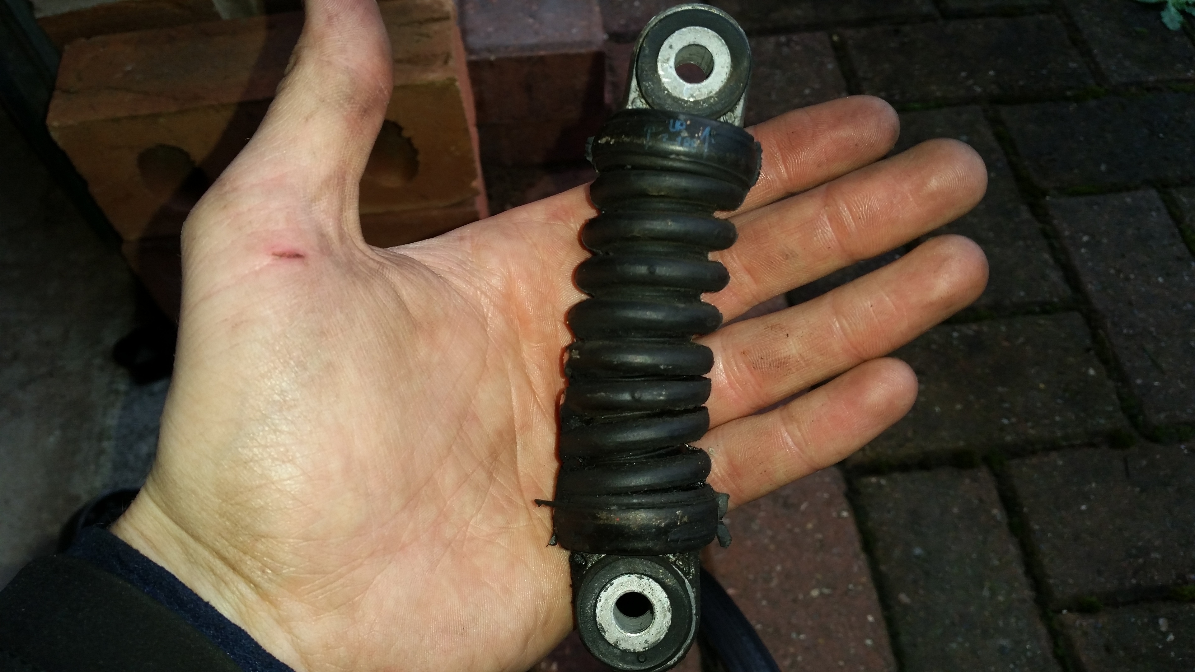

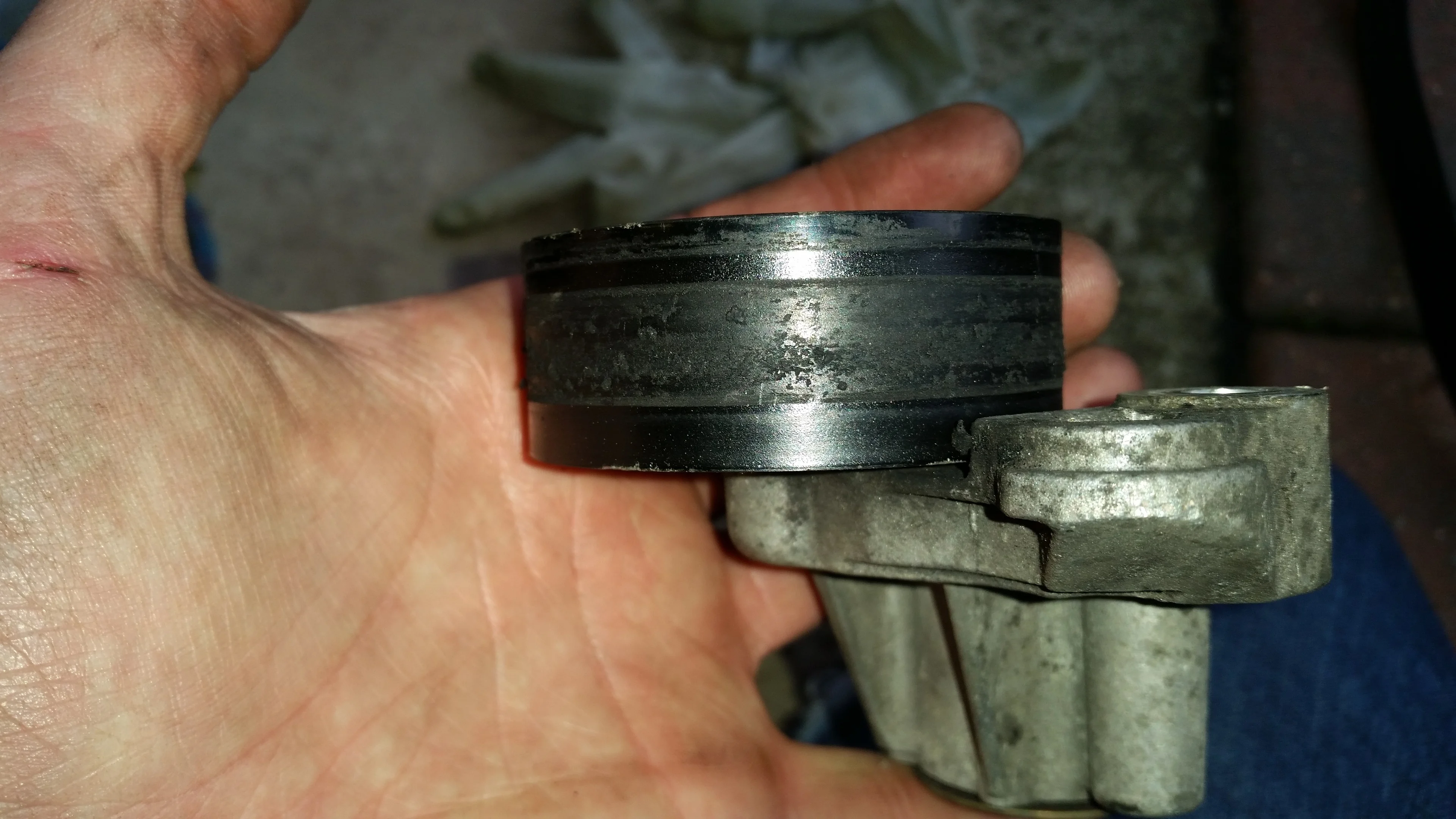

Just thought I'd post afew pictures of my Aux Belt that had been rubbing.
Back story first.
Noticed the Aux Belt looked a little 'worn' and 'dusty' around Tensioner Spring, when I changed the Engine mount in the summer, but couldn't see how, so kept an eye on it.
It then seemed to be getting worse and getting the old bit a squeal during turning (possible from the power steering pump put extra strain), searched the net for anything similar, and nothing.
So bit the bullet and bought a new Aux Kit for this long weekend, while I was changing the Clutch.

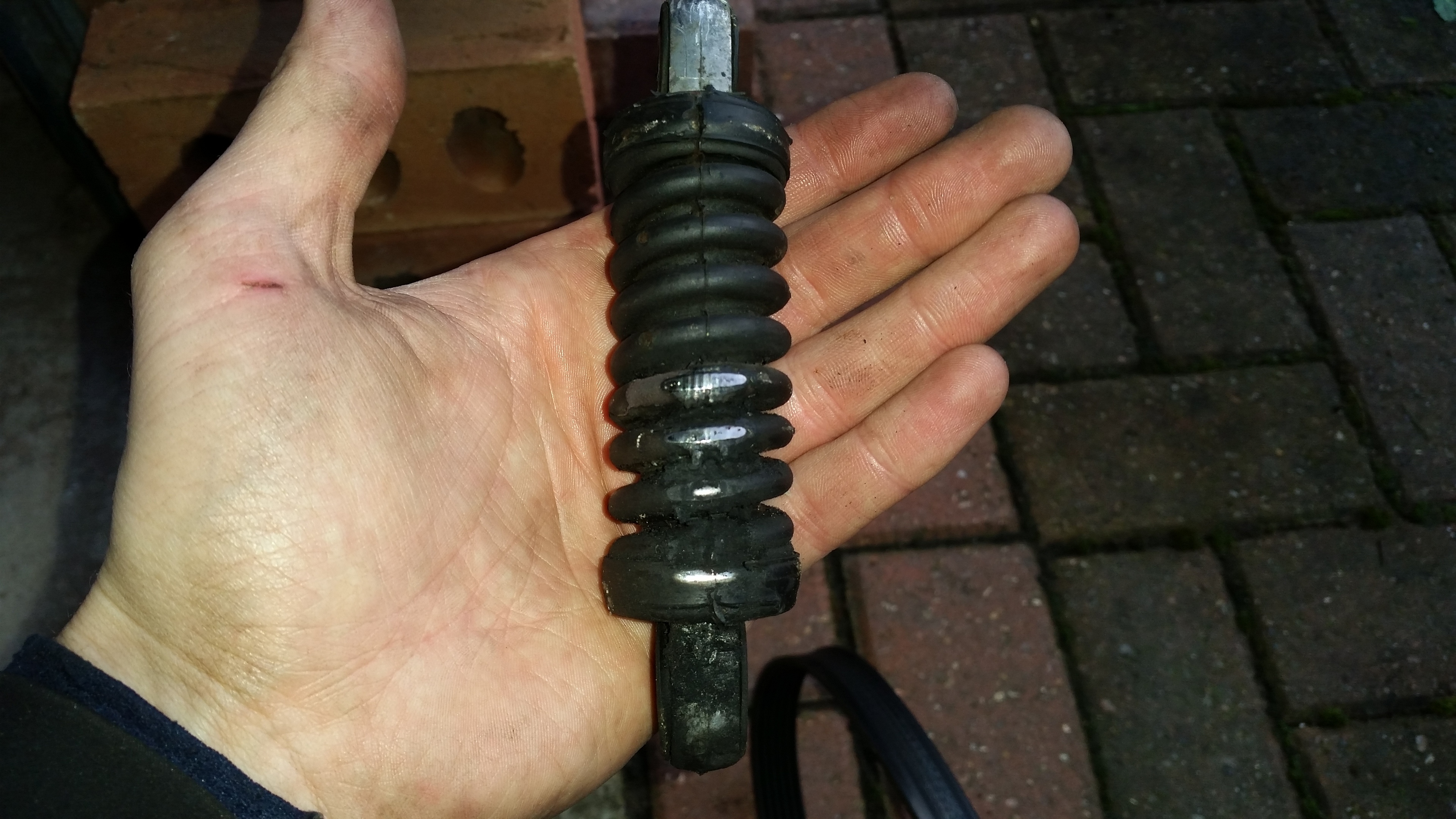

Anyway, following stripping of the front of the car, I could see that the Tensioner Spring had bent towards the back of the car and was fouling the Aux Belt.

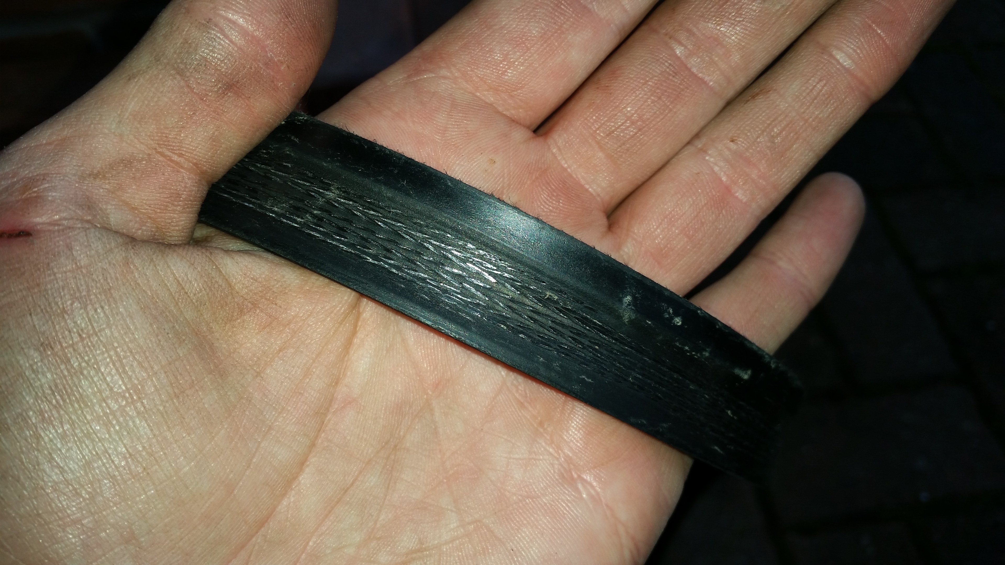

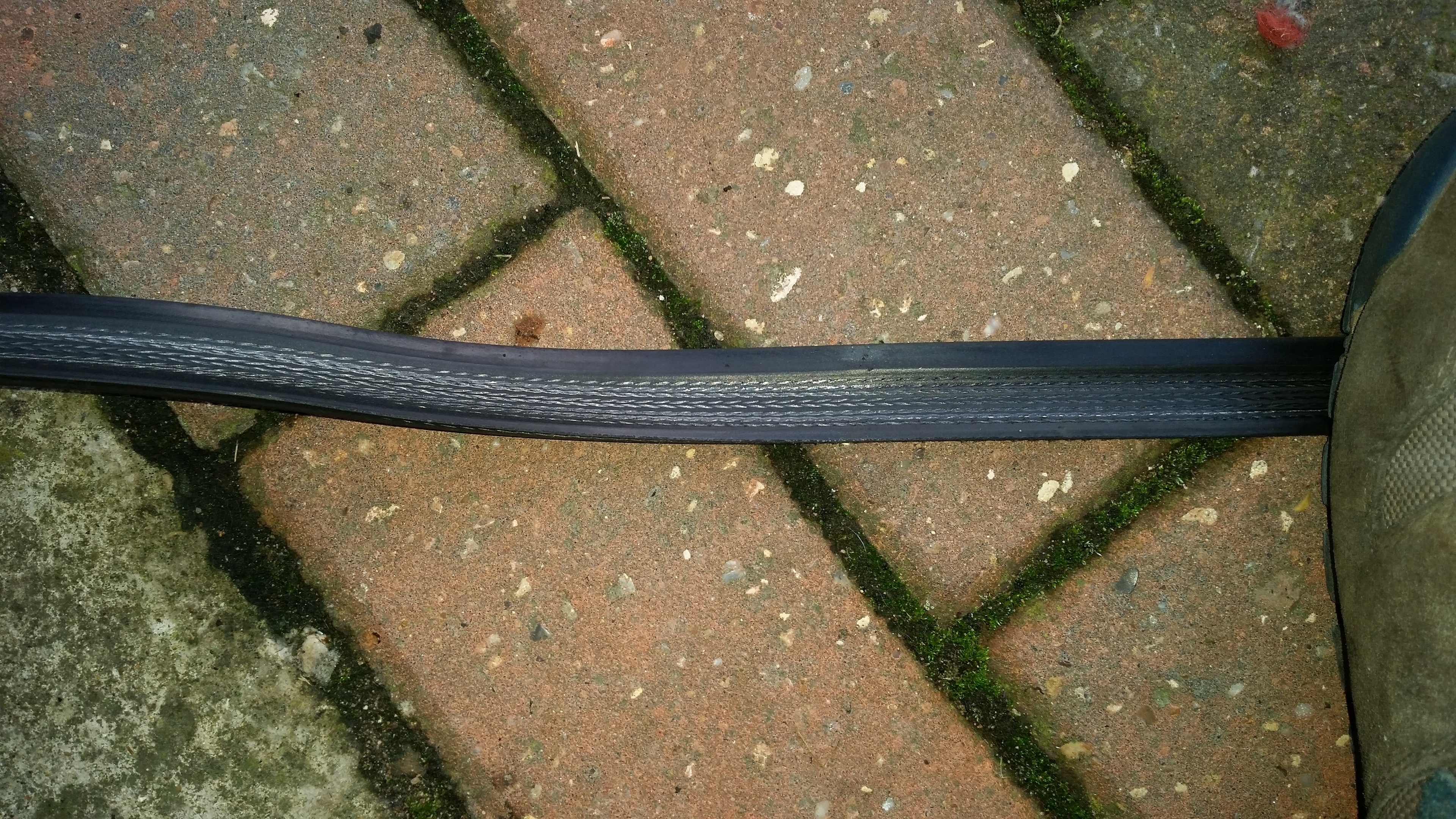

Once removed the Aux Belt had worn through to the Fabric String within the Rubber.
Leaving the Spring like this.
Anyway following the Cambelt Guide by @ben_p and a couple hours of nice weather, its now nice and new, along with a straight spring.

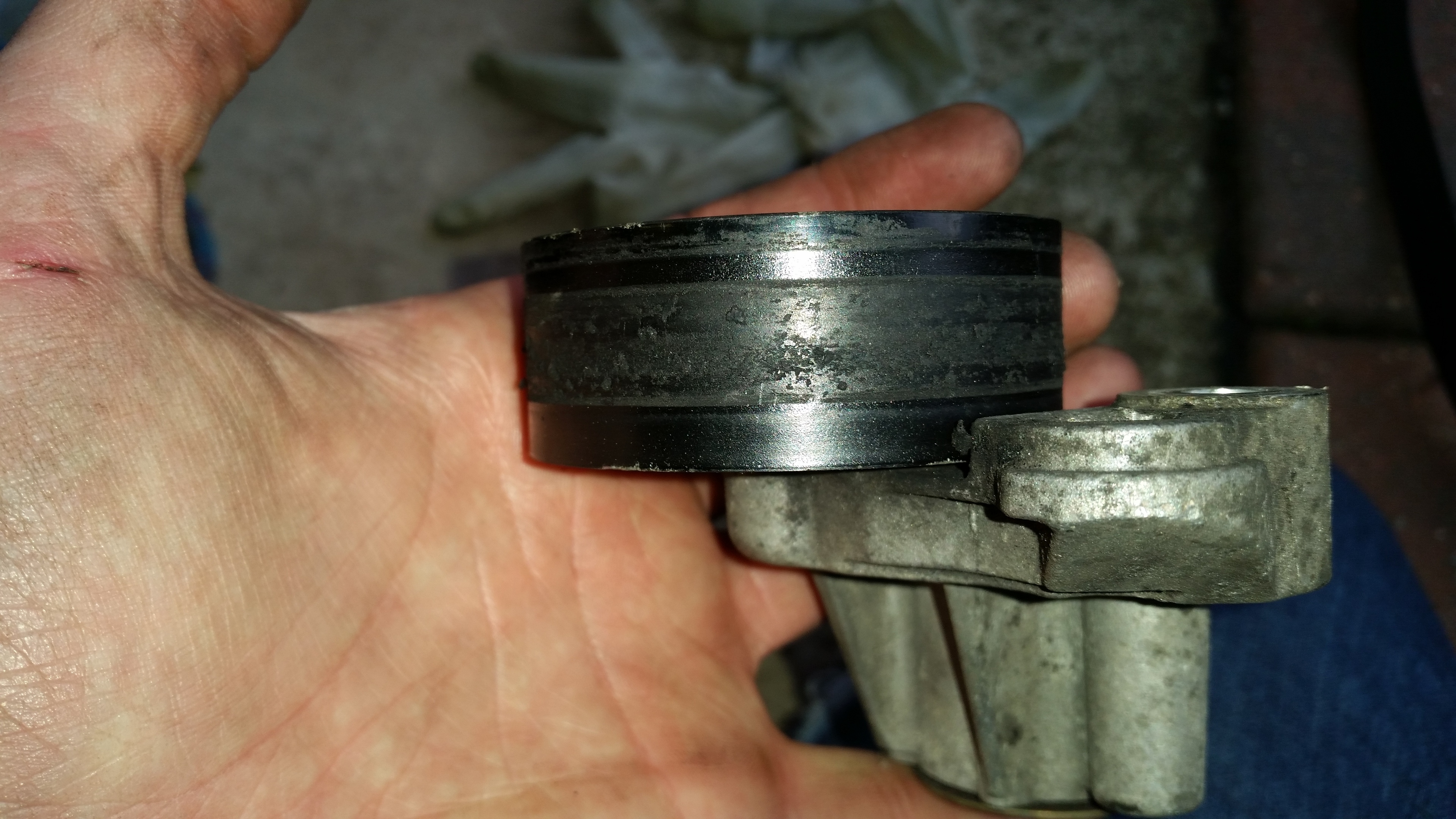

Are the pulleys still spinning freely?
If it's was a fk up when changed I doubt it would have lasted 2 month, certainly not 2 years... Just an unfortunate fail, but lucky you saved it for causing more woes...
Pulleys seemed fine, I'll check the old one in the morning.
I wonder if it bent, when it was fitted?
when the 'special tool' is used to remove tension when the belt is fitted.
