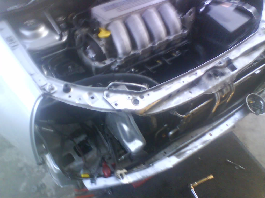

Hello, getting this changed this week on my 182, now on the k-tec site they sell the aux belt and the other option is aux belt and the tensioners which is more expensive, just wondered what kit i actually need before i take it to the garage
Thanks
Did my aux belt and tensioners a few weeks ago. If your getting it done Change the tensioners at the same time, Thats what went on mine and have read they are famous for it.
Can do it yourself as its not to hard but do need to take your car to bits.
