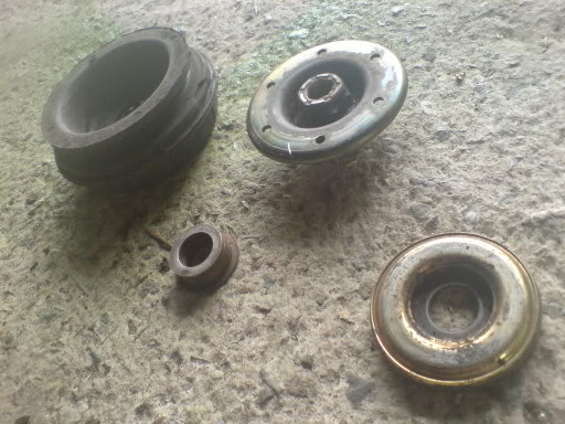

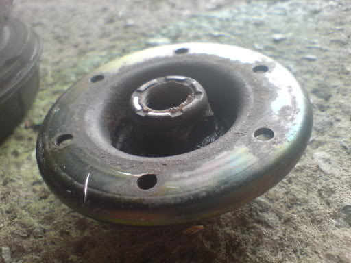

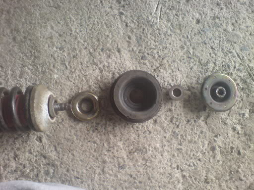

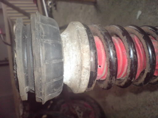

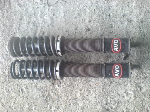

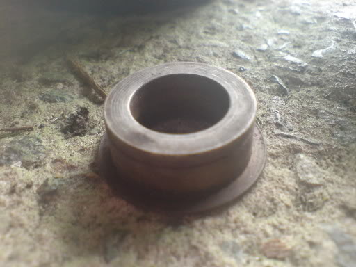

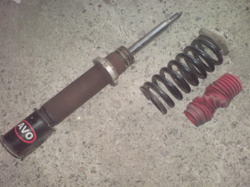

ok, got my avo's delivered yesterday, had a god look at them today, thinking to my self, how the fook do i put them all together, so many little pieces, which way do they go!!!!
also, is there anythin i need to know maintenence wise??

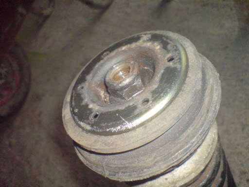

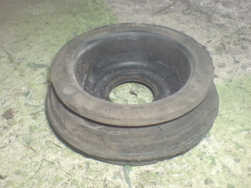

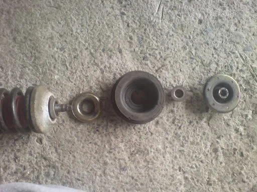

here is some pics, they wont be getting fitted until friday/monday depending on when my hubs arrive...
here is how i think they go, obviously with the top rubber being above the bulkhead..
in stages?? am i right??
thanks for ya'll help! :evil:

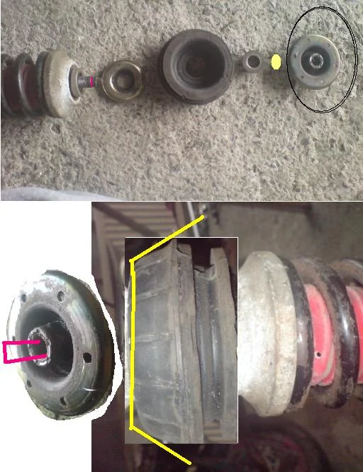

I've drawn a picture to hopefully show how it should be
On the top bit of the photo shows where in yourpciture a nut should go so you don't need to top mount on to keep the shock together. It goes onto the red bit of the thread. The black circled bit goes under the bonnet to hold the shock in place.
The lower bit of the drawing shows that you just got the big rubber bung on upside down it fits under the car the yellow lines shows where the metal of the car is when the shock in place. Then the top metal bit goes under the bonnet and holds the shock in place and stops it dropping out.
