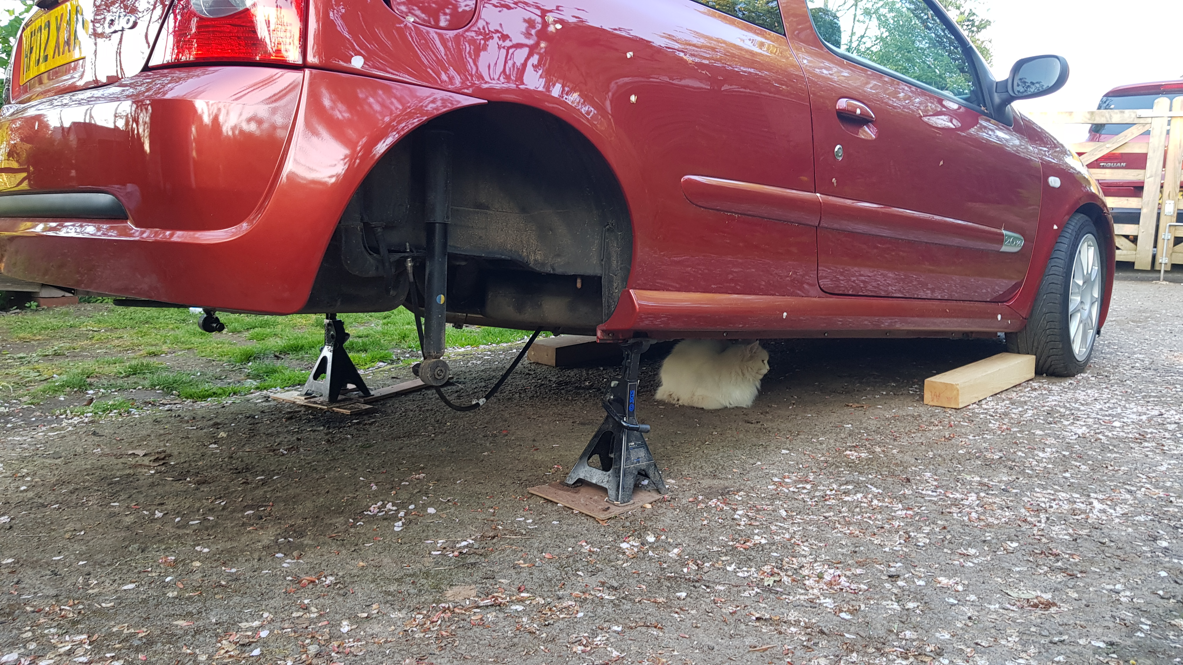

This is how exactly how I do mine (not my picture)
Jack where arrow is
As above although I use a flat piece of hardwood on the jack as well. The head on the jack is fairly narrow so I use the wood to bridge across the chassis plates. I’ve also put the jack on the rear axle beam as close to the damper plate as possible without issues

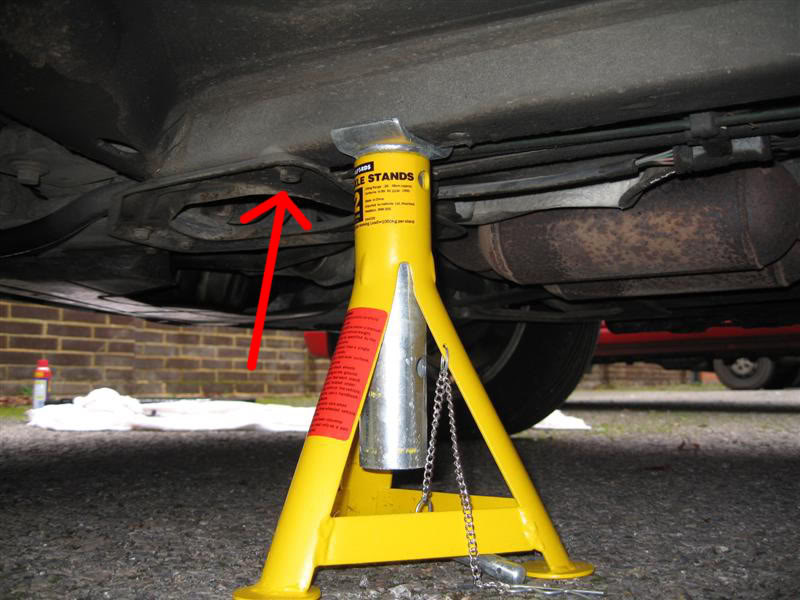

Jack where arrow isView attachment 1569175
That's where I jack mine at the front and put the axle stands. You'll need a low entry jack, i have the halfords 2 tonne jack and it reaches easily and the jack handle doesn't hit the car.
For the rear jack on the rear beam and put axle stands on the rear jacking points on the sill or axle stands under the rear beam. Both work well.

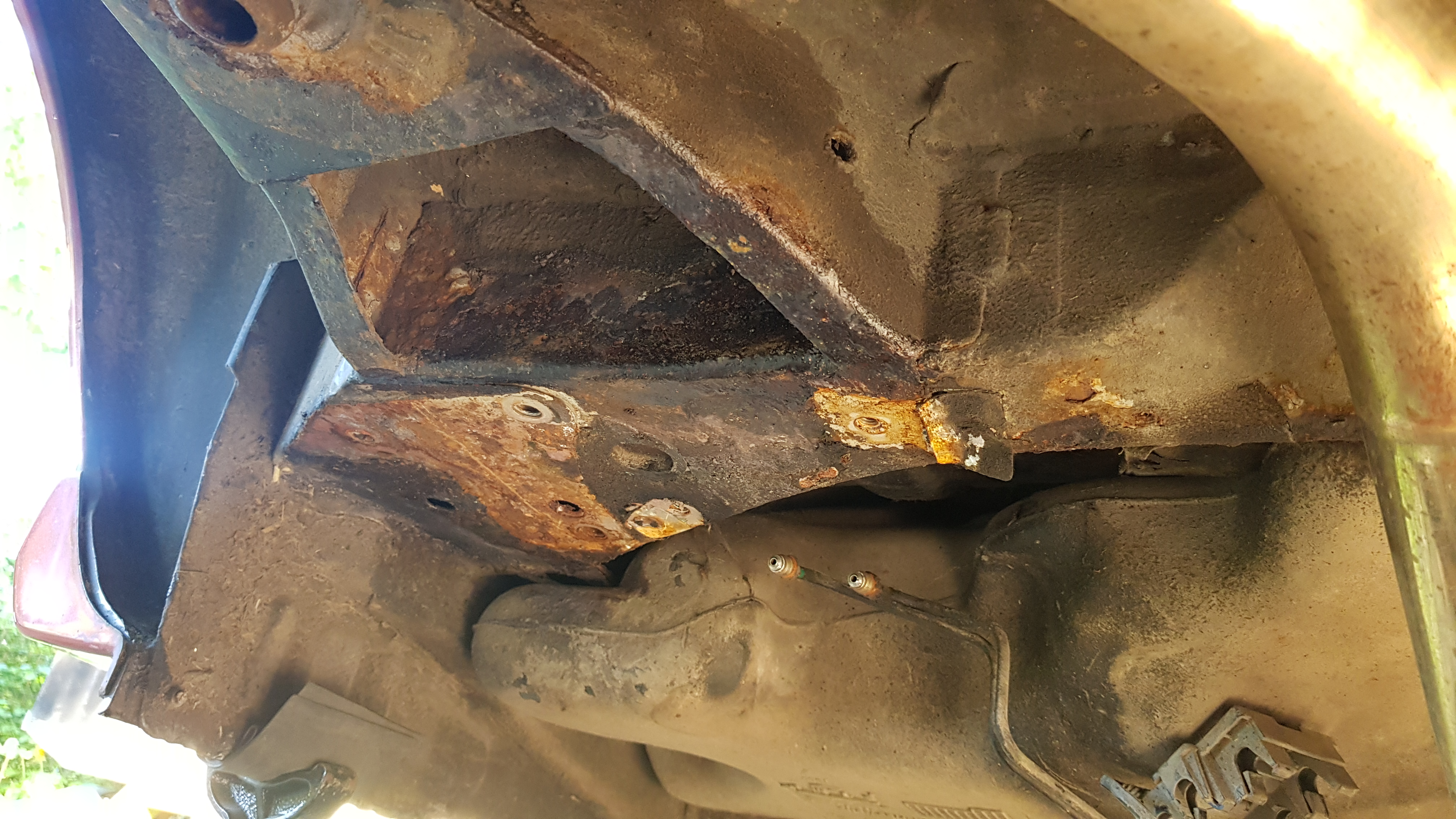

I do as James said. Lovely time of year to be playing with rust, be prepared for some frights around the rear beam mount area. Definitely get it off as mine had rust creating under it.
Oh and get the fuel tank off too while you're at it.
Yikes! That’s quite a lot more than I was planning….
