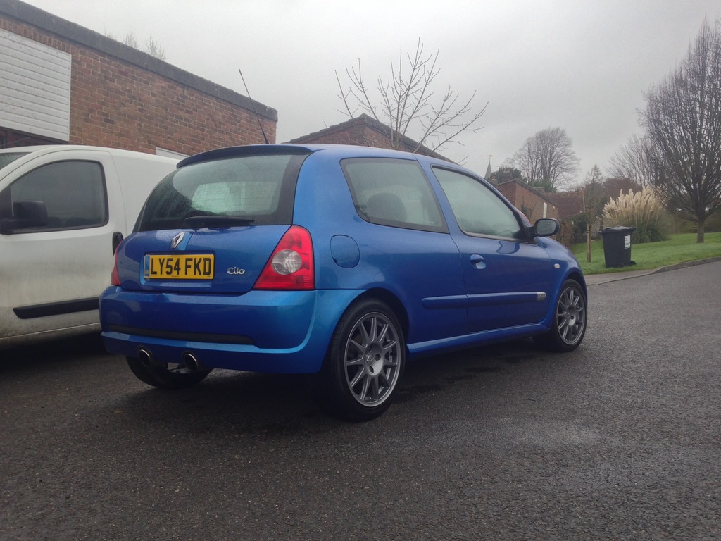

Back in a 182 again, yippee.
GrahamS
Picked this up last night as my dci is on its last legs and probably won't make out summer holiday without total failure.
It's my third 182 and I plan to do nothing to it but certainly nice to be back in another one. Needs an oil change, the tracking sorted and a cat gasket.

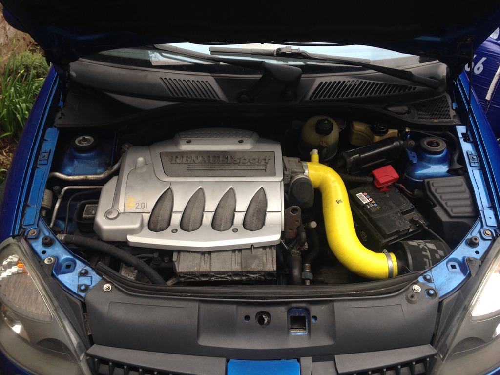

Spec
Poly bush dogbone
438 cams
Ktec induction kit
Eibach pro kit springs
Janspeed cat back
197 steering wheel
If anyone knows anything about this car I'd love to know.

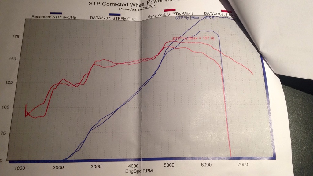

Who did the mapping on the 438s man?
Looks like a nice buy :smile:
Yeah it's not too bad. Will be sorting out the cat fitting kit this weekend and getting rid of the hideous blue interior light!
Was actually mapped by k-tec. Having looked through the SH one of the previous owners spent a lot of money there getting it serviced and having a few bits done. Map feels good but I'd like to get it on a RR to check a couple of bits if money allows.

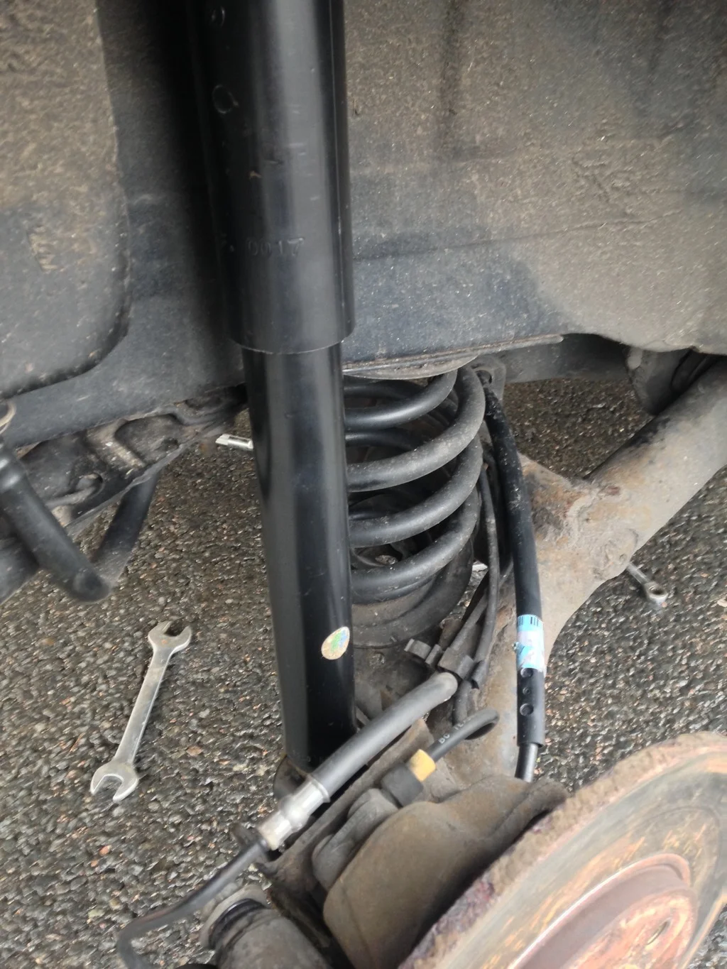

At the weekend I did a few jobs on the car to make sure it's tip top.
I replaced the handbrake cables with genuine renault ones as one had snapped.

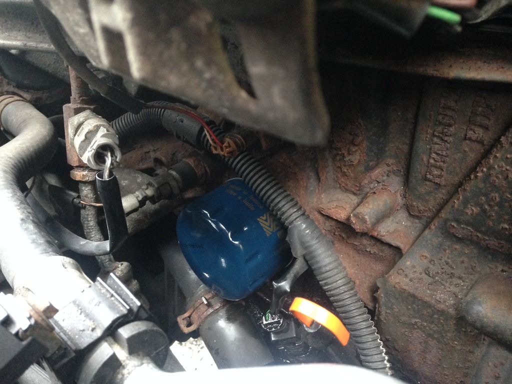

Millers nanodrive 5w40 and new genuine filter as I wasn't sure when the last oil change was done

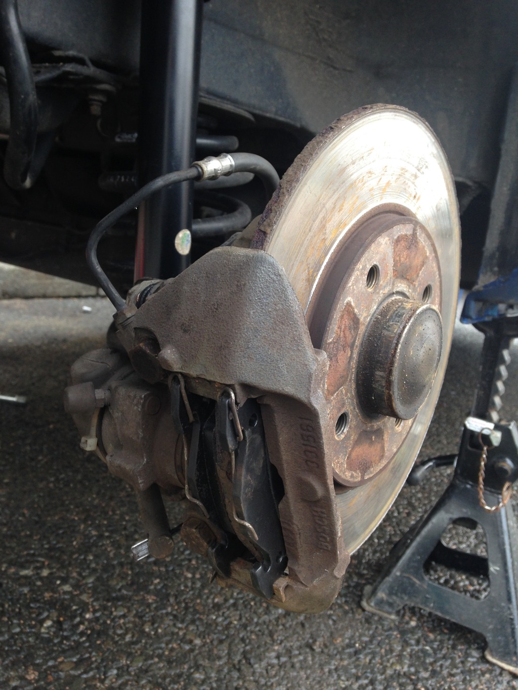

New rear pads
Free'd up the rear calipers with some rubber grease.

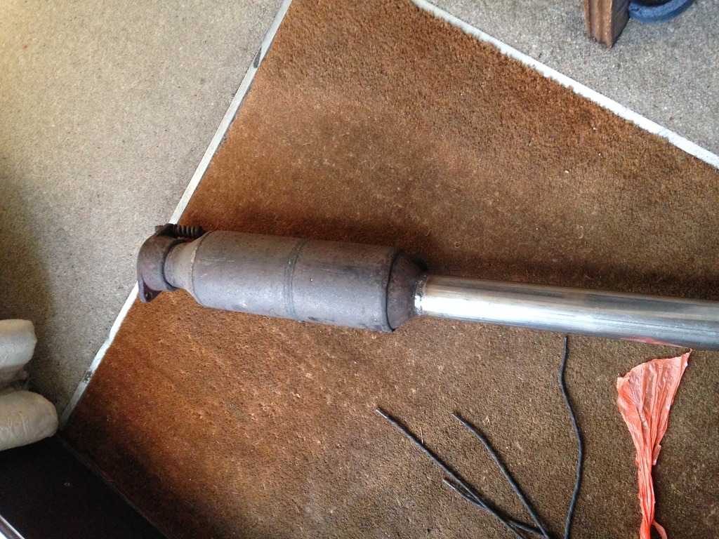

Tried to fix the olive joint on the exhaust but it was just leaking like a sieve so had the cat sleeved.

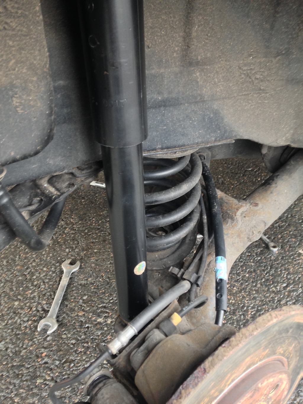

Replaced all the dampers for some with 110k less on from my dci rep build.
Car is now running great and sounds much better without the exhaust whistle. Tracking seems to have been put out again by changing the dampers which is annoying. Will try and get some new track inners and outers then have the tracking done again before going away.

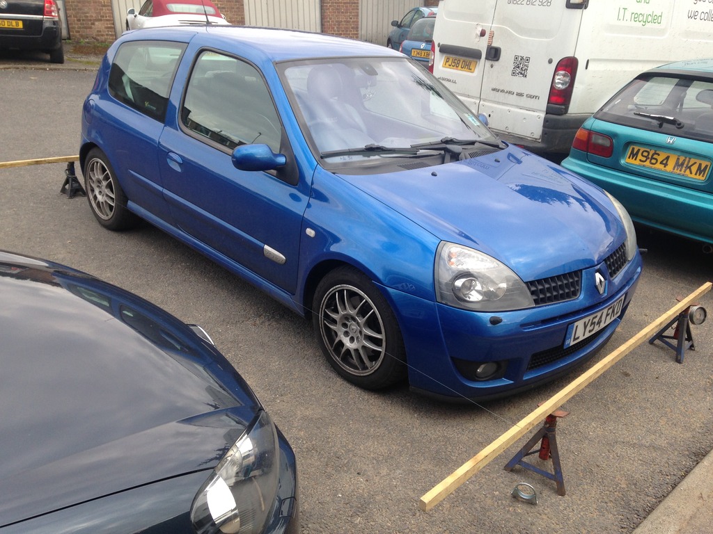

Checked the tracking, it's only a tiny bit out but it's that tiny bit which clearly matters!
Did you have the silencer removed as well? That pipe looks well long for just sleeving it haha.
It's the best way of checking tracking! You just measure how far the front and back of the wheel are from the line to see what toe it's got.
The next car is up for discussion here, likely a BMW of some form though I think. http://www.cliosport.net/threads/upgrade-time-soon-£10k-budget.790761/
How do you know the lines perfectly straight, also equal and adjusting must be a pain?
