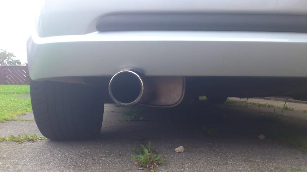

Just after a few suggestions to sort my exhaust problem out..

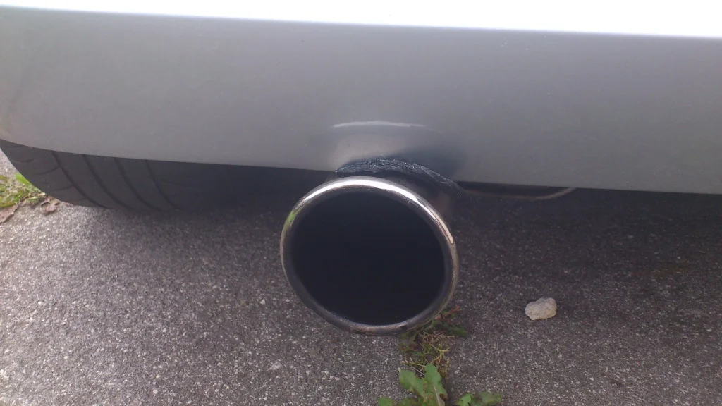

Its currently sitting right against the bumper and burning away at it, and im wondering whats the options to prevent this??
That black s**t is the bumper melting..

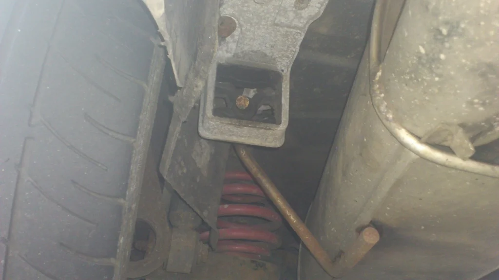

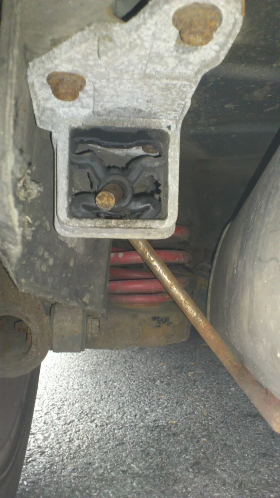

Also, the rubber hanger is just about goosed, if i replace this, is it not gonna pull the exhaust higher and therefore nearer the bumper?
Its rattling away as it is, so what can i do?
Am i better off getting the bumper cut to fit it, then one of those chrome plate thingybob's? Or will that look s**t? Anywho, just after what everyone thinks would work best, new exhaust perhaps?

I would personally cut the bumper. Replace the mounts with a set of the solid prima ones, and have the bumper cut so it sits recessed. Nothing uglier that a zorst sat actually on the bottom edge
