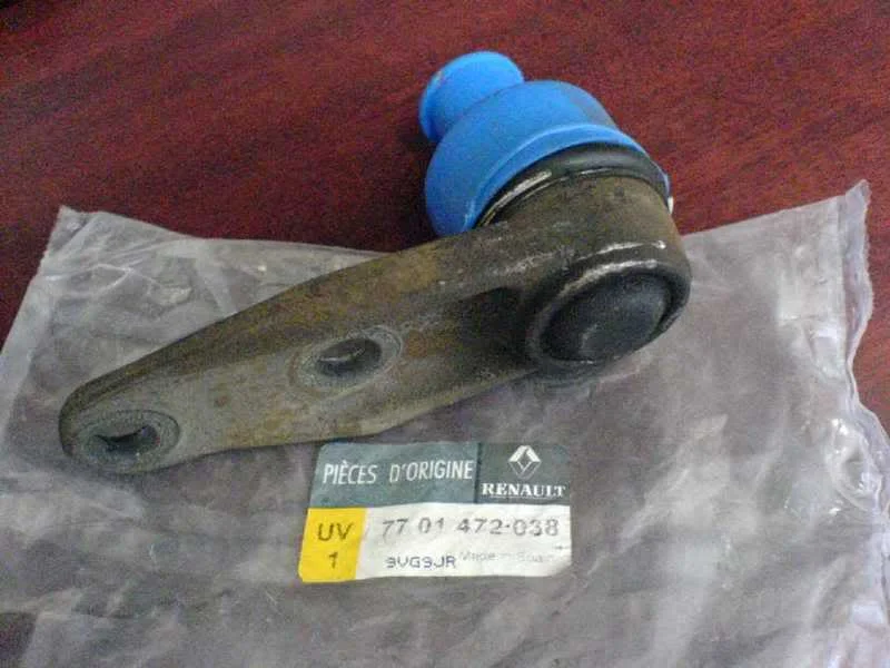

yeah thought so. the big helmets! theres only 1 ball joint per side isnt there? (bear with me im NO MECHANIC! - no sh*t!), the one right where the steering arm joins the hub if wheel?
Aye, looks like this
To replace, undo the 2 nuts connecting it to the arm and the nut on the hub, use a BJ splitter
The knocking noise I had, was the CV joint on mine.
About £50 for a new lower suspension arm from Renault, which maybe the same part as you need. (I'm no mechanic either)
yeah thats it Gav cheers. that bottom joint on your pic. so that can be fixed seperately and buy that for £15? i dont need whole arm?

As said you cannot buy just the ball joint its the whole arm you need.
You can use the ball joint off the Scenic and I forget what other cars I can get you the dimentions but its unlikly a dealership will have them in stock anway so its not like you can measure.
IMO just buy the whole wishbone.
^^^^ As the man said. On Dialogys it says you can't buy a ball joint on its own. Some have managed to find them from somewhere though so good luck.
