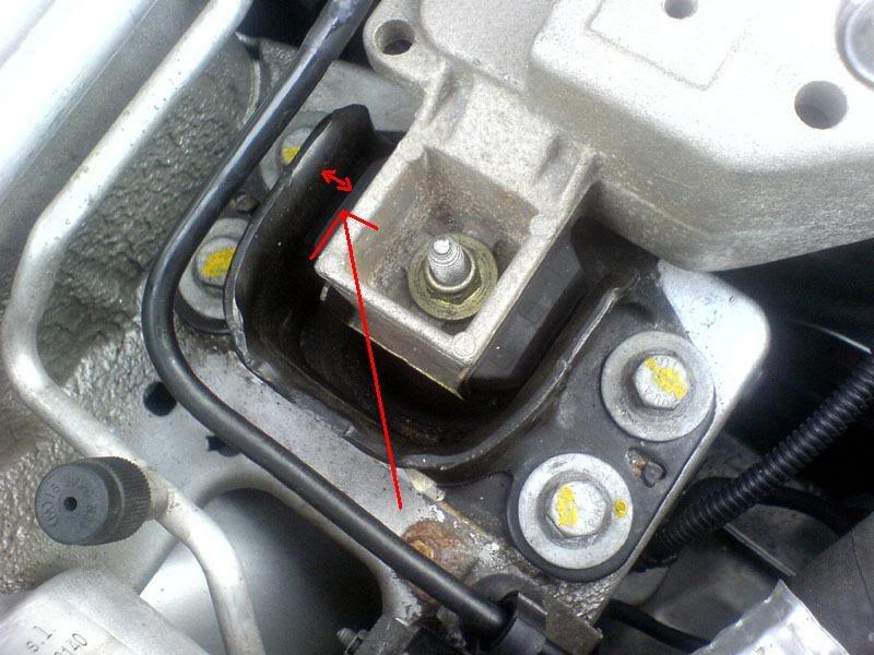

you mean this?
quote: and then slacken off the 4 bolts on the left hand engine mount (the one near the oil cap lol) pull the engine forward with the help of a bar/mate then re tigthen the bolts. Job done, mine never does this now, no mater how much right foot is given in 1st
  Lots of Alfas

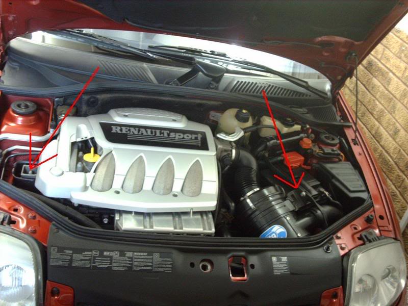

The bolts shown here with yellow on them, loosen them, there is also a mount under your battery which is similar, (remove the battery by unding the bolt holding the plate down on the left of the battery)loosen these bolts too (by loosen not take off just do them up about half a cm. Get someone to pull the engine/mounts as far forward to the front of the car as they can and then re-tighten all the bolts to 60NM iirc. (ignore the arrow).
  Renault Clio 172 Sport
Cheers for this, is this at the front of the car looking at it from the front. So the mounts are front left under the battery and on the oposite side>?
