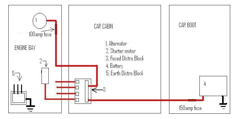

I would do it like this....(Fuse covering the Alternator charge lead should be greater than the alternators output but below the cables rating....Fuse covering the main batt supply should be great enough to withstand cold starts but again less than the cables rating).....
The Batt supply cable to the fused distribution should be 0awg minimum, on cold starts the initial draw can be extremely high....(even a 150amp fuse could blow on some larger engined cars), Check your starter specs for max draw....

intended to use a 0awg wiring, wit a 150a fuse,
i shouldnt need no.5 because everything in the engine bay is earthed to the chassis, and so is the battery.
where do the other 3 points on the fused distribuion block go??
to all the other battery connections in the engine bay??
i was going to:
consolidate all the battery connections under the bonnet to a 0awg wire,
and run in to the boot,
is this the cheap way??
your diagram looks the same kind of idea,
only running an extra piece of wire to the alternator no??
but just running the power wire to where it would have gone into the fuse box to begin with?? :S
