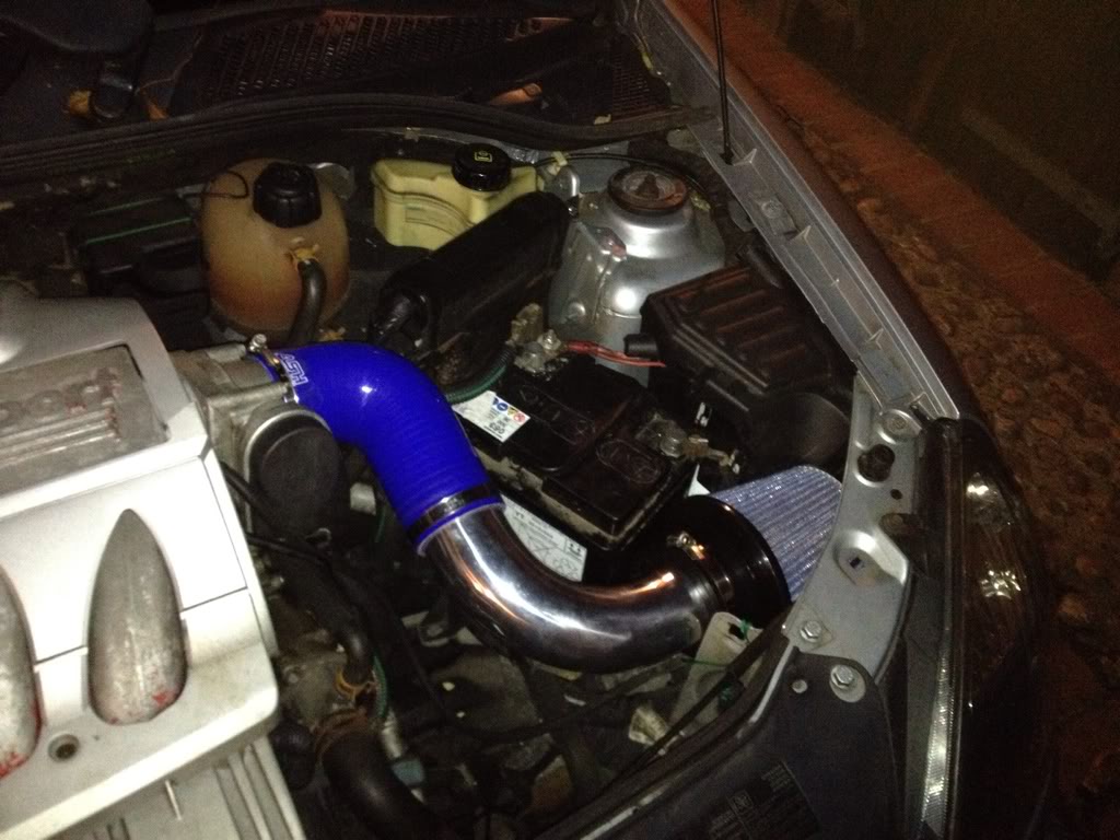

Its a BMC CDA. Awesome kit, but the CAF I have at the moment is sat right behind the radiator so its sucking in lovely warm air!!
Plus the cardboard flexi hose is cr@p!!
Going to sort some steel pipe and Samco hose to fix it up a bit, but its so tight for space in there with the battery where it is.

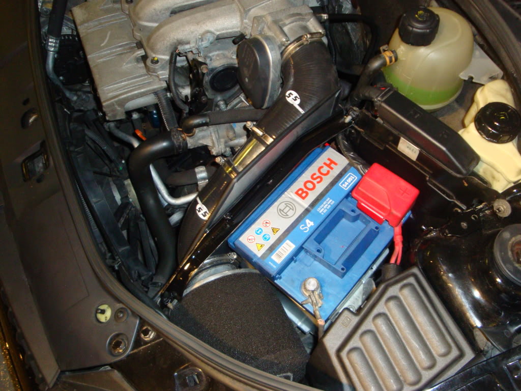

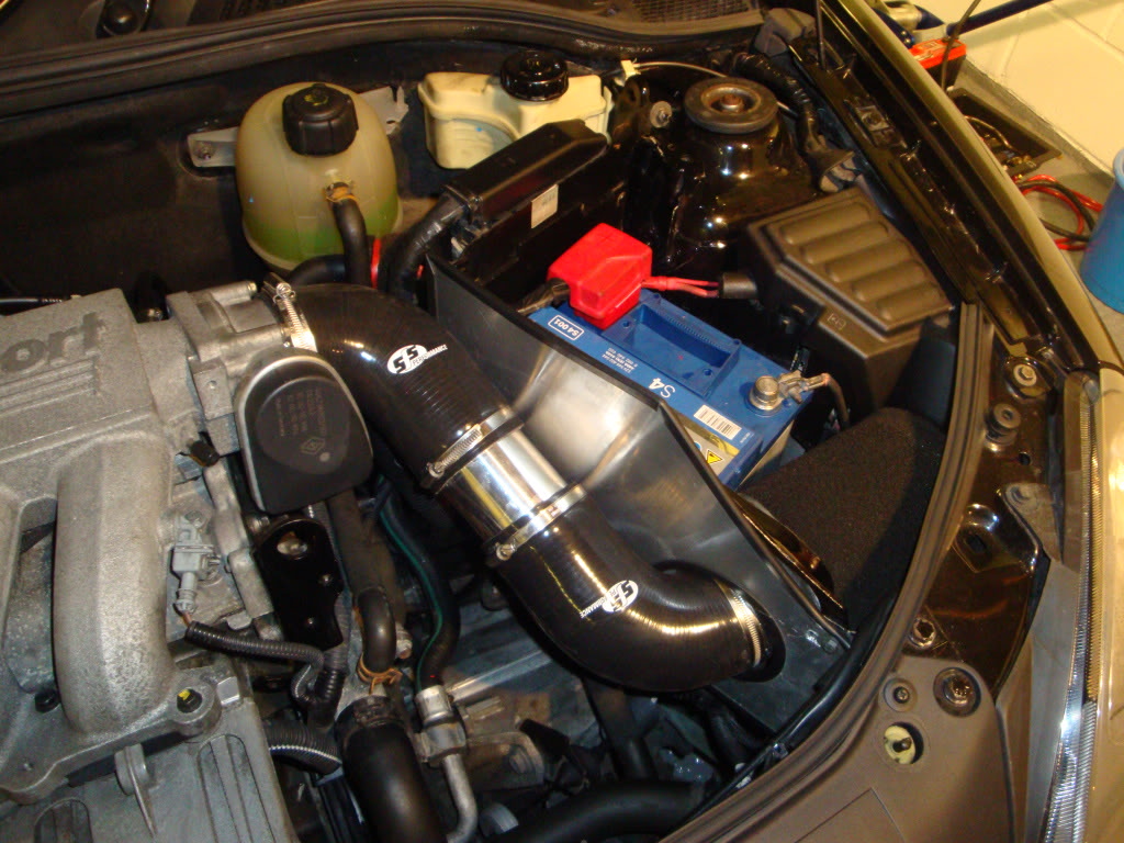

You say that but look at my setup and it fits, I'm sure you could get it to work for you!
Sorry, I missed that!
I had a look at my engine bay and there doesn't seem to be anywhere near that amount of space to get it at that angle?? I'll upload a picture tomorrow.
Also Chris, where did you get those bends?
As chip said there are two types of battery, 075 and 063, you need the 063. If you look on the battery it will tell you. However most places sell new 063 batteries for £35-40.
