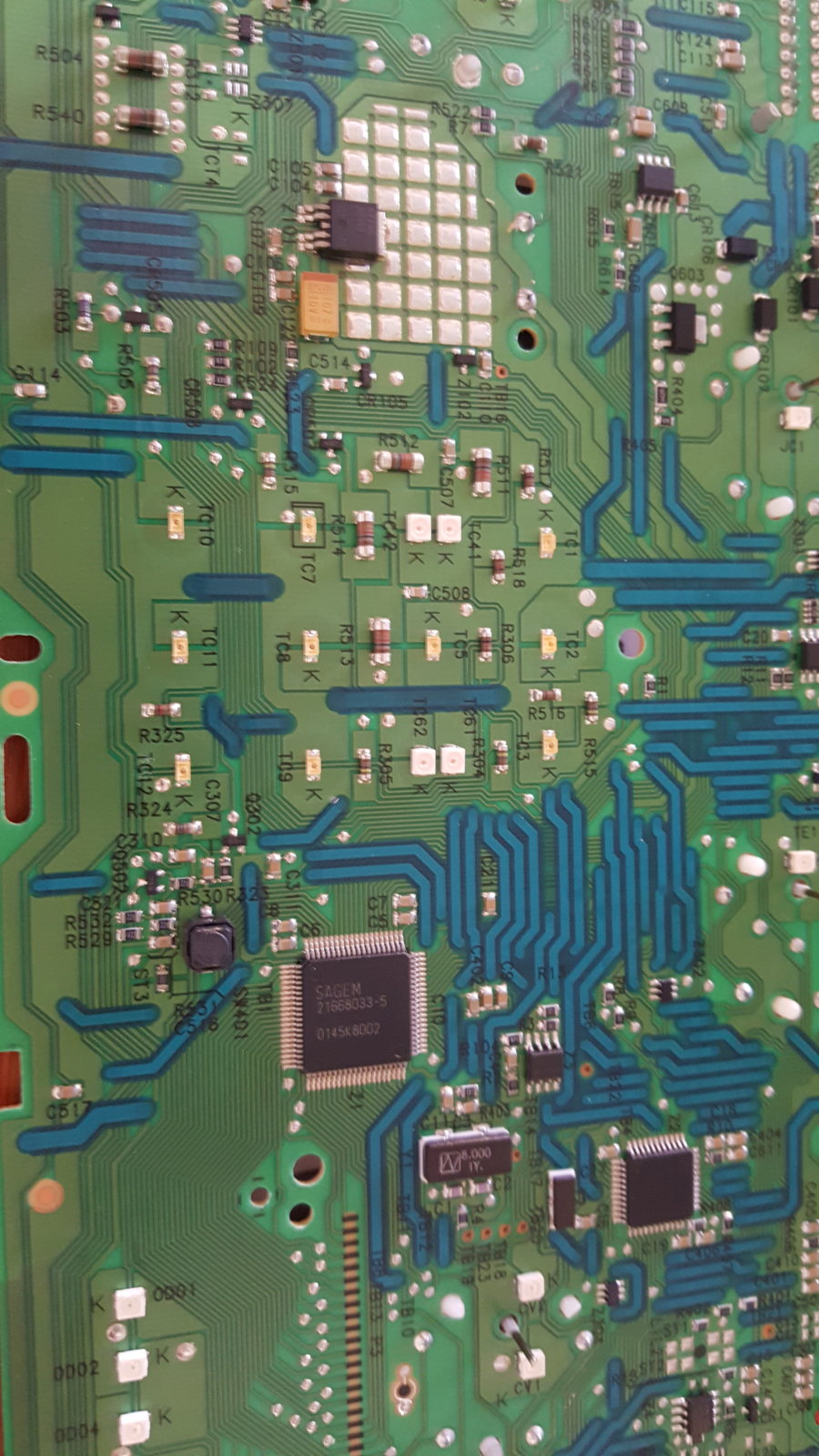

I have the dash completely disassembled and the 'bulb' is an LED. Would be very surprised if this is the problem.

I have the instrument panel completely disassembled and the 'bulb' is an LED. Would be very surprised if this is the problem. Now to look elsewhere.
