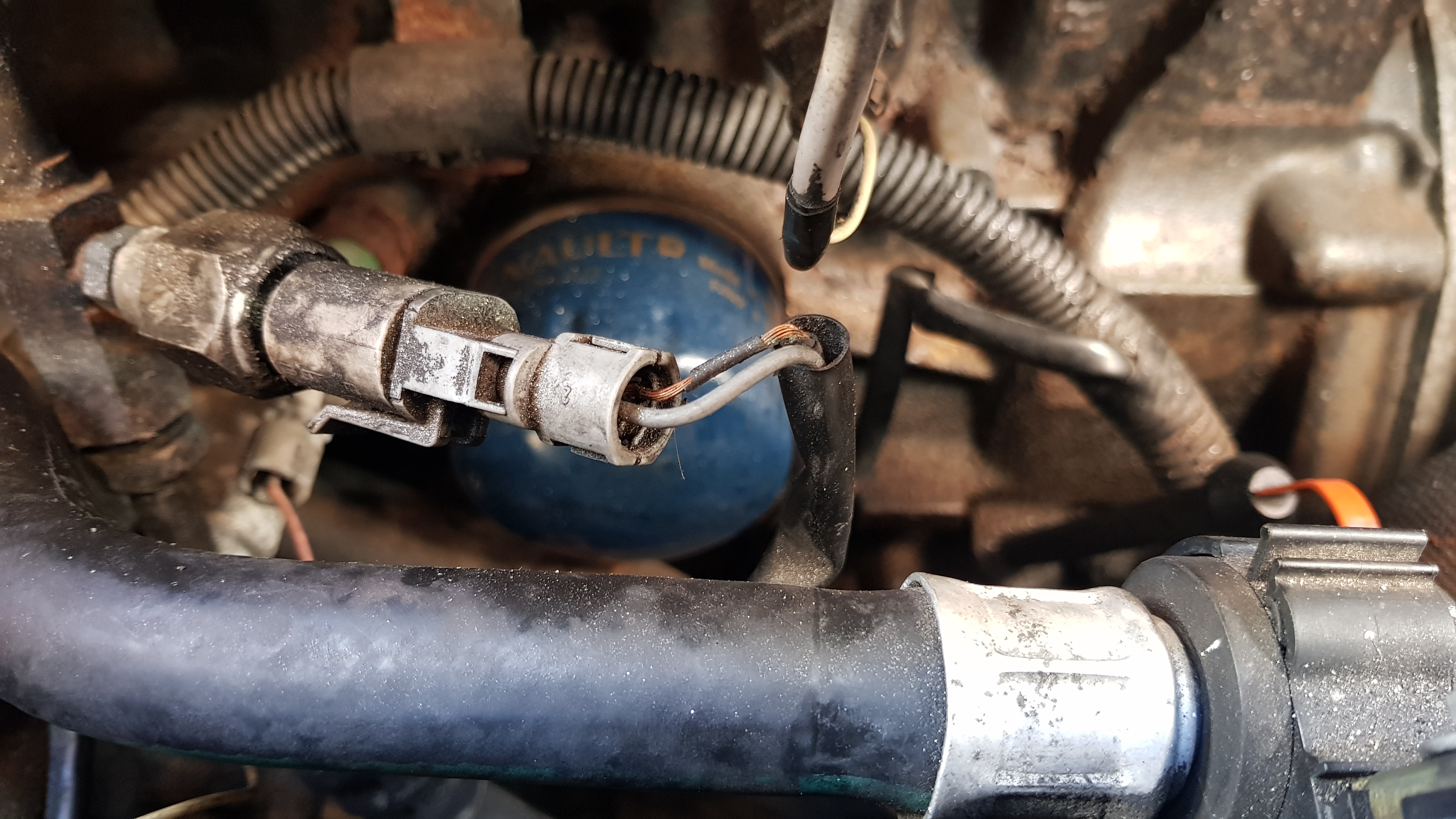

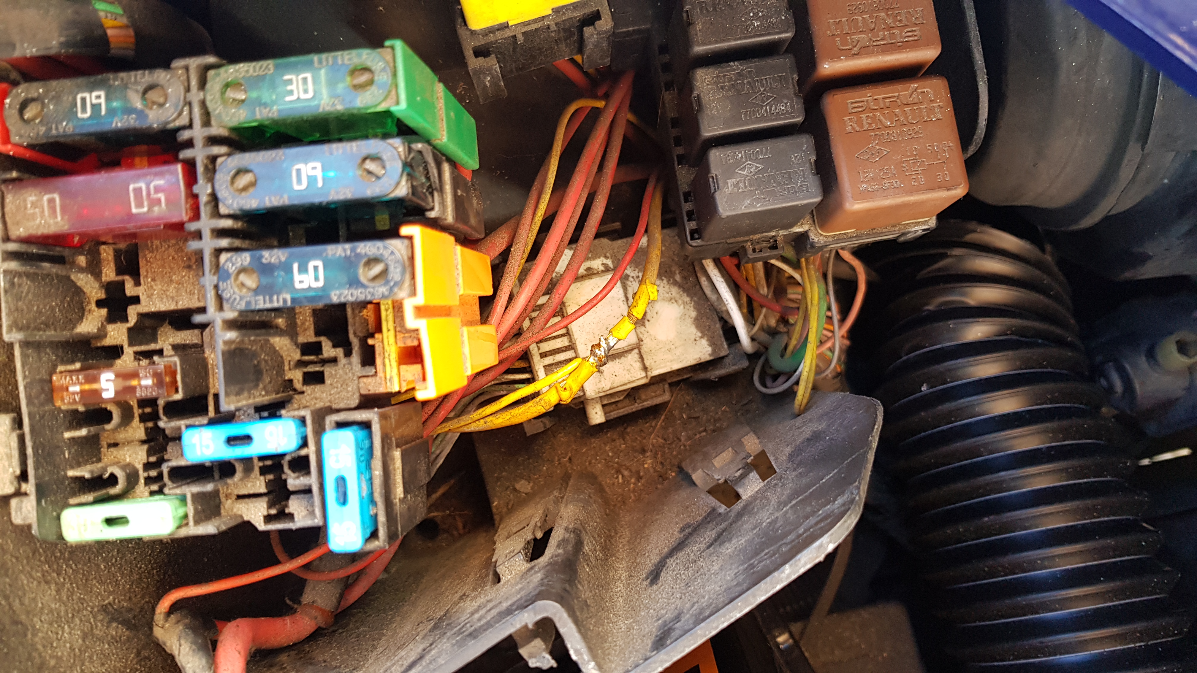

I found these wires looking a bit suspicious, anyone k ow what these wires do or are for and if it could effect charging
I'm going to repair that wire better but I ca t see that being the issue so still no clue what it could be
Sounds like duff alternator tbh, measure voltage from main wiring anchor on the alternator to battery neg, if that's still low then unlikely to be wiring.
