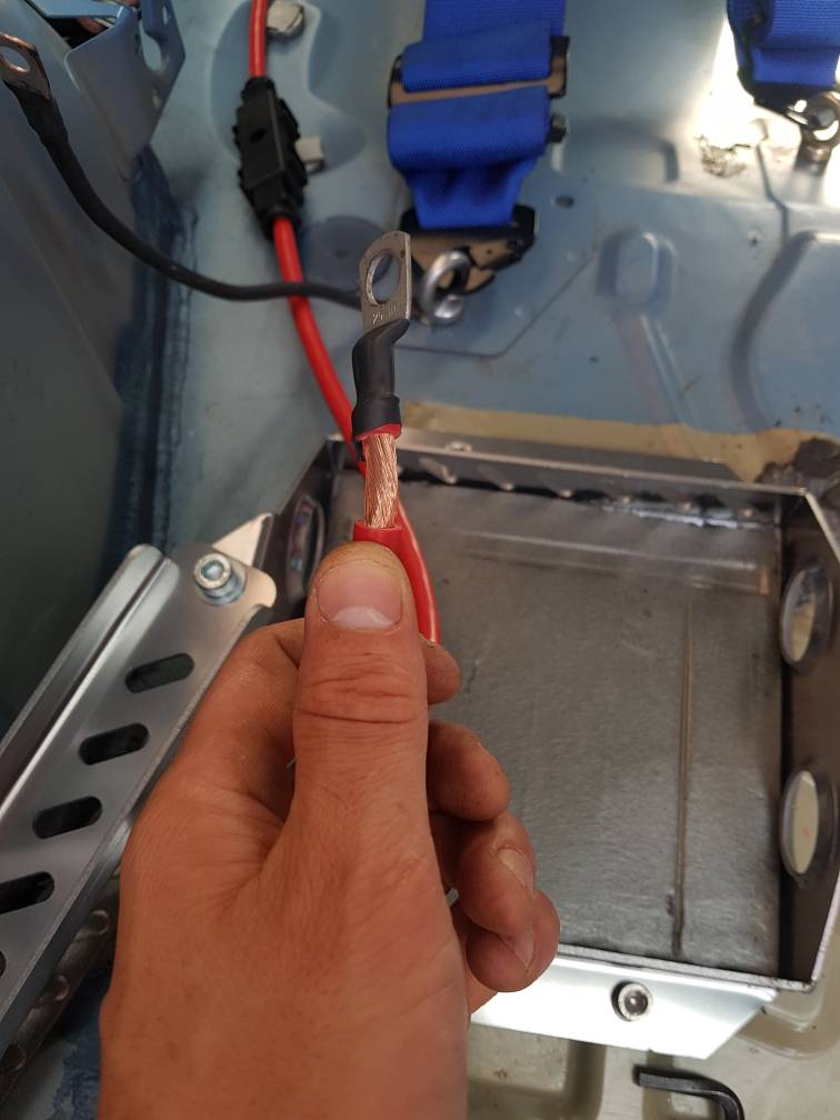

I'm in the process of reverting back to the old battery for now. I took a photo of the cable used. It's 6mm in diameter which equates to 28mm2. Not small?! Earth was the old battery earth from under bonnet.
Will report back once I get it fired up and test the alternator.

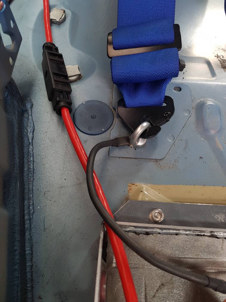

Here are pics of said wiring and farthing point. Bit of a bodge using the eye but I thought it would be good for an earth point

Whenever you make a new Earth make sure you clean the chassis where the earth is made and then coat it is grease to prevent corrosion, seat belts are a crap Earth unless you clean them, kids love earthing amps there and wonder why you get noise :(
