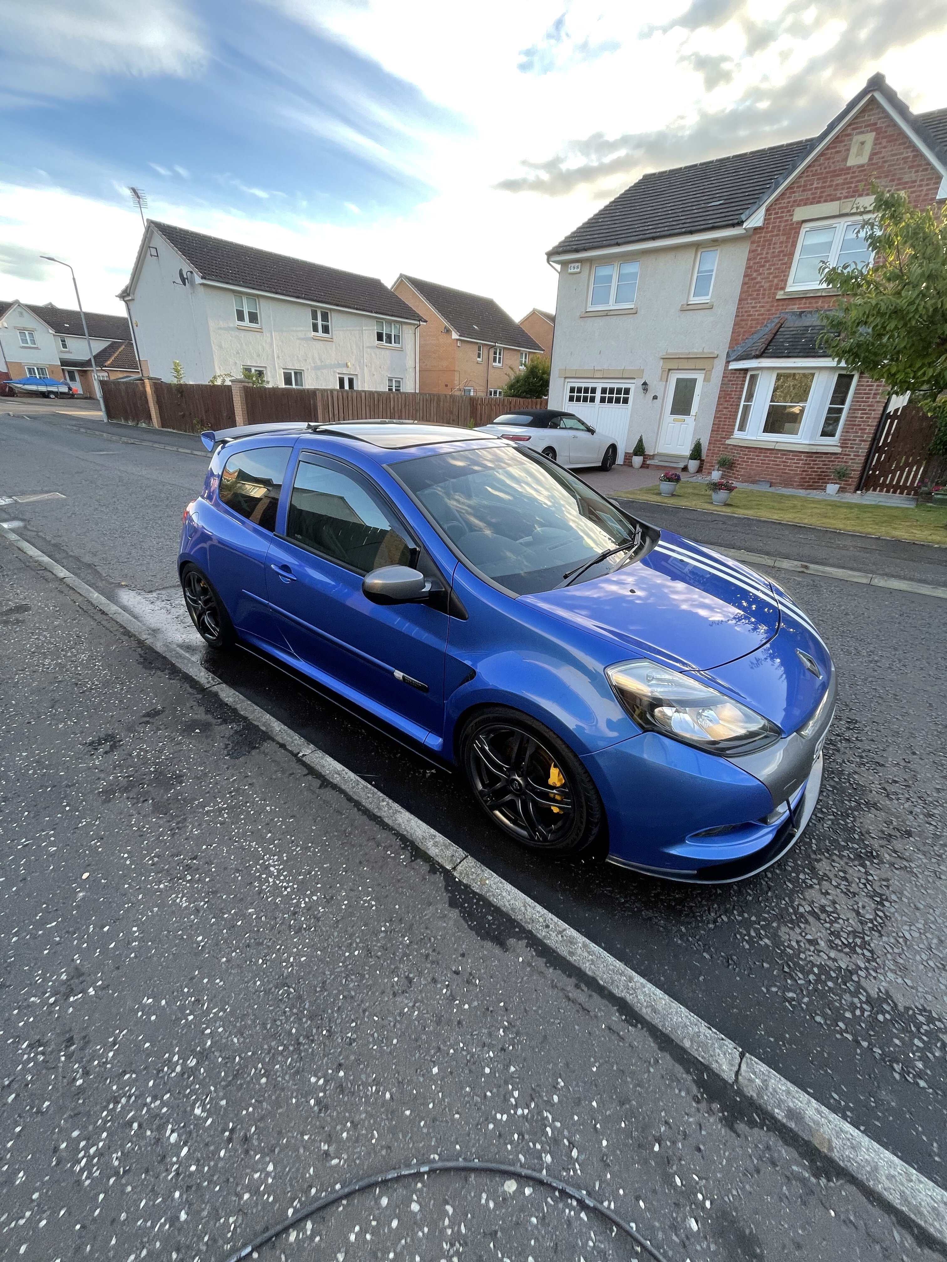

I have a clio 197 rs , the battery is smoking and stinks of rotten eggs is this being over charged by the alternator ???new alternator and battery???

Sounds pretty bad, you'll wanna try check over the electrical system as well, see if anything is obviously burnt, melted or damaged.
I'd probably remove the battery as I'm pretty certain it's not supposed to do that and if it's going to spontaneously combust I'm sure you wouldn't want it to do so in the car.
