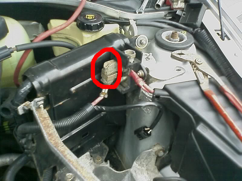

Hi all, just wondering if it is possible to remove this; (sorry for robbing your picture Jay ;))
I want to cut it off the wire and attach an eyelet to it. Is that possible, or is there something integral there that is needed?
that's what i'm thinking, just wanted confirmation really. Looks like there is some weight to be saved there too.lol
I think its a big fuse of some kind. I had the same thought but it looked like a thick fuse type of thing!
All i did was bend the spade so it wasnt so much of an angle, and it fit fine. You must have a similar junction, 2 way?
As far as i know, its just a wire, with an inline fuse, sure someone will correct me tho.
I just chopped it off lol. Not had any issues, although it'd be a good idea to put a fuse in if you're relocating the battery.
ah ok, didnt' think about that. Yeah 2 way I think. Its out of the new 3 series BMW I believe. Got it from the dealer £6. bargain!

I'm looking at getting a 150amp fuse, but don't know if this will be enough. How much does the started motor draw?
A fair few more than 150amps mate....
The 150amp fuse will not blow until it reaches around double its rated load....
The pic you linked to was based on a small engined Vauxhall, the best advice would be for you to check the stock battery specs for your car...Take note of the batteries CCA rating, this gives an indication....
The initial burst only lasts for a short time, once the engine is spinning the draw drops markedly....
It's good practice to start the car with the clutch depressed, this eases the load considerably....
I would suggest you consider a circuit breaker fitted at the battery in place of the fuse, if using 4awg cable, (battery to engine bay), then treat 150amp as a maximum, if using 0awg then 250amp maximum....

Thats the cable i've got. Not sure what you mean by awg :S. How would the circuit breaker work compared to a fuse?

Due to relative short periods of max load whilst starting, I would suggest you try your 16sq mm cable fused at 100amps & see how you go.... If you blow the fuse or your starter spins slow then look at upping the cable size.... I reckon you should be ok, (but remember to dip the clutch whilst starting)....
Nice one mate. So you recon 100amp, not 150amp to try? It's a racing battery, so more efficient current I believe (correct me if i'm wrong), so resistance shouldn't be too bad.
