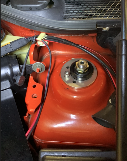

Currently in the midst of fitting some BC BR coilovers and whilst I will be sending the car to get properly set up once done, I'm looking for a decent default setup for fitting.
Does anyone that has BC BR's give me a steer on a default camber/caster setup for initial fitting?

You want the 3 bolts facing to the outside for max camber.
Or facing to the front for max caster.
I have mine for max camber.

I have these coilovers, to adjust them do you need to remove all the allen bolts and then rotate the whole shock or do you just loosen and rotate? I would guess the latter but wanted to check first.

Loosen all 3 and then rotate the top disc and top mount.

I ended up replacing the BC top mounts with PMS solid top mounts and use camber bolts instead. Whilst they seem perfectly fine, I just don't have 100% confidence in unloaded weight being supported by a small aluminium disc and 3x tiny bolts. They are a knocky coilover but work well on track.

I've got BC tops on mine.
I ran max castor and ran with camber bolts. Nothing has shifted on mine and it's had a good shake down. Marked it all up with paint pen to keep an eye on it. But nothing has shifted. Stuff that requires thread lock is threadlocked and torqued accordingly.
