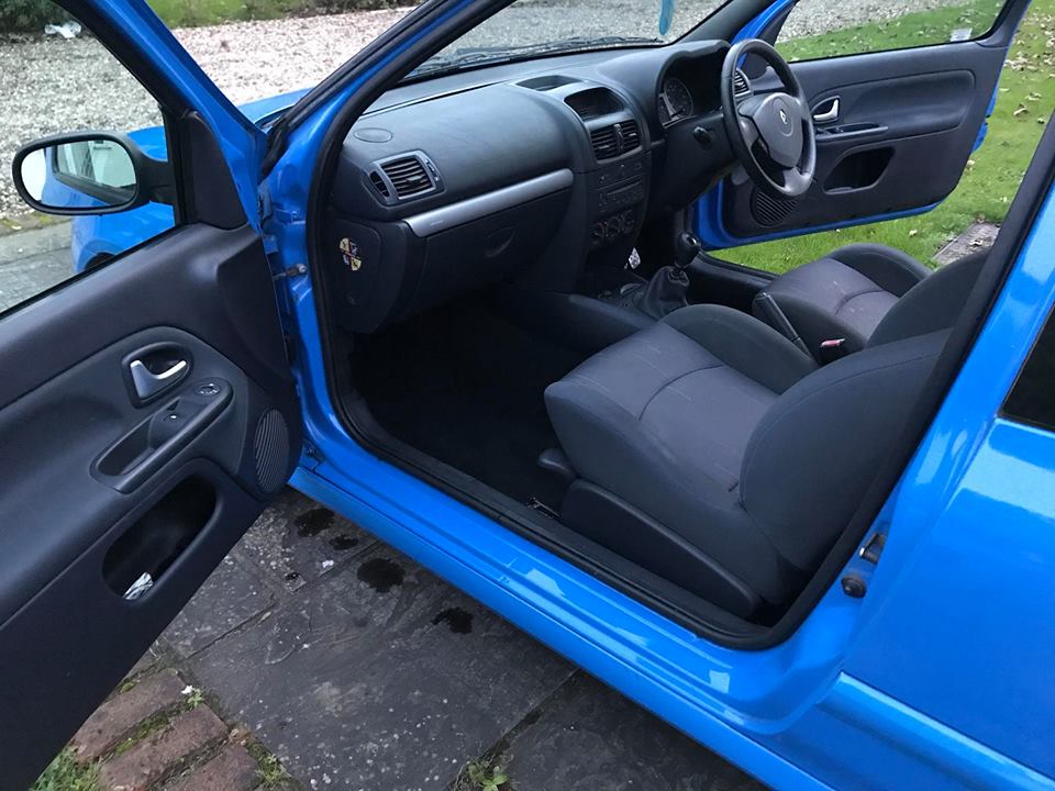

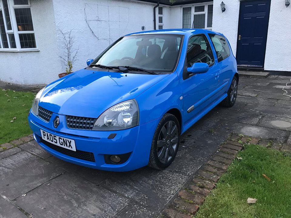

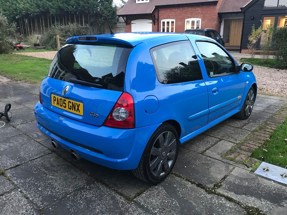

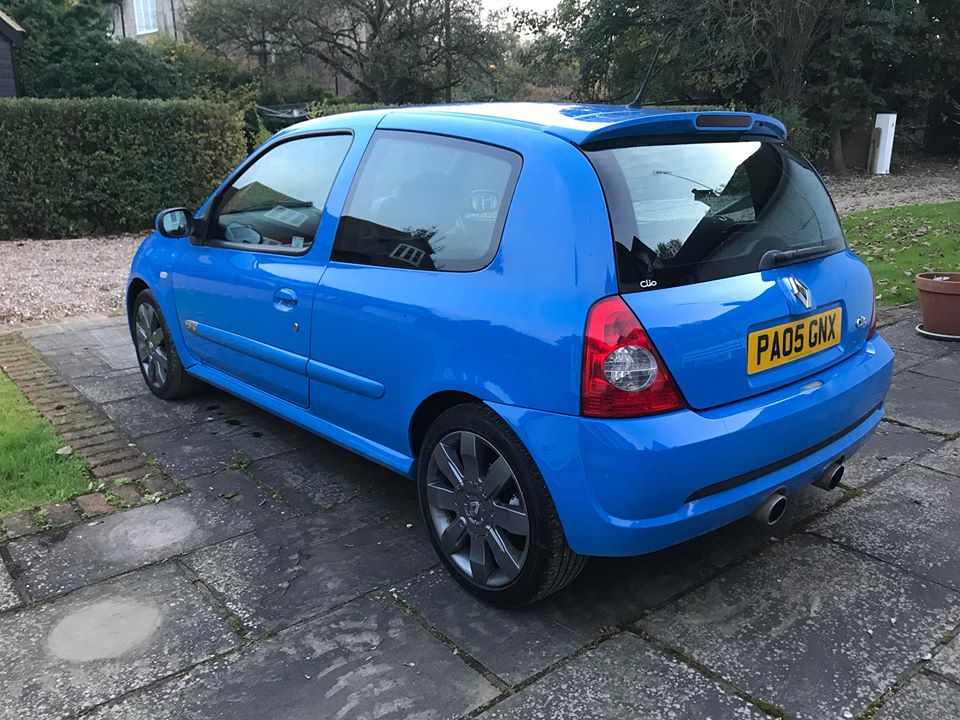

So after selling my last clio, I have cheap bangers to drive around in so I could save for a house, but have missed driving around in a clio! Over the last couple of months I have beeen looking for another Clio but this time it had to be either a 172 cup or a 182 cup in racing blue. Last week I spotted on faceaids marketplace a car that ticked all the boxes and after finally getting hold of the seller, we agreed a price and the deal was done.
So the car is completely standard apart from the molten exhaust, has had belt and dephaser done and has 94k on the clock.
The plans at the mo are to renew the suspension with standard parts and so decent lowering springs, change the wheels to Turinis or 2118’s and update the sound system
I’m sure at some stage engine tweaks will be done but for now I’m just going to give her a proper clean and enjoy!

Bet it looks great in the flesh. I would renew the N/S fog lamp, ditch the Clio stick on the rear window?!, get a genuine/replica of the Cup splitter itself and just go from there or leave it and keep it well looked after mate.
Also the sill kick plates missing? Not sure if I prefer with or without tbh?

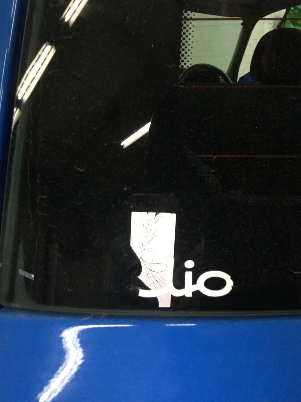

Bloody iPad, miltek exhaust ha ha. Clio sticker is going tomorrow as it’s already doing my head in. I am also looking for a cup splitter or Skoda one and a pair of front fogs.

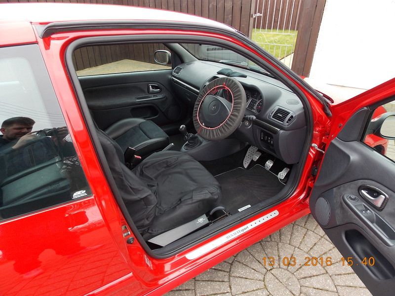

Here’s my car on Turinis :)

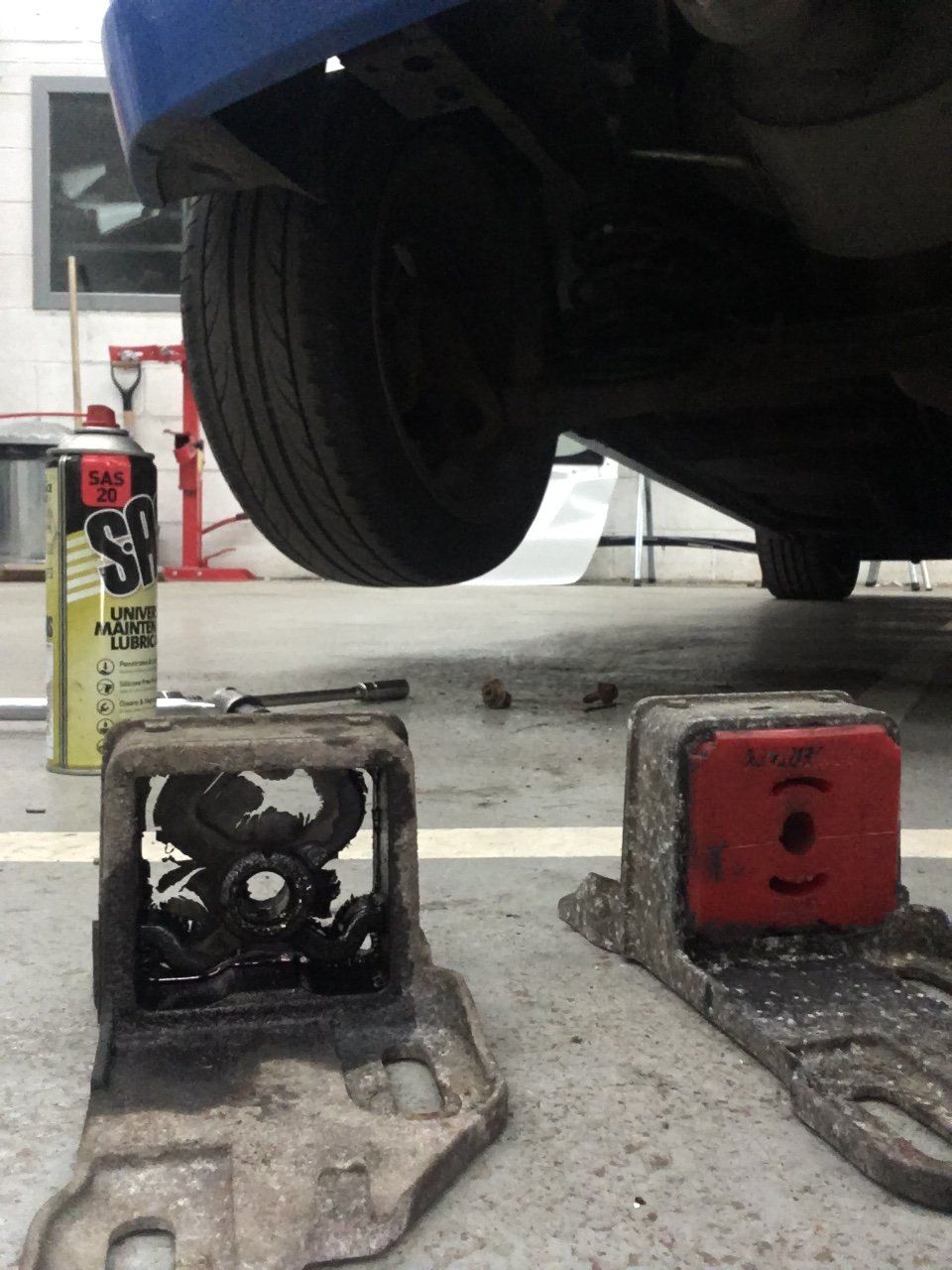

I removed the Clio sticker on the rear screen and replaced the rear exhaust mounts with poly bushed ones. Also fitted a Milltek de cat pipe which makes a nice difference in sound :)

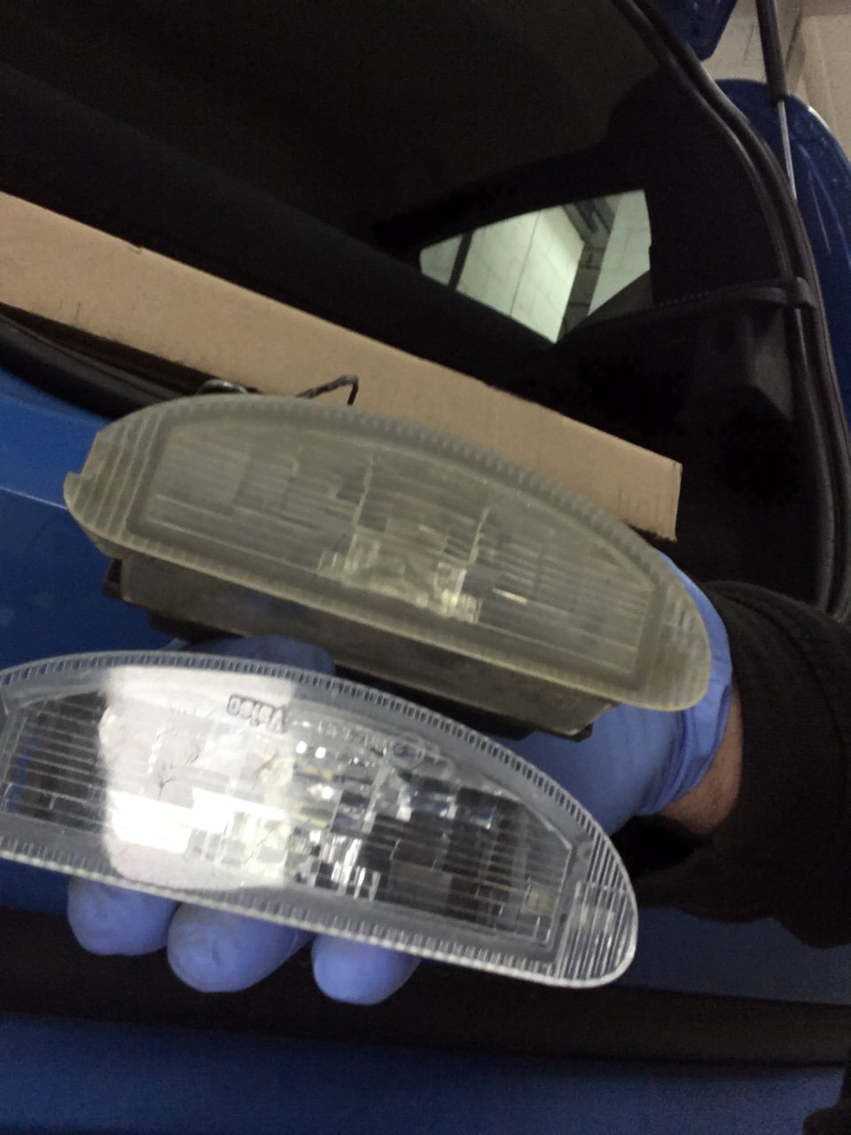

Rear number plate light look tired and old, so new led bulb and holder, makes so much difference ( it’s the little things that make the big differences)

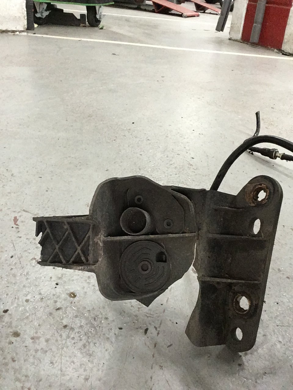

Engine management light was on, so plugged it in to find carbon canister was at fault, checked the carbon canister and there wasn’t much left of it and the plug was not connected, so bye bye canister, plug connected back up, reset trouble code and hey presto, no engine light, well for now at least!

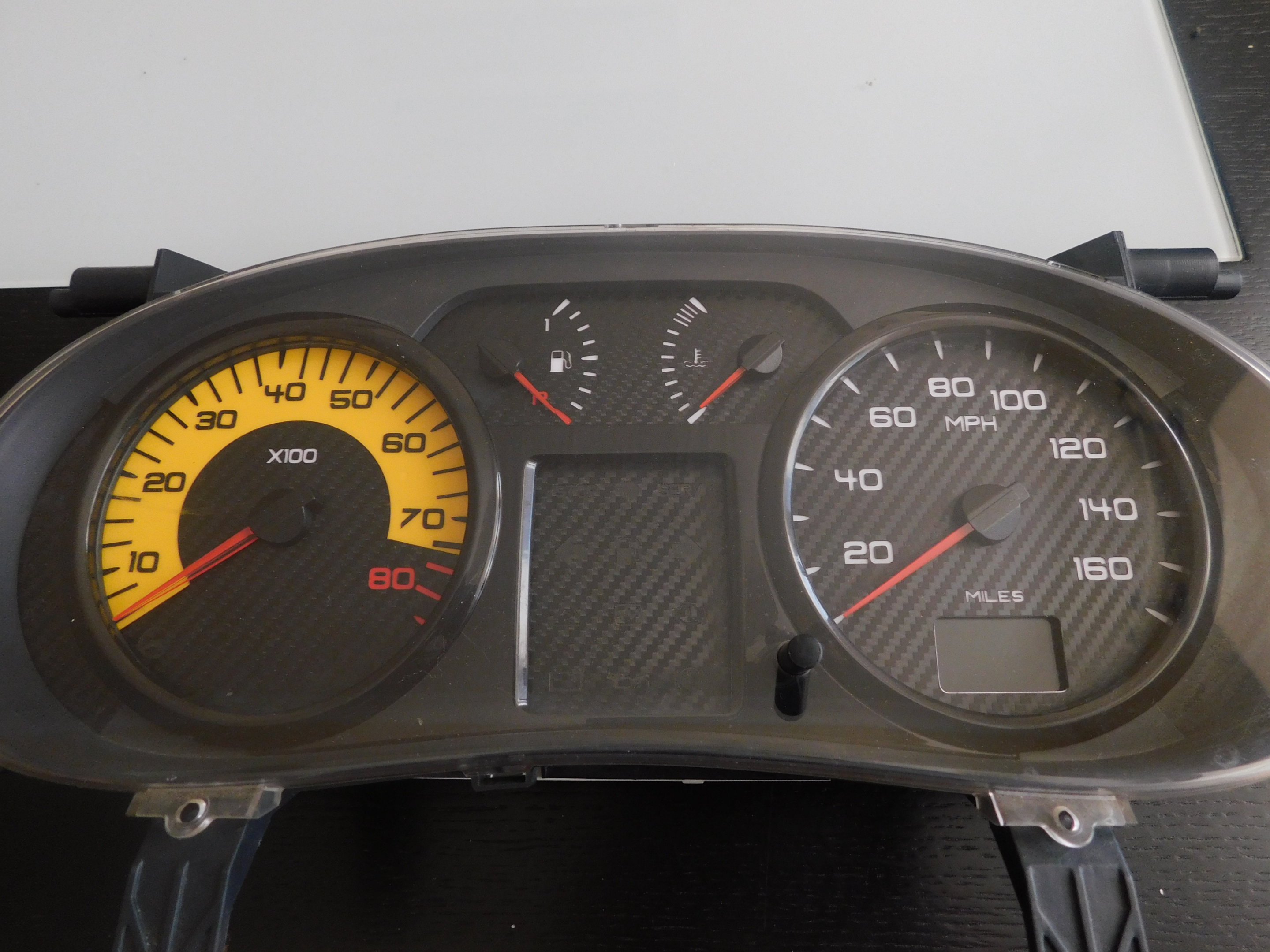

I found on Facebook a company who make custom dials and decided that I’d get some made, whilst waiting for them to arrive, I painted the dial surrounds. Now all fitted, I think it looks awesome.

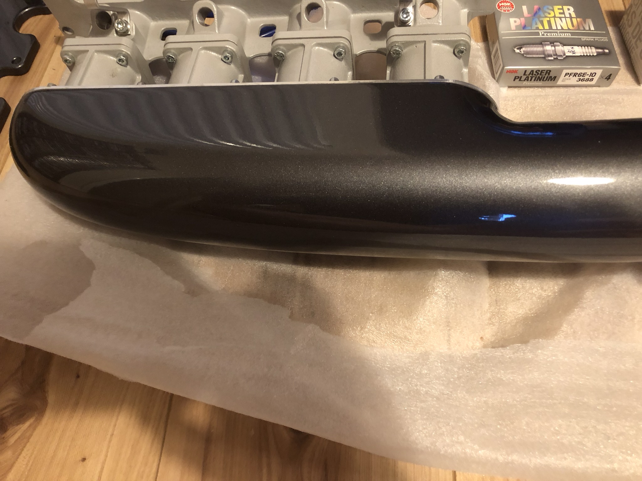

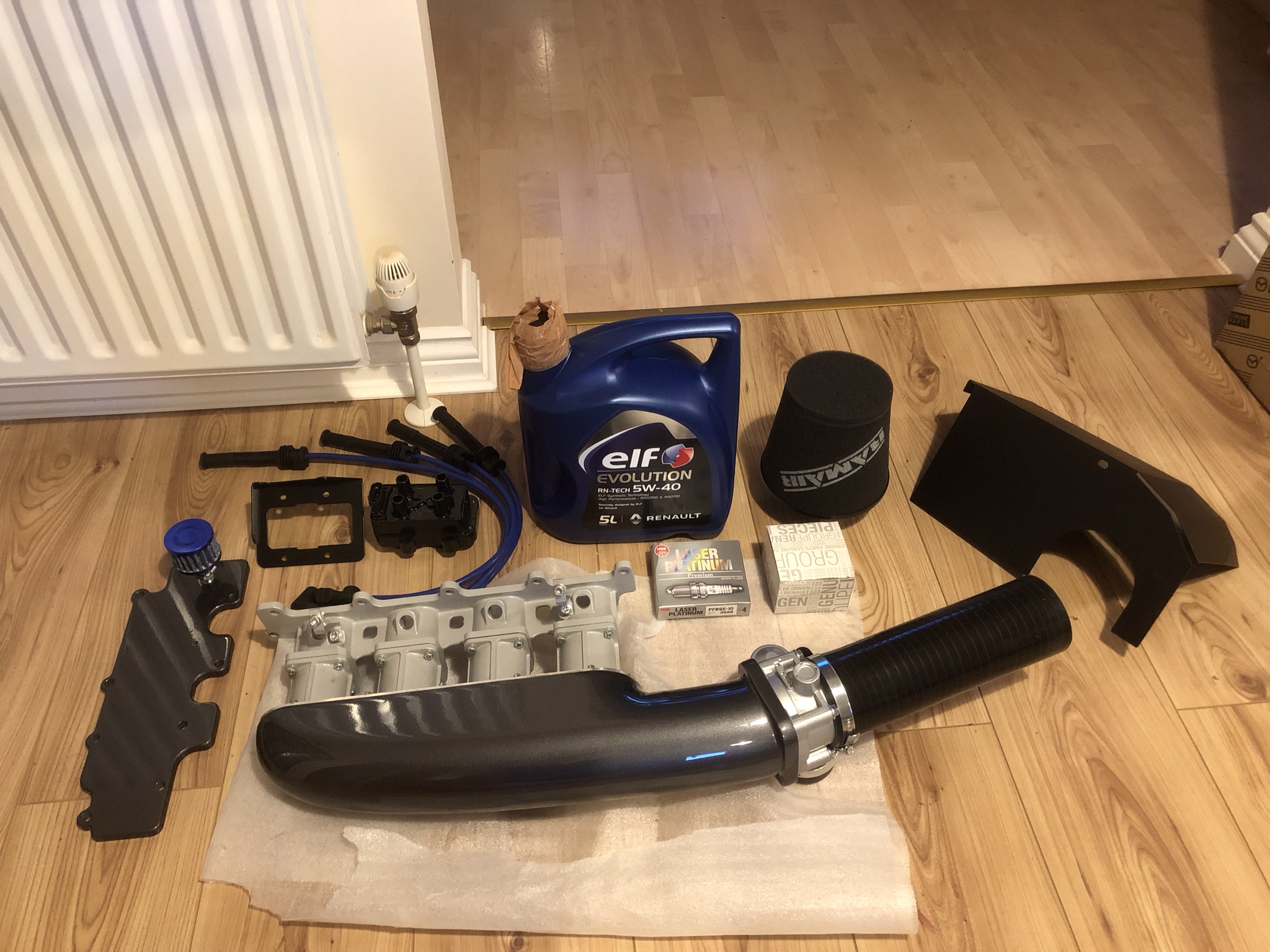

Final bit for today, I have purchased a cup alternator set up, epas conversion, Tessa inlet ( which I’ve tweaked and painted ) new coil pack and pms coil relocation bracket, genuine oil and filter, new leads and plugs, a Marc b battery cover, ram air filter ,polybushed dogbone mount, reinforced wishbones with polybushes and a mk1 Renault traffic alternator bracket ;)

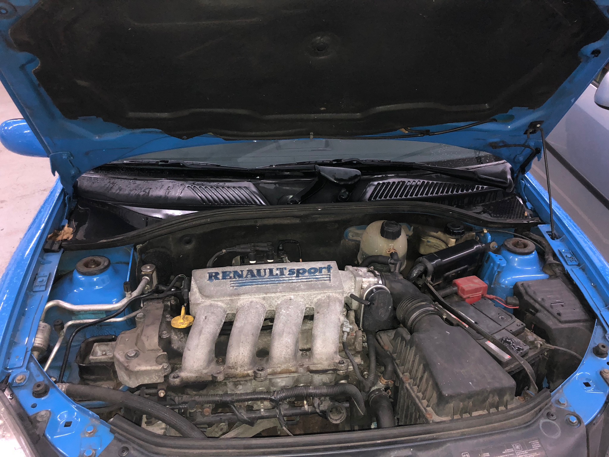

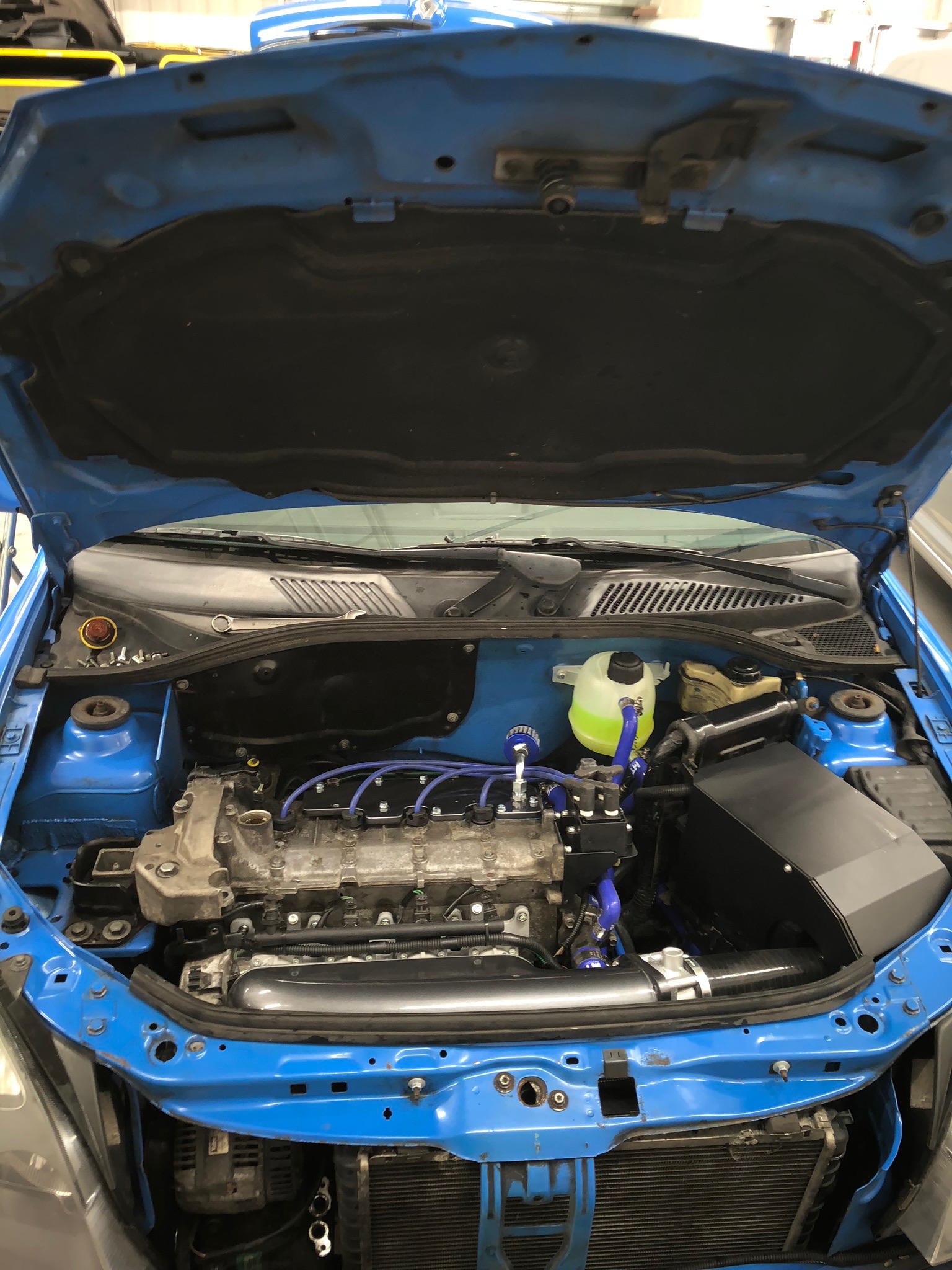

So spent yesterday doing a sevice, inc oil,filter, new plugs, leads,coil pack, expansion bottle, coolant, map sensor and oil pressure sensor (because I’m heavy handed and broke them both) I also fitted a polybushed dog bone,mount and engine mount, Marc b battery cover,new blue leads, blue coolant pipes and a coil relocation bracket oh and my newly painted inlet :smile: All went well until I realised I didn’t have the correct breather plate (correct one on route) so had to use the original and block of the outlets and when it got started, I found I had an air leak, to which I haven’t found yet!! Guess what I’m doing over Easter weekend then!
In other news, my cup set up and most of my Epas set up finally arrived, so once I’ve got the car idling normally, I’ll crack on with that! Anyway before and after pictures because we love pictures

Nice work and engine bay looking clean now, huge improvement
