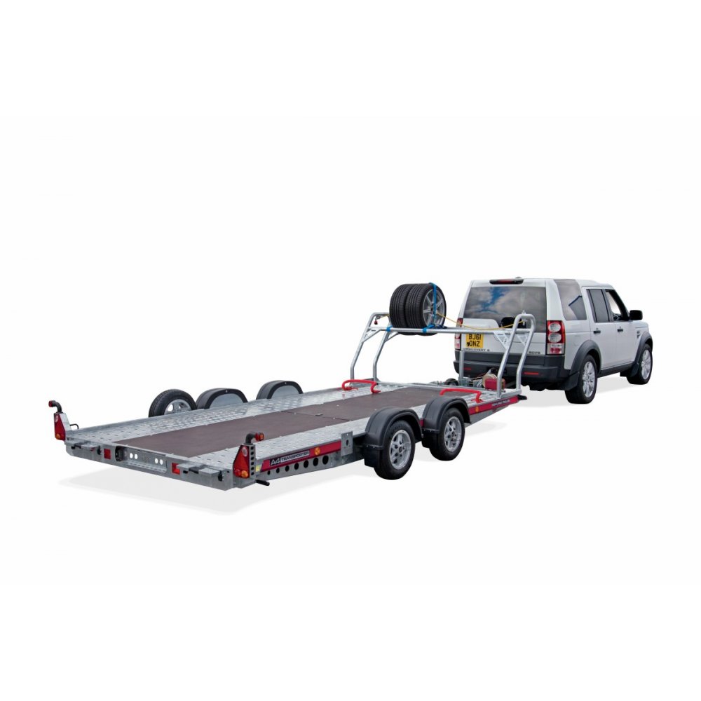

Off topic but... Just looking at trailers myself, looks good, did you go new? Any particular reason for this one over other makes?
2nd hand although I don't think there is much in it tbh we have agreed on £2200 and I think new without the extra's they're about £2700+£500 in extra's ( mine will be similar to the pic's below if it is as advertised when we get there), It was just a nice trailer with the extra's we were looking at and as it has the next to no sides just the low wheel arches it means the doors can open and hopefully we can fit some pretty low cars on it (my dad's R8 is pretty low if we ever wanted to trailer that) also the ramps slide into the body and not in the middle (if you know what I mean) and they also seem to hold their money very well, didn't have to be Brian James as we looked at Ifor Williams, Indespension, PRG and Woodford just to name a few.
Thanks, all very valid benefits, glad I asked, never thought about the walls and when height. I need to consider width so I can get it through a through garage for storage without having to modify walls/opening, that's probably going to limit me somewhat. Good luck, hope the purchase goes well.
