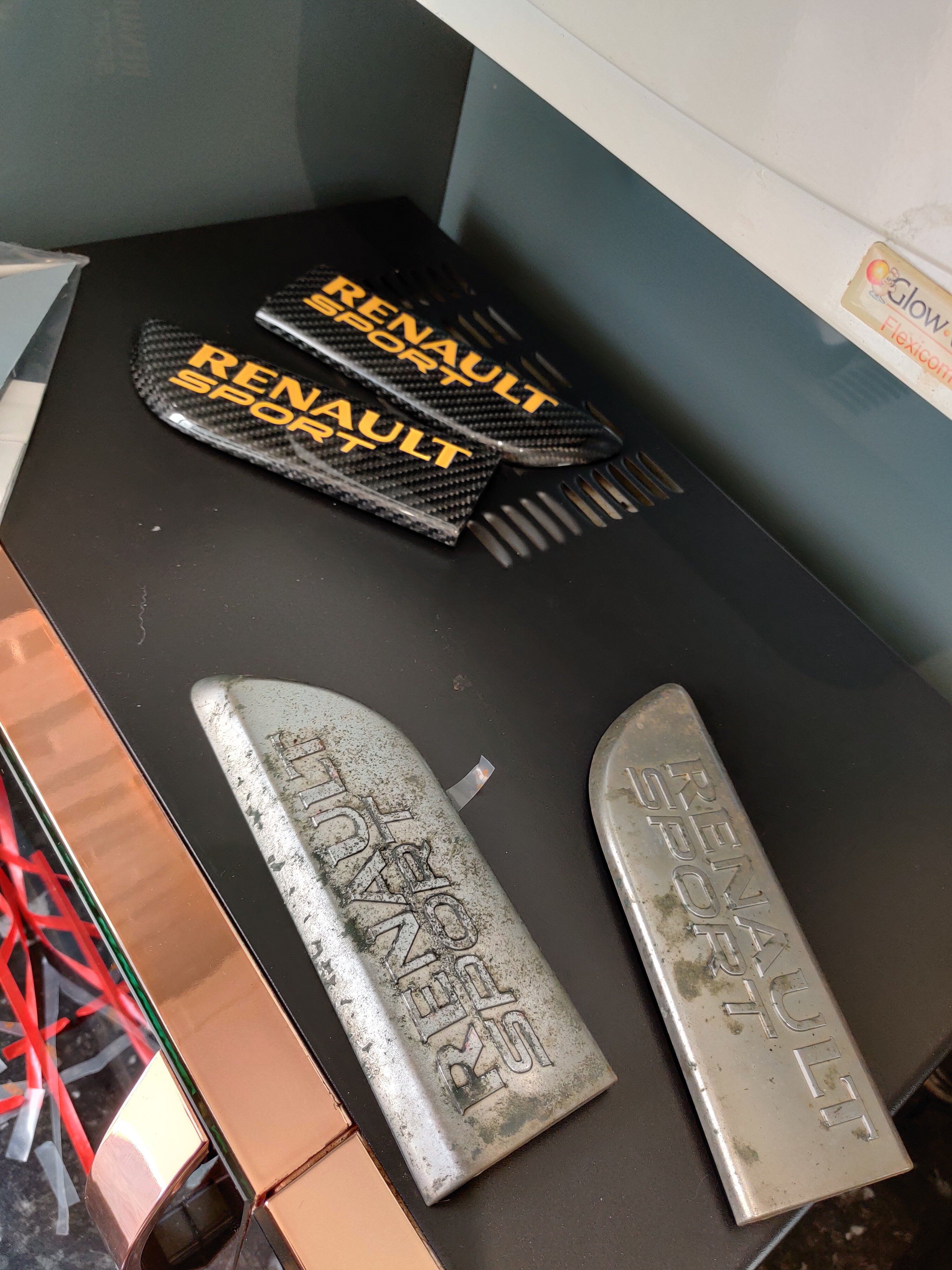

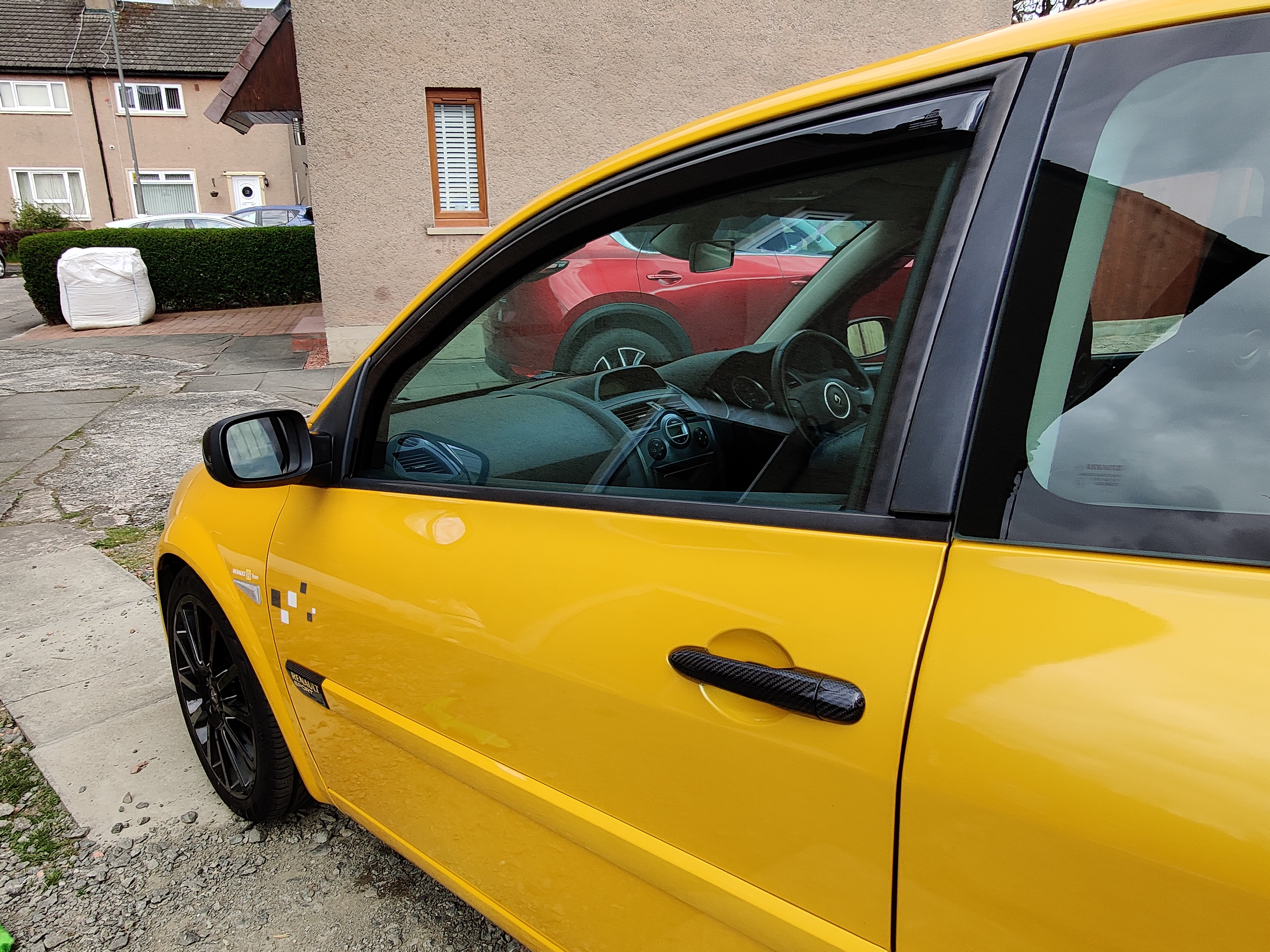

Finally got the plate onto the meg! Along with the carbon door handle covers and door bullets and a set of heckos

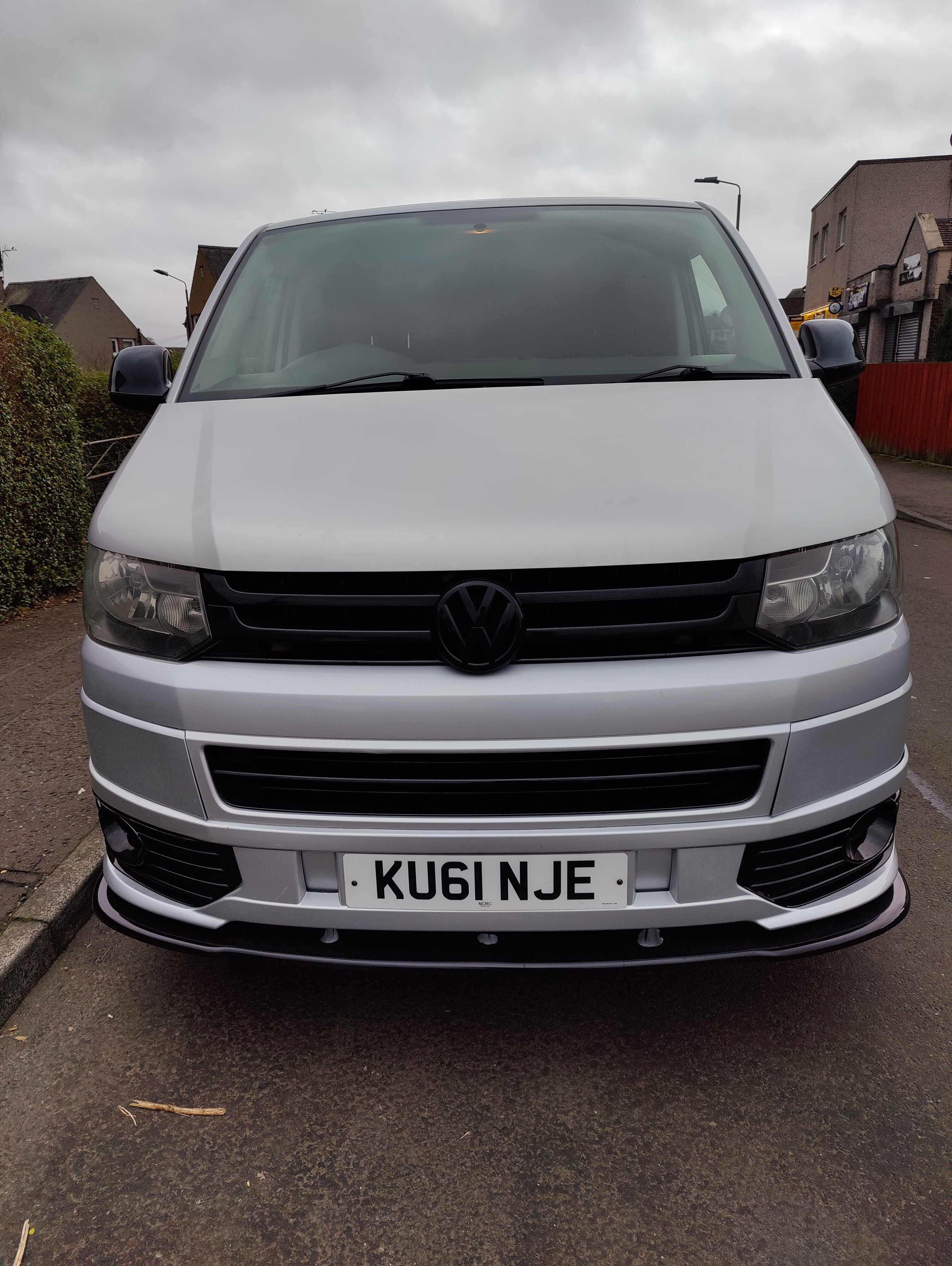

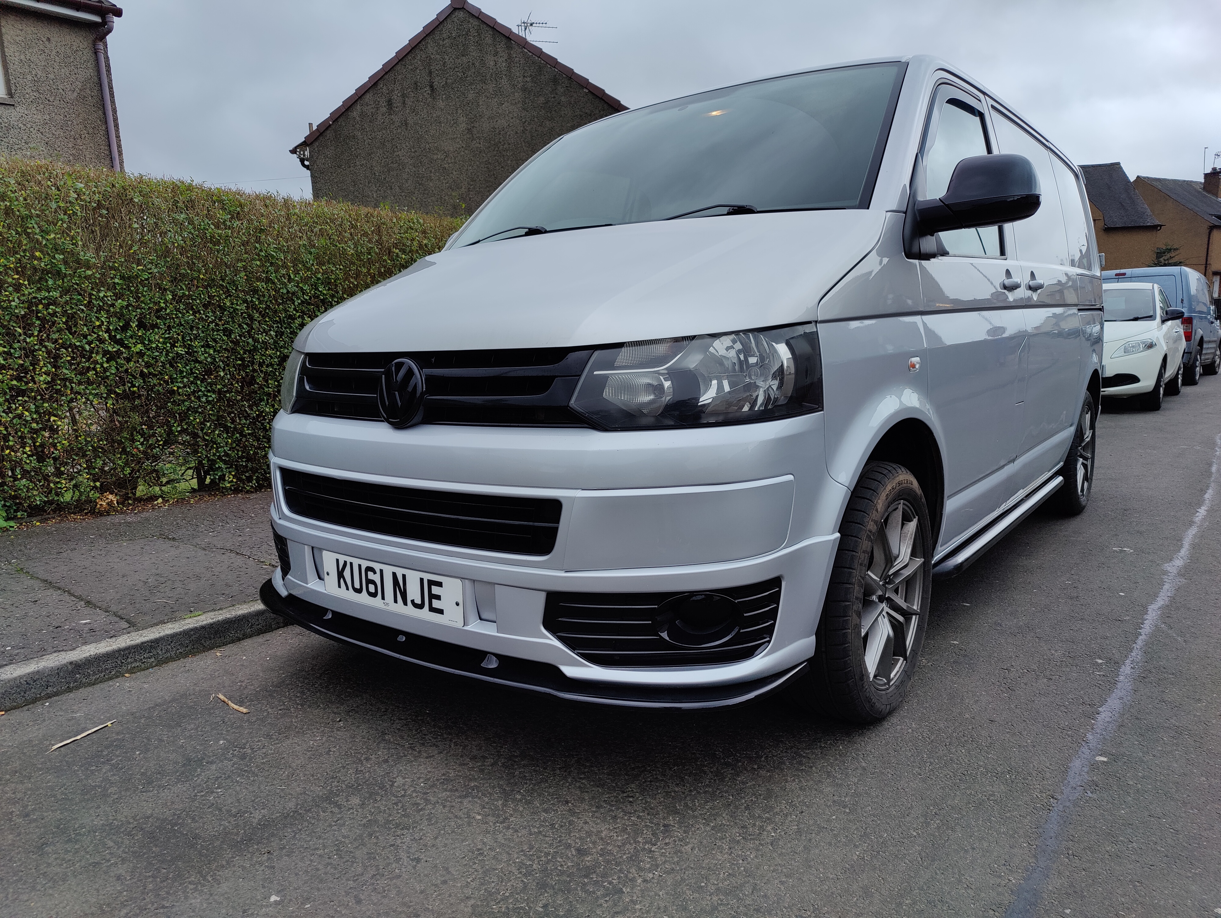

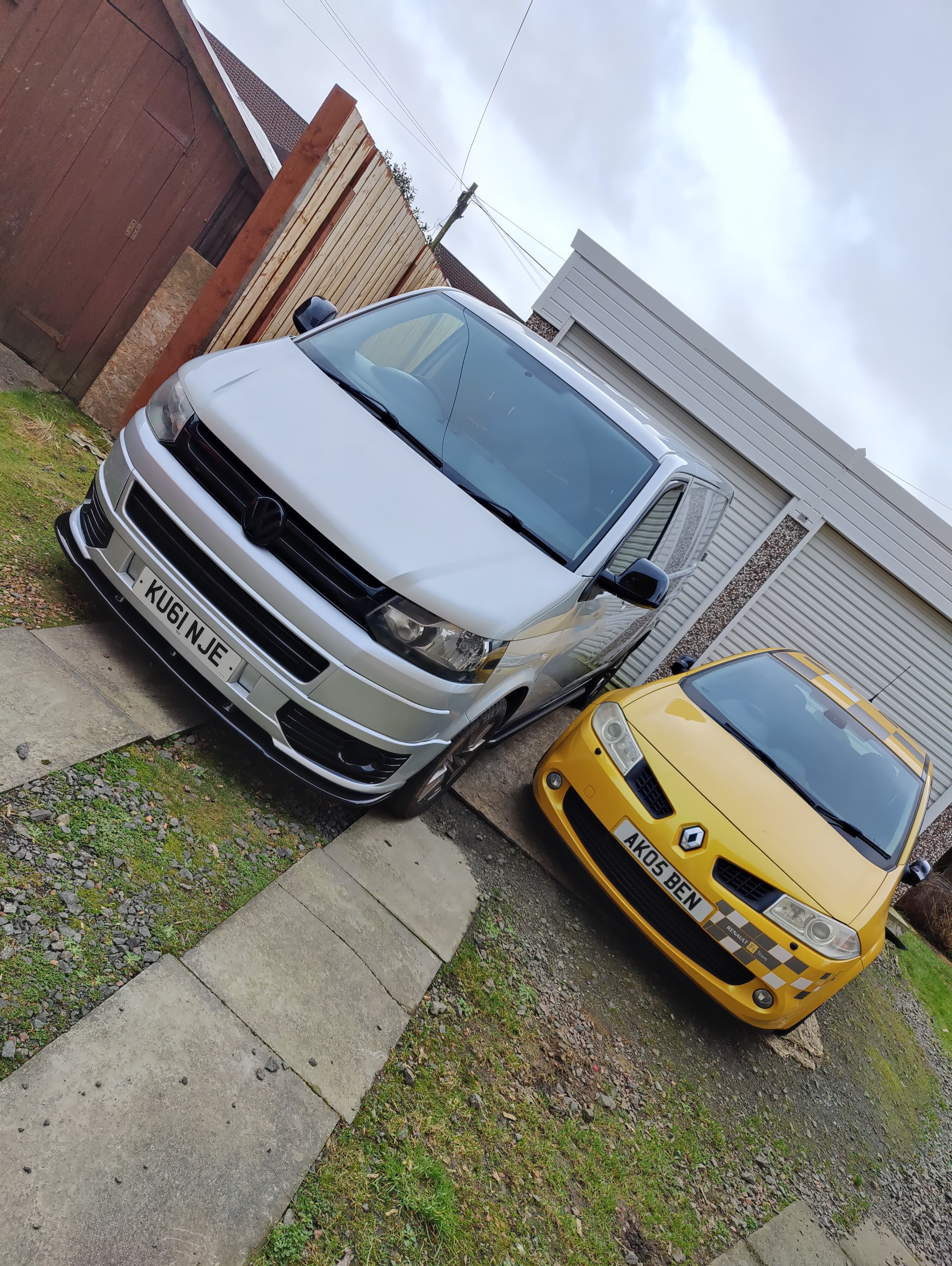

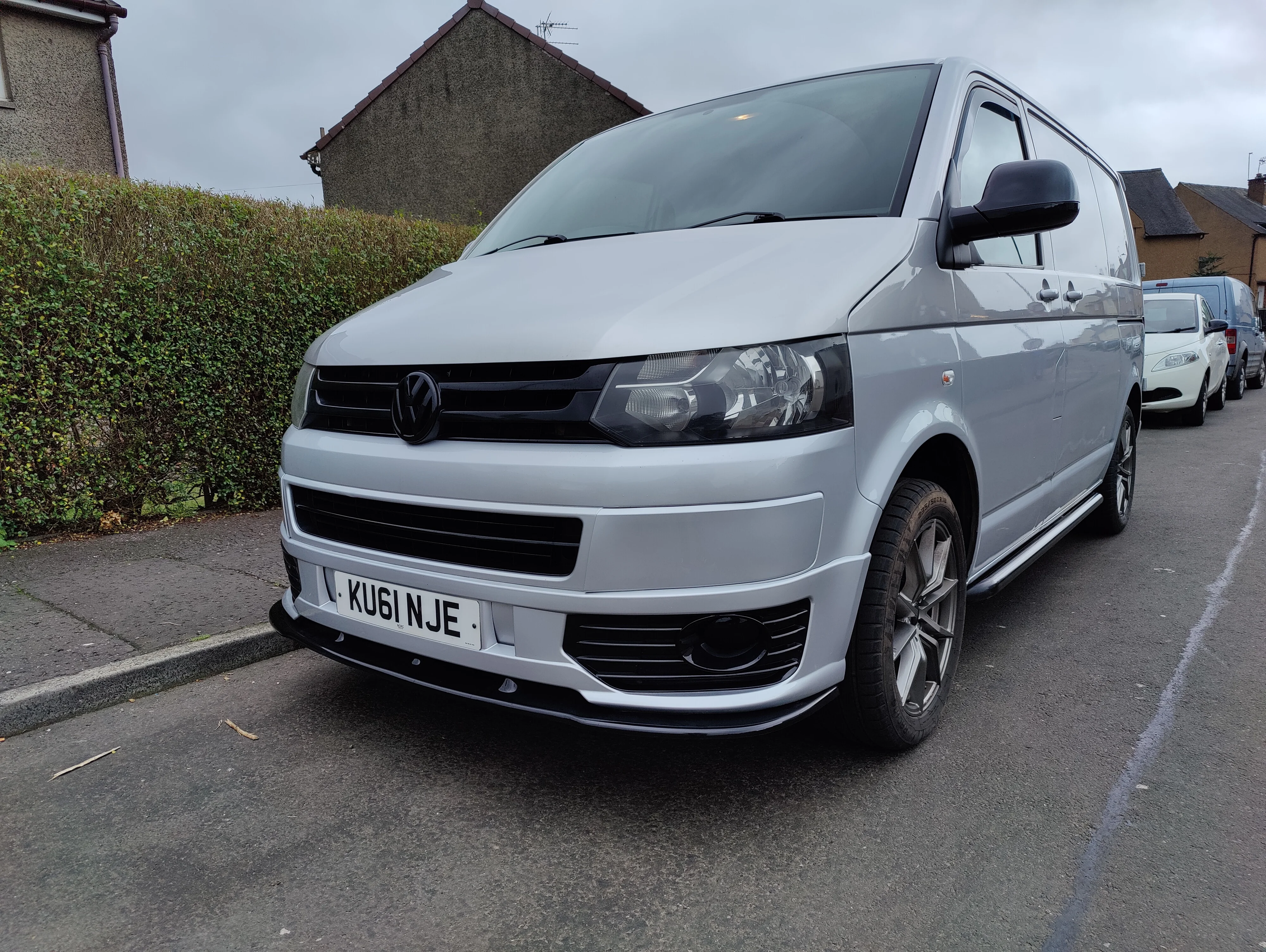

It's been replaced by this

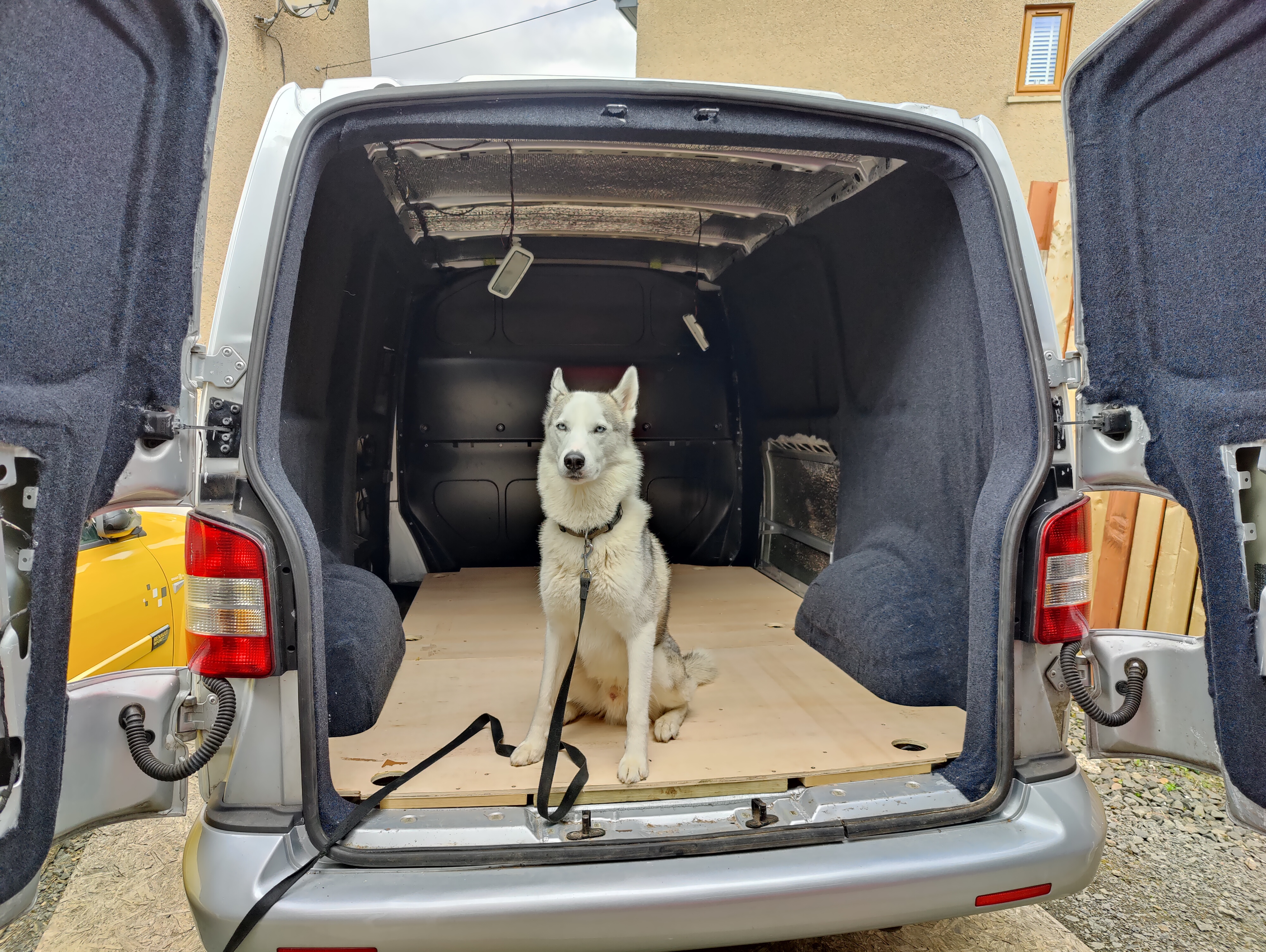

A t5.1 transporter which I picked up from Carlisle about 3 or 4 months ago now and I love it! It's a mild camper project for me and the Mrs to take the dog on excursions, I've carpeted the back ealls, lined the floor, fitted the new CNC cut floor, insulated and sound deadened it, I've got some more new trim panels to carpet and some downlights to fit to the roof and itl be good enough for it's first weekend away
I also got a towbar fitted to it the other day so that I can now borrow a trailer of various buddies and use the t5 as a track support vehicle

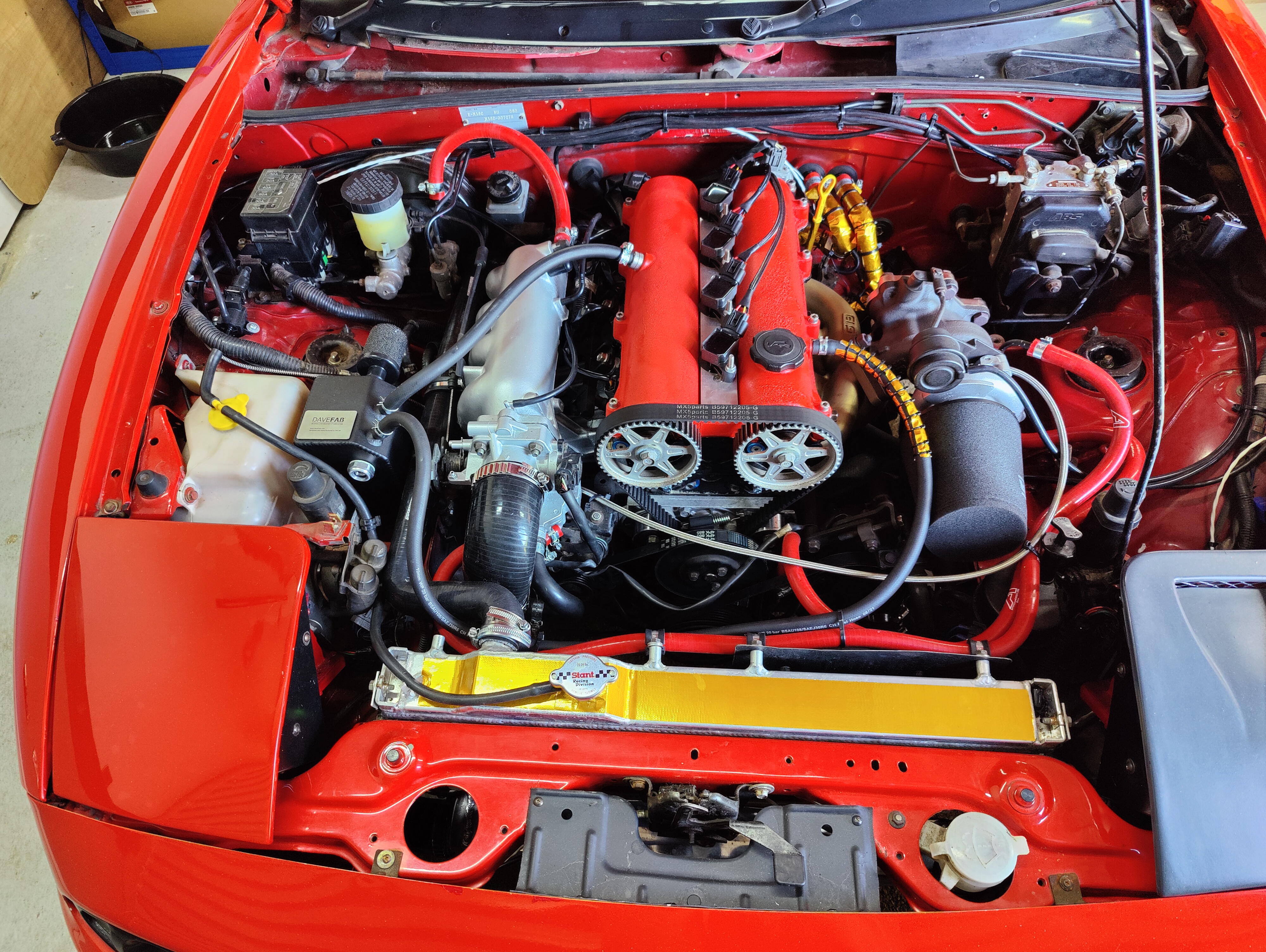

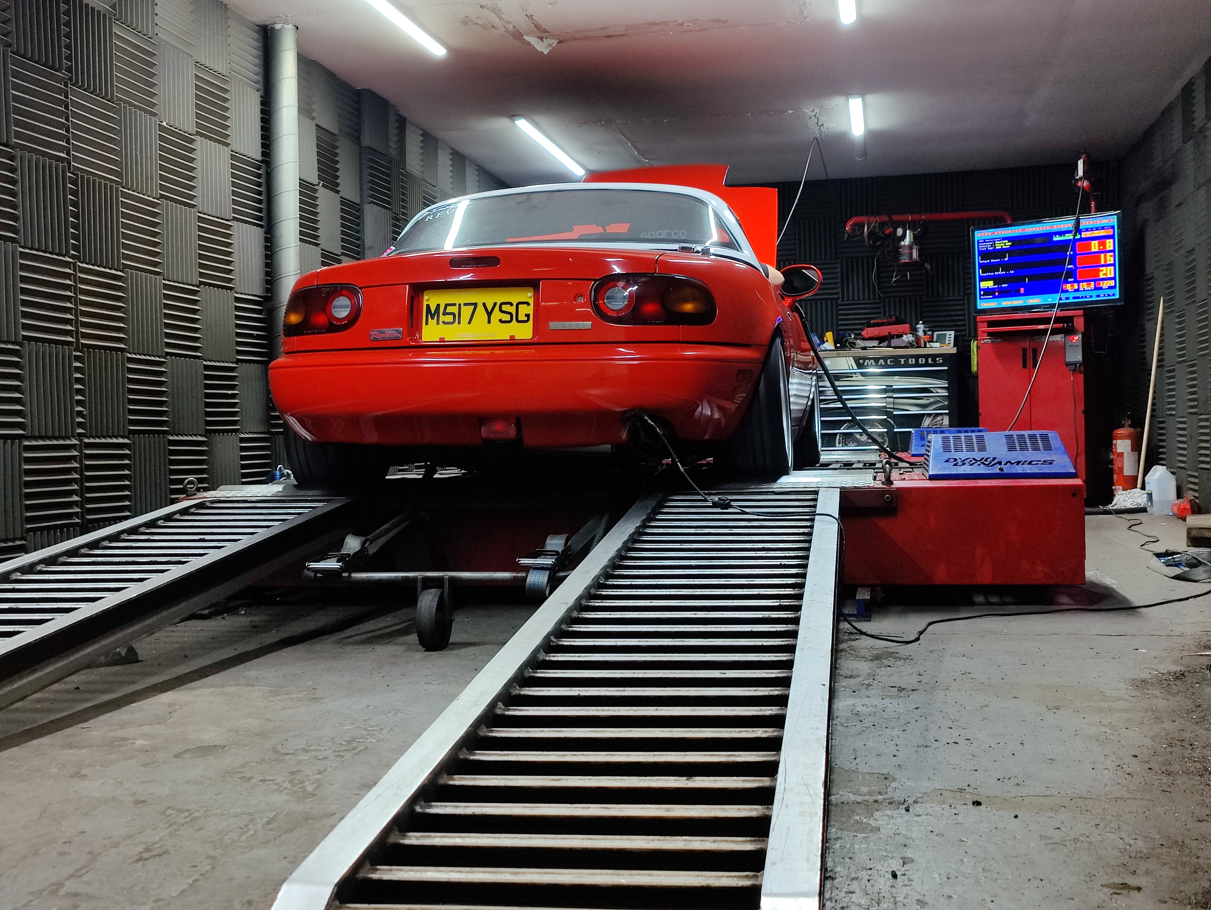

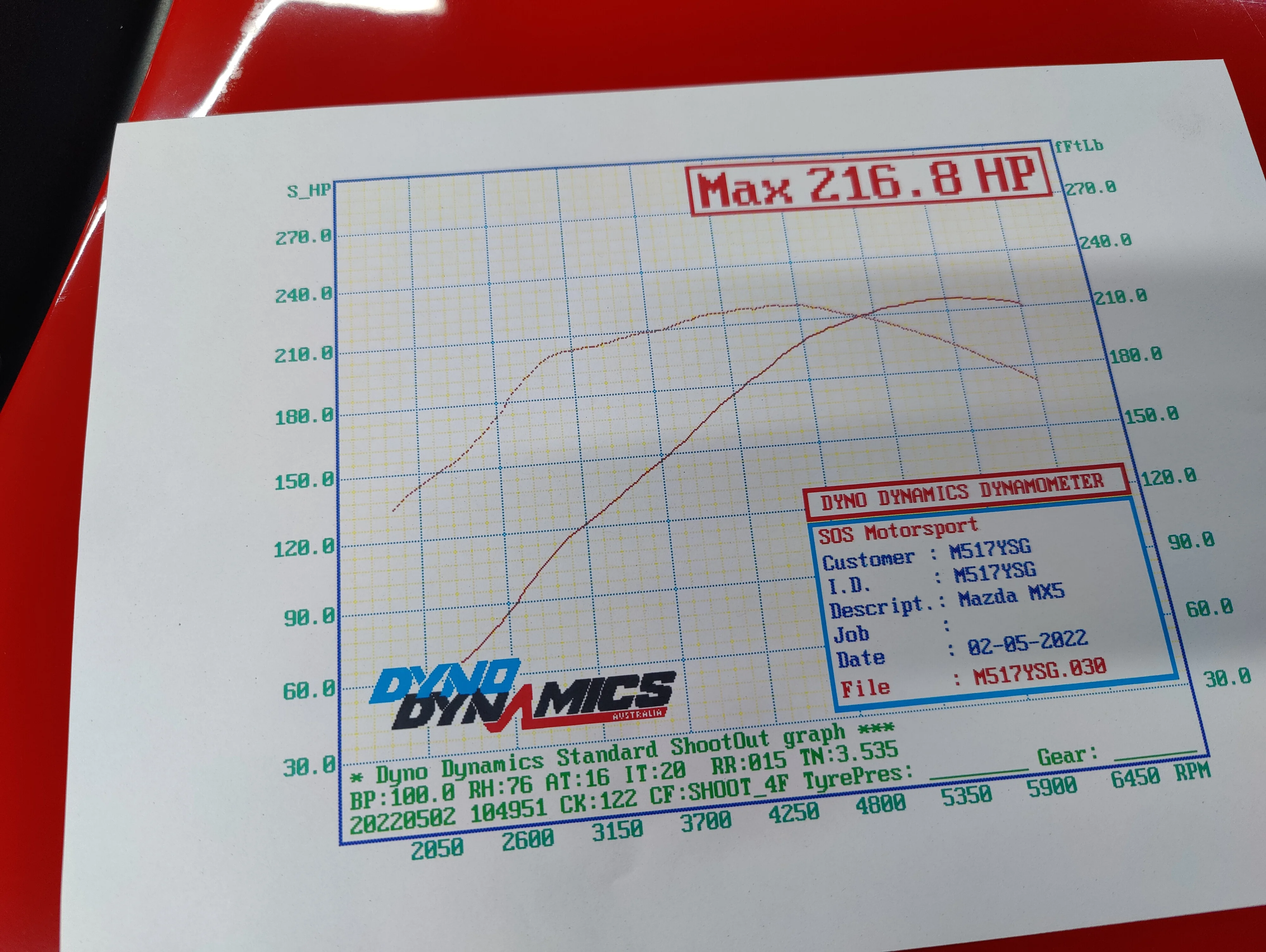

The mx5 turbo build has been completed and mapped.
It made 216.8hp and ~220ish lb ft at 0.8 bar then the clutch started slipping, after being a bit disheartened at the figures it felt absolutely f**king amazing to drive and it certainly feels fast.
I have a badboy 6puck clutch to go in and then I'll go back for more boost and the 230/40hp figure I originally set out. I'll be keeping it as is for csf and changing the clutch out afterwards
Absolutely loving the mx5, it's been a long time coming to get it this far but it's all been worth it, new discs and pads on the way for it and a rollbar which I've now been waiting a month and a half for, then an alignment and it's ready to be dragged down to Blyton by the silver bus!

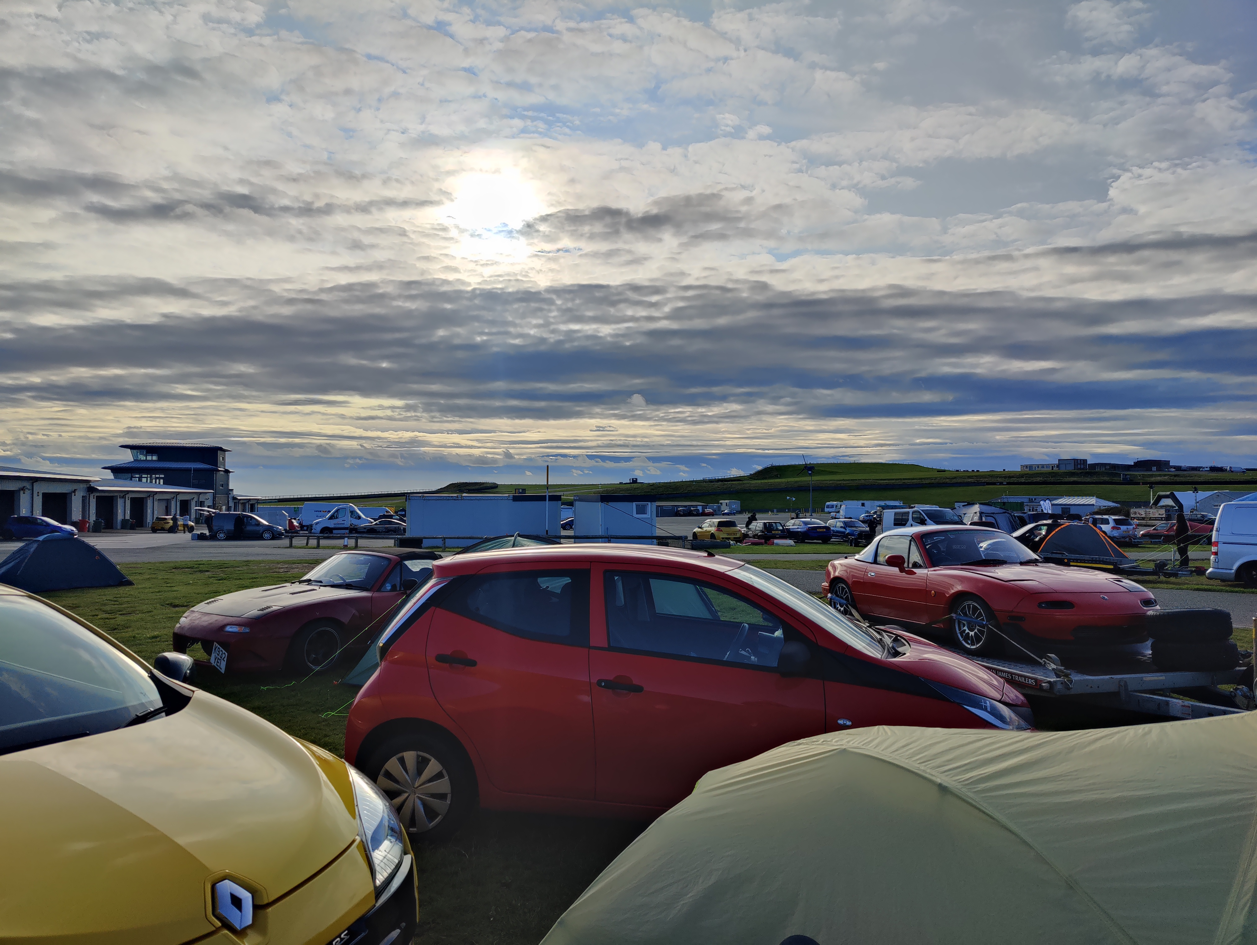

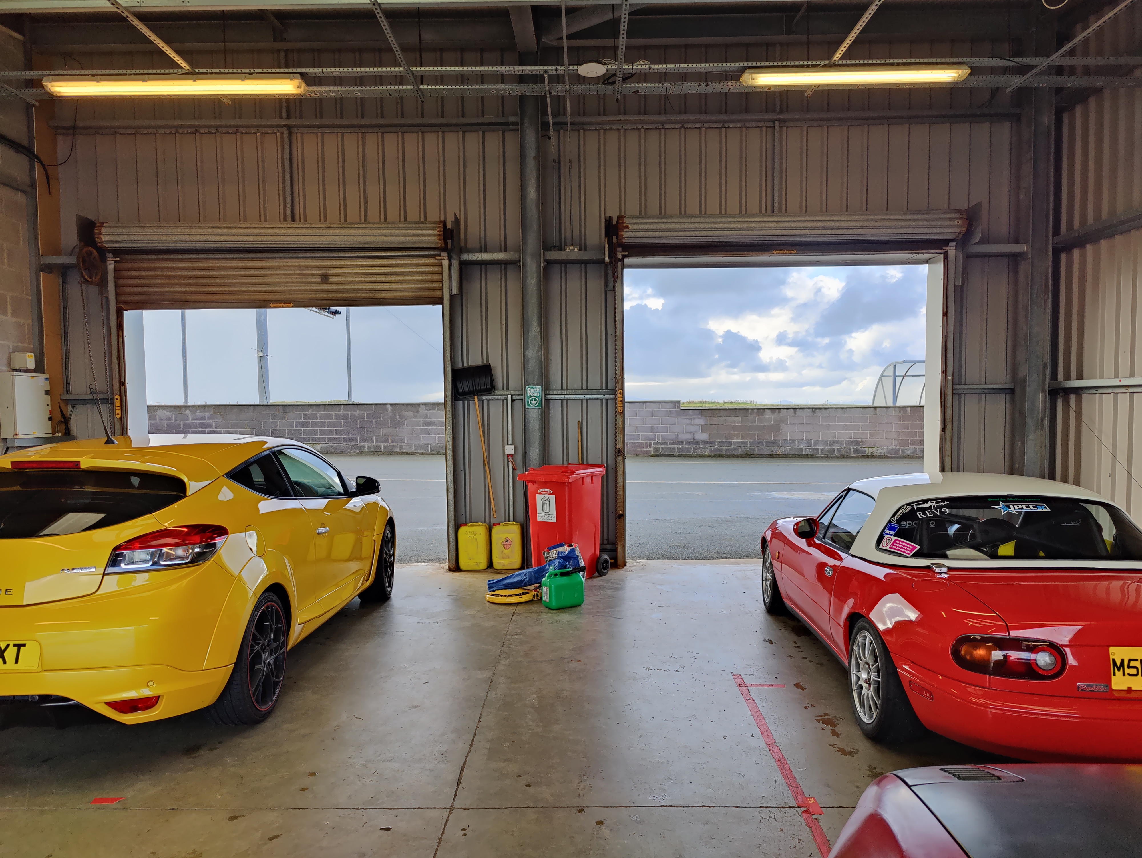

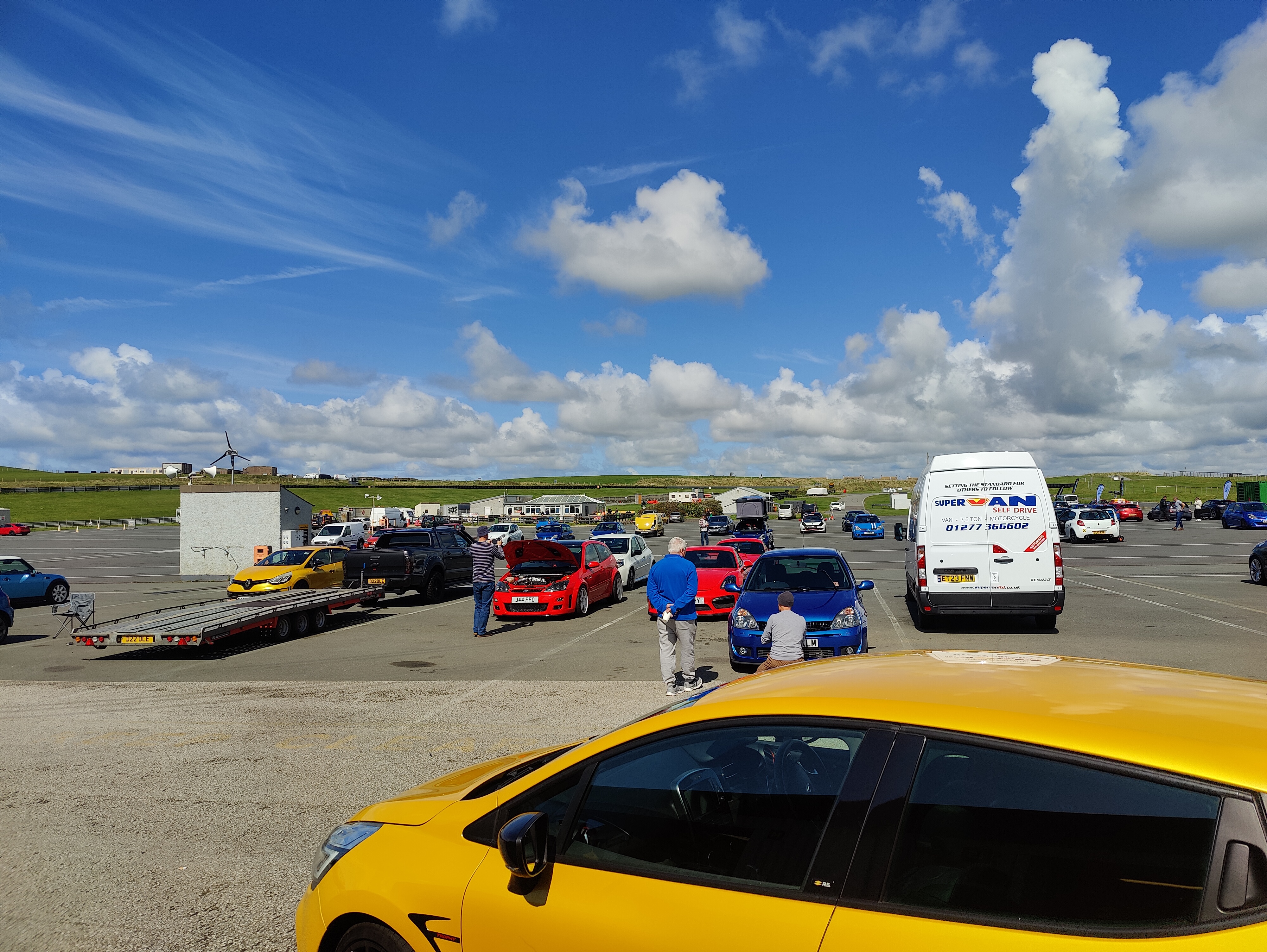

Just back in the door from unloading the trailer etc, I'd like to thank everyone for allowing my s**t box Mazda to csf23, what an incredible time! Anglesey was excellent and the mx5 done well. The van however... Thatl need a clutch for next year and it decided to burst it's egr cooler about 5 minutes from the house. I'll deal with that later, time for a lie down!

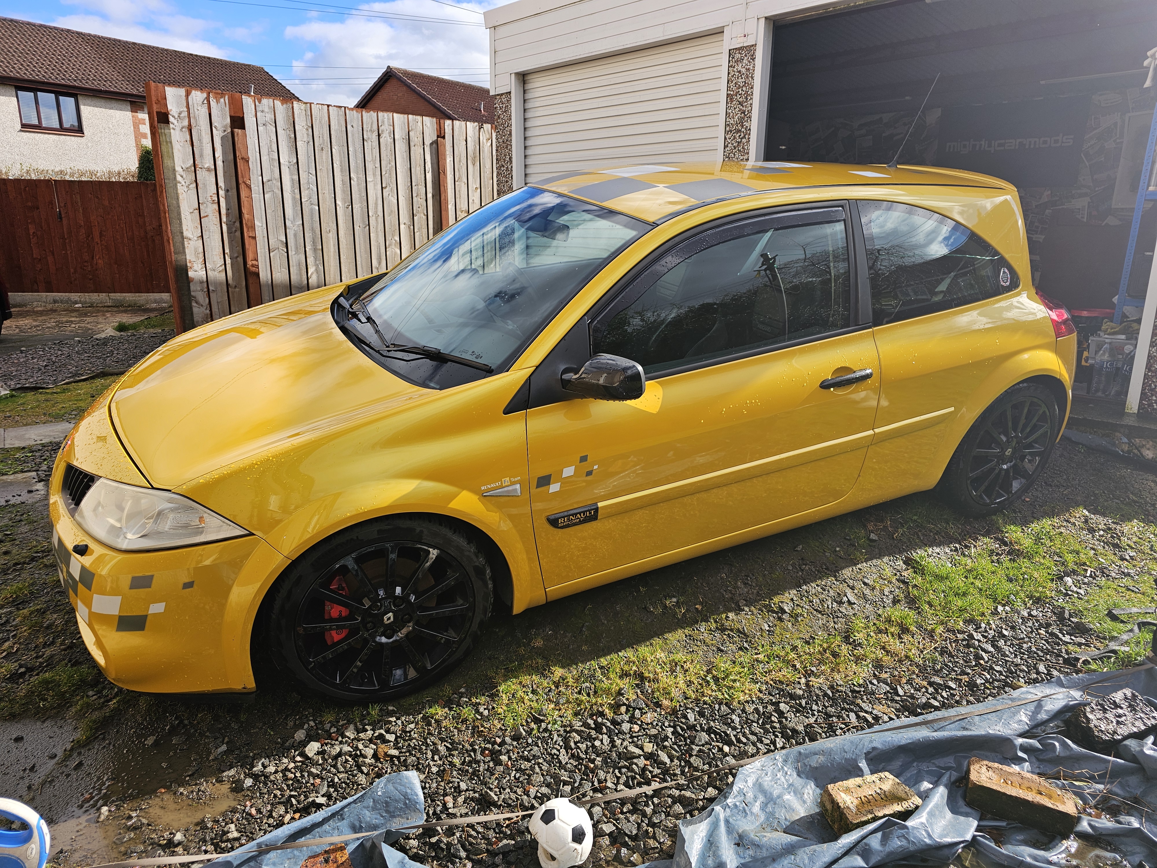

Megane passed its mot and after a boost solenoid, a brake hose and some tax it's back on the road, it's rather nice to be in compared to the van although it is quite vibratey inside
So I've ordered up a new set of engine mounts and I'll replace those on my week off.
Quite enjoying it
benji93
  ph2 182, mk1 mx5

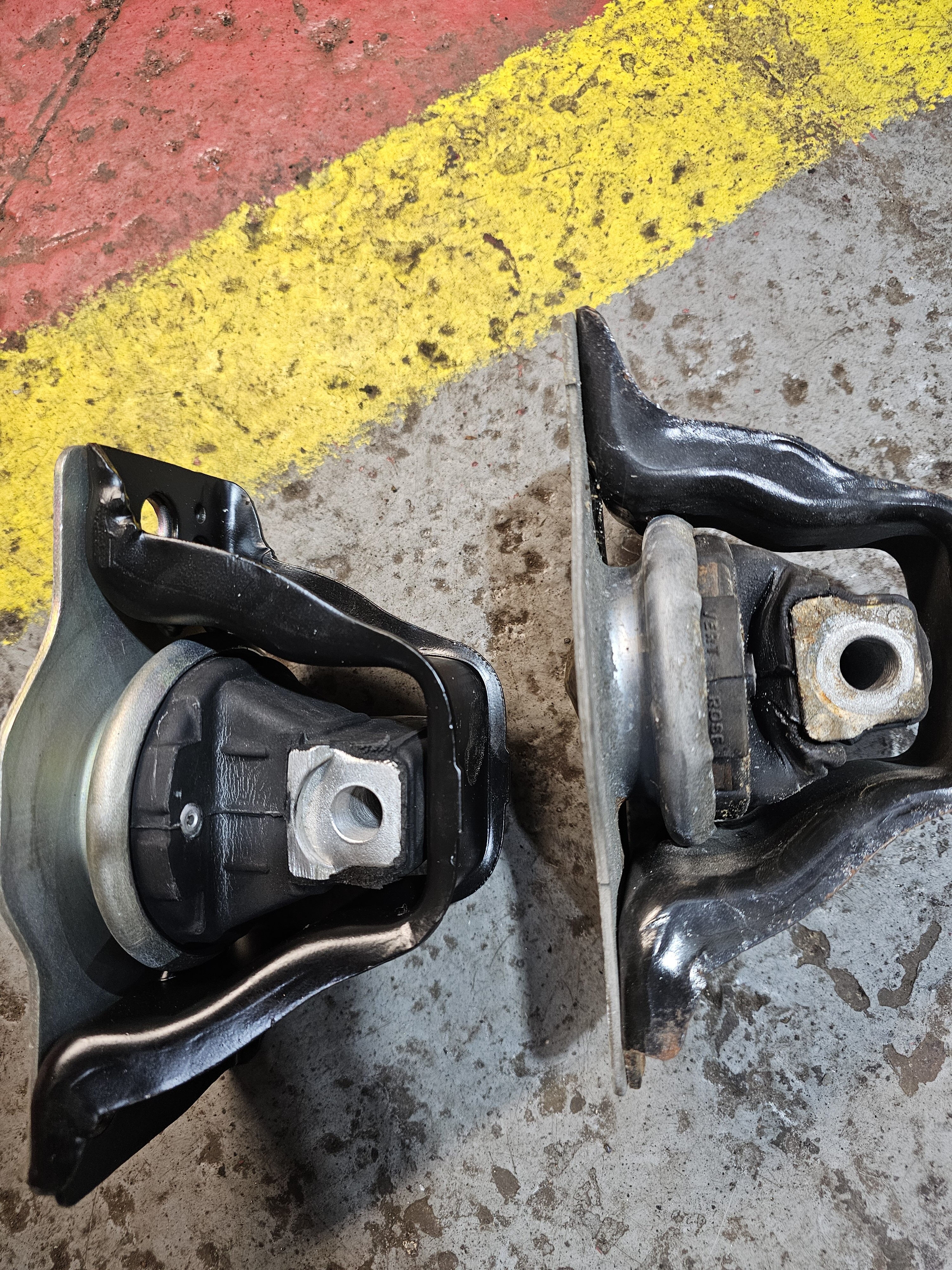

Changed all of the engine mounts in the megane, what a difference, the vibration on revs was quite horrible and it's nice and smooth now
Drivers side mount and torque link mount were totally humped, pass side wasn't bad but probably on its way out from the other side being so bad and the bottom mount seemed fine but changed it anyways since there was a new one there
Stuck a new boot button on a sit was a bit floppy and a cheap fix, then realised it's missing the light in the boot so I'll try find one of those nice and cheap
Had a quick alignment done aswell and now it's excellent to drive, a good machine Polish and touching up some stonechips and it's pretty much ready to go
