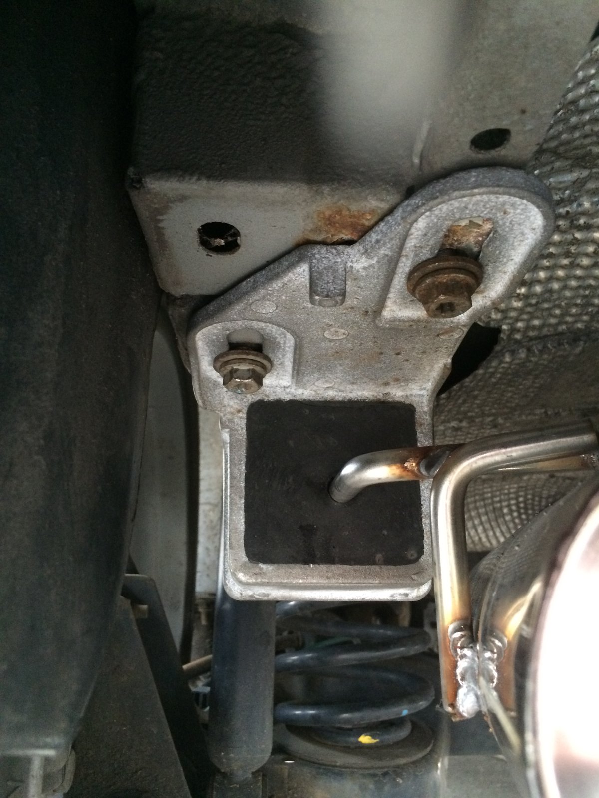

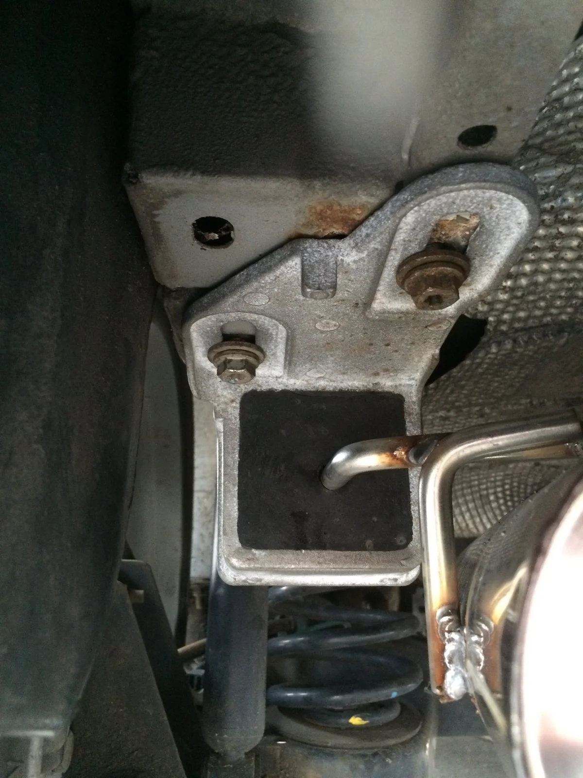

I just wondered what exhaust mount everyone was using for their stealth systems please, as mine isn't very stealthy at the minute!
The exhaust mount has collapsed but looks like a standard one (maybe cheap after market), is the solid competition mount a better buy as this doesn't have the rubbish holes all around it like a standard mount, or will a genuine renault mount be ok?
Any info much appreciated

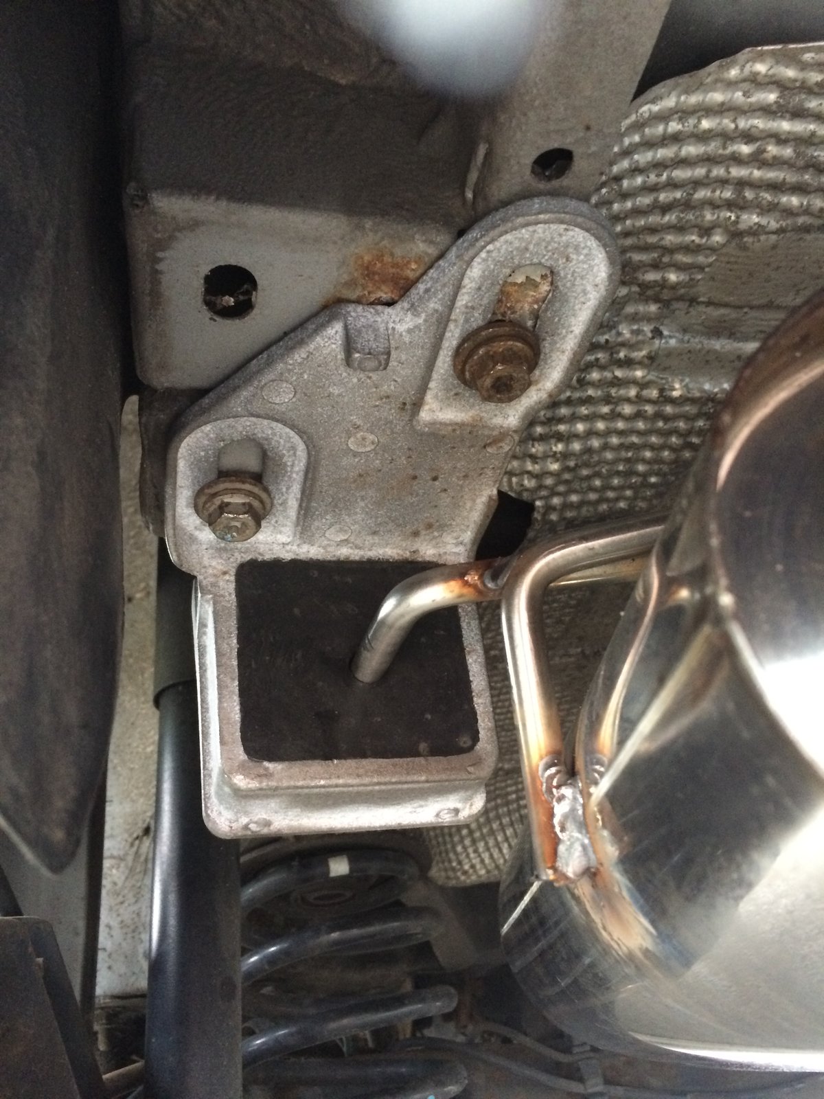

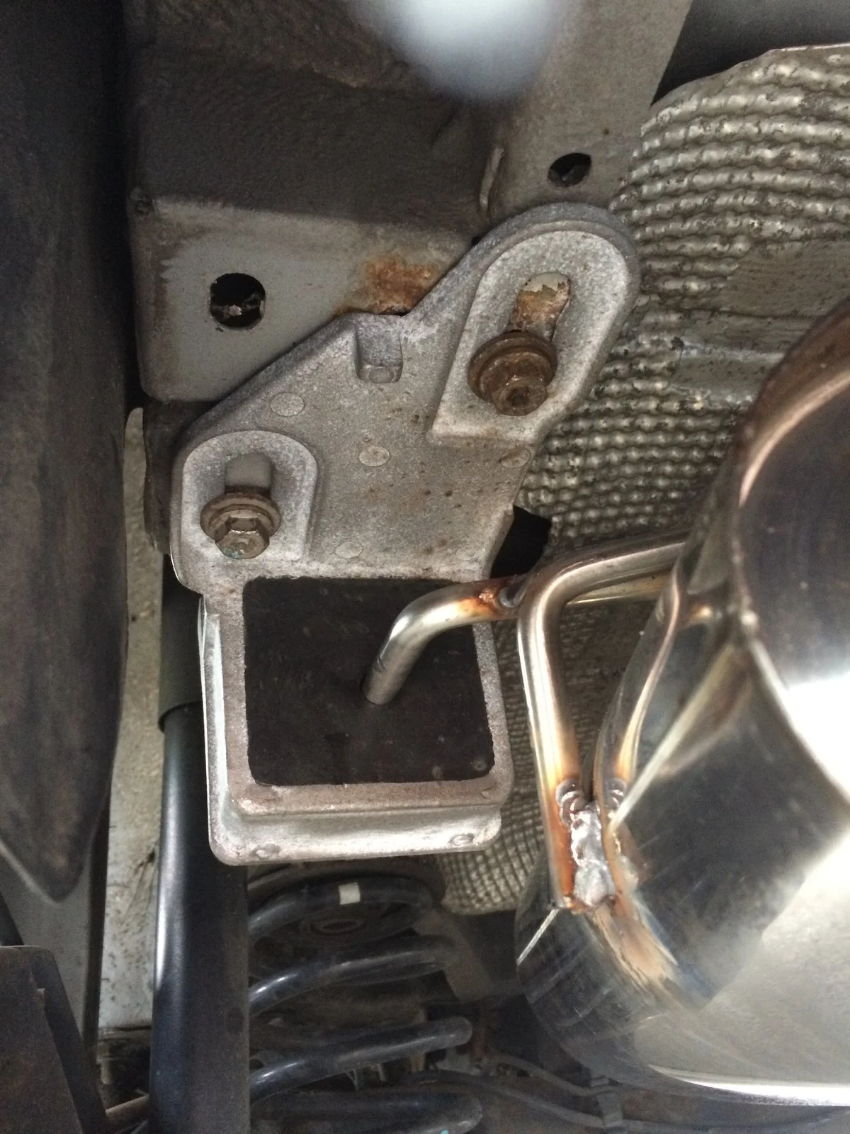

I ordered one of your mounts the other day, had confirmation it's been posted, will be fitted on sat when stainless exhaust is fitted, will add some photos when it's installed
All fitted and I'm very impressed, a huge improvement over standard, no more sagging and moving exhaust. Cheers levaz
