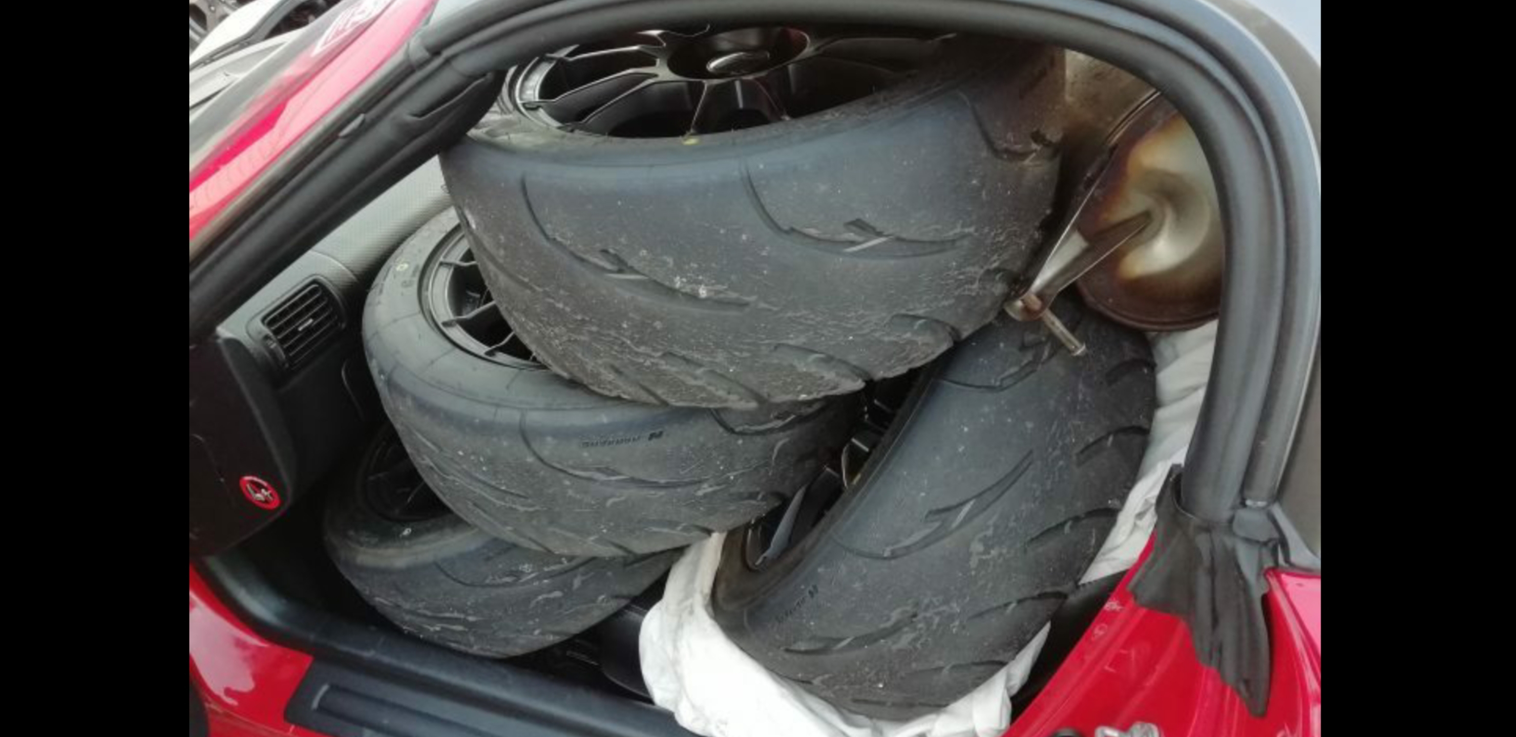

With my AR1's now shot, i'm in need of some more semi-slicks. I currently have the overkill of 3 sets of wheels and have to rely on others to carry an extra set to track.
One set for wets and road with Rainsport 5's, which are only good for very wet conditions, for road they really lack and sort of feedback and really don't inspire confidence for fast road use.
Another with AR1's for damp/drying track and summer road use, but as these are now down to illegal thread depths I have to resort to the RS5's for the road. Plus they are really poor in wet conditions.
And lastly a set with full slicks, which in this countries climate rarely get used.
So I'm looking to drop down to just one set of wheels with an all-round semi slick.

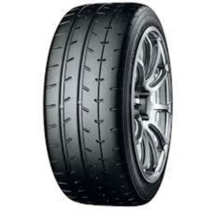

I'm drawn towards the Yokohama A052 given there excellent wet weather properties, just not sure if they will cut it on a hot, dry track?
Anyone got any other recommendations? They have to be in 15" sizes too.

A052s are incredible.
Up there with 03Gs for outright dry grip and piss all over them in the cold and wet. Even seen people say they are quicker than the Dunlop but not seen any proof.
Downside is they wear like mad, Rears were dead in 2.5k and fronts managed 4k, granted that was with 3 knockhill evenings included

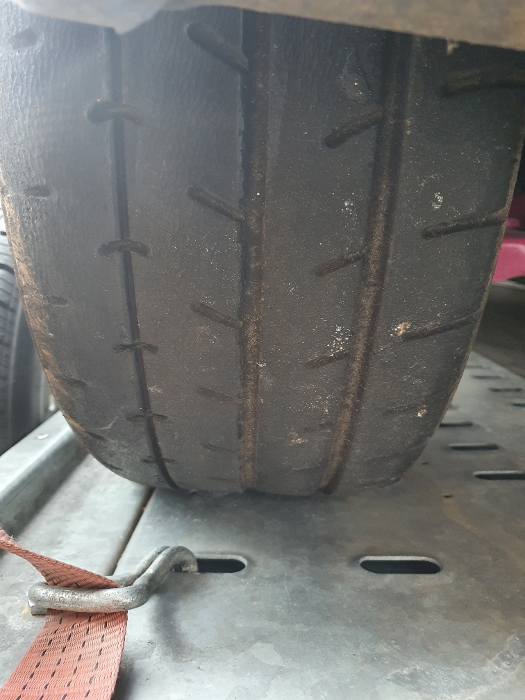

Used twice only. 1 at a wet/damp Cadwell morning and dryish afternoon. I was doing 1:49 laps and 1 Donnington Gp day which was wet morning dry afternoon doing 1:54 laps. A052 are on another level to R888r and A048s, which were the tyres i used to use. The picture here is the nearside front which i have rotated to the rear as it does show signs that they will wear quick. But i do drive it pretty hard. Still playing with pressures though.

Maybe more negative camber needed? Looks like its leaning at lot on the outside shoulder.

Its already at neg 3. Id say it was more down to running a bit low on pressure as it was wet and cold. I should have bumped it up a couple of psi. I was running 28 hot. Could have done with being 30/32. [emoji2357]

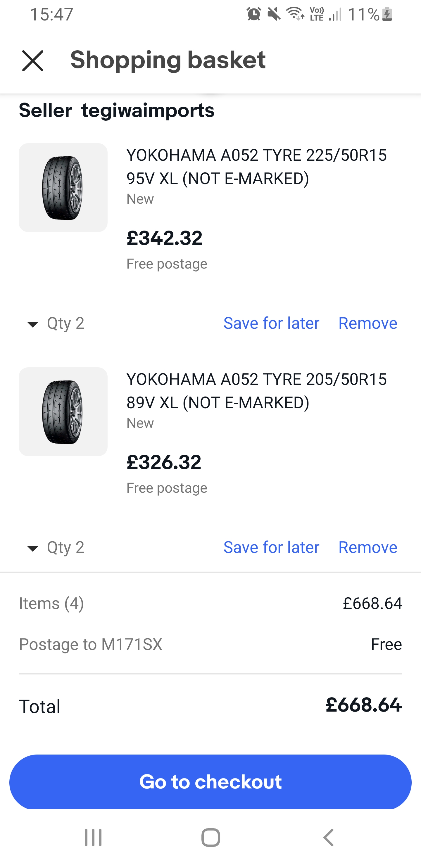

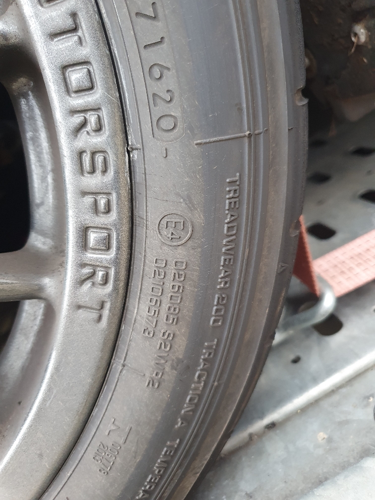

Not sure why they state they are not E marked as the 52's are defo E marked.
Think it's a case of whichever you buy, some are and some aren't
My avons are E marked but i know a lot aren't. Weird

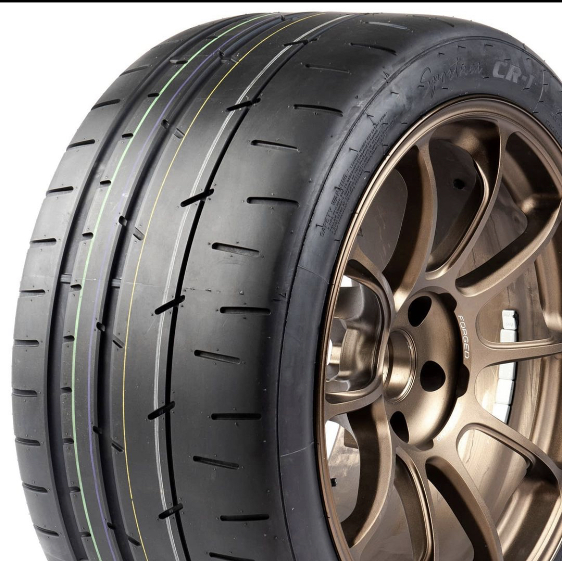

2 of my R888s are getting low, might buy 2 more or replace the set with AR1s. I know Nangkang are releasing a new tyre this year between an NS2R and the AR1 called the CR1. These could be a great summer road tyre. 🙂
