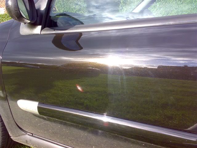

If you have black, you will NEVER de swirl it by hand unfortunately. I recently purchased a Black gold 182. the swirling was/is shocking in direct sun. I like you also believed you could do it by hand...... wrong lol. I tried everything. The problem is you can't work the product in fast enough to break it down by hand. Here is my 182. On the right side of the door is the best finish i got by hand :o . That was using Auto Glym and megs products for around a month lol, couple of times a week!!!. Left hand side is me messing around with a PC for ten mins lol.

The door pic to the right had been Megs scratch x SRP and EGP..... and still you can see the defects, lots of blood sweat and (nearly) tears lol. I had scratch x'd the door twice before hand, working untill the product pretty much vanished. Still looked shite lol! I was sooooo happy when testing the PC, i know it'll come right in the end :)

its is amazing what the pc can do :)
you can do a days detail and still feel fresh after using the pc compared to feeling knackered with 2 tennis elbows after giving it a good going over by hand lol
