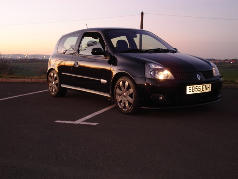

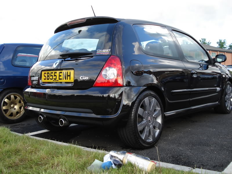

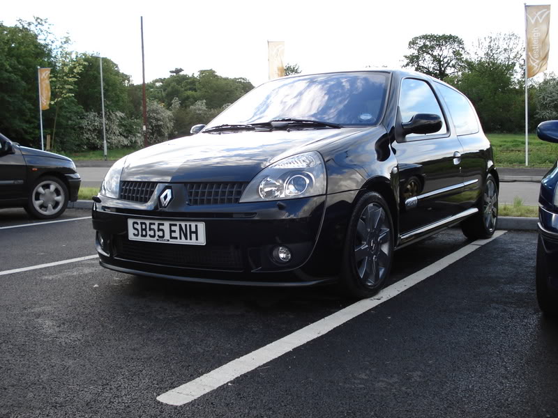

I've been into car detailing since before i could drive...i'm on my 2nd black car (black gold 182)...
  Monaco 172
dear me thats a shiney one. what did you use to get that finish? as i said ill have 4 months to get my new one looking that good! its monaco blue. ill put it up here when i get it back to the house!
