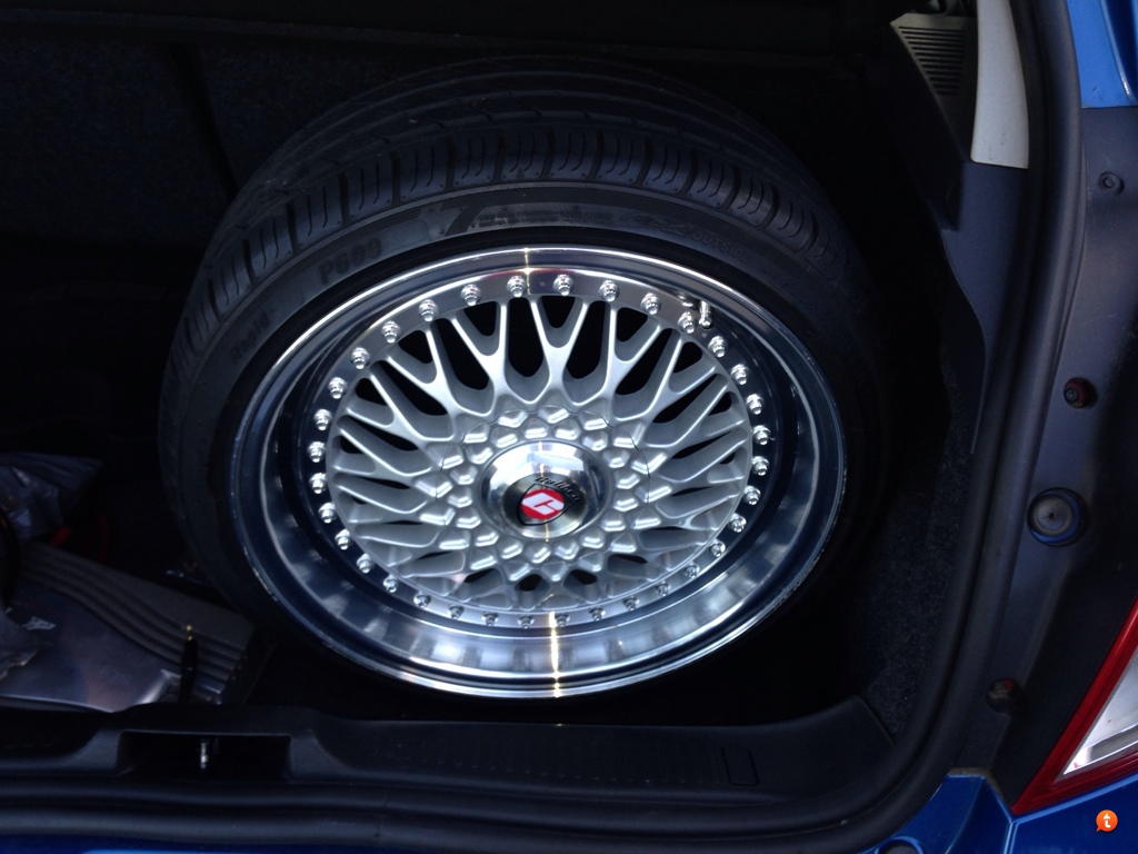

Okay so I'm back again for some more advice! Just picked up my new alloys
Calibre Vintage 17". They have a polished lip with silver centres. So I'm just wondering what's best to use on the polished lip ?
  MK3, 1.2. 16V
So just give them a wash with my usual wheel cleaner (dodo juice mellow yellow) then apply a coat of C5 ? I'll get a bottle of C5 ordered asap, everyone appears to have great things to say about it. For 4 17" alloys will I need the small or large bottle ?

Tar remover, Fallout remover, Clay and then an IPA wipedown would be my guess.
  Golf GT & A4 Avant
All nano / quartz coatings require a perfectly clean base for it to bond, any oils, grease, tar or general dirt and grime will stop the bond and it will not last. This is why IPA and panel wipe are used last just prior to application. But as the coatings can last so long it's best to get them looking as good as possible, so the use of tar and iron or fallout removers are used.
If you get the coating, it might be worth looking for someone local to help out with application and maybe some of the products you don't have for a few pound as it guarantees it'll be done properly.
4x 17" wheels can be done with 7 - 10ml of product, but first time users always over apply as its not that easy to see it spread. You really don't need much at all. hence having someone to help is useful

Thanks a lot for the advice! Will post pics when I get round to doing it! Thanks.
