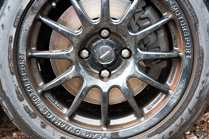

Any track pad will ruin your wheels.
My PF97s left my wheels in a complete state.

Pagid black (RS14)-great stopping power & don't make a mess of your wheels/sills.
