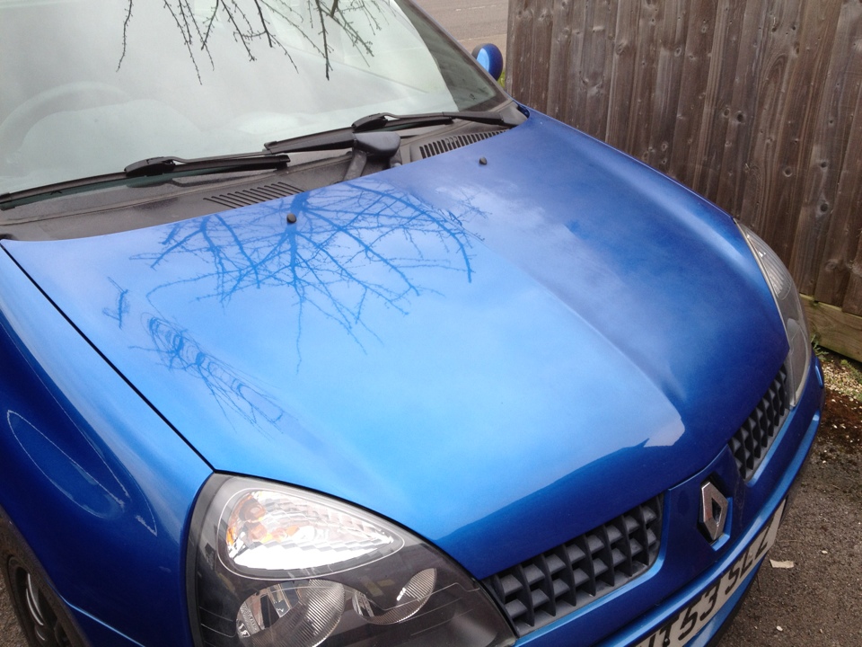

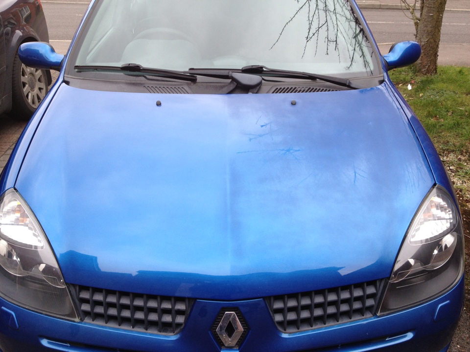

As the title suggests. My bonnet is awful (bought it like that as I wasn't fussed as I was going to track the car, which I never ended up doing) with the paint generally a bit nasty (not sure if it's actually faded, or if there's just been all the crap build up on the surface over time). I'm not overly clued up with detailing, so suggestions on how to tackle this would be appreciated (i'm thinking something like t-cut followed by polish of some kind, but not really sure).
Would be doing it by hand as I don't have a polishing mop or anything like that.
Thanks in advance :)
  2003 Cup 172

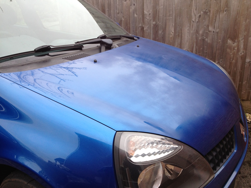

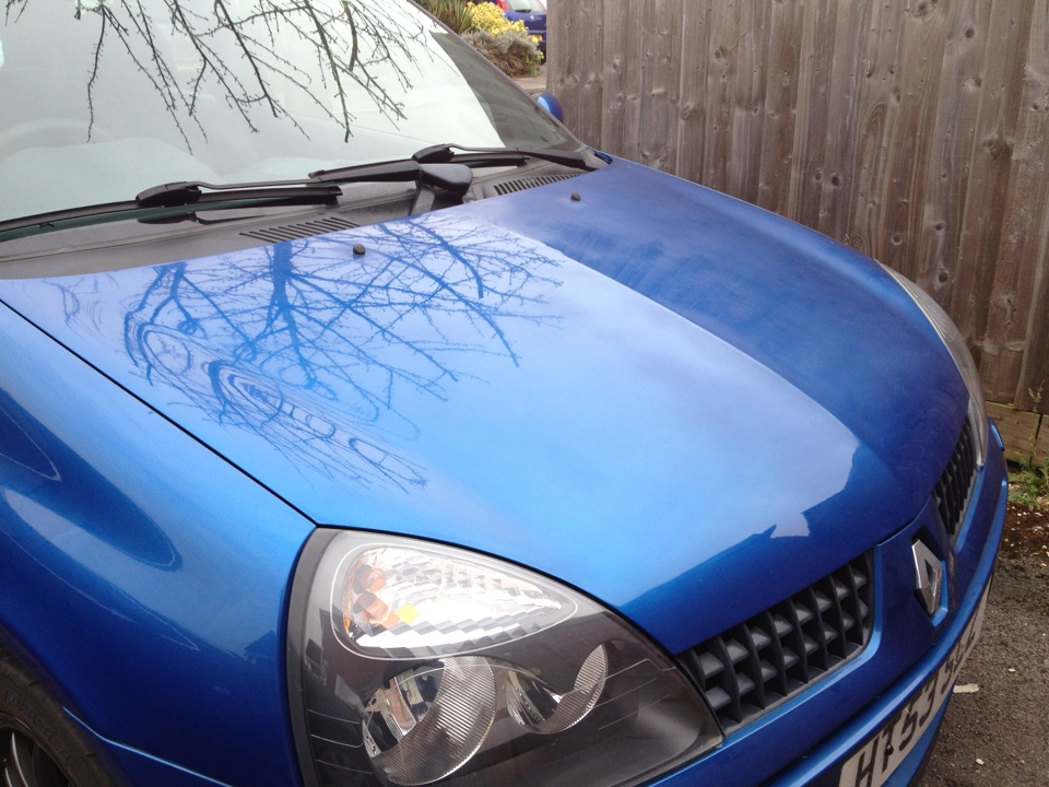

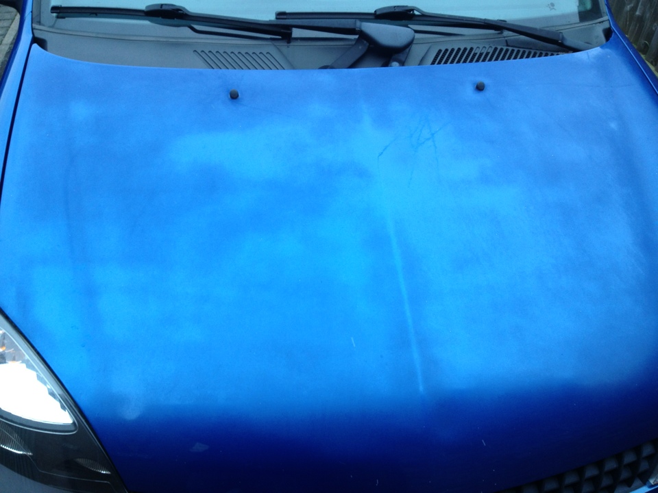

only have one more pic, but it's much the same. Just popped outside to get a couple more and it's been snowing / raining, so it's all wet and looks fine in the wet so can't tell what it looks like.
Small pockets of the bonnet have bits of shine (as opposed the whole thing appearing matt). Will attempt to see if any kind of compound or polish or anything will help, just don't really know what to use.

Definitely a re-spray, had this happen on my MX-5 and no matter I tried, did it make a difference.
Dr HMS Derv Destroyer
  MK1DTi/vivaro/corsa
I'd put it down to either what you said, basically was polished up on colour coat, or very s**t lacquer used.
Had a Z4 come I'm for a bonnet respray. Looked just like that, the lacquer failed, and was very cheaply done

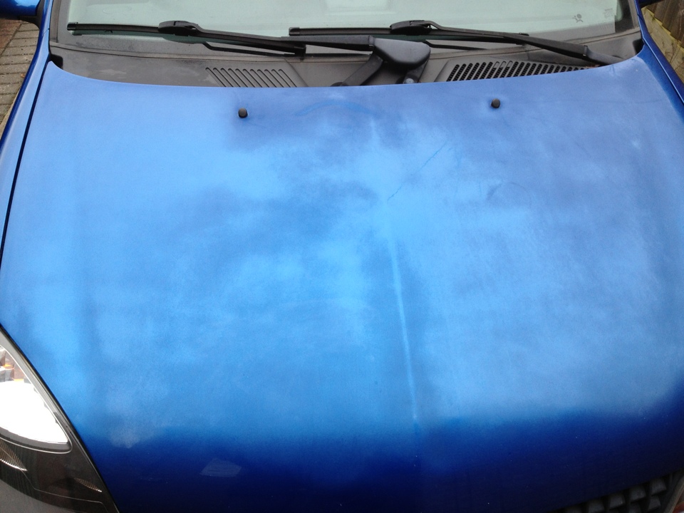

Well t-cut was a waste of time, didn't touch the mess, although it did make it much smoother to touch and was no longer rough. So I thought i'd give the halfords rubbing compound a go that I used on my headlights on one of my other cars a while ago (they got all misty and yellowish etc., brought them up like glass) and these are the results so far (just on the top left corner so far).....
Before:
After 10 mins of hard work.....
From the side (you can see the difference a bit better compared to the rest of the bonnet....)
I'm fairly happy so far, seems to be doing the job, albeit slow progress (I'm very impatient). Is there anything I should be doing after using rubbing compound to help keep the shine / protect it etc etc?

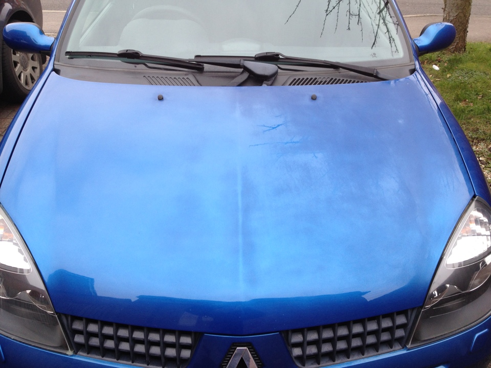

Progress so far....
  2003 Cup 172
Well then, I used a new pad and finished off the left side. Everything stayed white, not a bit of blue. Presumably all that means is all the mess was just tarnish on the surface of the lacquer and the finish should now stay?
Time for a roast dinner, then crack on with the other side :)

As it's obviously not gone down to the paint (as no blue was coming up), so was just a surface tarnish, is there any reason to think that it wouldn't last long? Surely it's no different than a normal detailing session where rubbing compound is used?

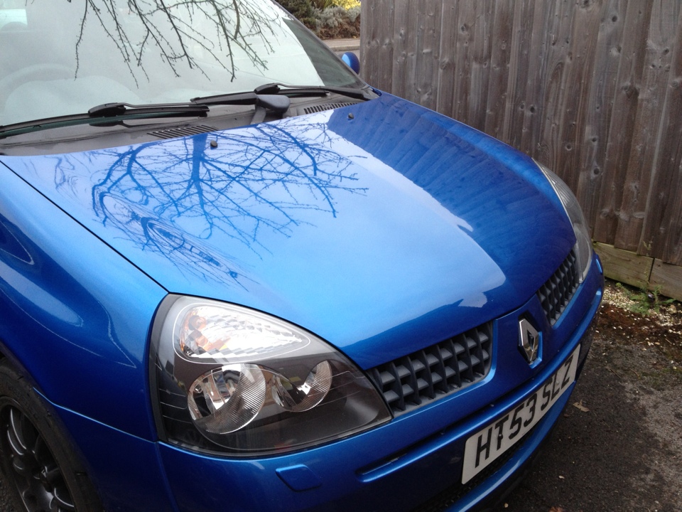

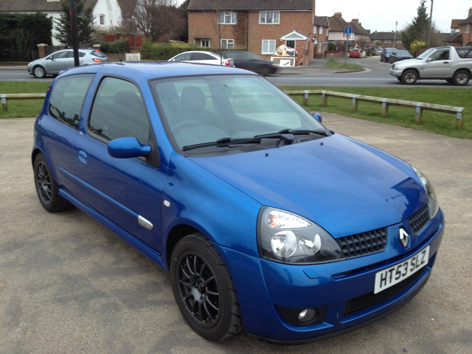

All done. Pretty happy with the outcome. Now, time to put it on pistonheads.... anyone want to buy it!?! :)
Before....
After....
  2003 Cup 172
me neither to be honest, had resigned myself to having to get a new bonnet from a breakers, but chuffed that I now don't need to. A few hours well spent.
