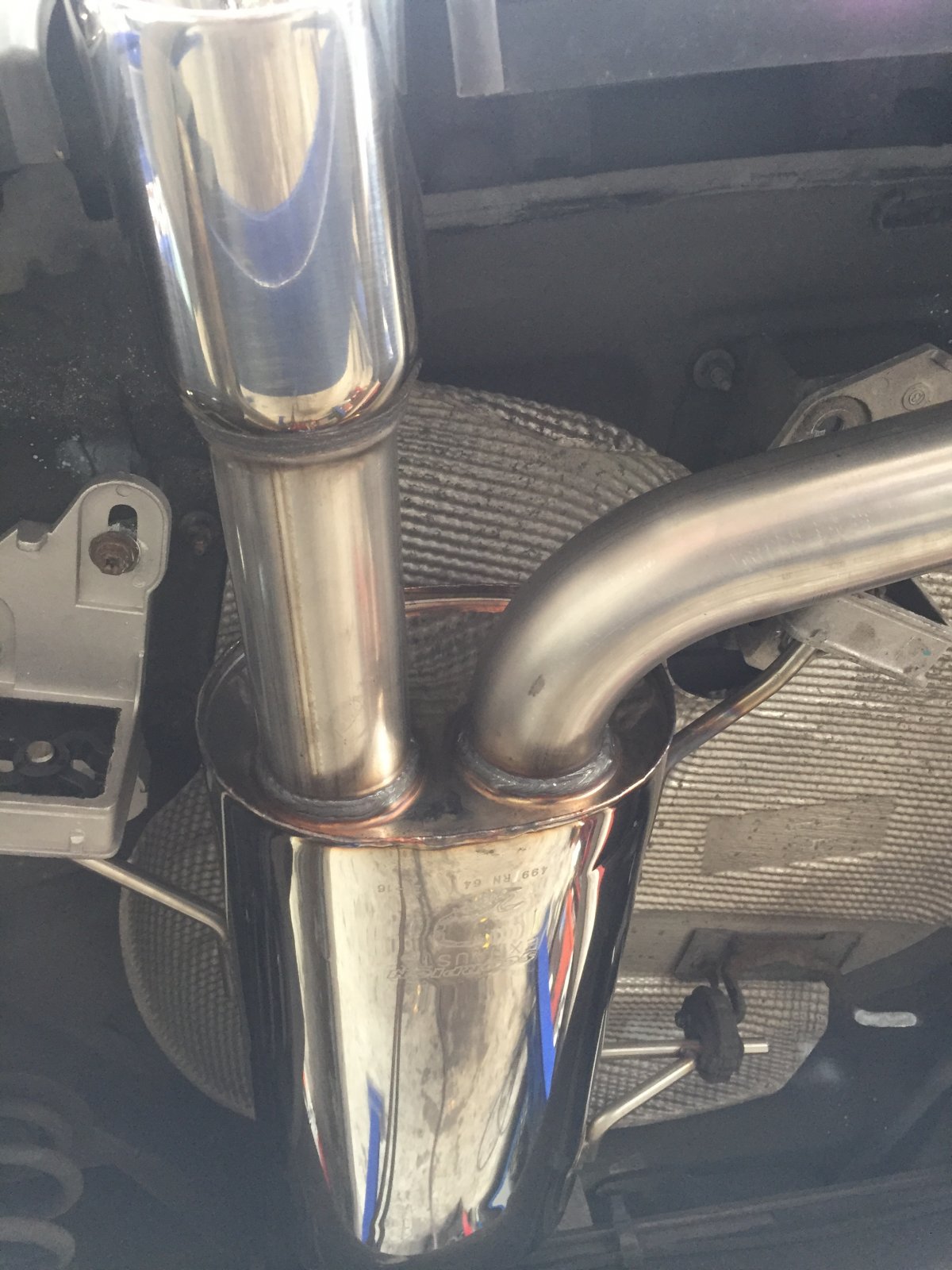

Car seems good so far not drove it a lot yet as I use work van, I know exhaust is blowing was when I brought it. So have just picked up my new scorpion rs192? I think it's called today, which is being fitted tomorrow

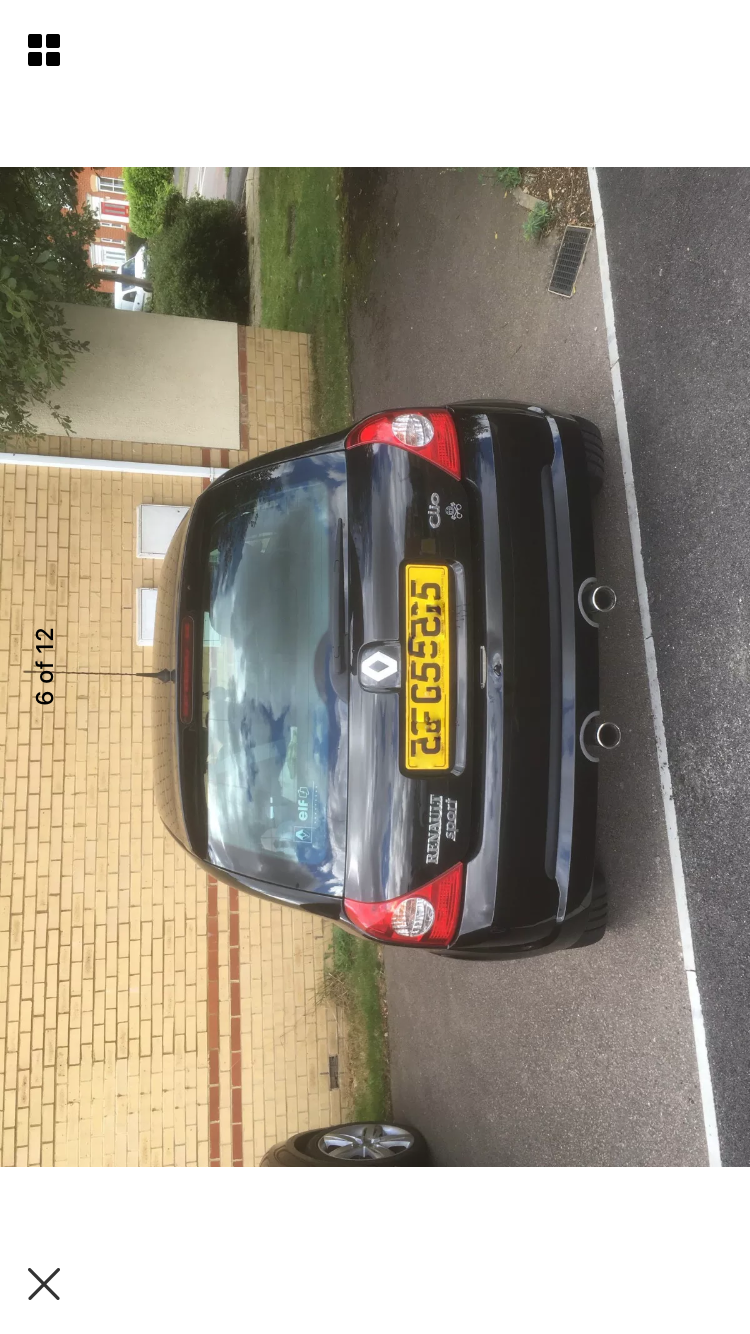

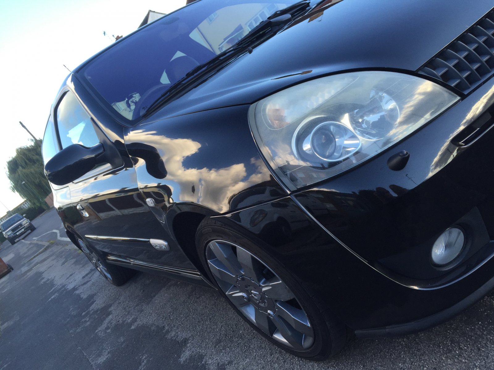

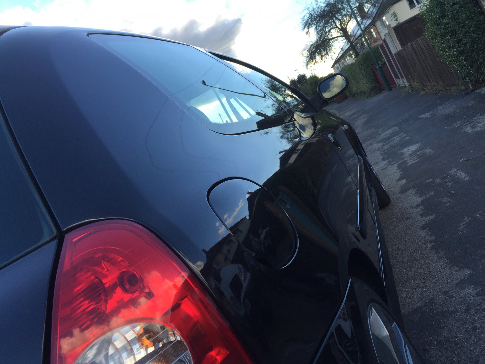

Service kit arrives tomorrow, along with a couple of cleaning products (looks like it's been abused by hand car washes all its life! So I have a nice weekend planned but here's some pictures from the day I picked her up. Shall update as I go along and any advice is ALLWAYS welcome. BRING ON THE WEEKEND

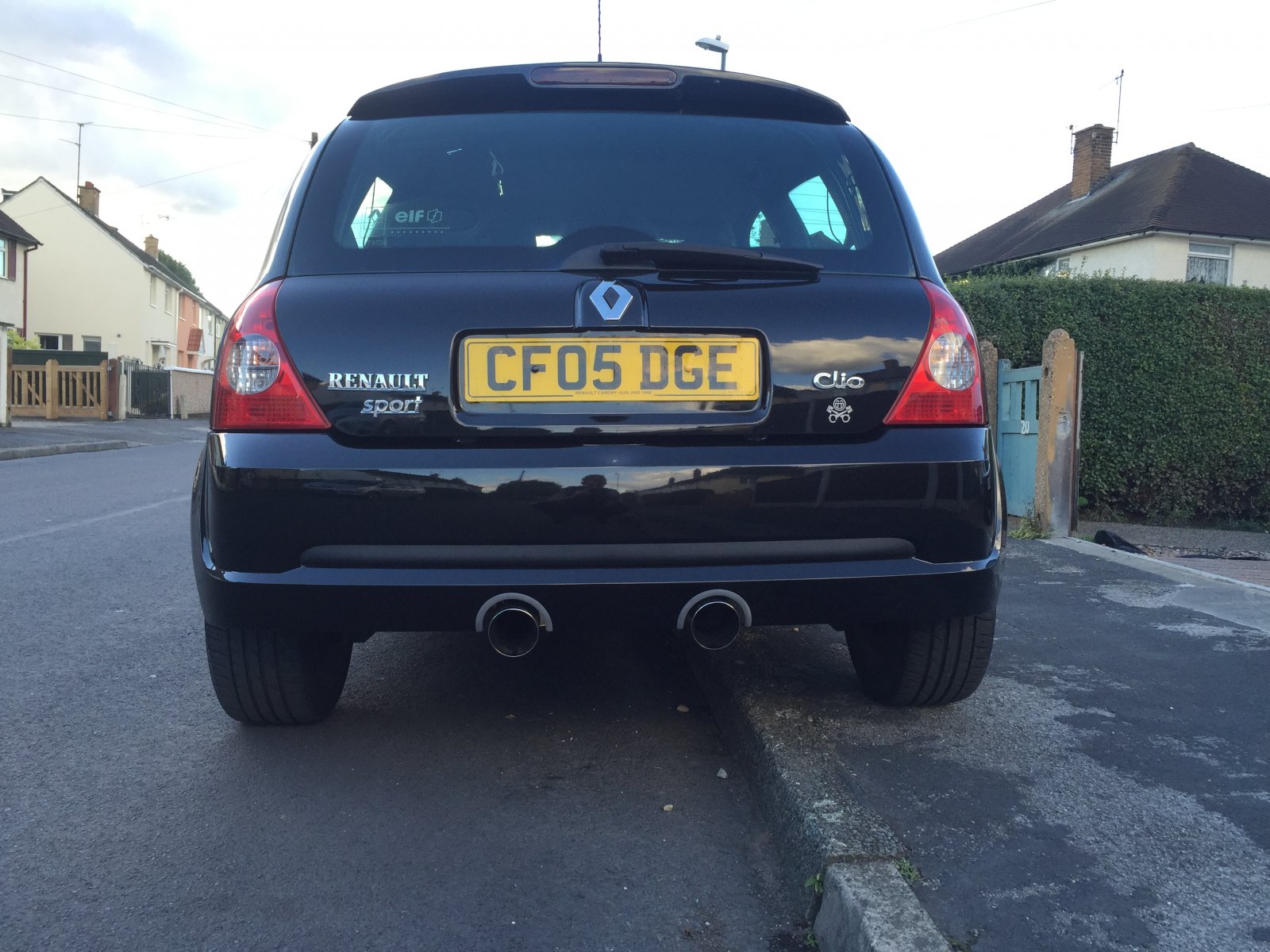

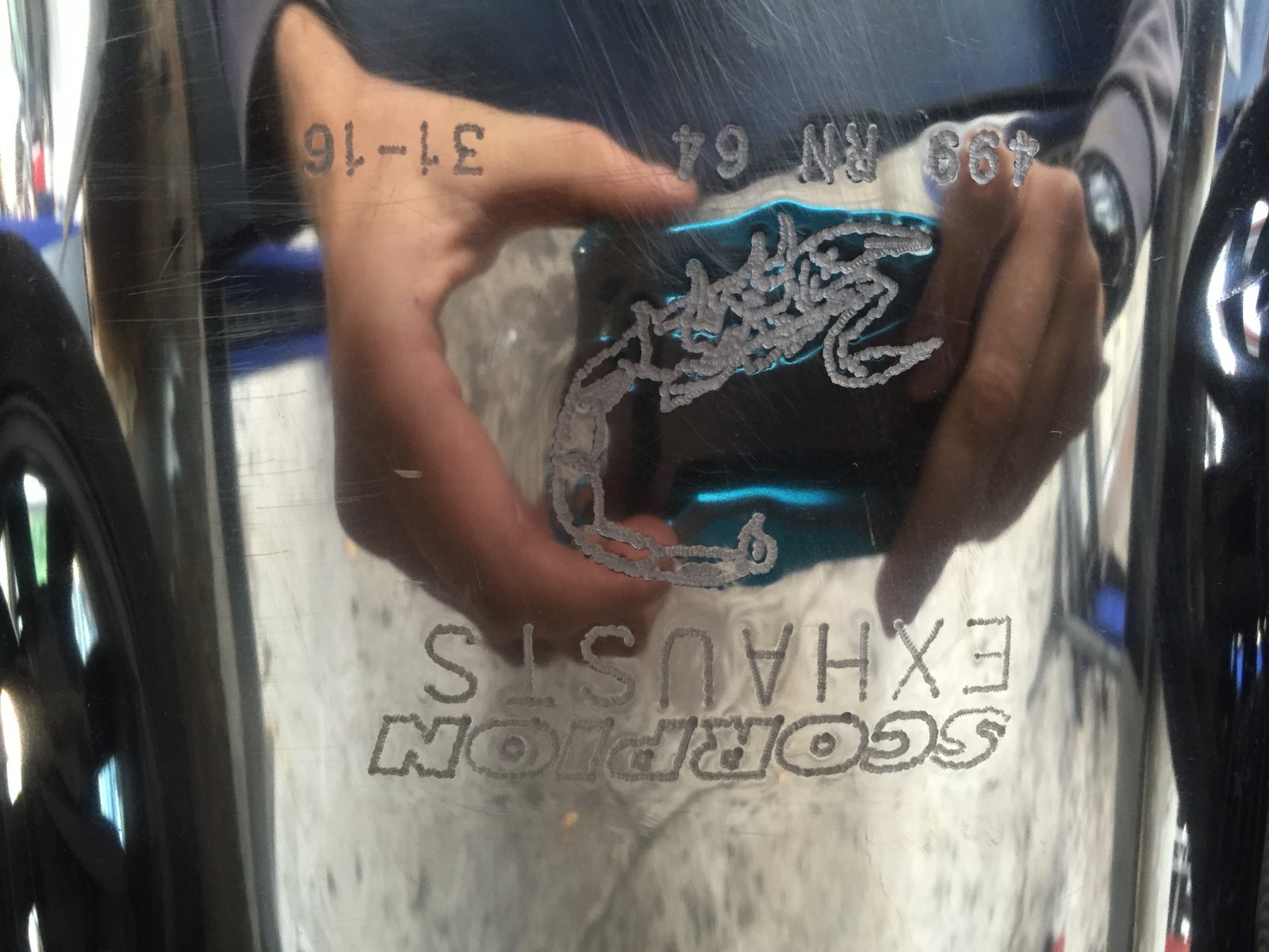

Is it not? Sure that's what he called it on phone, never mind it's fitted lovely, lined upto the hole perfect... And I tell you what. This noise when you give it a little some can be addictive I won't lie! Hopefully weather holds off today gonna attempt oil change, look at my cv boot, and give me cloudy head lights a good sand!
Don't say that, I've drive her home from the garage that's it. So not had chance for a proper drive yet
Yeah that exhaust looks a huuuuge improvement, nice and shiney! :up::up:
Maybe get some powerflex exhaust hanger bushes in the future? They hold my milltek in really tight with no flex

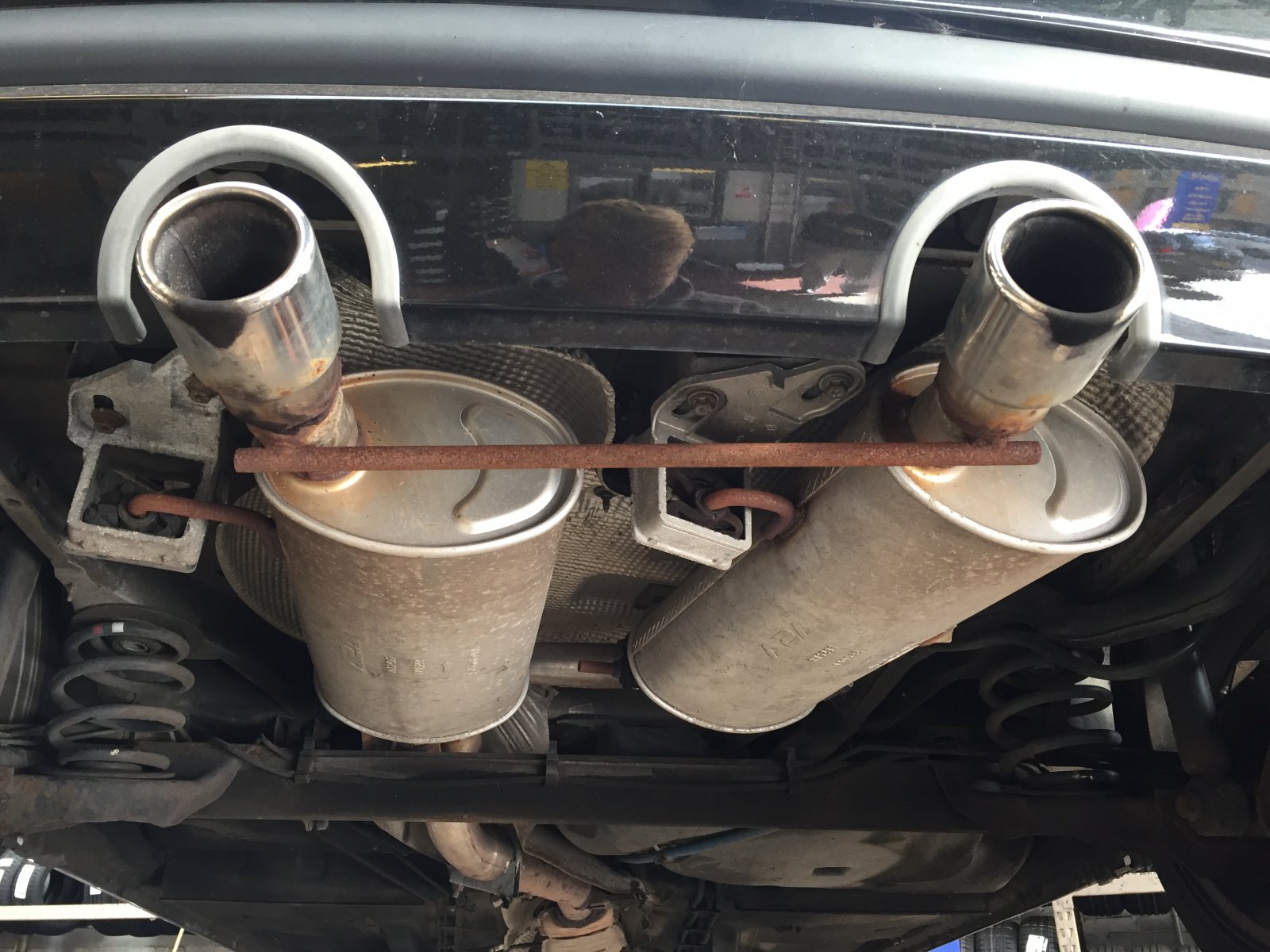

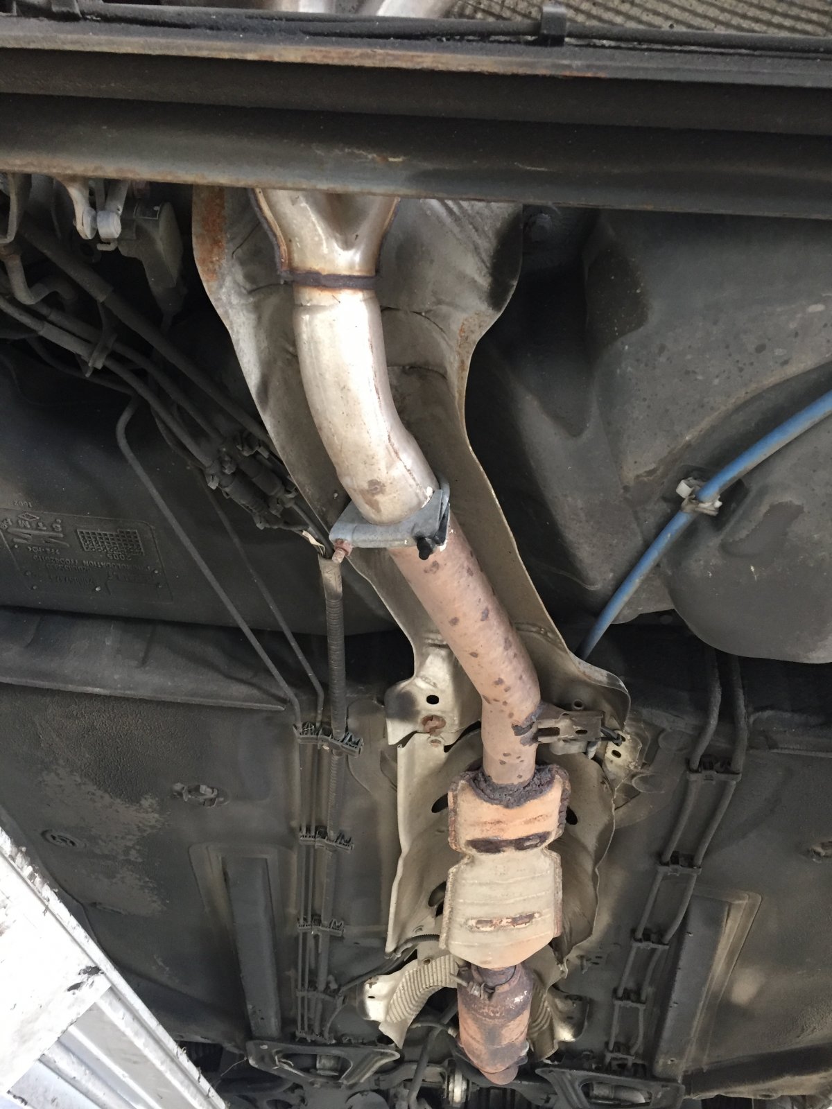

As a side issue, what's the rusty metal bar on the old exhaust going across both tail pipes? Standard? Never seen that before as the exhaust wasn't the original when I bought my 182
Well I'm gonna give it a couple of weeks, few drives in it see how it sounds to me. If I got a resonated pipe guessing that would make it quieter?

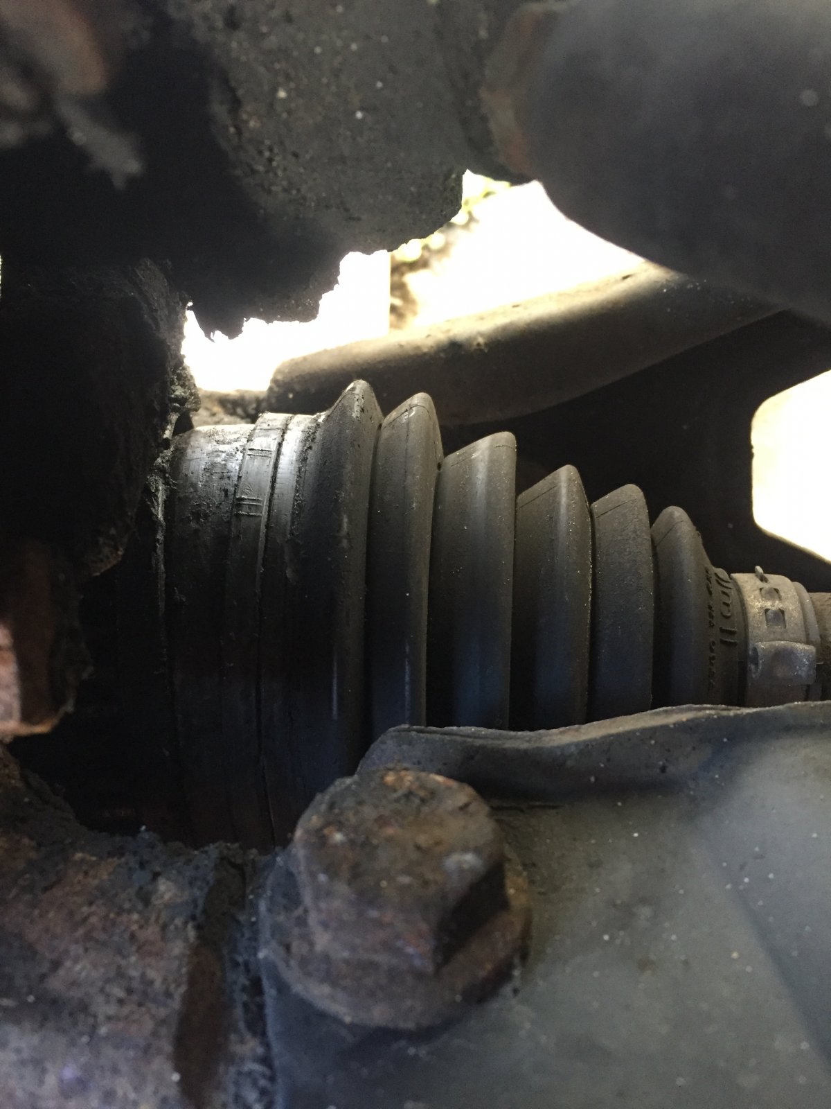

Well a productive day today. First off started with looking at my cv boot, it had just slipped off not split so little bit of grease and a bodge it tie wrap and that's sorted

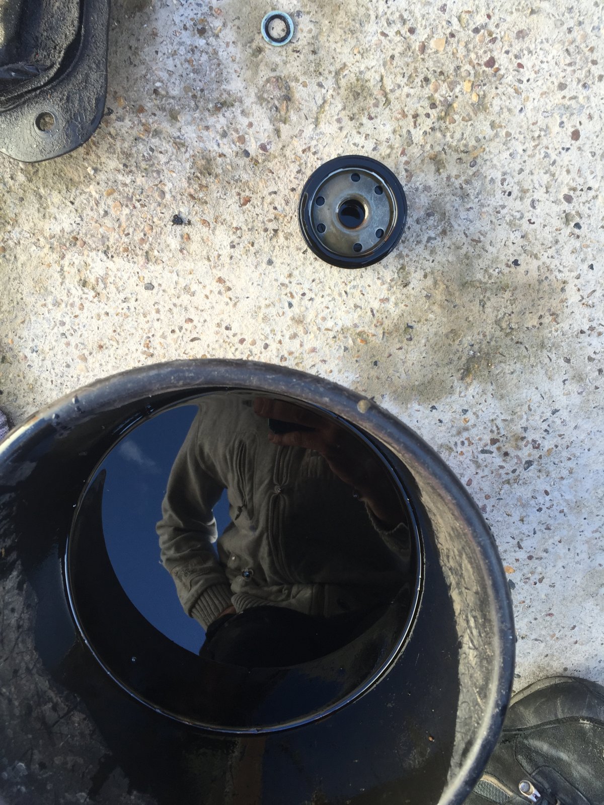

Then set about doing an oil change thanks to a little guide from here! Very useful
From the looks of oil it needed doing!

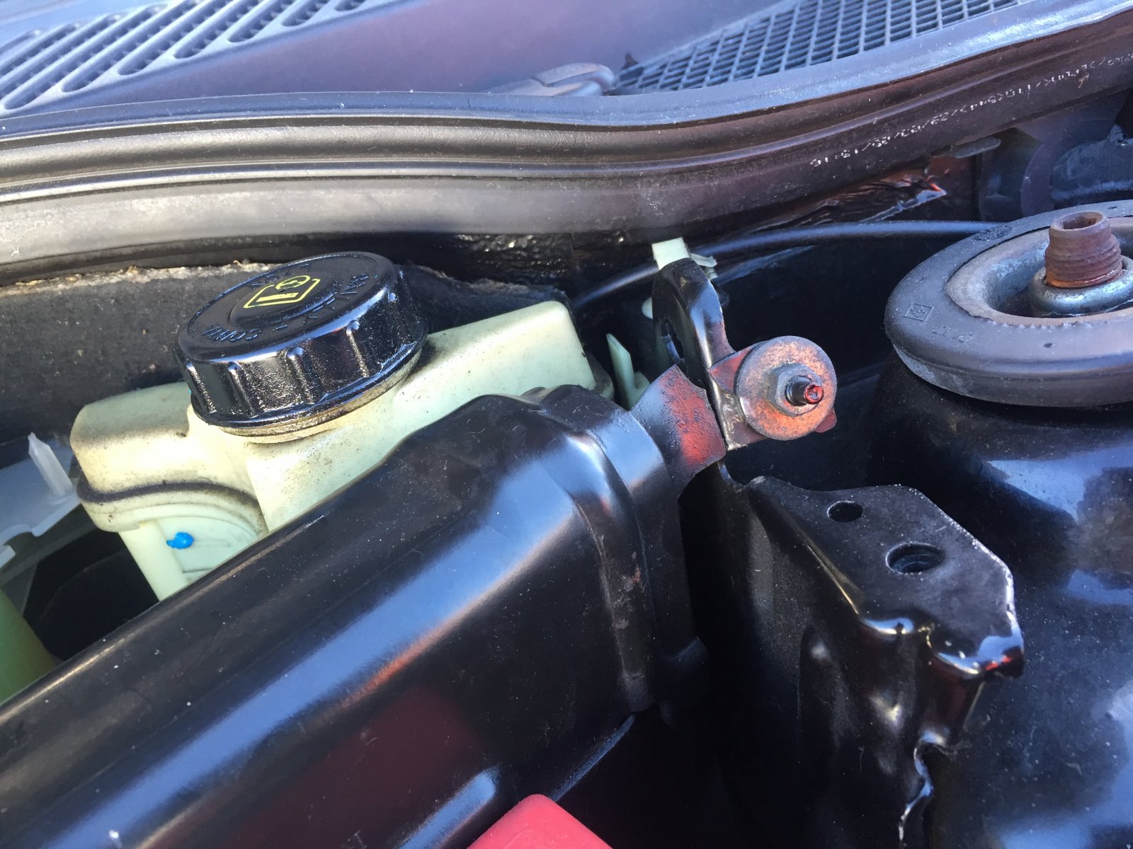

While doing the oil change also noticed this?
Somehow that's broke? Not sure what to do with this though...

Your system is the SRN019 buddy. I believe its the revised one too.

The ecu bracket is a common problem, seems 99% of them are like that.

So ecu bracket is nothing to worry about? Just messaged him about the brakes to get some prices cheers pal!

Good to hear the cv was an easy fix, get yourself a proper clip/jubilee clip though.
Give the exhaust time. When I first got my 182 I thought my Piper exhaust was waaaaay too loud but it's massively grown on me and I want it louder now so looking to decat. If it's brand new it could need time to bed in as well. If you're still not happy, I'm sure Scorpion do a silencer pipe.
Any idea where to get the proper clip from? Seems quiet large for a jubile clip?
Can get them from a few places mate, just search on eBay and they'll come up. Need a specific tool to tighten them correctly though.
I've got a jubilee clip on mine and it's been fine. Will get the size of what I've got on mine the next time I get chance.
As said by Justin above ^ Get yourself the proper clip and do it properly mate. That will come off in no time at all and you're back to square one.
The tool is mega cheap on ebay look for cv boot pliers
Lol - I think mine broke in exactly the same spot about three years after I had it. To be honest, I'm amazed it lasted that long - wafer-thin metal, retained in place while the rest of the engine attached to it has the ability to flex and move on the mounts.
I just clamped the broken bit between two bits of scrap metal - effectively two oversized washers - then tightened them with the nut and bolt combo to the right. Seems to work ok.

Ordered my self a couple of jubilee clips. Got brakes to change next week so when I do I'll bang on on both sides!
I should have a new one arriving in the next day or to so should be all sorted. But if it's that bad and that thin might have to doctor something to make the none broken one stronger like you have!
