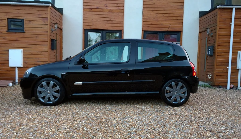

Hi guys,
Here is my BG Clio 182 FF that I bought from Steve over at R-Sports car.
Purchased it with 42k miles and its cracking good fun to drive.
Here are some shots of the car after a clay, polish and wax:

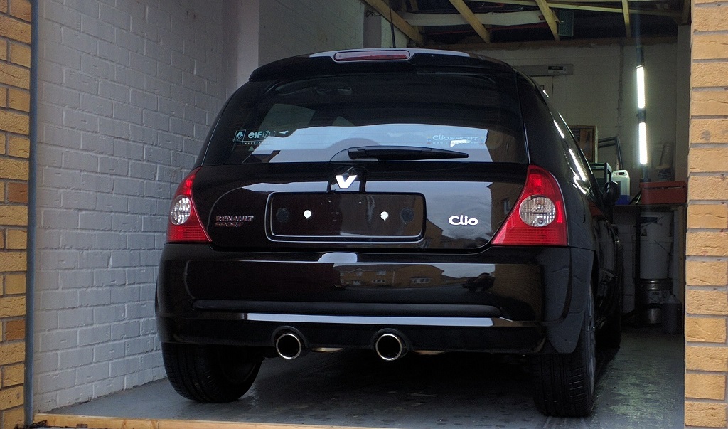

Thought I'd do a little update with this.
Got the Scorpion RS192 catback fitted as the original was getting a tad rusty:
Done other little cosmetic changes as well... Fitted Silver vision indicators front and back, also fitted some LED sidelights/number plate light. This picture is half way through fitting:

Anyway, here it is after a winter protection, 48k miles and colour cliosport sticker applied (excuse the poor shot):

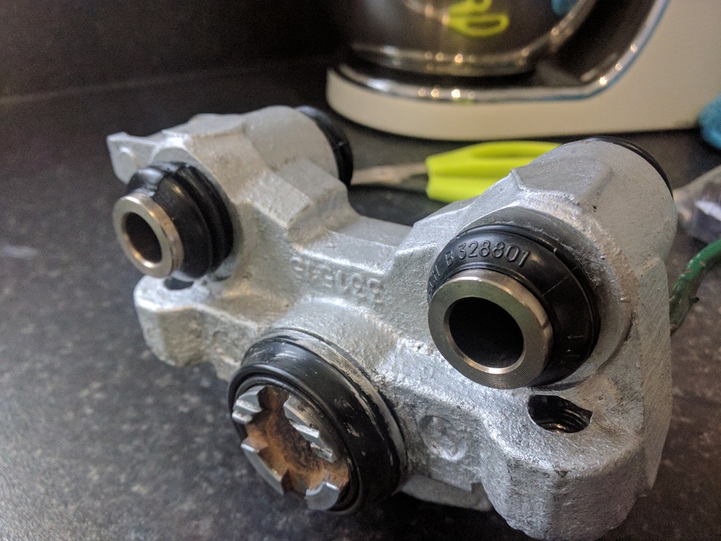

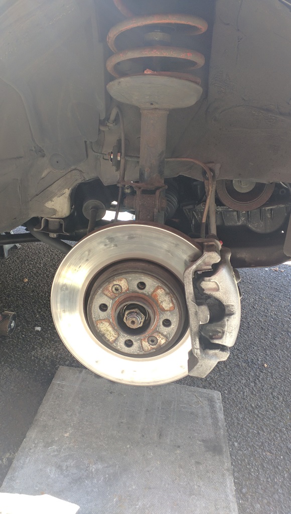

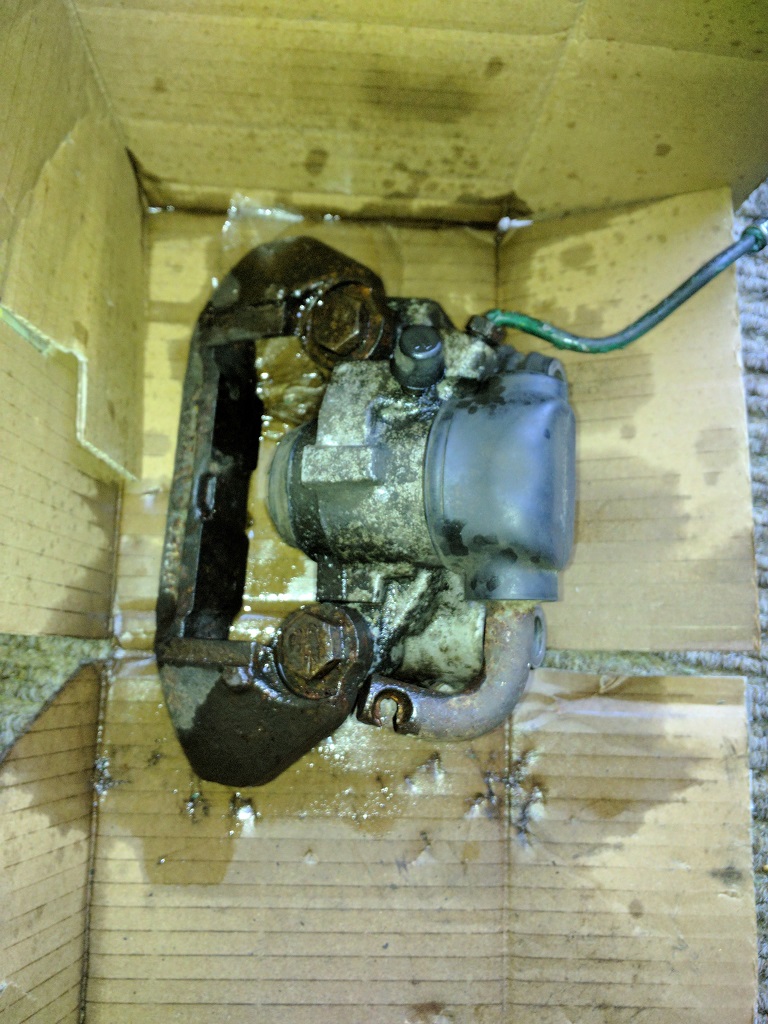

It was during this change I noticed that the drivers side outer pad was well worn compared to the passenger outer pad. From researching on here I found this was an unusual combination and if anything, the inners typically tend to wear faster.
After removing the pads the difference was obvious. Drivers side outer pad on the left, inner pad off the right -
The sliders were all fine but if anything the piston was a little stiffer than the passenger side to push back in. Thankfully a pretty good offer came up on the Bigg Red eBay page. A pair of calipers that had brand new seals, piston & nipple but had an issue with the electrolyte coating (one was pitted silver, the other gold). As a result this pair cost me £70 which is a good saving and didn't require me to strip or send the old ones off-
A quick lick of Hammerite paint fixed the mismatch -
And installed with new Brembo HC discs and pads -

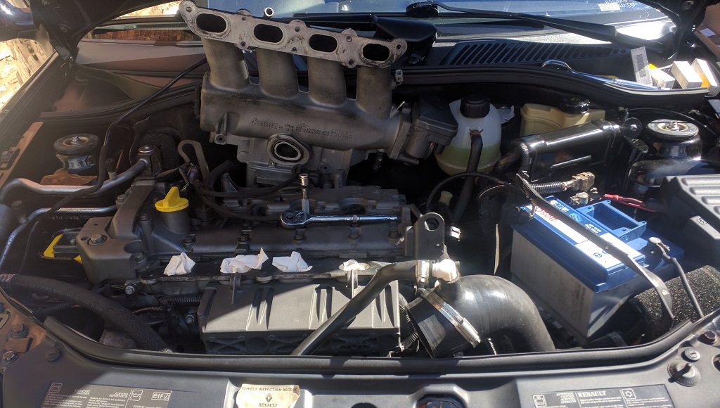

Just after this was my birthday and I received some Halfords vouchers. After thinking about what to spend them on, I decided to go for some high temp paint and finally tackle bringing the engine bay up to standard.
A quick, but dusty black gold bonnet shot before I started!
Engine bay -
Inlet and gubbins removed -

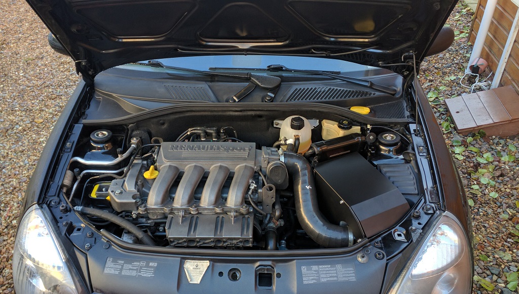

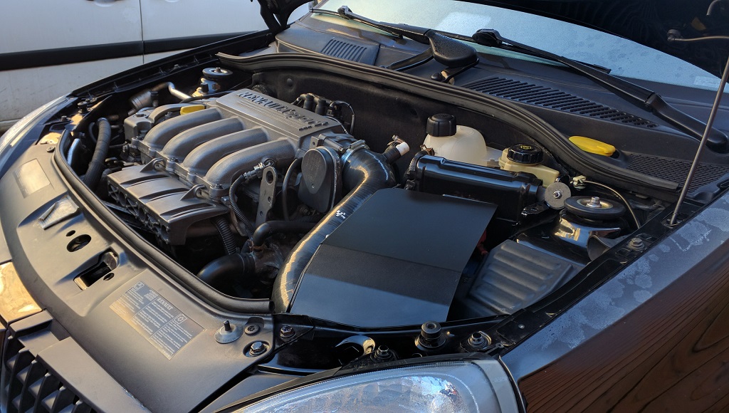

Painted (also did the throttle body, fuel rail & upper mount cover):
Then a nice new coolant bottle, which really does freshen up the bay!

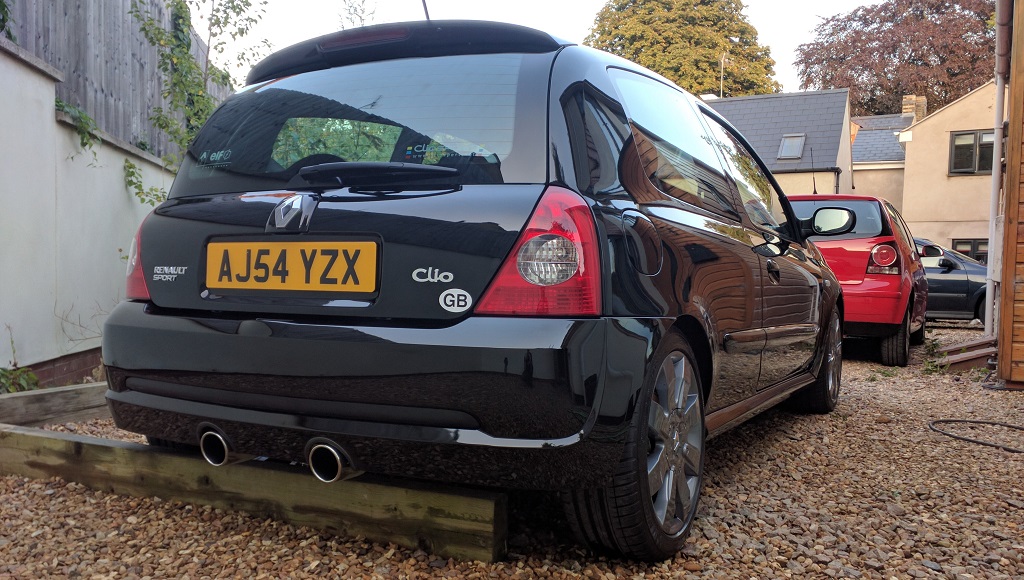

To end the updates, how the car stood on Saturday -

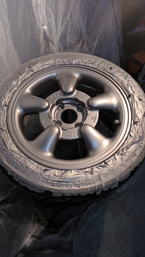

I decided to give the alloys some attention on the 182 at the weekend. Although the wheels were refurbed when I bought the car (45k miles ago) I was not into detailing at the time so a wheel sealant wasn't high priority!
As a result, whilst I kept the front faces tidy (never curbed) the rear was always neglected and it seems that some brake dust has etched into the clearcoat irreversibly.
Regardless of this, I tidied them up with ironx, tardis & clay bar. To be honest, it was good just to get rid of all the old tyre weight glue!
Jacked up -
Dirty unprotected wheels, including old glue -
Product of choice, plus tardis & claybar!
Iron-x doing its thing -
Result -
Then they were brought inside, prepped with eraser and a coating of Dlux applied (should give 1-2 years protection). They were left for 24 hours to cure before being put back on.
I'll update with how I get on with the coating.

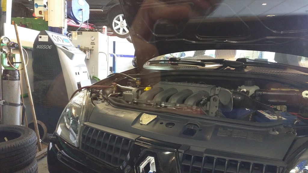

With the recent spell of good weather I also noticed that the aircon was no longer working, the clutch seemed to engage but no 'click' sound when it starts operating. The garage found that the gas had escaped and it was no longer holding vacuum.
Cue my saturday morning having a look over the system and with a bit of luck I found the issue -
It was the pipe that goes from the condenser to the compressor, just below the alternator. No idea how this occurred but I've fitted a replacement pipe and hopefully a regas later this week won't yield any further issues.

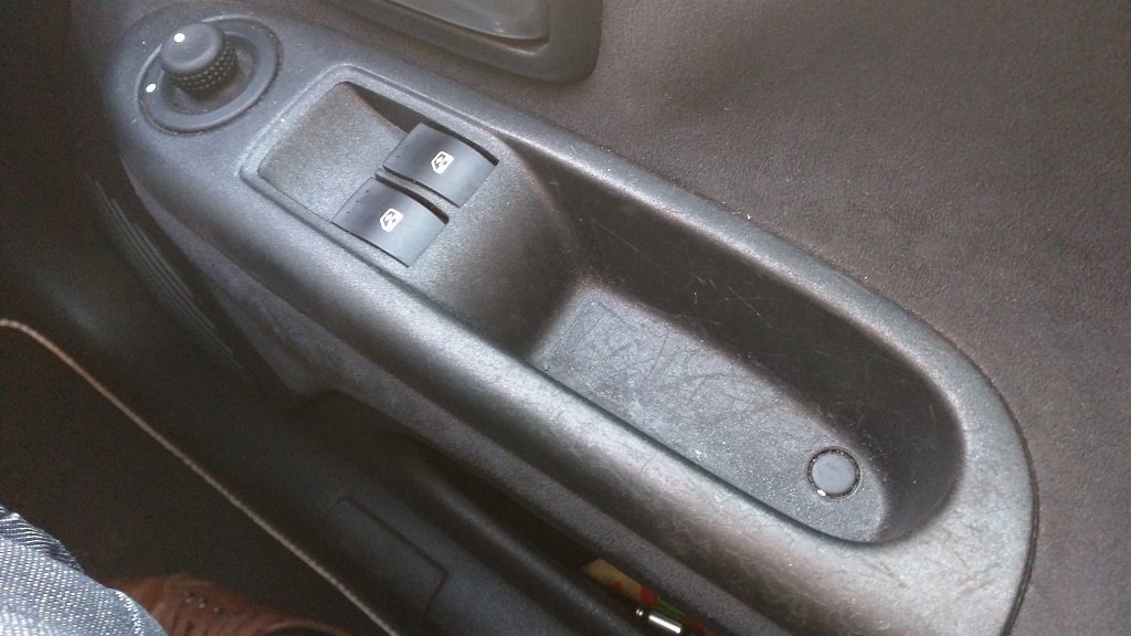

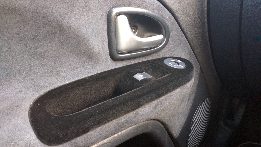

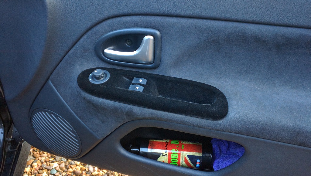

I had noticed that like most clio sports, the door pull plastic was looking pretty worn and scratched up. On eBay Black Sheep Flocking had a few listings and an impulsive best offer from myself was accepted on some black door pulls.
I've just switched them over, it looks better in person but I'm not totally sold yet... I'm going to order some new flocked door handles to try and match it a little bit and see...
Old ones -
New -

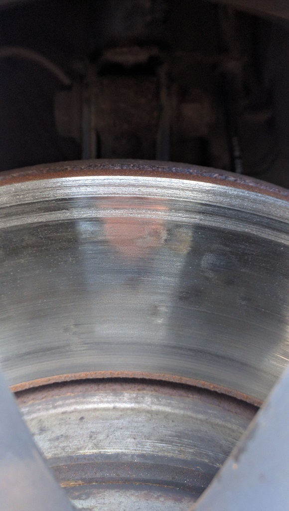

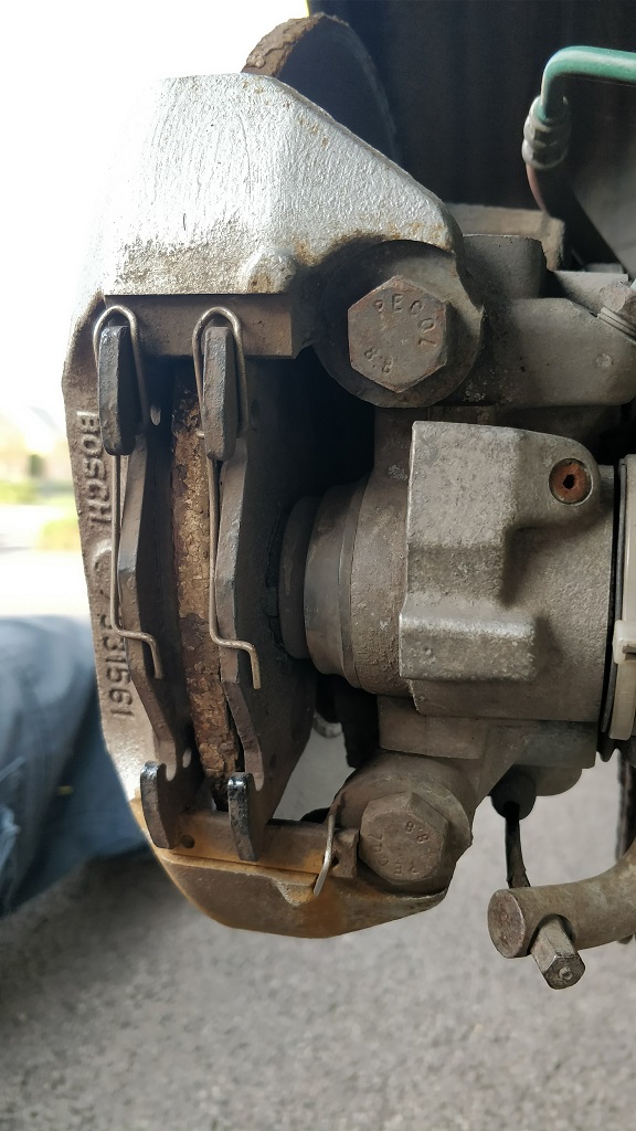

We started off with the brakes as they were completely shot and one pad was down to the metal, thankfully it only happened the previous day so got those swapped over asap -
Didn't get an after picture but I decided to remove the anti-rattle shims in case they were causing the pads to stick a little with heat. Also decided against lube on the back of the pads etc which seems to be working fine after 200 miles. No rattles or squeaks.

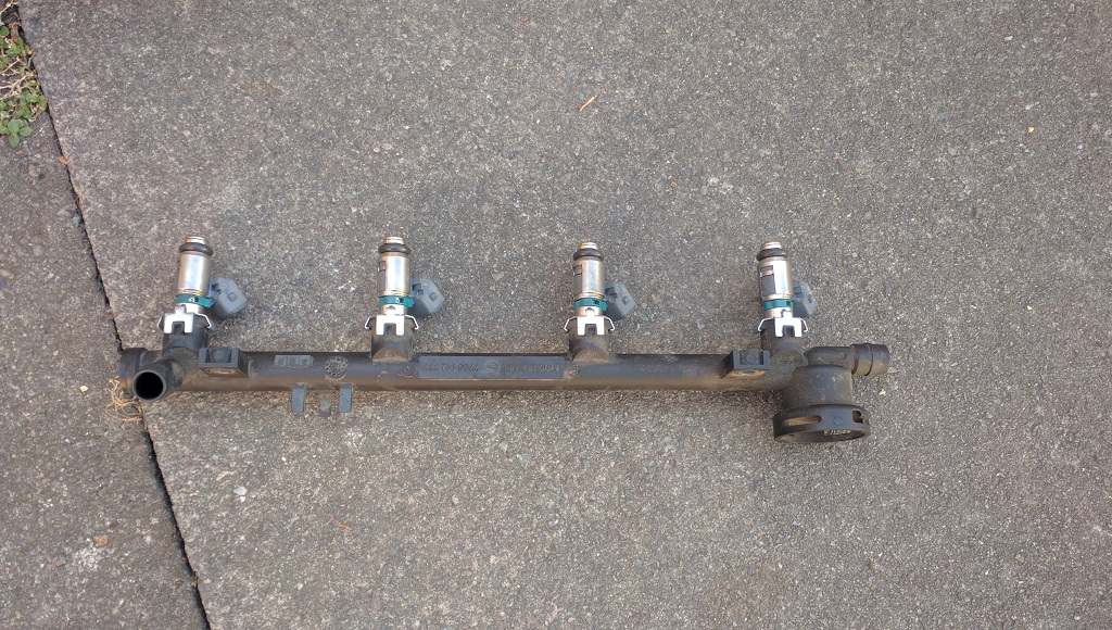

The other week, the injector on cylinder 4 died so I decided to get a brand new set to mitigate the chance of further failures. They were easily installed and new o-ring placed on the fuel connector (these often break when removed).

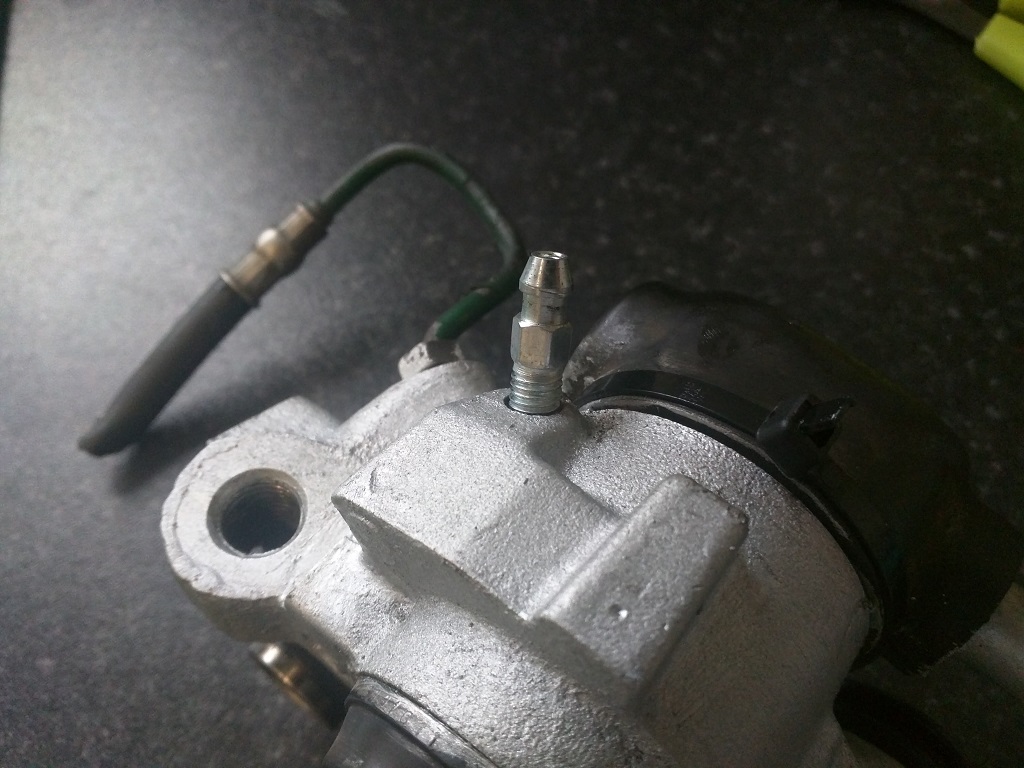

Finally, the power steering was changed with a bodged pipe method, this basically involved covering the return hole in the header tank with a bit of pipe, turning the engine on and pumping the old fluid out whilst replacing with new - it was easy and the old gunky fluid was removed!
With all this done and everything working correctly, I got a new pair of Pilot Sport 3 tyres and went for a Hunter Alignment. Whilst it technically drove straight, the steering wheel used to always hang slightly to the left. Previous alignments have been unsuccessful but STS in Bedford got it right first time.

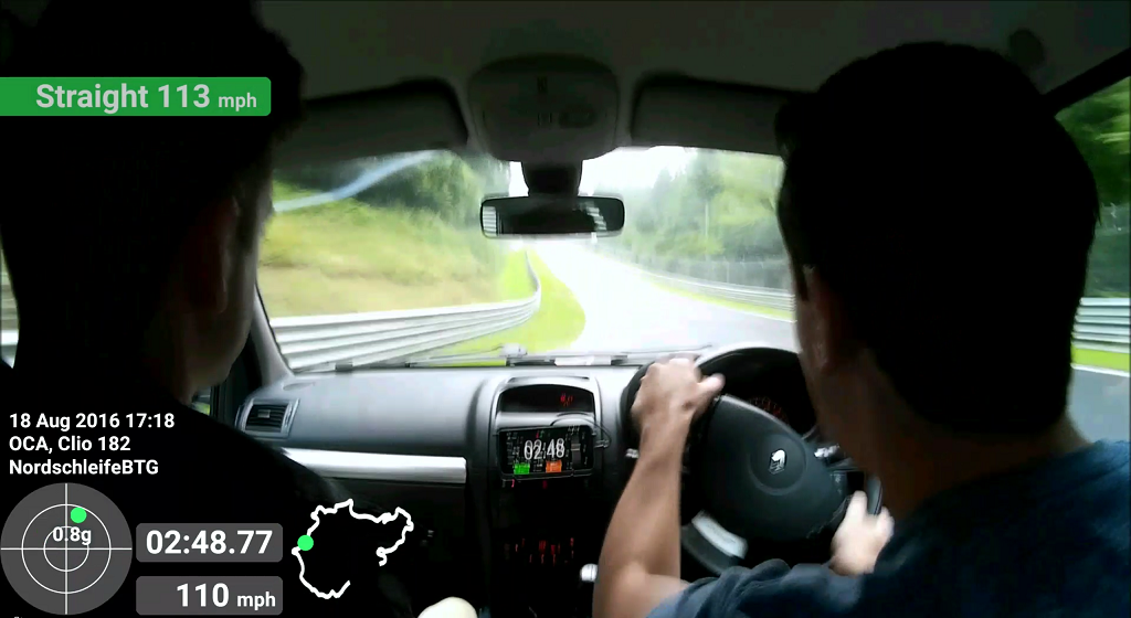

This was about 1 hour from the Nurburgring and we arrived at the car park moments before the track opened. Unfortunately it was wet and raining and the track looked sketchy. We decided to wait 30 mins for a dry line to form once the rain had stopped.
It was the first time I have driven on track, and at the ring so drier conditions would have been preferred!! As a result, we decided to go for one lap before heading towards the first stages of the WRC.
Overall it was an awesome experience, absolutely love the track and I need to get back there soon! It was great to finally put the 182 through its paces.

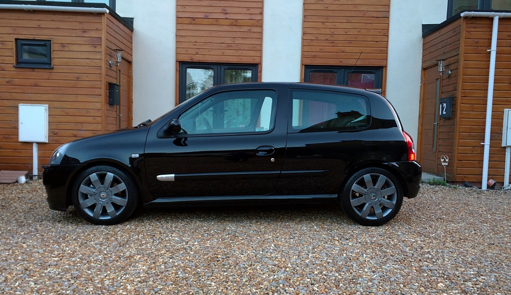

Due to the visit to the Nurburgring earlier in the year, I decided I wanted to start using the 182 for track days, particularly now that they are worth so little it almost becomes a disposable car. The first thing I needed were some 15" track wheels as I didn't want to wreck the PS3s on track. It was after trawling for sale threads on here I saw @Budgie selling a set of Speedline Vegas with R888s for a very reasonable price. I couldn't resist so took the trip down to Budgie's to collect -
As most know, they are an old (& heavy!!) alloy but I wanted to tart them up a bit for track, knowing that they would get pretty wrecked with brake dust regardless. With the garage I had a perfect opportunity to get them sanded & sprayed. I went all out purchasing filler etc but quickly got bored and just decided to spray them. Although I try to get things perfect I really couldn't be bothered with a set of track wheels...
Trial fitted they looked alright to be fair, better than I was expecting:

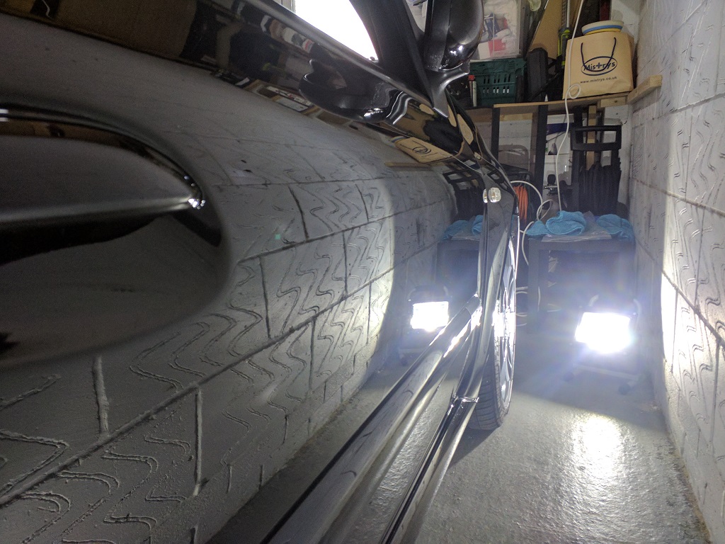

In the more recent summer months I've spent a bit of time correcting the paint, various Menz polishes with Hexlogic pads & coating the car with CQUK. One of the benefits of having a garage to let coatings cure -
And after its first subsequent wash -
Carrying on with the CarPro theme, I thought I would give Ceriglass a go with a rayon pad to see if I could remove any lighter scratches from the windscreen. My 182 is still on its original windscreen so its sporting many marks and stone chips which are impossible to do anything with but I think I made some minor improvements to wiper scratches. I've got some Flyby Forte to put on at some point but ran out time -

Before the first track day in June I went to bleed the brakes, all going fine until I tried to crack the nearside nipple. It didn't move a mm and snapped off with very little effort!
As it wasn't leaking I left for a couple of months, however with yesterdays good weather I took the opportunity to get it switched over before the cold weather comes in.
As you can see, it sheared off well:
I decided to get a used caliper off eBay and crossed my fingers it will be all free & moving. Although a bit dirty, the piston moved nicely & the bleed nipple was free:
For the sake of a semi-refurb, I replaced the nipple with a new one and bought new sliders & seals. After a lick of hammerite it came up pretty nicely. Fitting it was easy enough, the hardest part was stopping the brake line from cross threading (a little swearing ensued). Got there in the end and all bled through.
