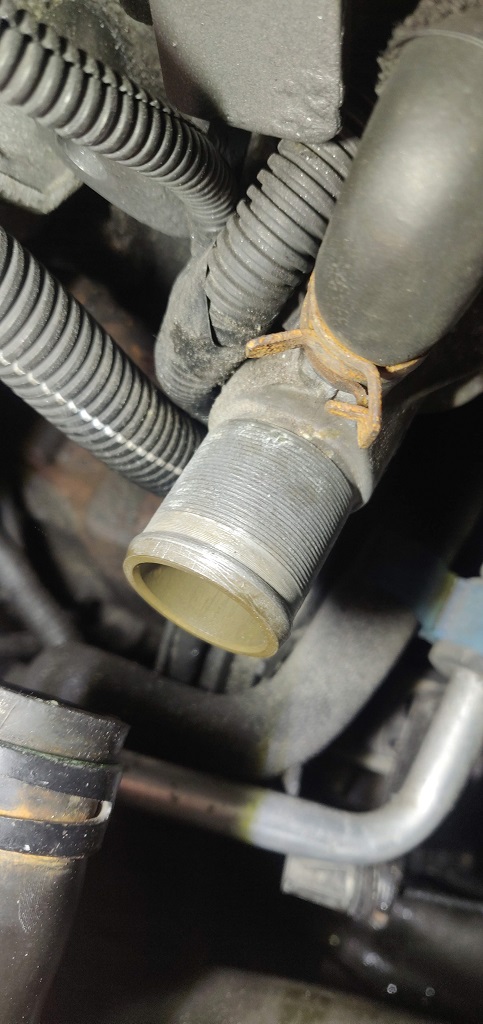

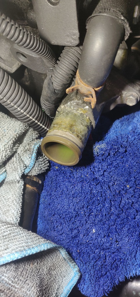

Only a few small bits to tide me over -

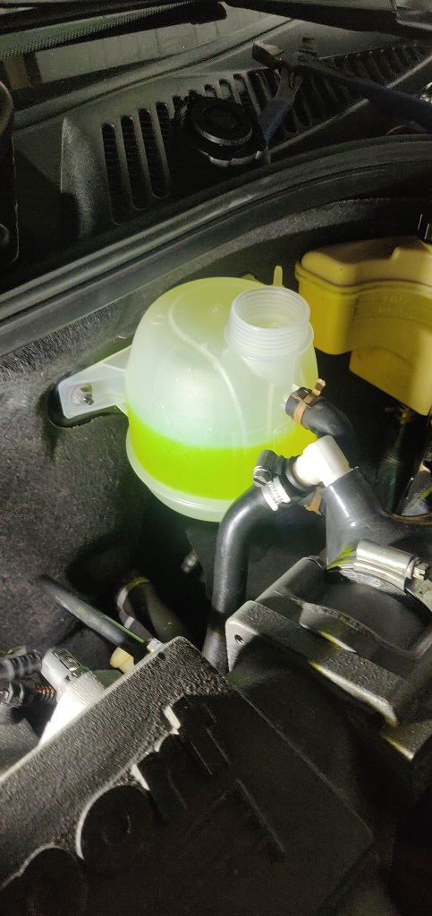

1) Noticed coolant weeping ever so slightly from the radiator top hose into the thermostat housing, so whipped that off and gave it a clean up to remove all the gunk
2) New coolant tank as the ECP ones are complete s**t and never seal the cap down properly. This one off eBay was much better and paired it with a brand new genuine coolant cap

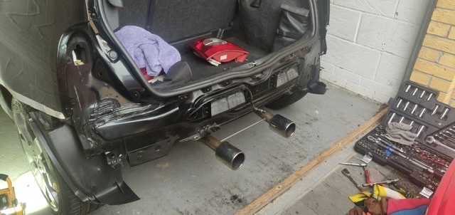

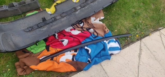

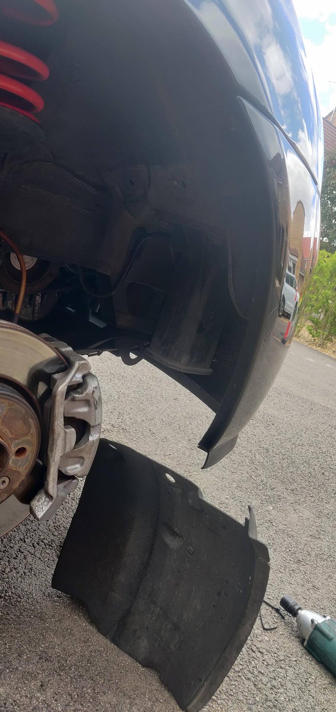

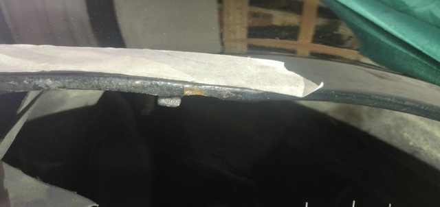

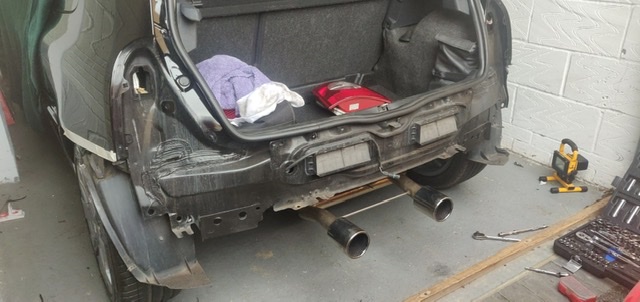

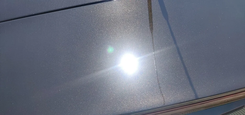

I thought I’d get involved with the trend of removing the rear bumper to clean behind it :LOL: In reality there are a few marks on the rear trim / strip so want to get that off and respray - due to where the clips are it’s easiest with the rear bumper off.
So off it comes and leaving the arch liners in place, can’t be bothered with any rusty bolts 😅

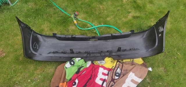

Rear bumper and trim piece removed for paint -

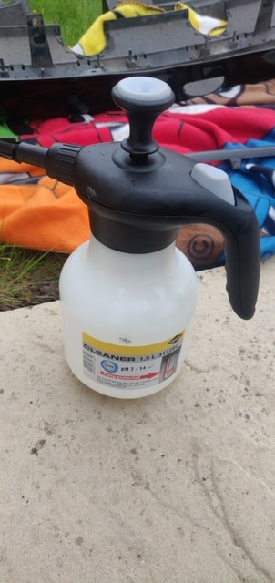

And a good opportunity to clean up the rear bumper, mixed up some Surfex into a new Mesto sprayer. Cheers @gally & @-Jamie- for the recommendation.
And onto the rear of the car which wasn’t too bad to be fair

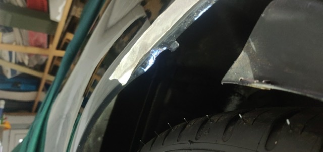

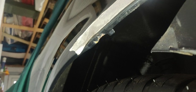

I did have my suspicions that where the rear bumper meets the quarter panel there might be some corrosion, I’ve noticed in the past grit stuck in there which could easily rub through. It turns out these concerns were well founded -
Due to its location it’s not something I particularly want to tackle as I really don’t trust my ability not to cause issues further into the paint above haha!
So for now, I’ve treated with two coats of Hydrate 80 and will put a coat ofpaint over it. Hopefully slow it down a bit so won’t cause too many issues. Plus the car won’t be used in salty or many wet conditions so hopefully give it some longevity before professional attention. It’s time to come to realise it’s a 16 year old car with 142k on the clock!
I will update when I’ve got the bumper strip painted up!

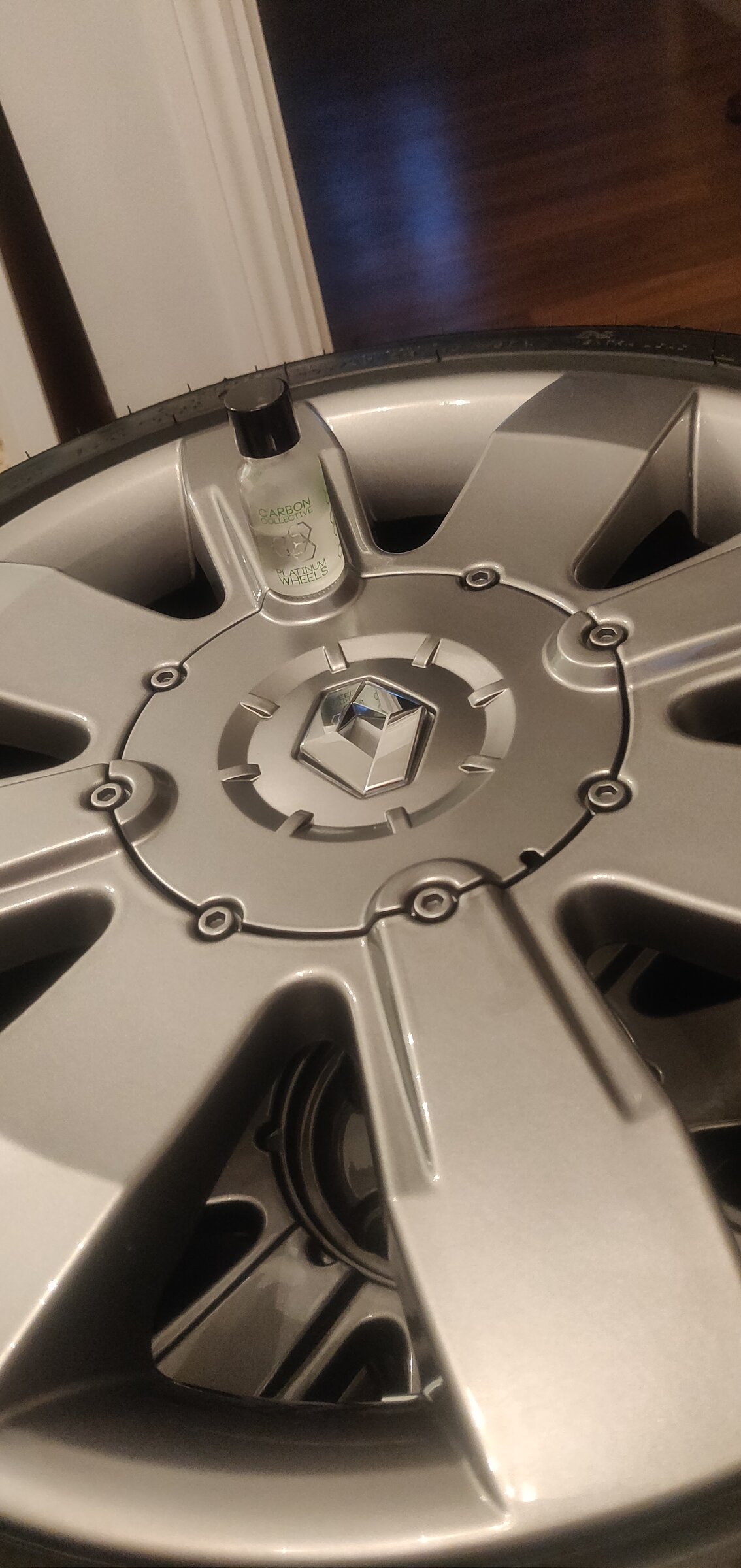

Well as you will see I couldn't quite decide 100% on the Turinis so stuck with the original 182 alloys.
Now fully refurbed and coated with CC Platinum Wheels. Once the coating fully hardens in a few days I'll pop them back on, want to also bleed the brakes with RBF660.

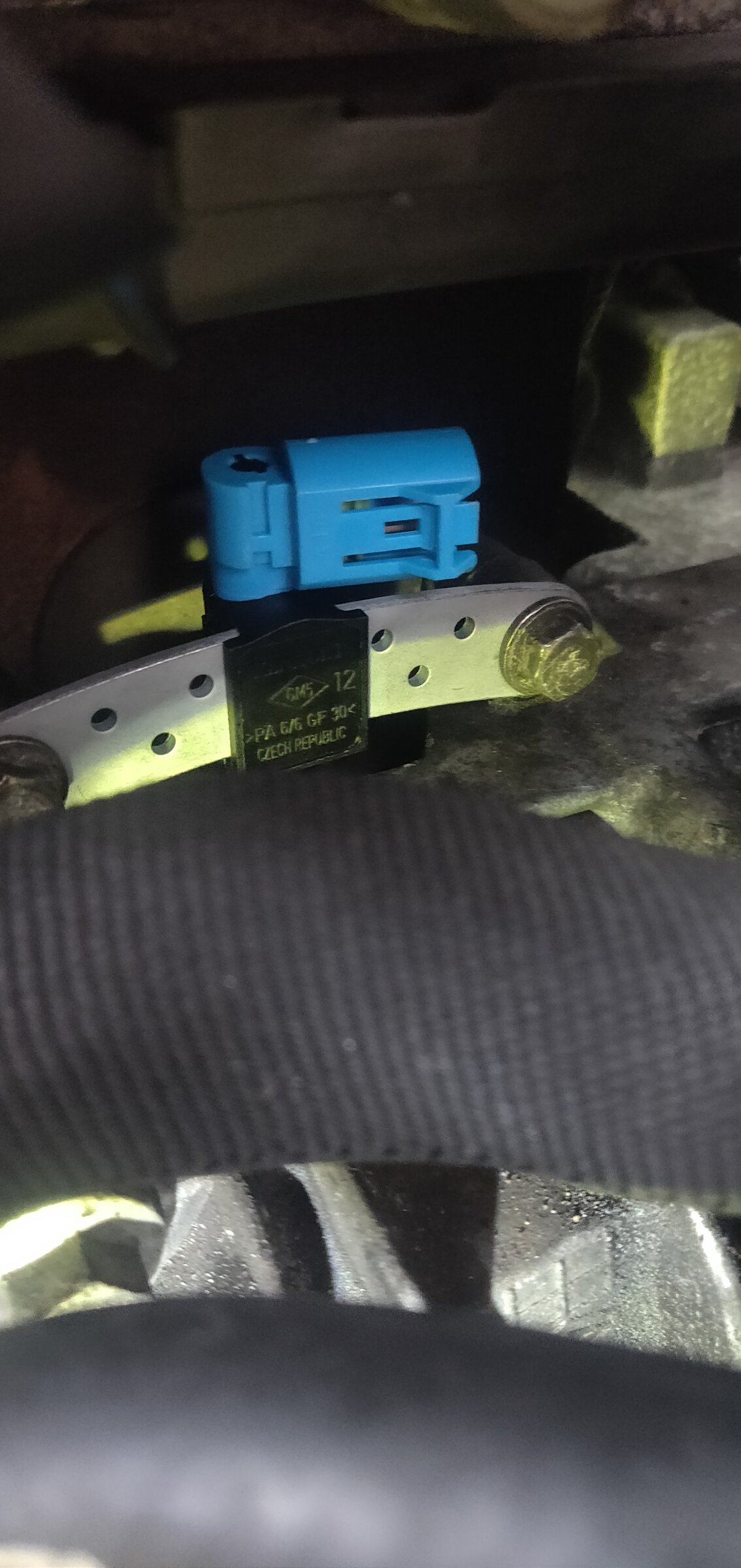

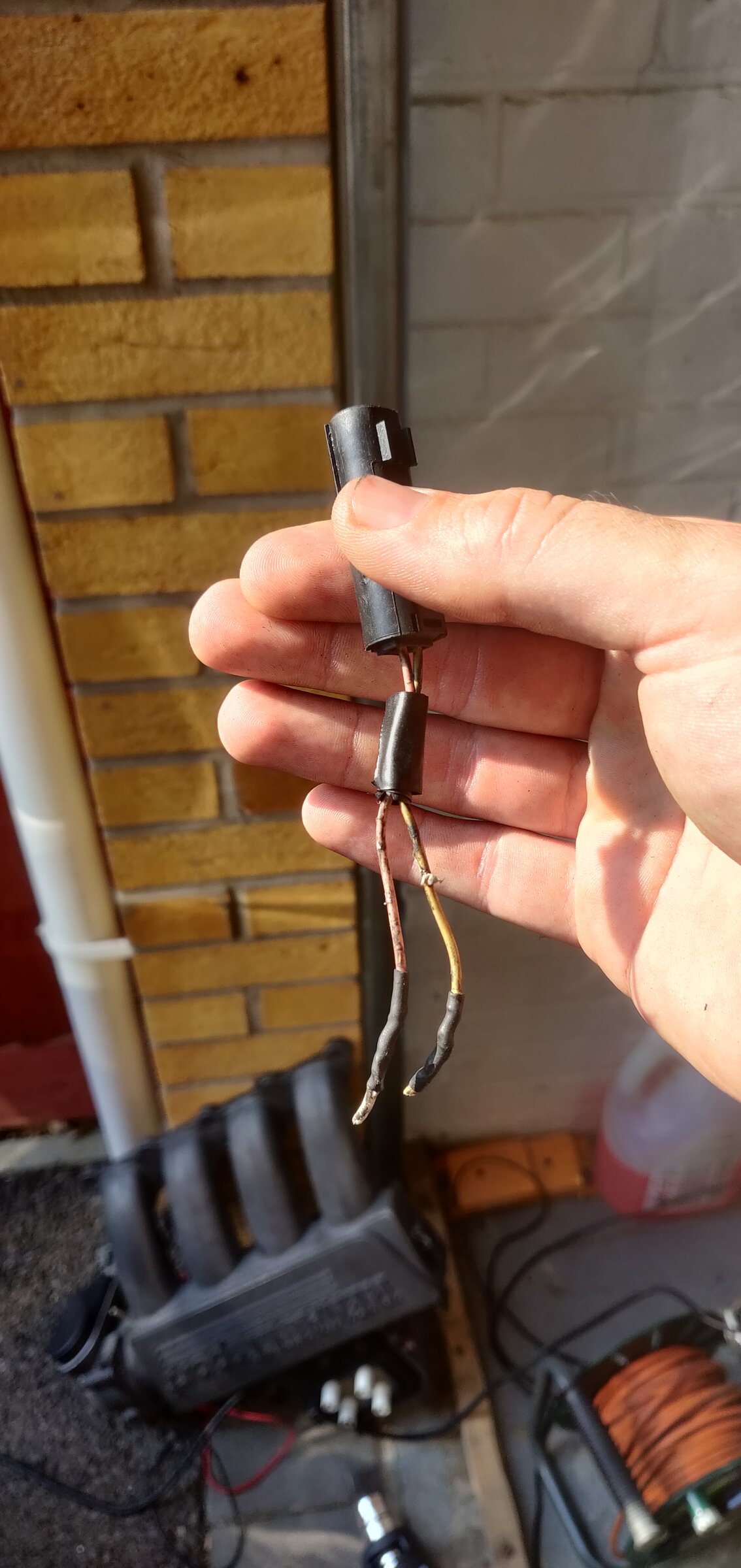

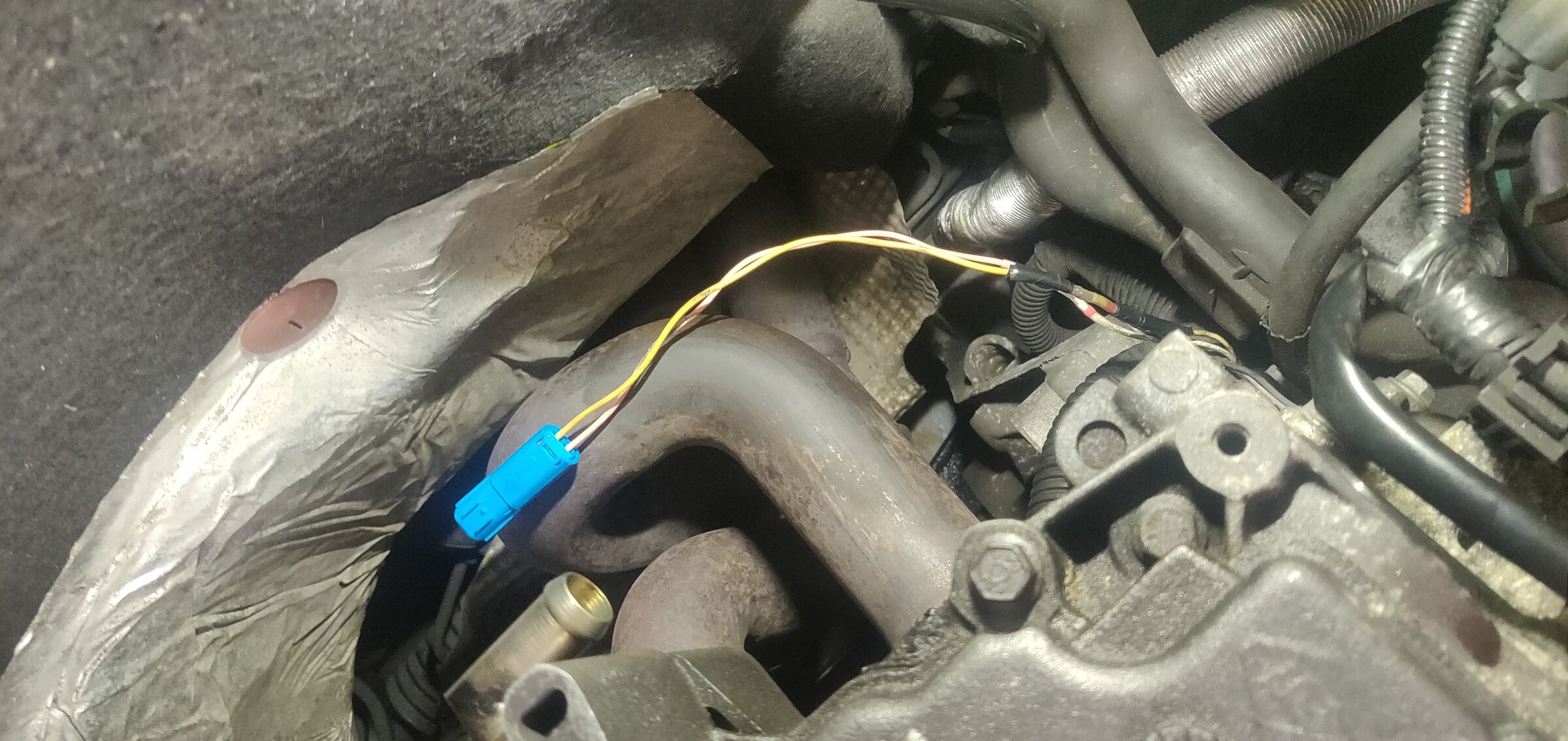

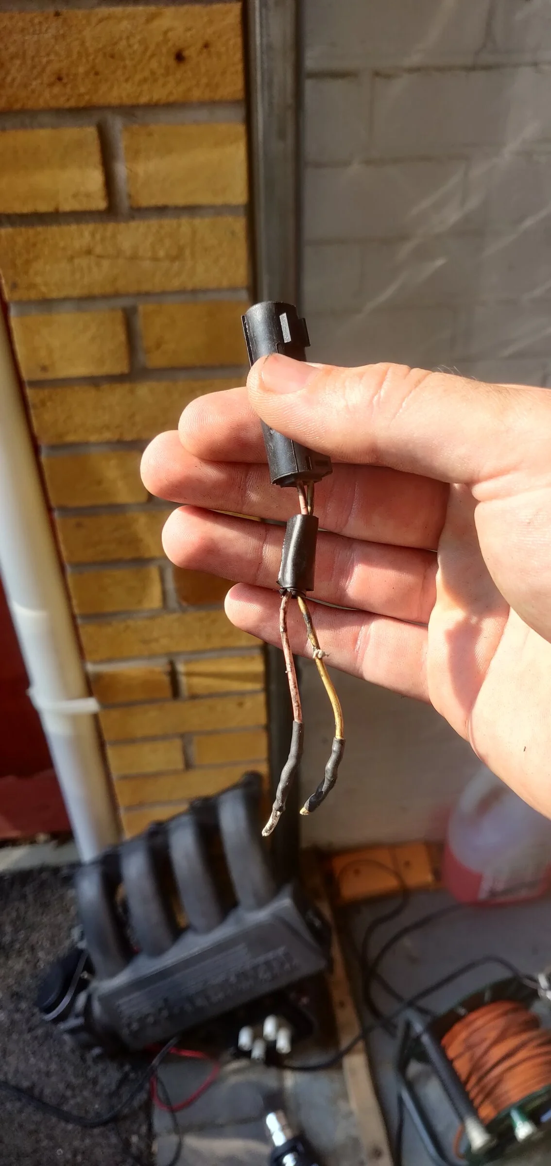

The other day I was going to take the Clio out to a mid week BBQ as the weather was nice. Drove it out the garage and onto the driveway and I went back inside the house for 5 mins to get a few bits. Then tried to start it again and cue endless cranking of the engine but no sign of ignition.
Plugged the RsTuner in and noticed it was showing 0 rpm. I could hear the fuel pump prime and could also manually start the pump with the RsTuner so ruled that out.
After a bit of playing around I ordered the new style crank sensor and associated wiring loom, just over £80 for both :rolleyes:
Very quick delivery from RPD so I set about changing it over today, I've never really had any signs of issues with the original sensor which is why I thought it was a bit odd, however once I had a look at the loom it appears someone has been in before and I assume soldered a different plug on -
New crank sensor in place -
And due to the previous soldering which I wanted to remove I've had to splice right next to where it enters the harness, but fingers crossed no more issues. I also took the inlet manifold off as for 5 mins work it gives that little extra space for the heat gun -
Hopefully get some sunny weather again soon and I'll take it for a test drive and make sure the solder butt connection is decent enough (first time using them).

Tbf the looks like standard Renault wiring almost as bad as how they spliced the alarm system in. :LOL:

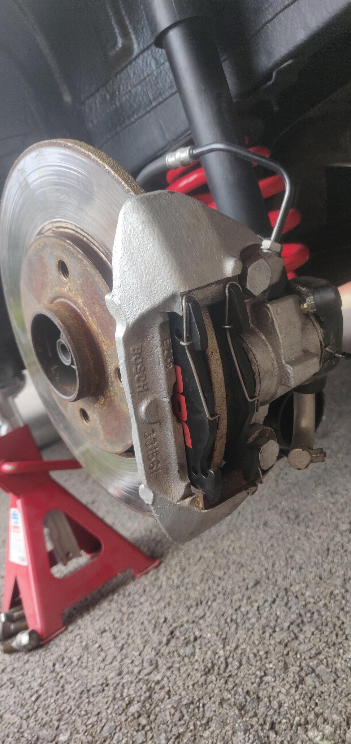

First track day of the year completed! Seems a bit crazy saying that but you seem to have to book about 3 months in advance to get a slot now :rolleyes:
Only did a bit of prep beforehand - switched the Typ200 fluid for RBF660, added some PBS rear pads into the equation and put on the trusty DS1.11s up front. Also removed the arch liners and foglights in case it was a hot day, this turned out to be good plan as the temps were about 34°C. Thank god for air conditioning!!
Prep wise -
I was slightly concerned about noise with the Ktec Ultra Performance system and sports cat. It was fine at Donny but as I've never had it static tested I wasn't sure how loud it actually was. It turned out to be 92dB at 5.2k rpm so happy days.
Spent the day with Beaniesport in their 750 Ktec Clio Cup car and a mate's i30N. Going out in the race car was quite the experience, although in that heat it was awfully sweaty - never been so happy to go out on track again in car with AC!
My 182 felt pretty good all day, although I was expecting a bit more from the PMS rear anti roll bar (stiffest setting) but I didn't feel the turn in transformation that some people mention. Mid way through the day the ABS light decided to make an appearance and stay on so I will need to get that sorted, the bias still felt fine but ABS was definitely not working as I found out on a couple of occasions. Other than that, the temp gauge did start to creep up from the middle after about 10 mins on track but I expect that will be due to the air con condenser hindering the cooling ability (AC on min temp & max fan).
It's had new coolant, gen thermostat and waterpump recently so may be worth a replacement condenser & radiator for efficiency sake.
Main thing is, I was able to drive it home and not call the AA!
