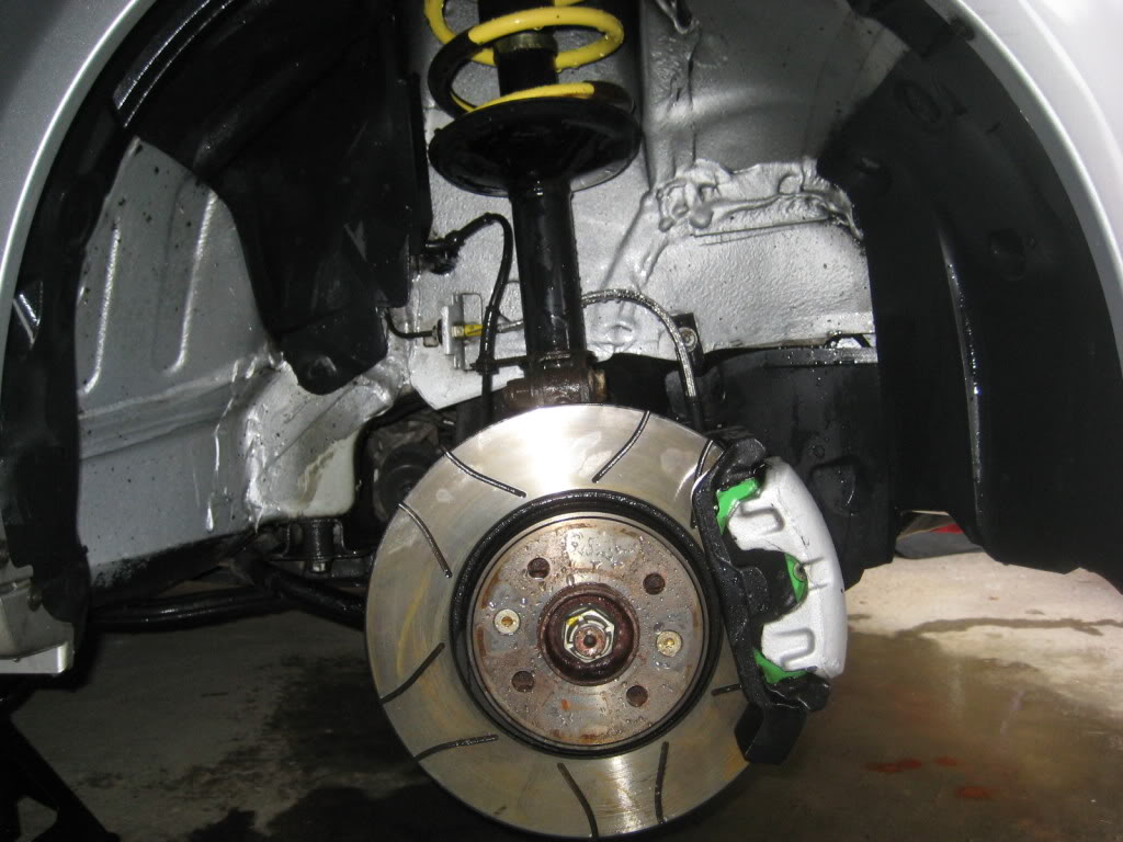

My brakes have been outstanding for over a year now :)
Just took this set up on the track and they did really well. Apart from the pads. Bit of Faid.
I may have paid too much but
Discs - Brembo Max fronts £90
Pads - EBC Green Stuff all round £96
Hoses - Goodridge Braided hoses all round - £49
Fluid Castrol Super Responce Or something like that, full flush - £23 2ltr
I would recomend all of them apart form the Pads
Get some Ferodo DS2500 or EBC Red Stuff or Carbone Lorenie (Cant spell the last one)
