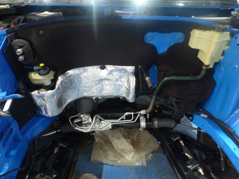

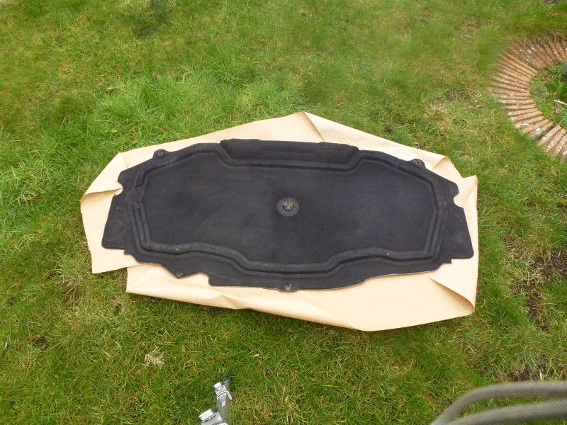

Finally got that Bulkhead heatshield/soundproofing panel in:
Big_Steve_T

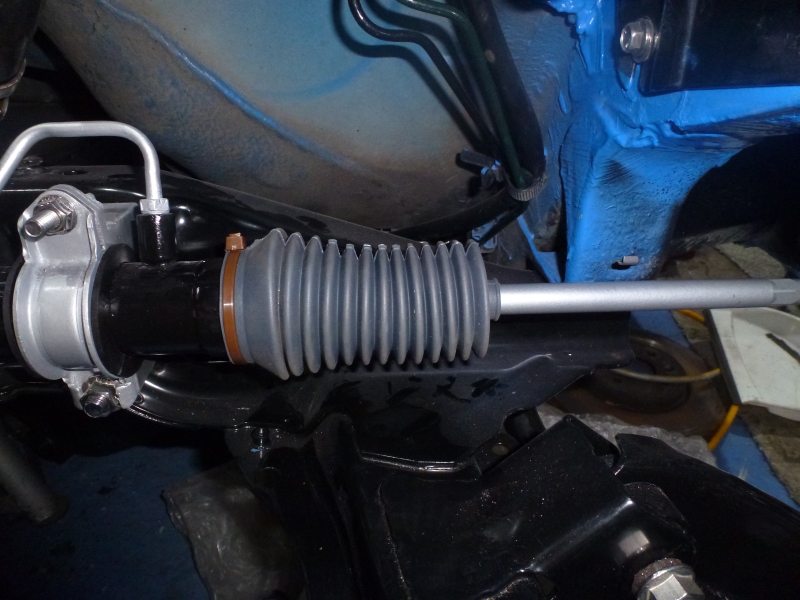

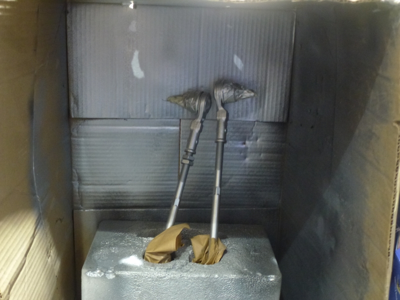

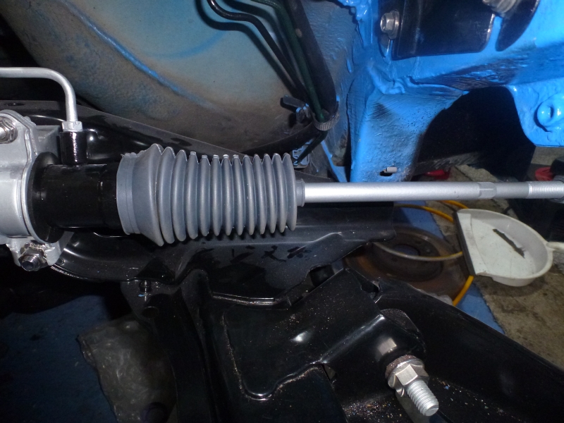

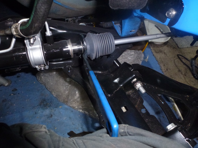

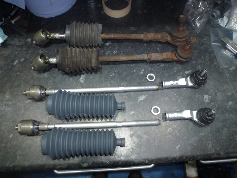

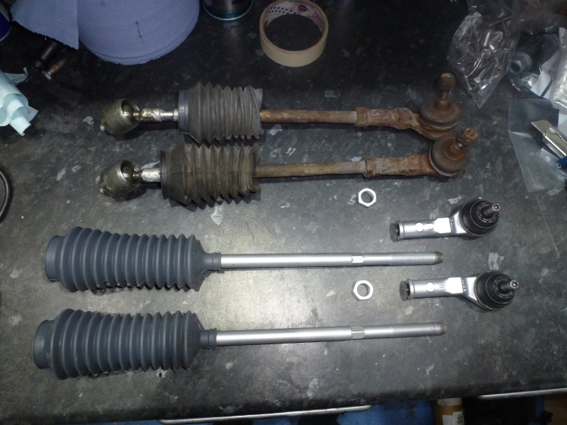

Got the Steering Track Rod ends painted, assembled and back on the car, so I could again move the car:

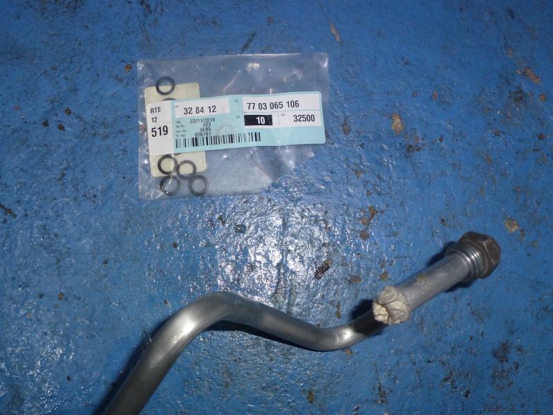

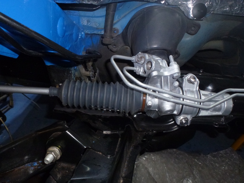

And then got myself some new Power Assisted Steering pipe seals from Renault, and fitted one to the low pressure feed pipe, before fitting back to the car:
Thanks for reading :)

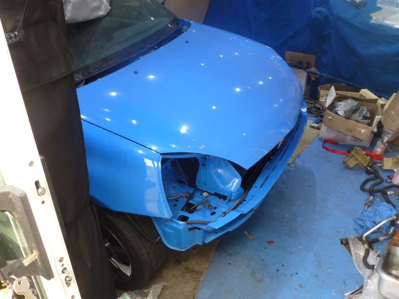

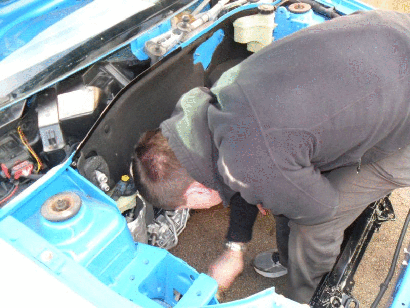

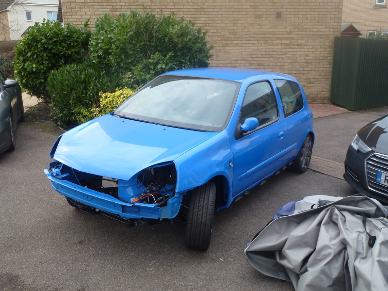

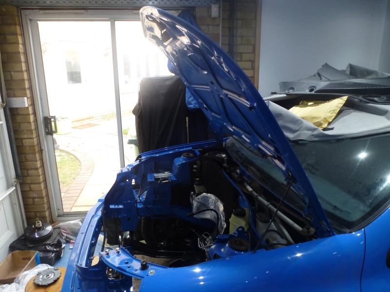

Following the sucess with the bulkhead heat shielding/soundproofing, I gave the bonnet matting a dose of the same treatment:

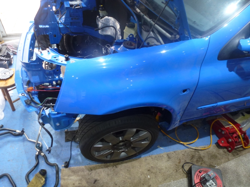

I could then get the wing, wheels and bonnet back on the car:

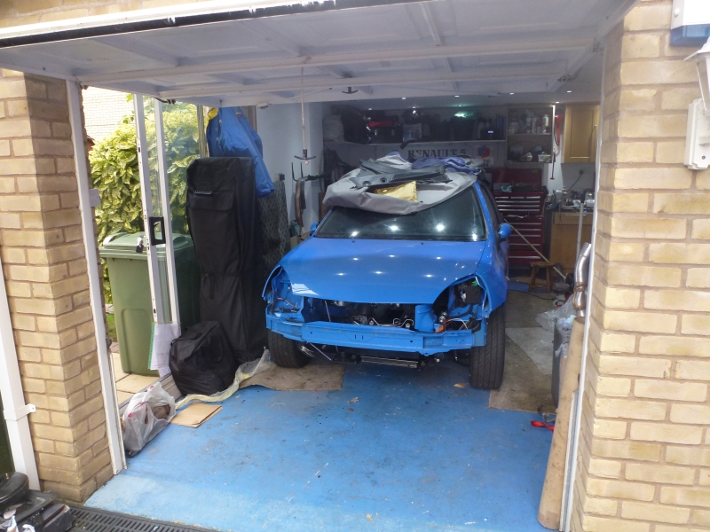

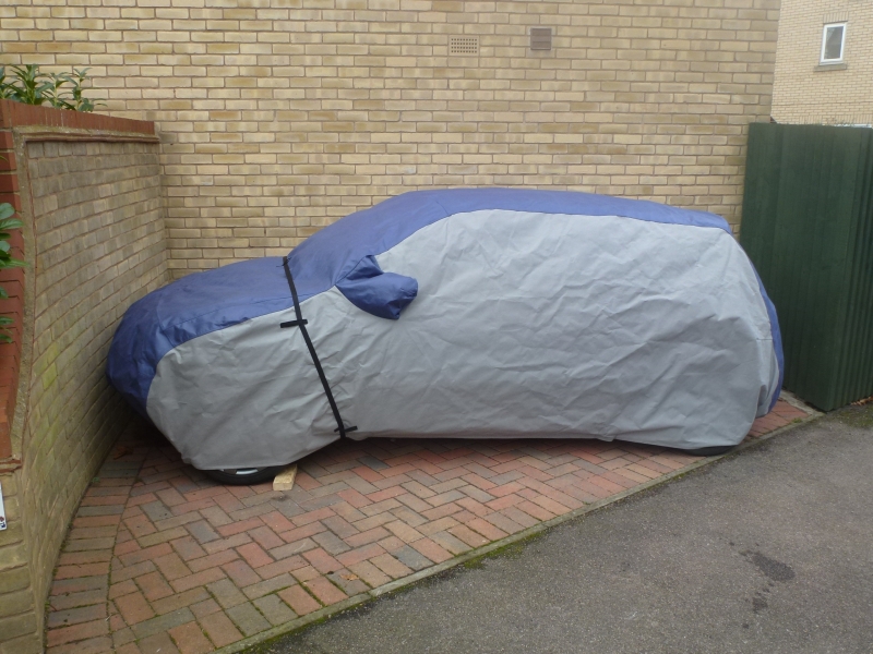

...before dragging it kicking and screaming out of the garage and back into the drab british winter!!
but it was soon wrapped up under it's fitted cover:

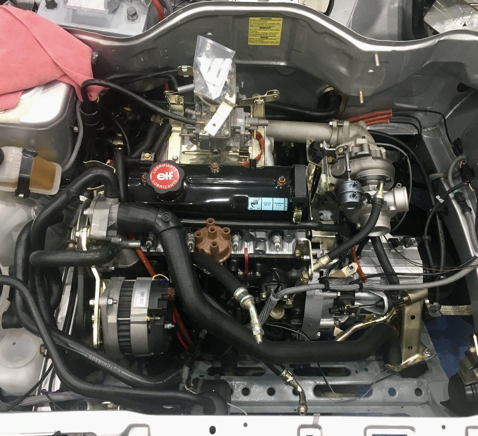

Fantastic job. Just read through the whole tread. More pics of the 11 too!

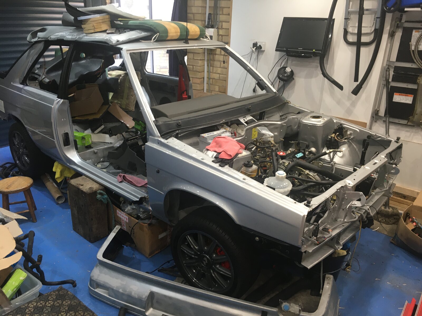

Here’s a few live ones I just took from my garage @Iain C :
engine bay is coming together, the Cooling system is going in at the moment:

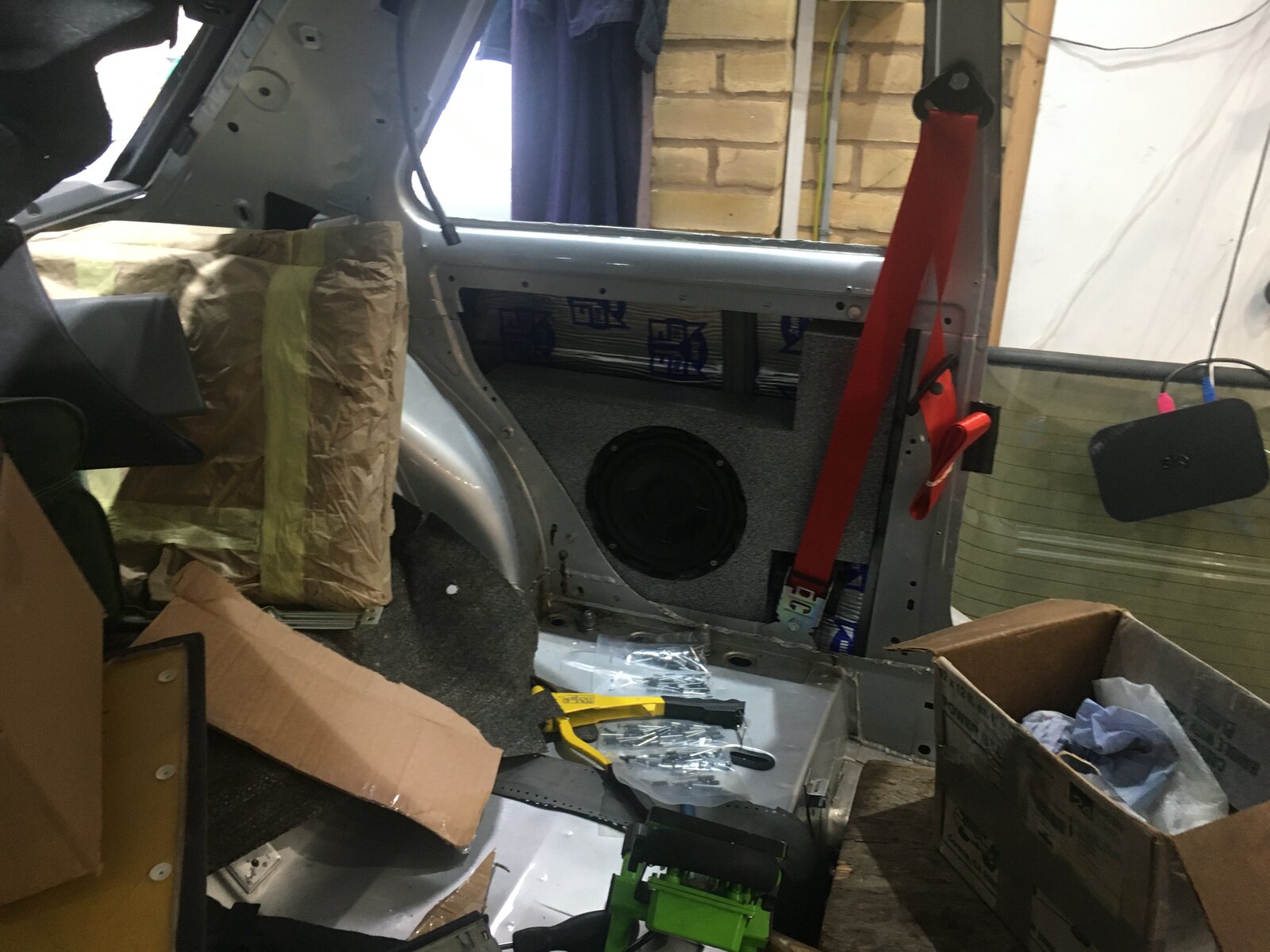

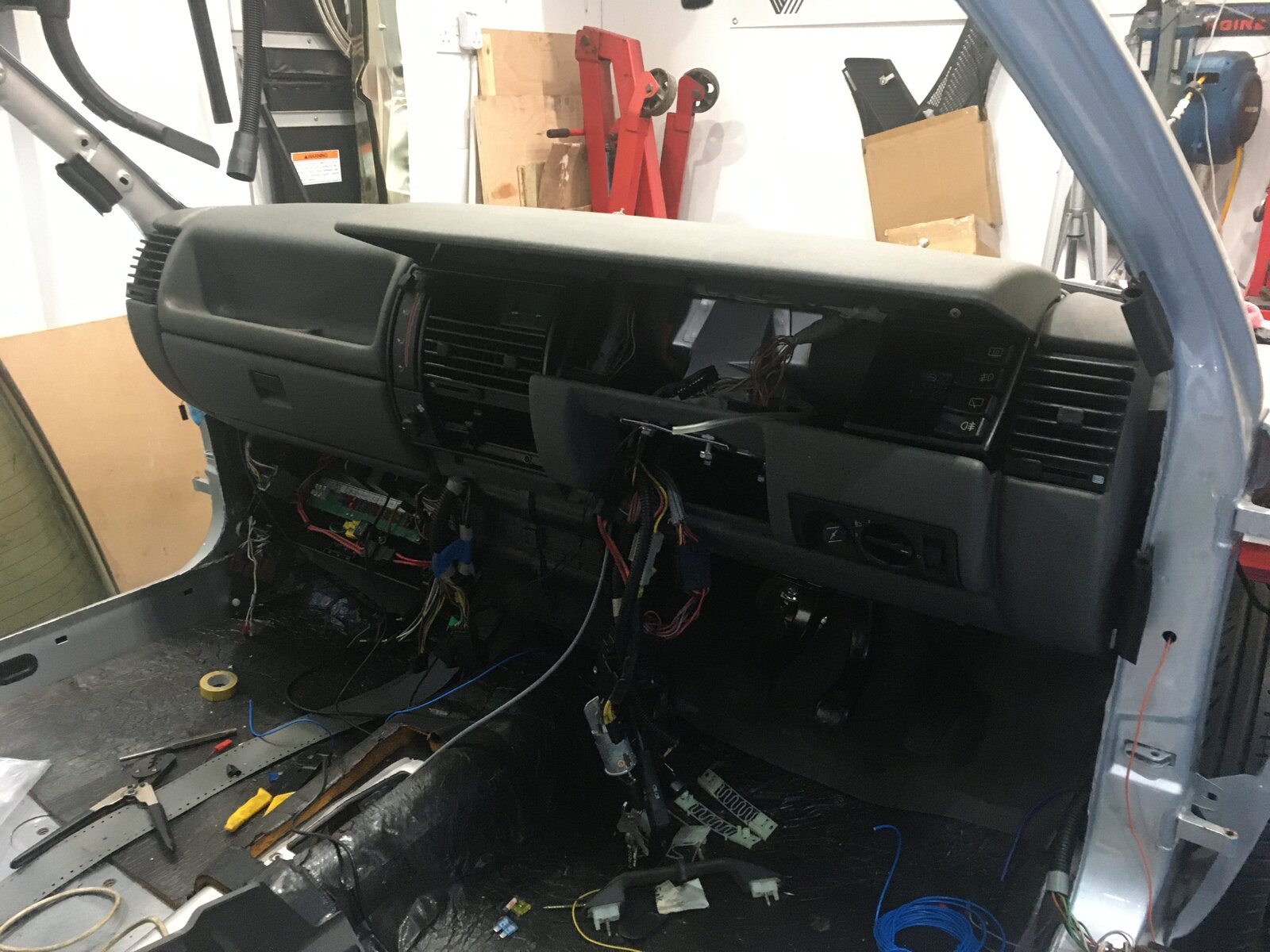

Dashboard is in, but the roof lining is holding me up at the moment... currently waiting for my balls to grow enough to tackle it... 🤦🏼‍♂️

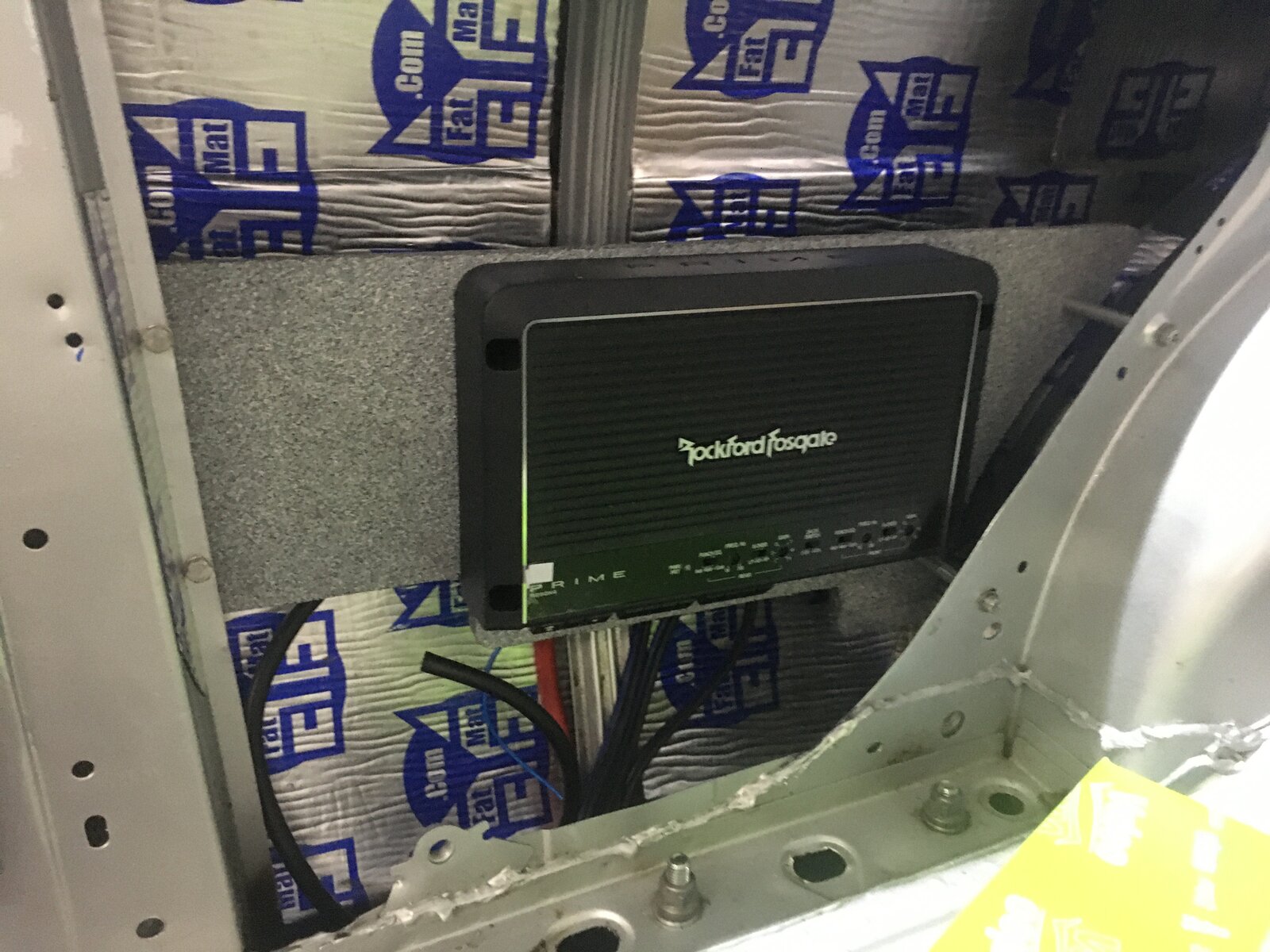

finished installing my cheeky ICE system (Yes I know that term and scene is years old... much like me! 😂)

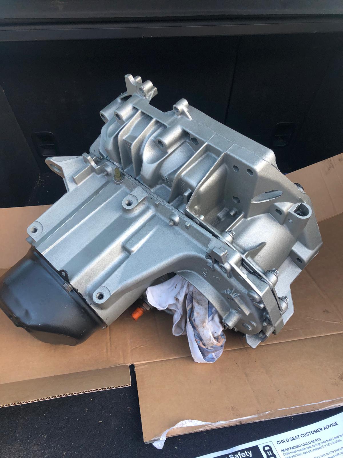

Finally got my Gearbox off Bloke aka Carl Wadeson after its 1 year holiday on the Wirral... 🤦‍♂️
Looks ok, I just hope the giblets look as good as the outside which has been blasted and re-painted. Hopefully I can get it all dropped back into the engine bay soon!

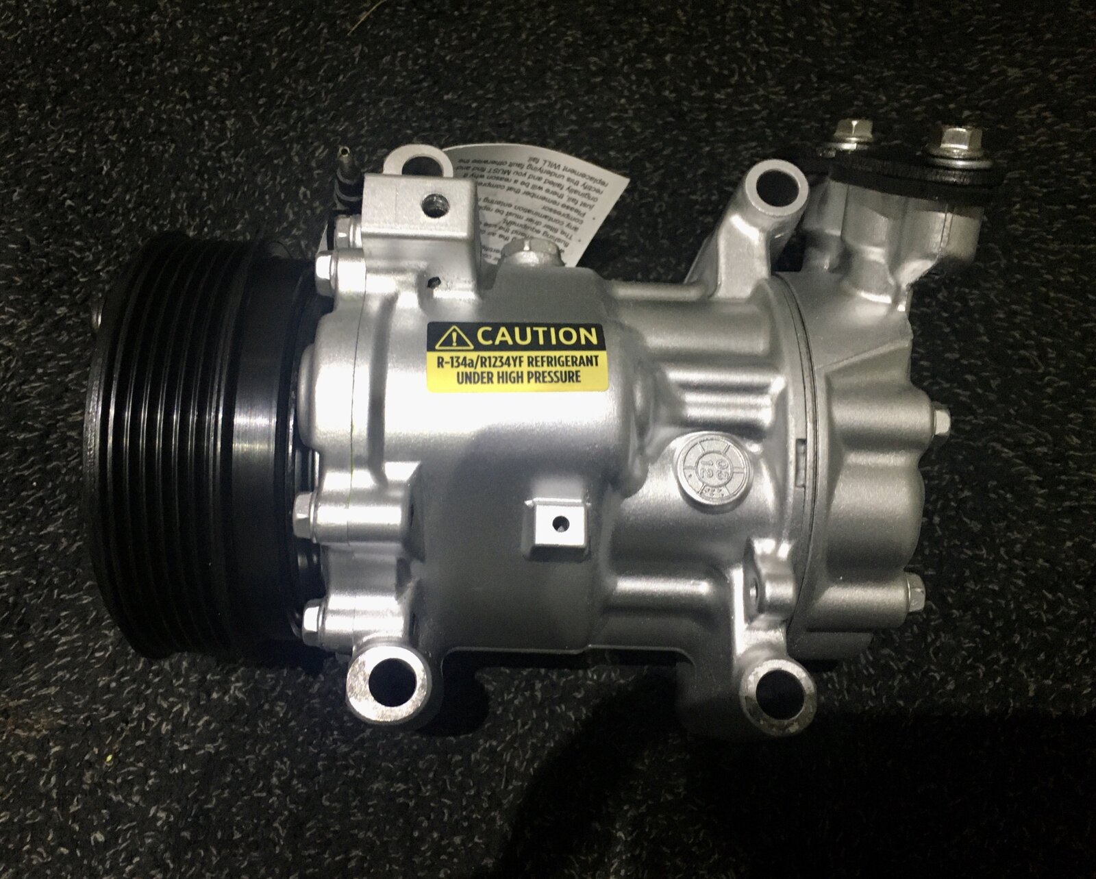

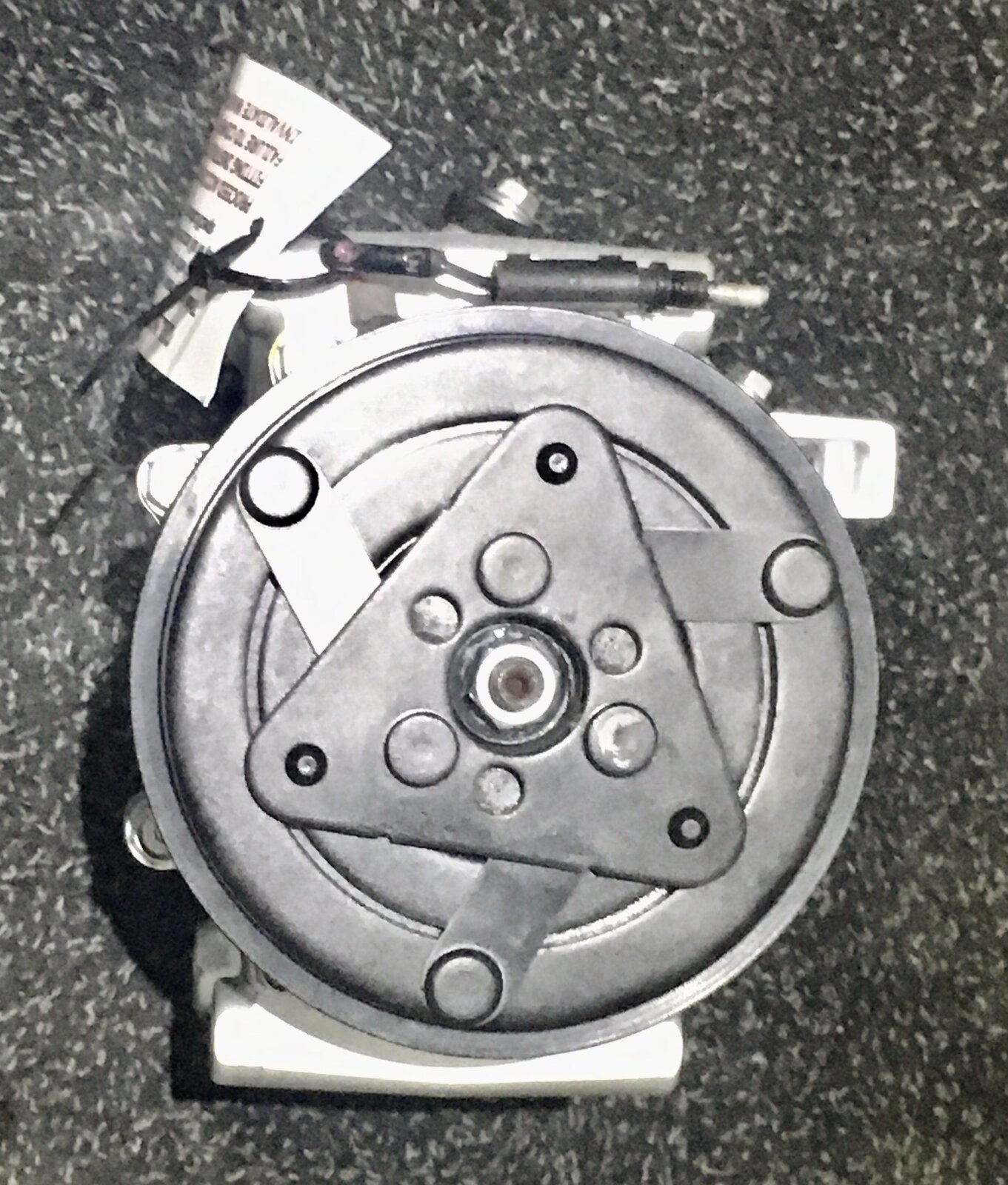

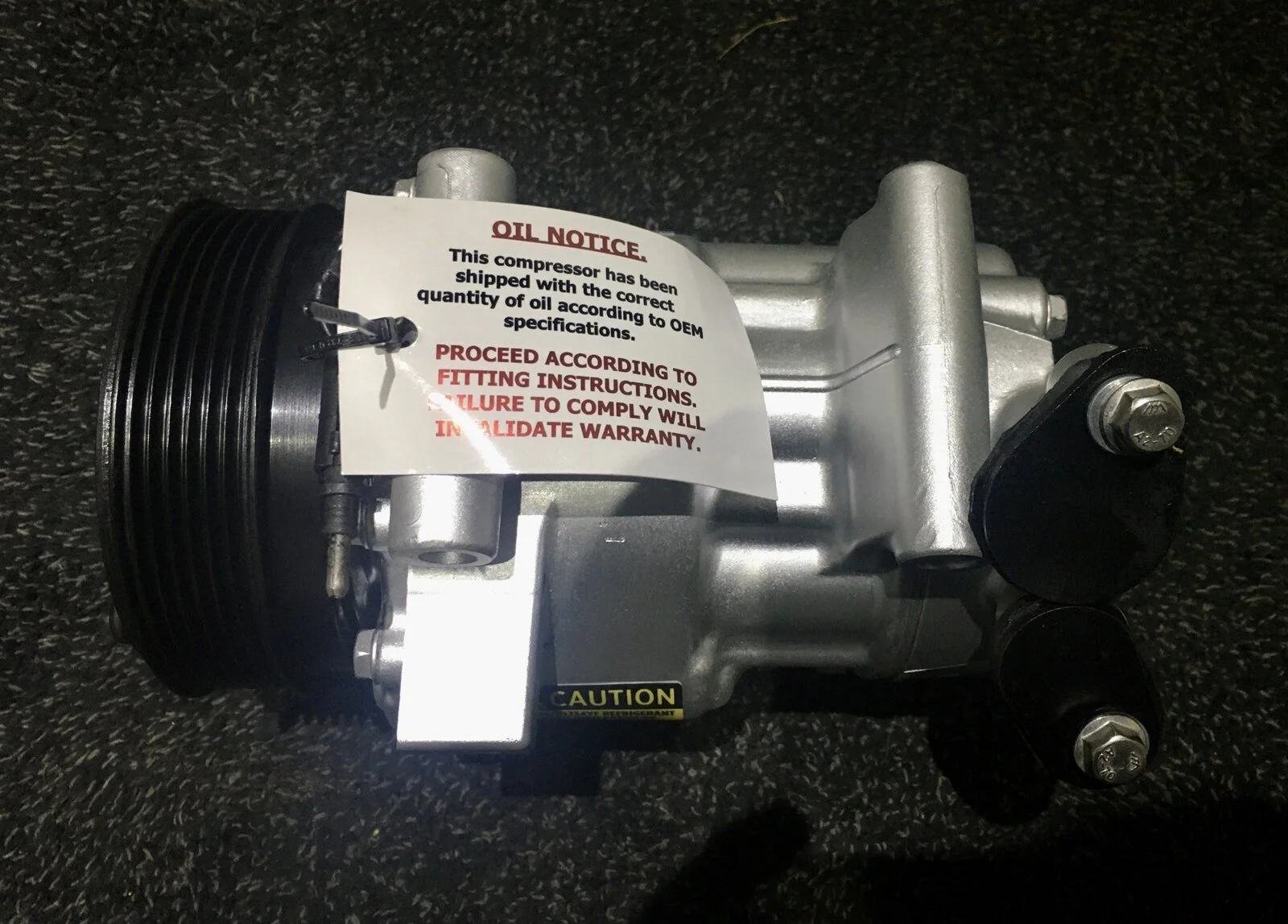

In preparation for the re-assembly, I’ve also had the OE Air-com pump Re-built to ensure the A/C System is in Tip Top condition when it’s all back together:
I’m hoping I can get this car back together for the ClioSport national Day this year..!?

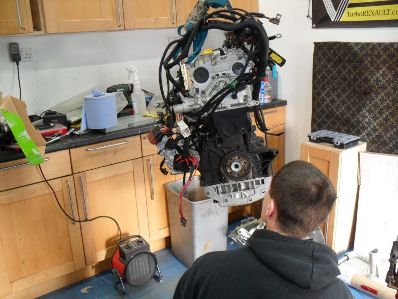

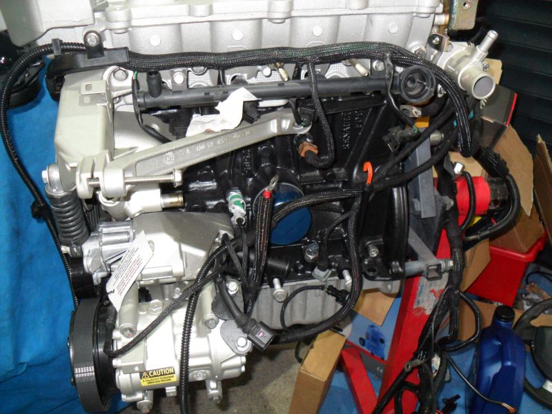

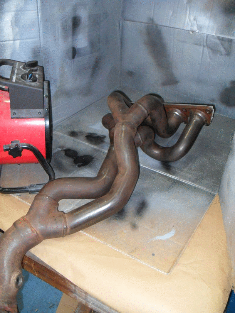

Been working thru the engine loom I got off @Mbeau that was in great condition to begin with, just wanted to go thru it all and clean/re-wrap it all in new softer insulation which I think looks better in the engine bay:
Also gave the exhaust manifold a little tickle with some high temp paint, to make it look a bit more presentable:

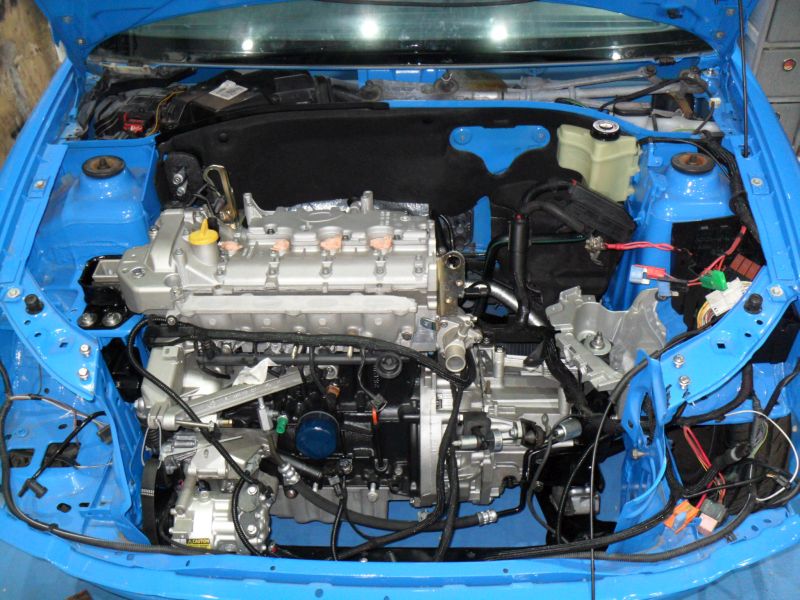

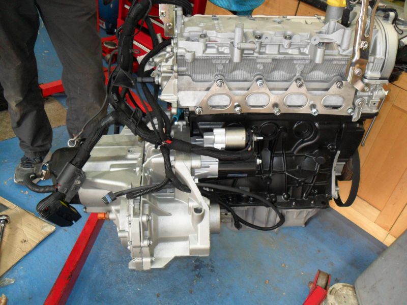

Nothing ventured nothing gained I say!!! :cool: So today I finally got the engine back in the car - BY GOD there's not a lot of wriggle room in these engine bays is there?! 🤦‍♂️:D

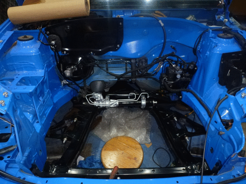

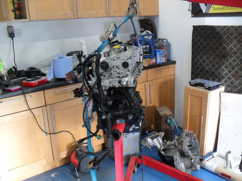

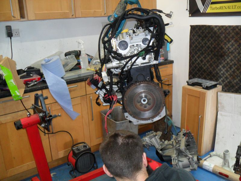

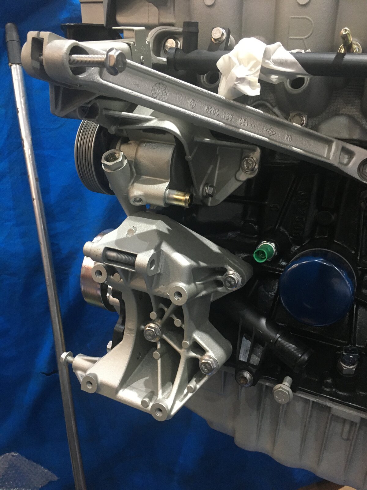

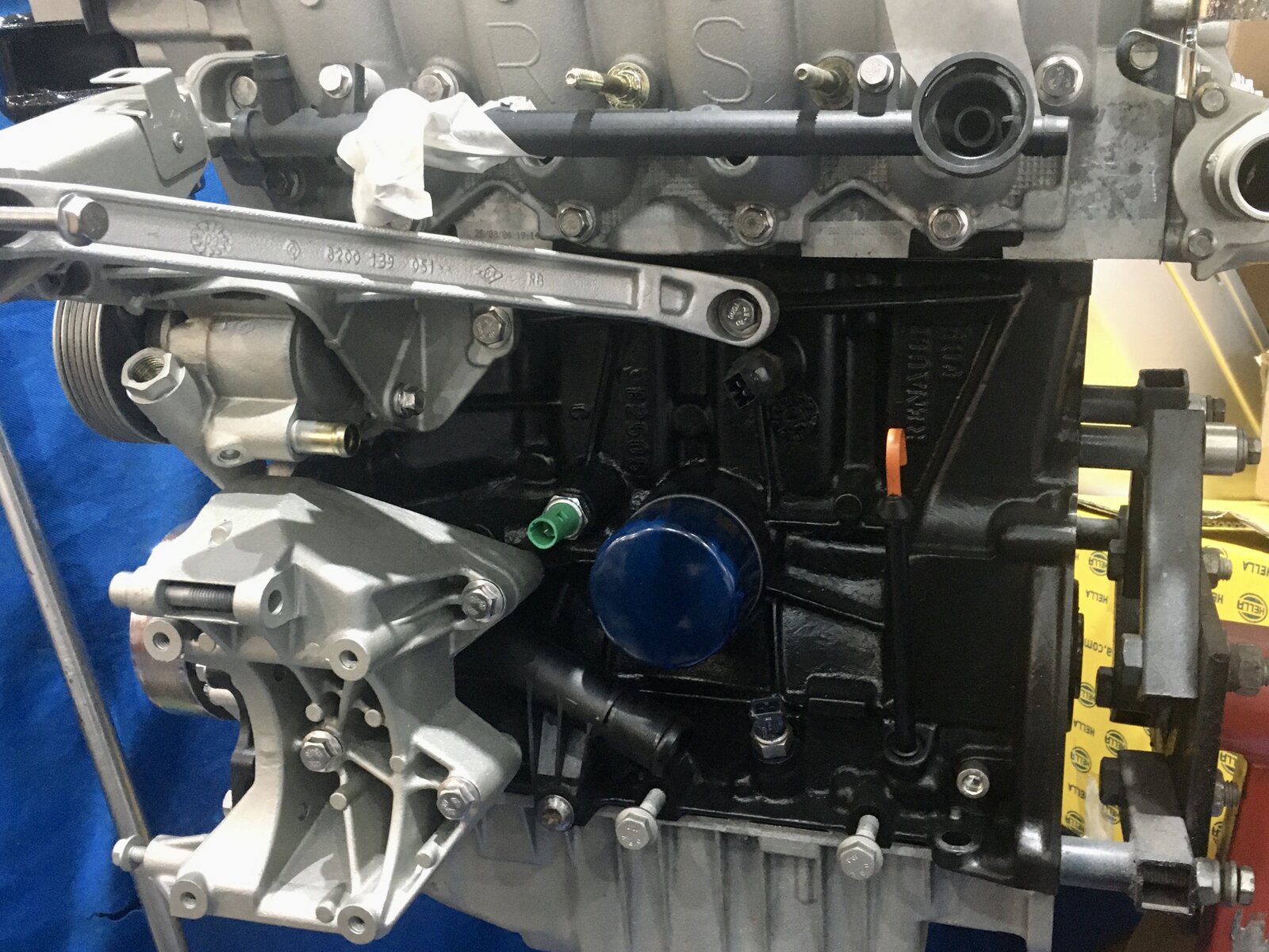

First job was to give the front subframe a little wash down as it got quite dirty, from just sitting outside, stationary, under a cover..? 🤔 We then fitted the PAS pipes, heatshield, and exhaust manifold:

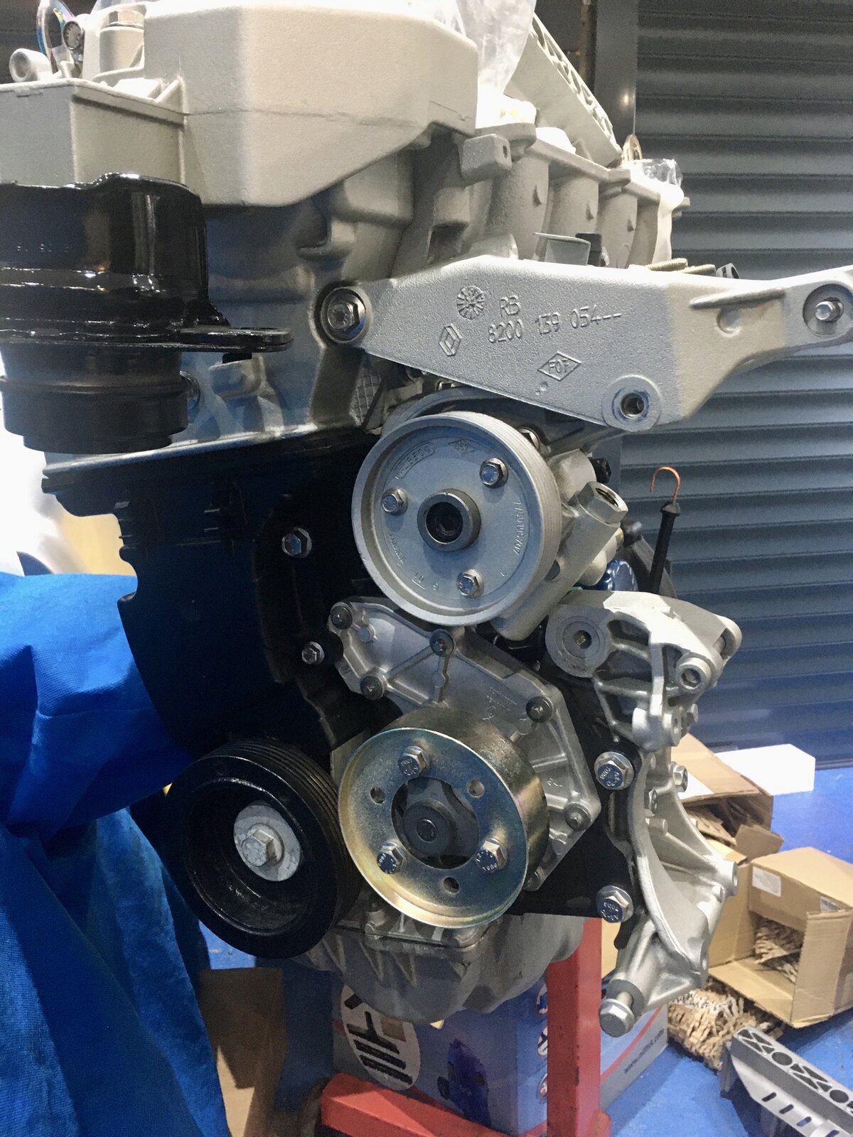

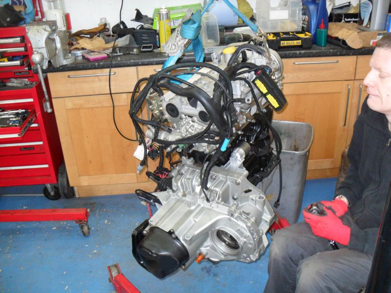

Next we fitted the flywheel, clutch, and gearbox to the engine:
We also made our life a WHOLE WORLD easier by also fitting the starter motor and wiring it up at this point also...! (Heatshield fitted after I took this photo)

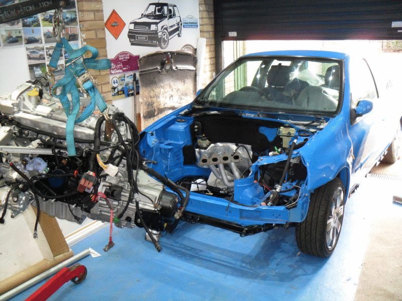

Next it was time to finally dropping the engine into the bay:
And torquing the engine mount up to spec..

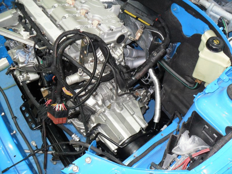

A photo of the finished article:

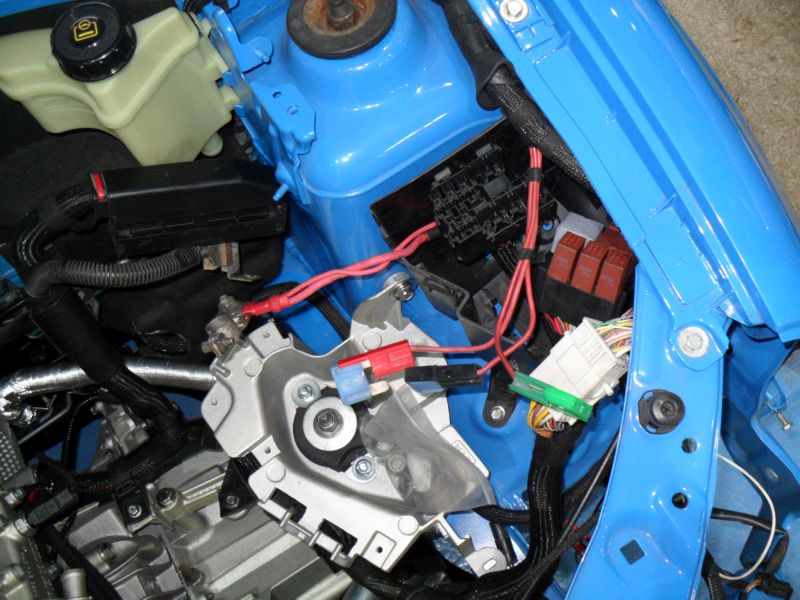

I need to connect everything up in this connection box but unsure what goes where.. If any of you have a link to the correct layout/connection/configuration of these connections you could pass onto me, that would be fabulous!!
