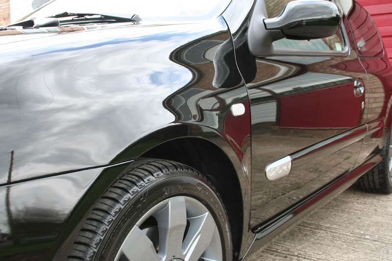

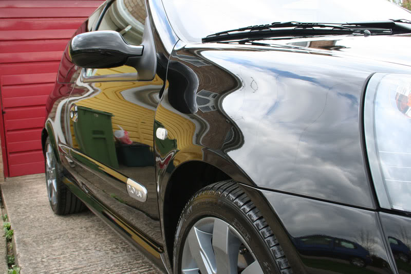

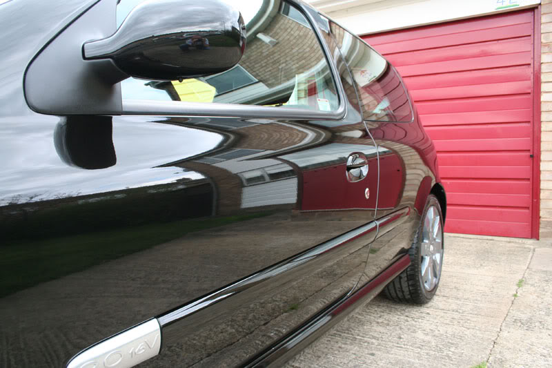

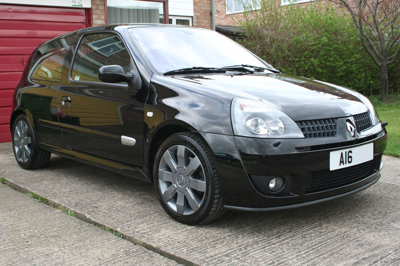

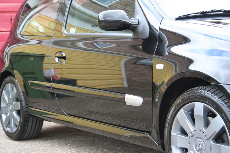

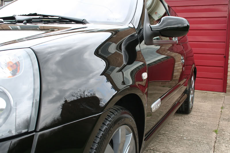

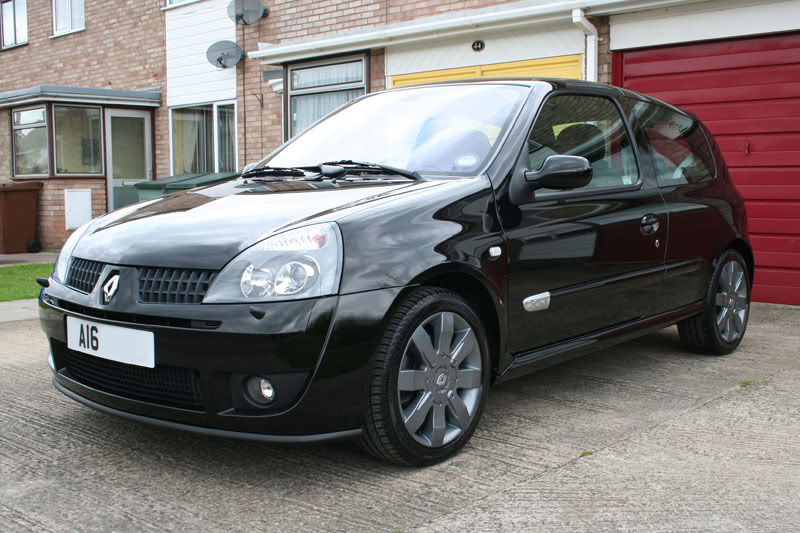

Started to get the car reay for the show season this weekend, process used here for those intrested, its had a damn good PC'ing!

Stunning... Rich would you mind giving an overall run-down of the products you used to achieve that look, for those of us who haven't got half a clue and are in awe of your uber-cleaning abilities? :)

Most of the work was done by PC
Swirl Removal - Poorboys SSR 2.5, Light Cut Pad - A fairly abbrassive cutting polish.
Polish - Meguiars Speed Glaze 80, Polishing Pad - A very rich deep gloss polish that leaves an excellent finish.
Glazed - Cleakote Vanilla Moose Hand Glaze - Polishing Pad, Clearkote Red Machine Glaze. Add lots of oils onto the paint to give a real deep wet gloss.
Sealant - Wolfgang Deep Gloss Sealant. A very deep looking sealant that looks good on dark paints.
