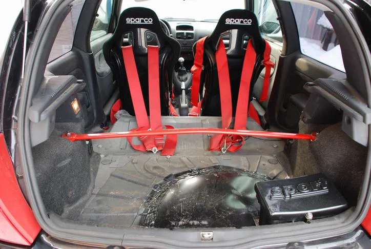

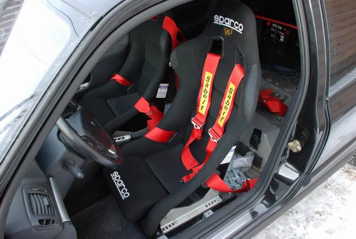

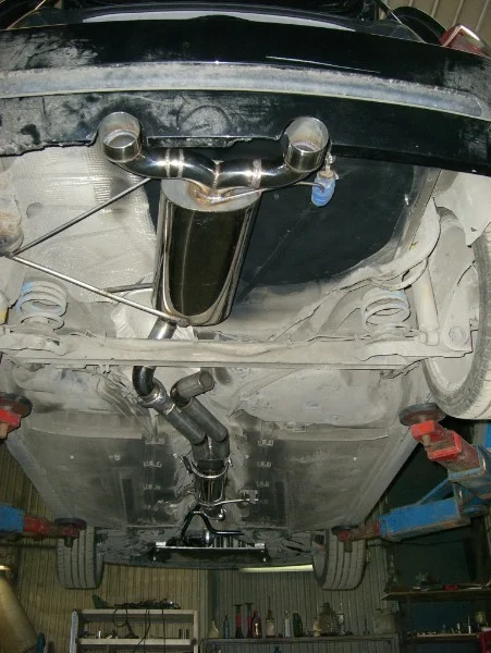

The project is still in development, but some pictures are here:

Some comments:

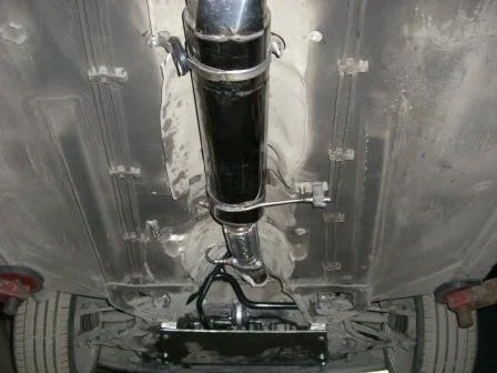

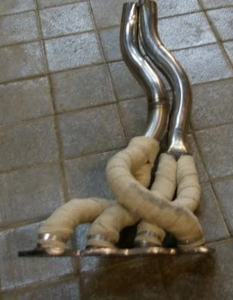

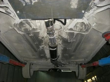

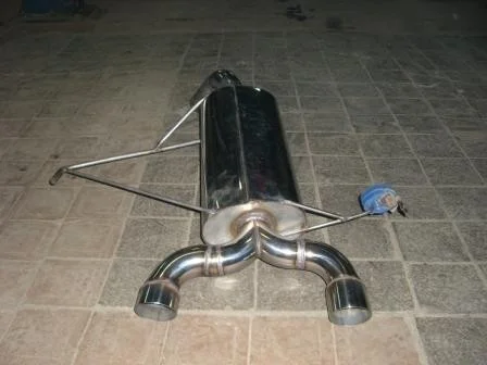

Black: Original manifold with Supersprint decat exhaust
Blue: Custom-made 4-2-1 manifold and decat exhaust (+6.4 hp & +3.3 Nm)
No ECU remap

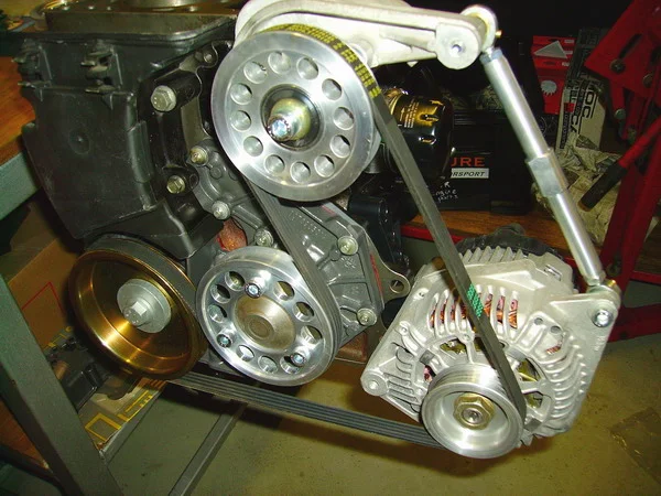

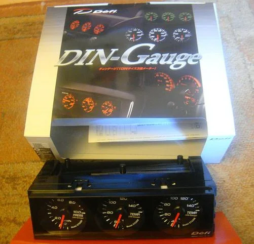

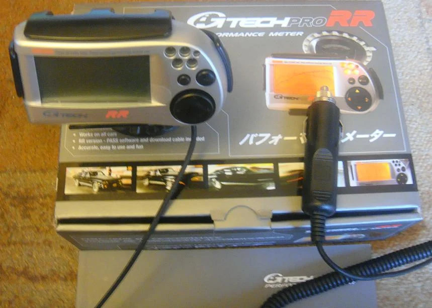

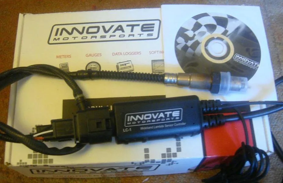

Some gauges to be installed in my car:

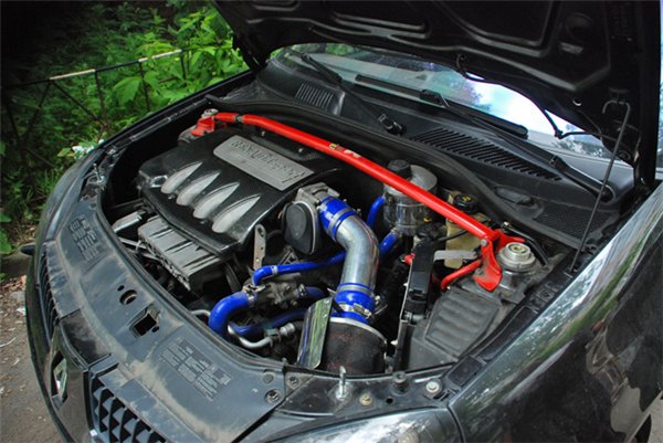

Some new pictures:

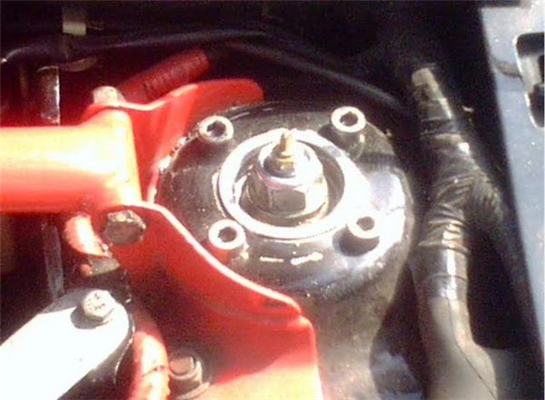

KW Variant 2 coilover suspention kit:

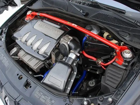

New Pipercross induction kit with polished alloy pipe and screen:

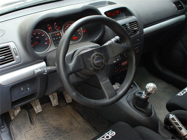

Momo Monte Carlo 320mm wheel:

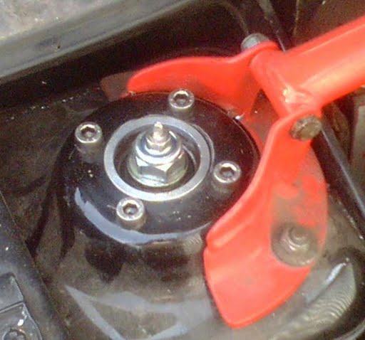

Hey man, really like your car, and thats a great suspension you have in there, car's going to handle suberb.
Just one repair, the strutbrace is looking bad, lots of rust on it, besides that its great.;)

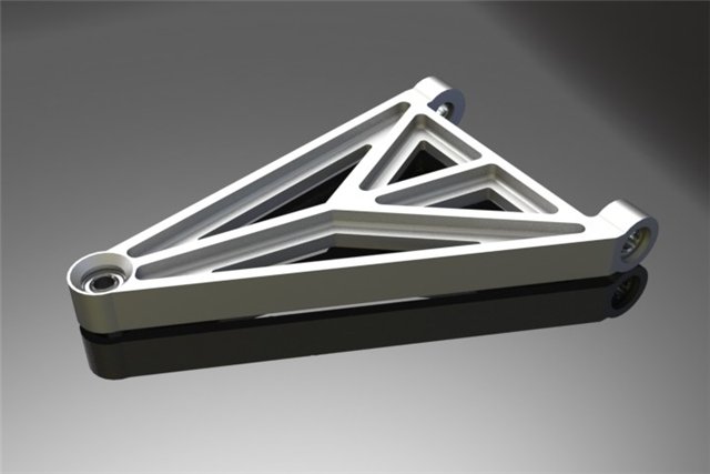

Alloy triangle front arms with ball bearings.
At first, 3D-scan of the original one:
And how it will be in future:
Absolutely love this, remember having seen it previously. Progressing very nicely, whats the plans for the wishbones-will you be manufacturing them eventually? Will you be running them with stock or laguna hubs?
I pay for wishbones just today - so I hope they will be ready in a week or so. They will be with the solid bearings, not bushes (if you mean this). Sorry for my English ;)
Oh my!!! Those wishbones are beautiful. Are they something you would be creating more of? Incredible, at least in the computer stage
How much have you paid for them? Want to send me the CAD files? Lol
And are laguna's hubs different? I am planning to do some hubs from the forged alloy, but this is under development now.

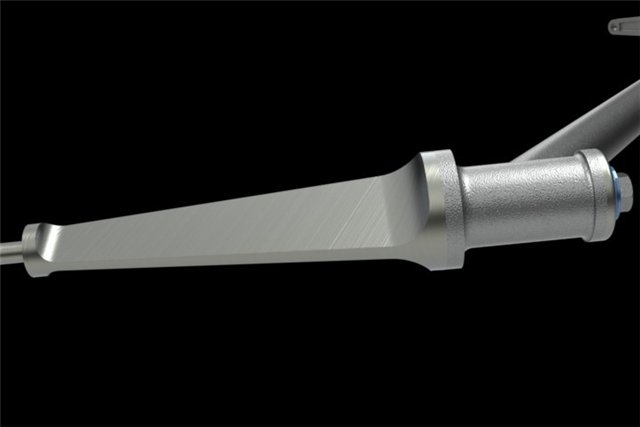

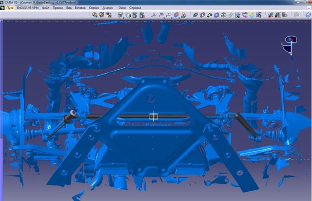

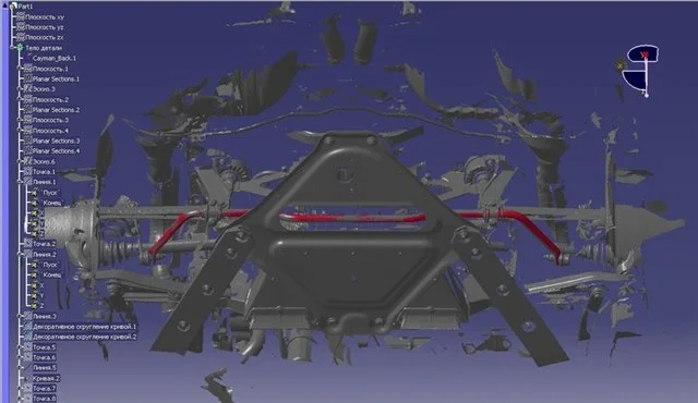

And here is the project of the "blade type" ajustable front anti roll bar:
I can give you a contacts of my engineer - this is his IP :)
For example - some of this development for the Porshe Cayman:
Standard:
Blade type:

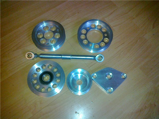

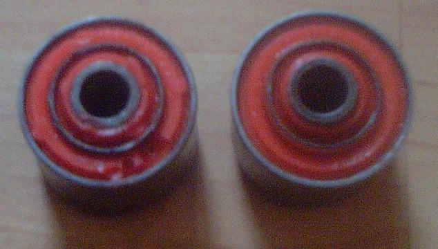

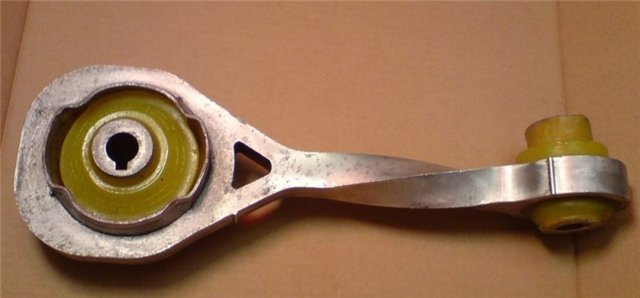

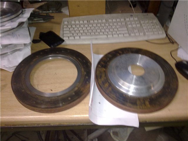

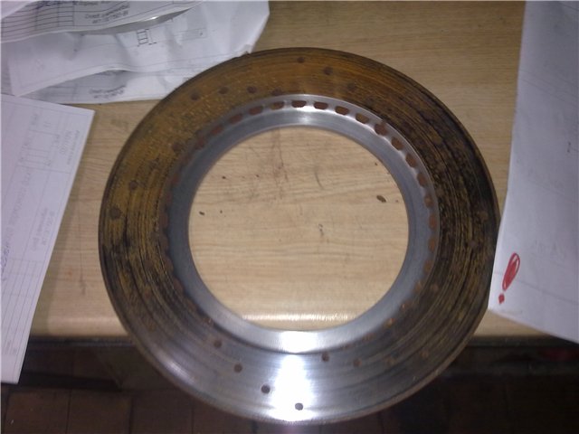

Some polyurethane stuff made from original parts.
Dogbone:
Front wishbone bushes:
Rear bushes (now replaced with the Pure Motorsport bearings):
