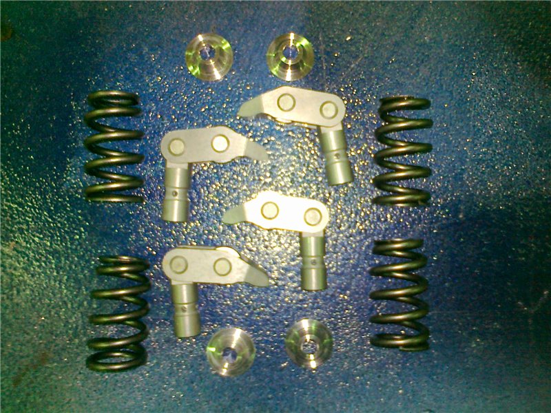

And new rocker arms, springs amd platinum retainers ... for 9000RPM enine
No you get them from here mate. They're a copy of the R3 maxi evo setup.Nice. Are they custom made?
http://www.xrallyparts.com/

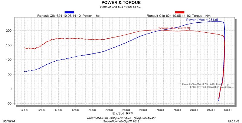

Which pistons you used with this setup I am doing same setup with 197 pistonThis is what we got from F4P (1.8l) engine build - 231.6bhp and 202.3 Nm torque!!!
What about your camshafts and camshafts degree do you retarded ir advanced a camsWhich pistons you used with this setup I am doing same setup with 197 piston
What about your camshafts and camshafts degree do you retarded or advanced a camsThis is what we got from F4P (1.8l) engine build - 231.6bhp and 202.3 Nm torque!!!
