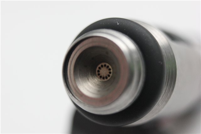

The part number is: Magnetty Marelli injectors - IWP189 - Shower style, eBay price is £89.95 They are the same size as the original (the original are IWP042).

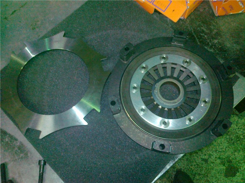

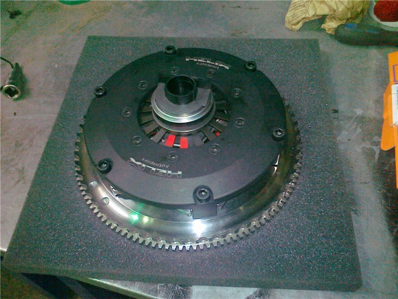

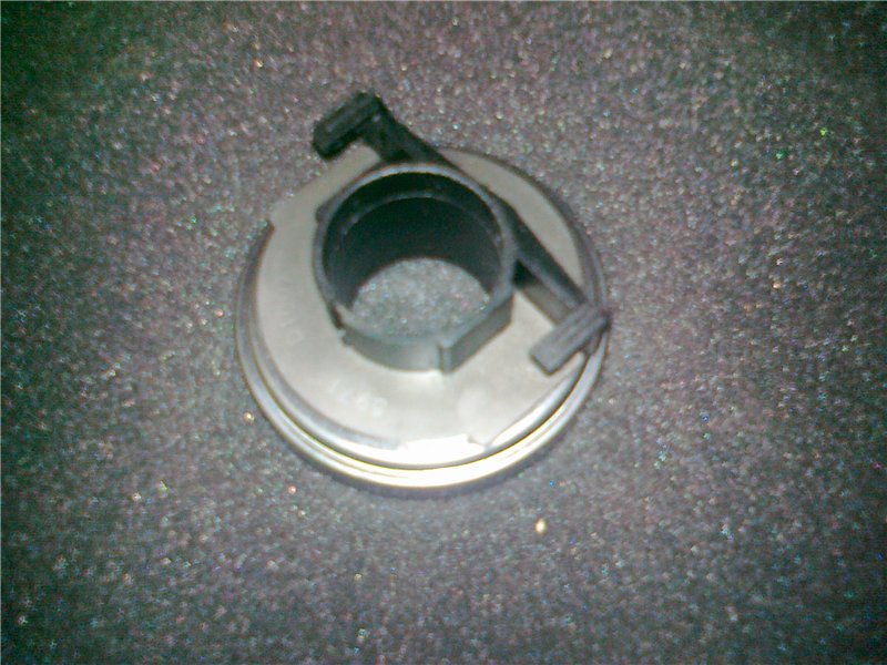

where did you get that clutch and how much was it?

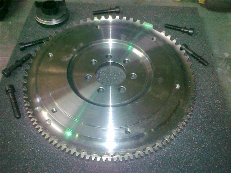

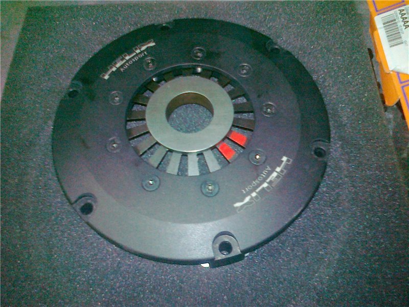

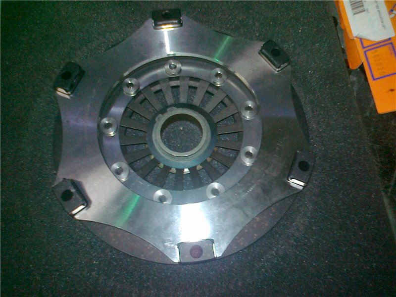

I got this clutch from DemonTweaks and they spend near 3 months in communications with the Helix (manufacturer) to build the proper configuration with the release bearing compatible with original 172's gearbox. I think that now you can get it much faster - just ask the John Harris JohnH@demon-tweeks.co.uk about price and time!
BTW - DemonTweaks give 10% discount for ClioSport.net Club members, so it is VERY reasonable to pay just 5.00GBP for annual membership, as soon as you will return much more from the first order! ;)

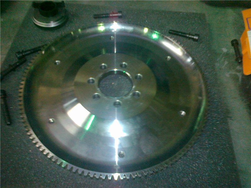

You will also need to buy 184mm flywheel at TTV Racing to use this clutch - or machine the original flywheel !!!

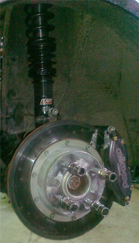

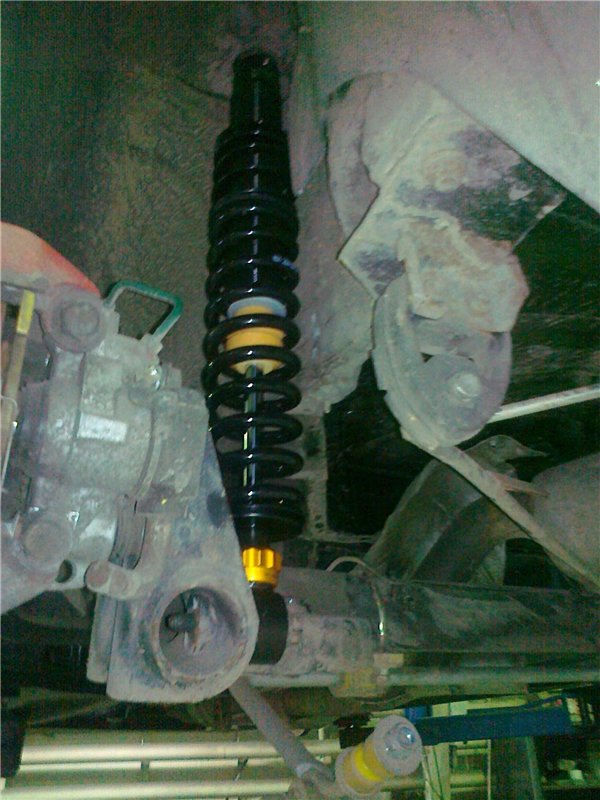

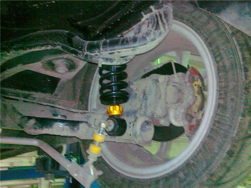

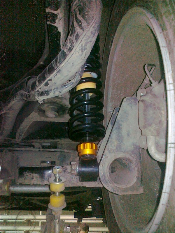

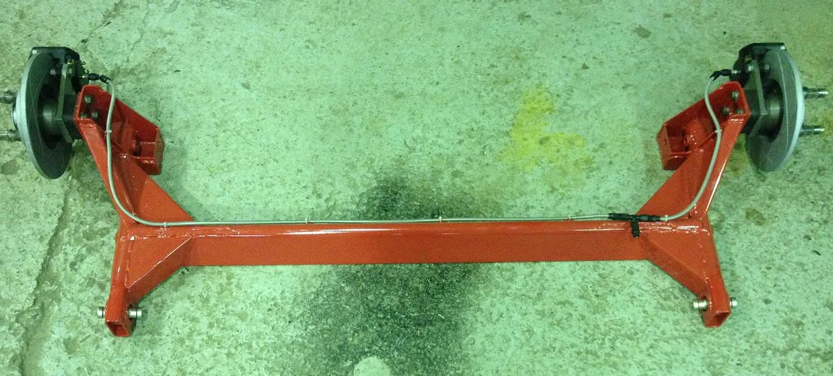

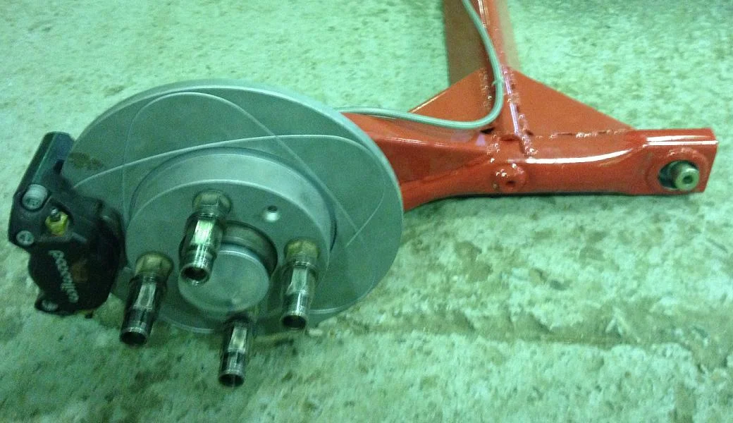

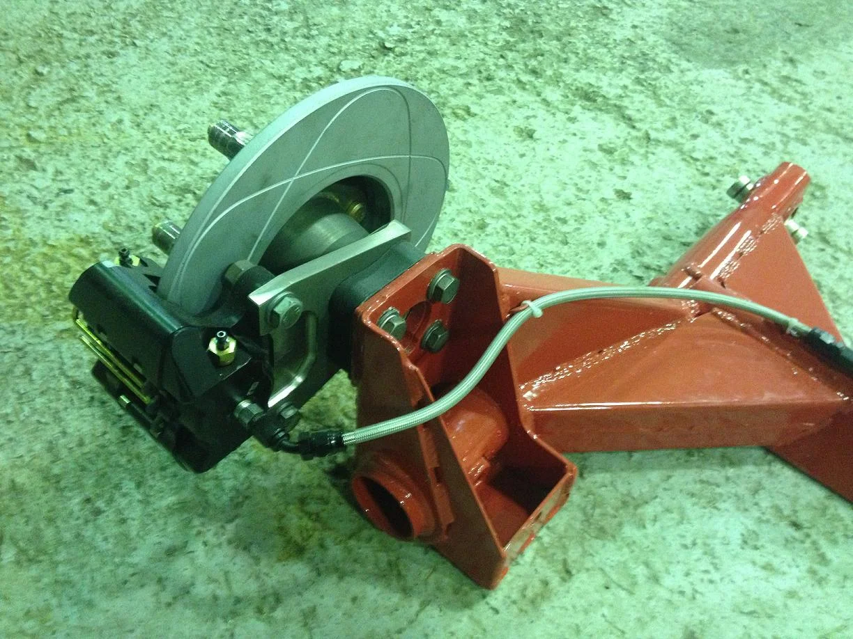

New rear brakes - with Wilwood 2-pot calipers.

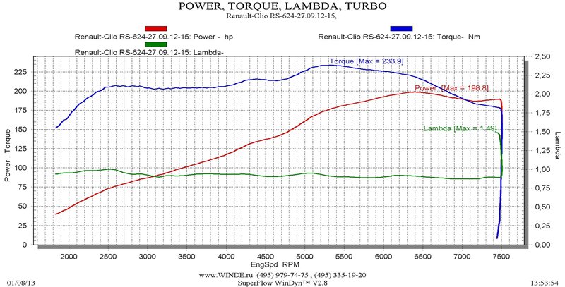

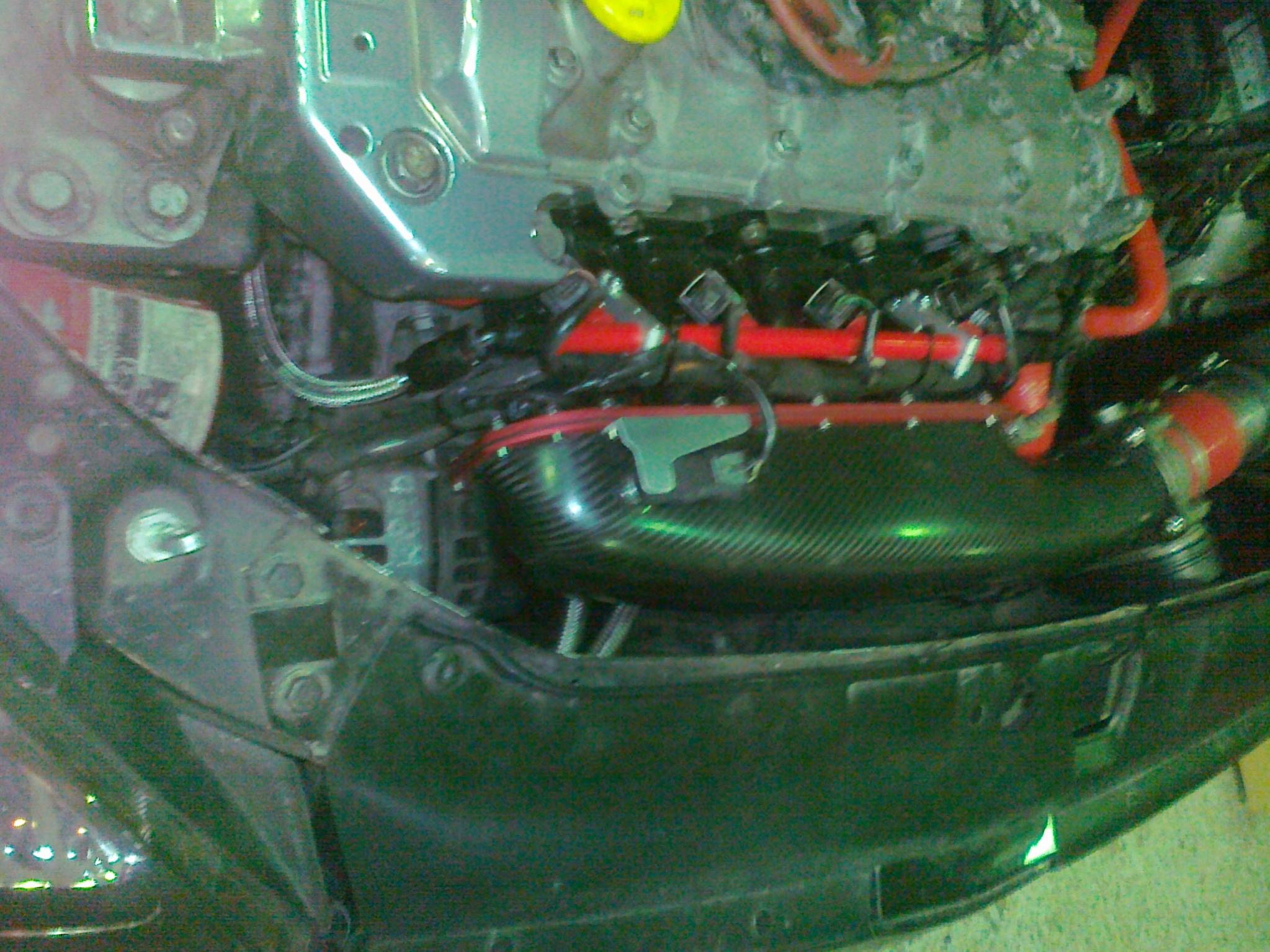

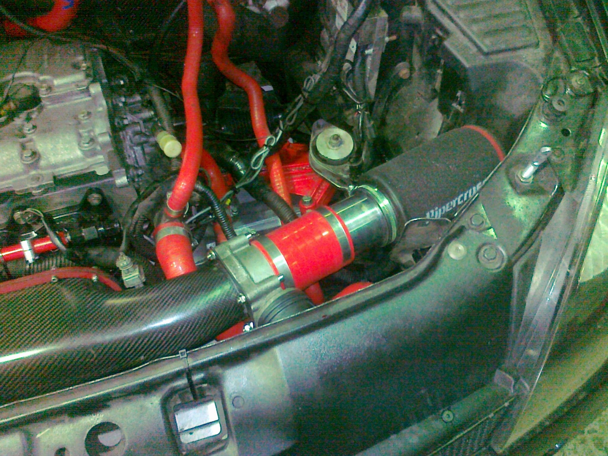

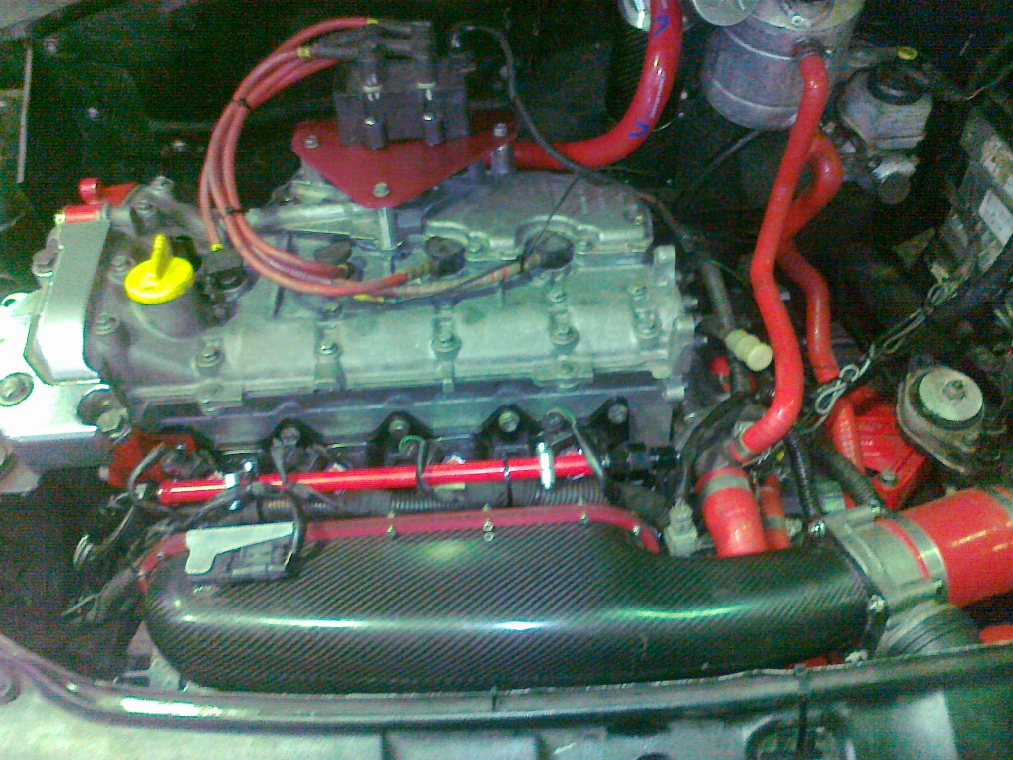

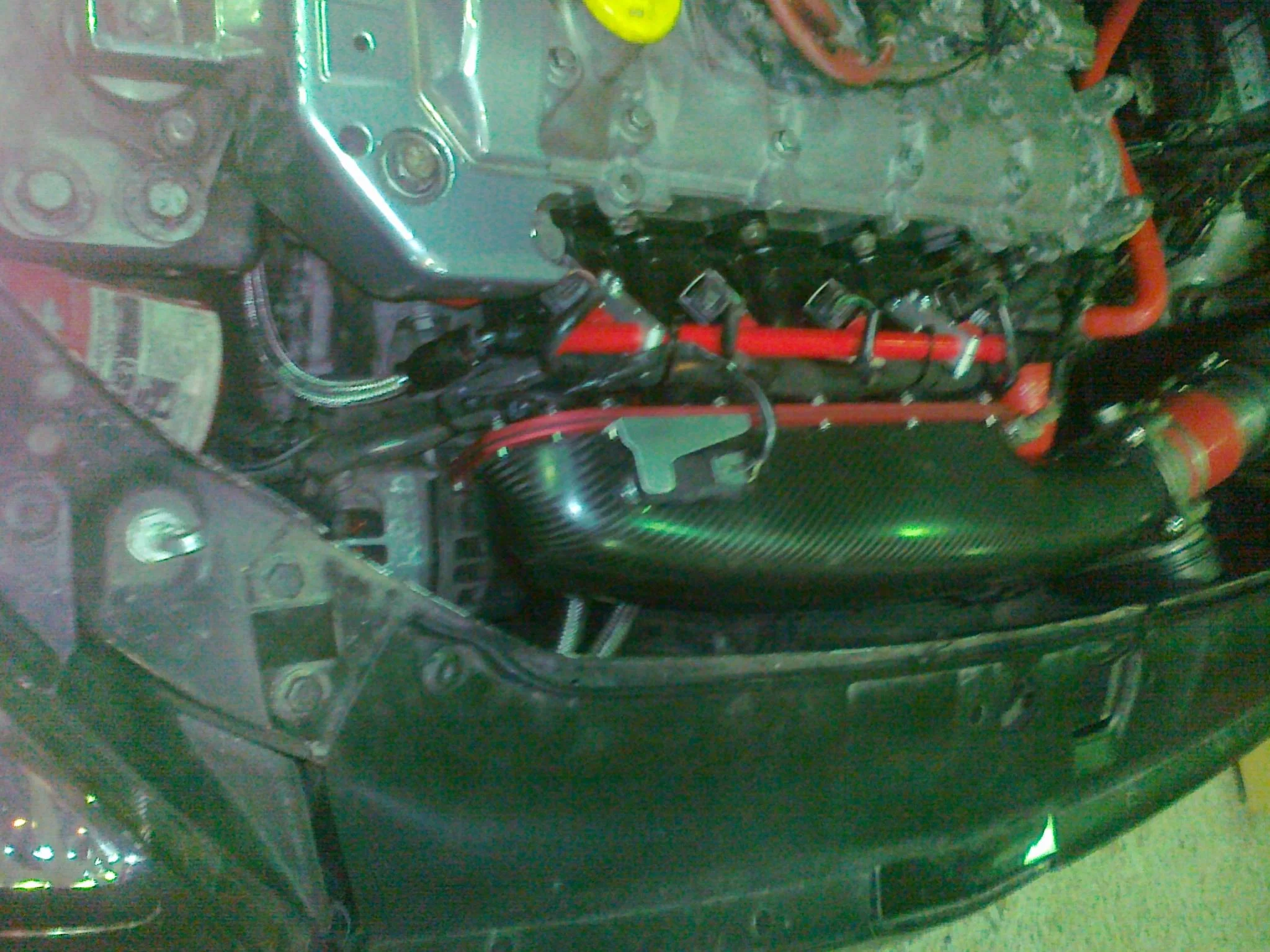

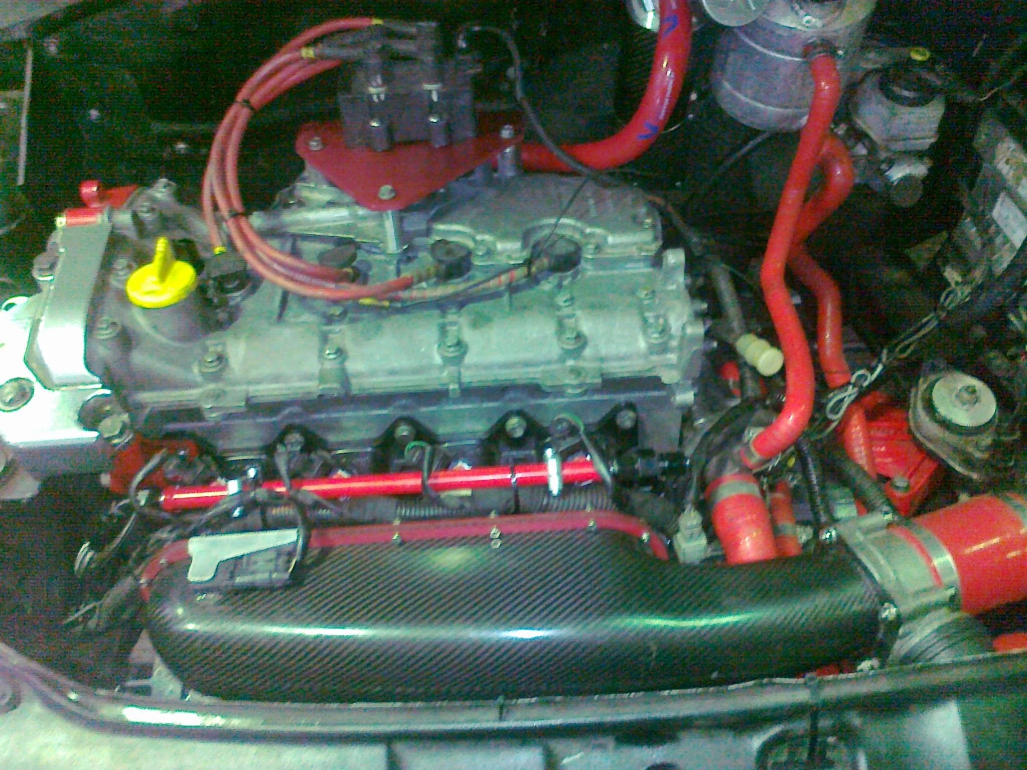

Engine config is:
CatCams 553 It (304/304° - 12.45/12.45mm),
CatCams adjustable vernier pulleys
Supertech uprated valve springs
Supertech valves
Solid lifters
H-beam forged Con Rods + Woessner 12.8:1 pistons

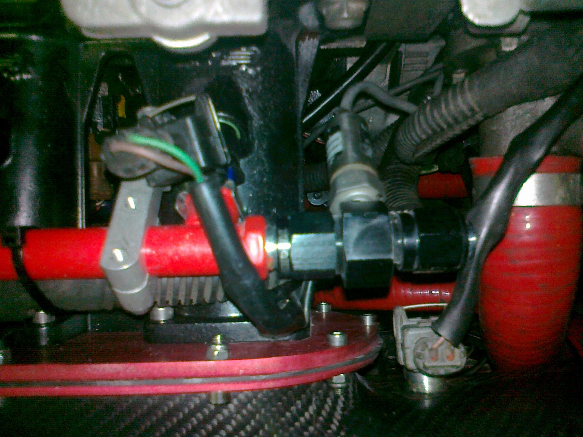

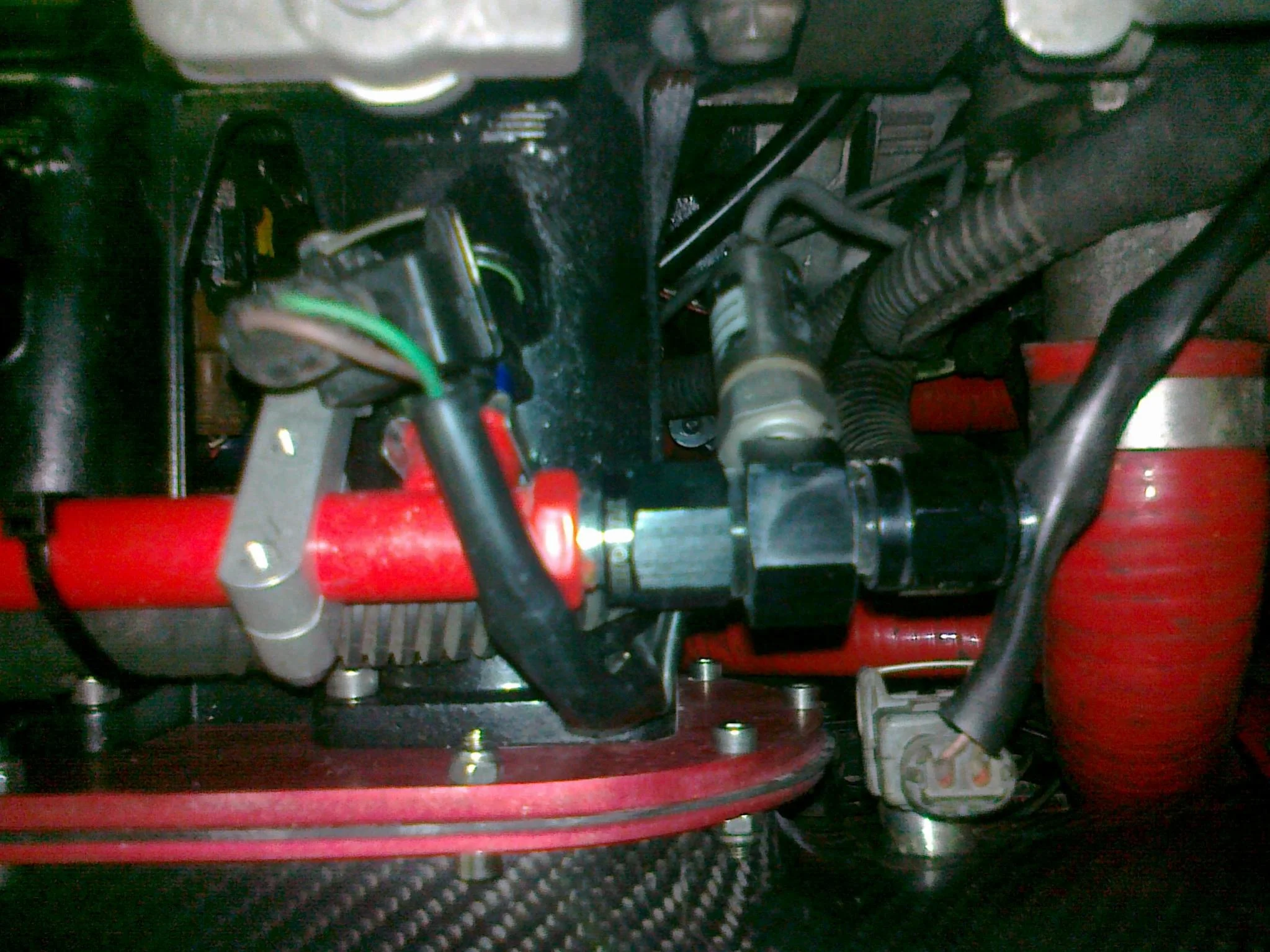

Megane RS 225 injectors on Jenvey's steel fuel rail (with M6 fittings and Teflon fuel pipe)
Ph1 Tom

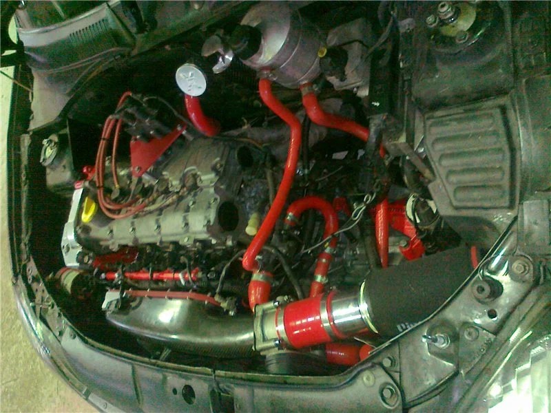

Yes, it is very good with high lift camsshafts too! Here are my most current engine spec:
Engine:
JMS RS2 Inlet Manifold
CNC-machined cylinder head
CatCams (304/304° - 12.45/12.45mm) with adjustable vernier pulleys
CatCams uprated springs (single)
Supertech valves
Solid lifters
H-beam forged con rods with ARP bolts and ACL bearings
Clio 197 pistons (give 12.5:1 when installed with Clio 172 head)
Megane 225 injectors @ Jenvey steel fuel rail
ARP main and head bolts
Kent competition cam belt
Athena Racing MLS gasket
Pure Motorsport AirCon and PAS removal kit
Transmission:
TTV Racing ultralight flywheel and Helix 184mm clutch
JC5-129 gearbox with Gripper LSD (30/65 ramp angle and 4.33 main gear)
Ceramic coated synchronizer rings for 3-5 gears
