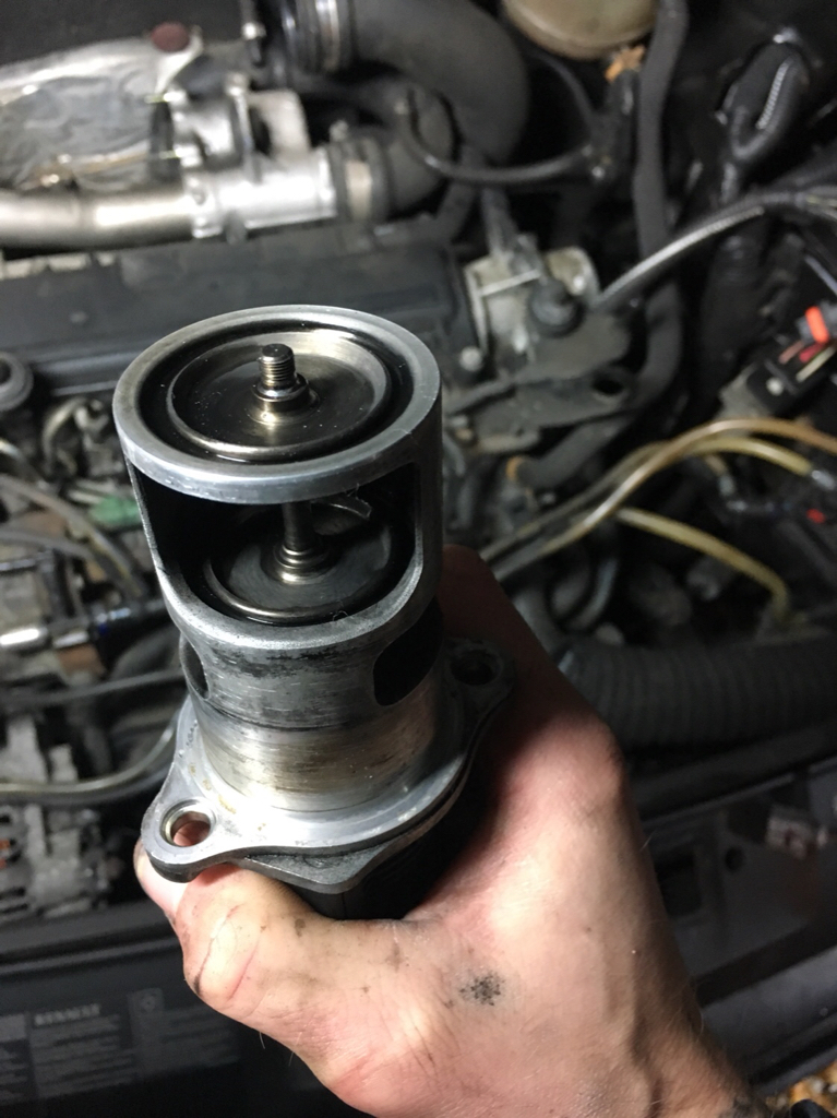

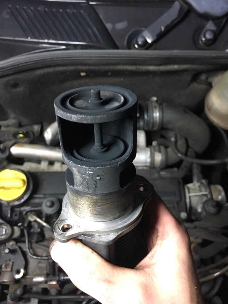

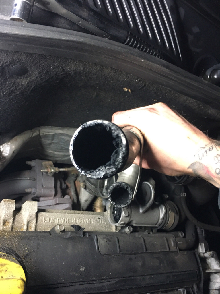

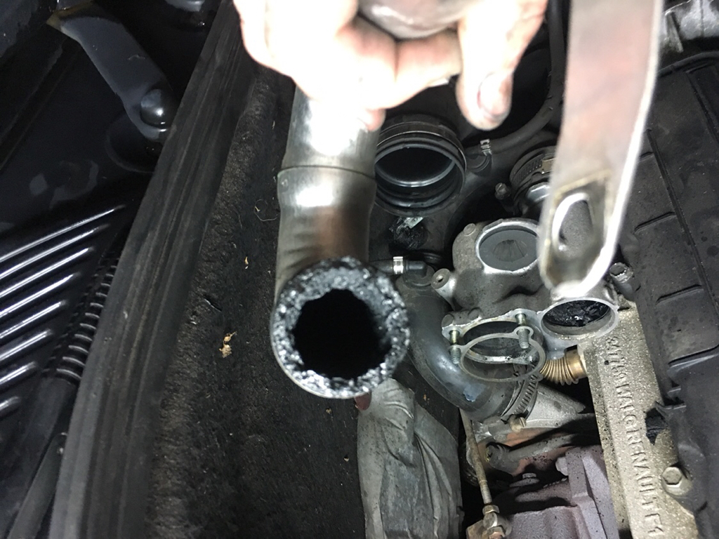

So I tackled the EGR valve cleaning and charge pipe. Followed this guide on YouTube:
Was pretty straight forward for anyone with some mechanical knowledge.
EGR was a little sooty:
And then after a clean:

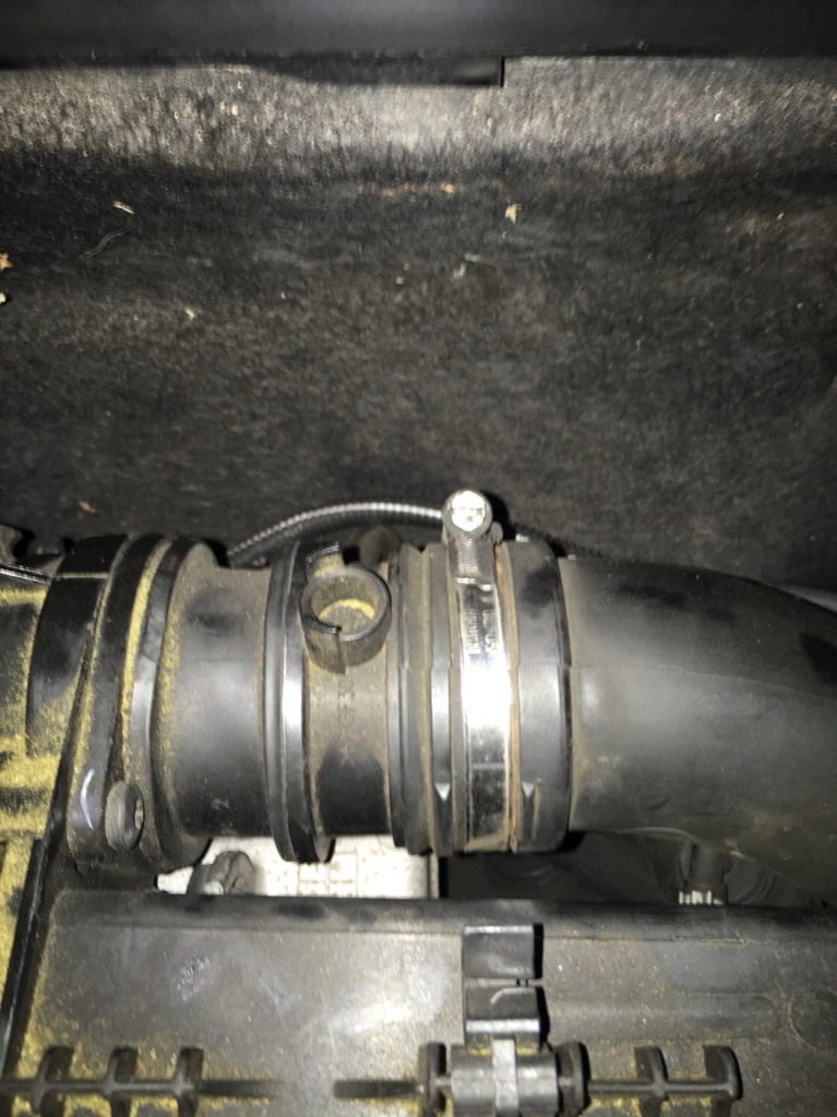

Also the charge pipe was worse:
All in all it was worth while exercise and hopefully will keep things clear for a while.
Noticed this plug was missing:
But think it’s blanked off... the YouTube video showed his DCI 65 with a plug to remove there? I had no spare wires.
Also had a huge screeching from a belt on and off almost like clockwork every 10-15 seconds... not sure what gets worn on these? Any advice?
Thanks
Looks like a tidy dci? That hole is blank in the dci65 pipe, the sensor is in the boost hose from memory.
Egr looks as clean as they get wouldnt have bothered cleaning it, they usually stay like that with a good thrashing once a week ?
Wish my EGR looked that clean when i took mine off lol. Mine was filled full of crap. Interestingly though, my pipe was pretty clean so the opposite of what you have found with your egr / pipe.

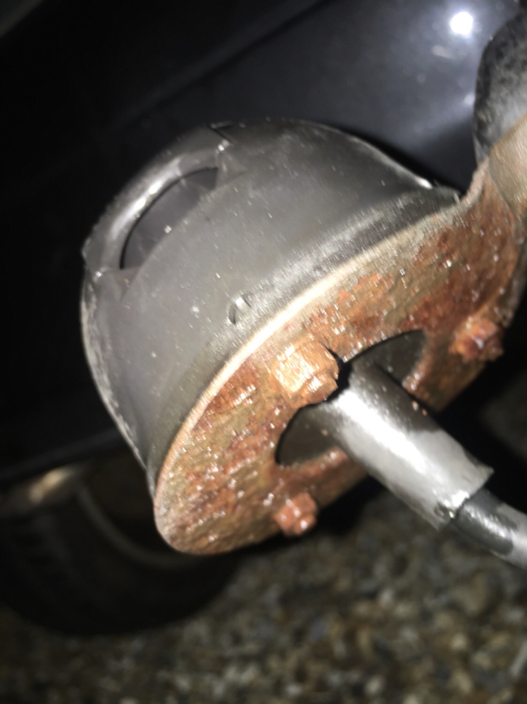

This evening I managed to take off the 2005 fitted towbar. The bolts were horrendous and with keeping the rear bumper on, it was difficult to get some movement on the ratchet.
Had a good helper (even though he was looking in the middle)
The electric connector on the towbar though has some well rusted nuts and I’m struggling to open it up so I can disconnect the wiring.
Loads of WD40 ect. but the screw has a flat head on top which makes life annoying.
Should I persist or just got the wire inside by the light cluster?
It’s all wired in so not sure what it will do to that circuit however...

Tow bar wiring probably tapped into rear cluster, follow wire and remove it at the source.
Yeah it is! I followed it back there and it was a bit of a mess!! I would of liked to just remove it but it’s been bodged in by the looks of it...
Might have to spend some time in daylight looking at the wiring that comes from down the car to the cluster originally and then what someone’s done with this towbar!

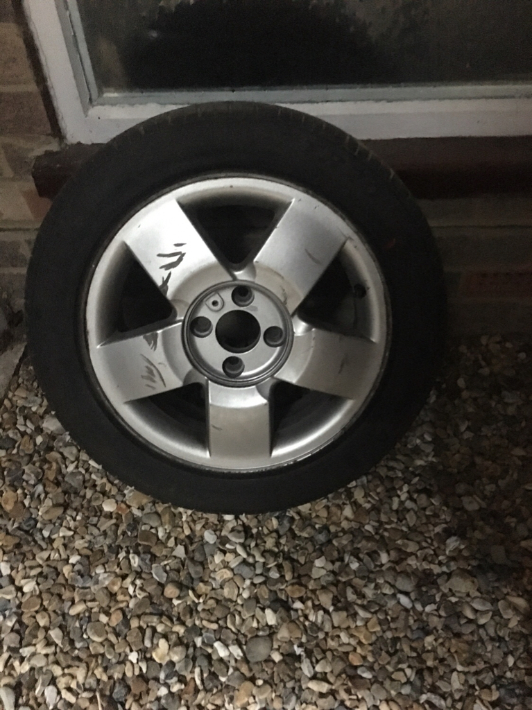

Picked up this spare wheel this evening though with a almost new tyre...
Typical when you go in the boot and there is nothing in the spare wheel well.
Not sure what Renault model it was from but it will do for £15 to sit in there.

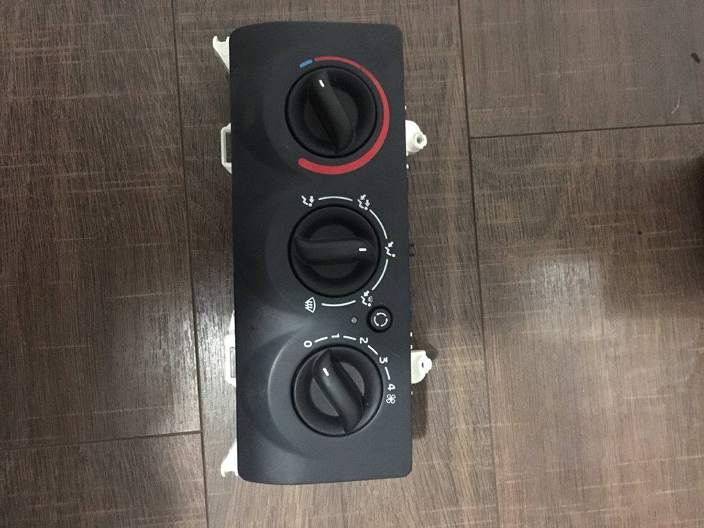

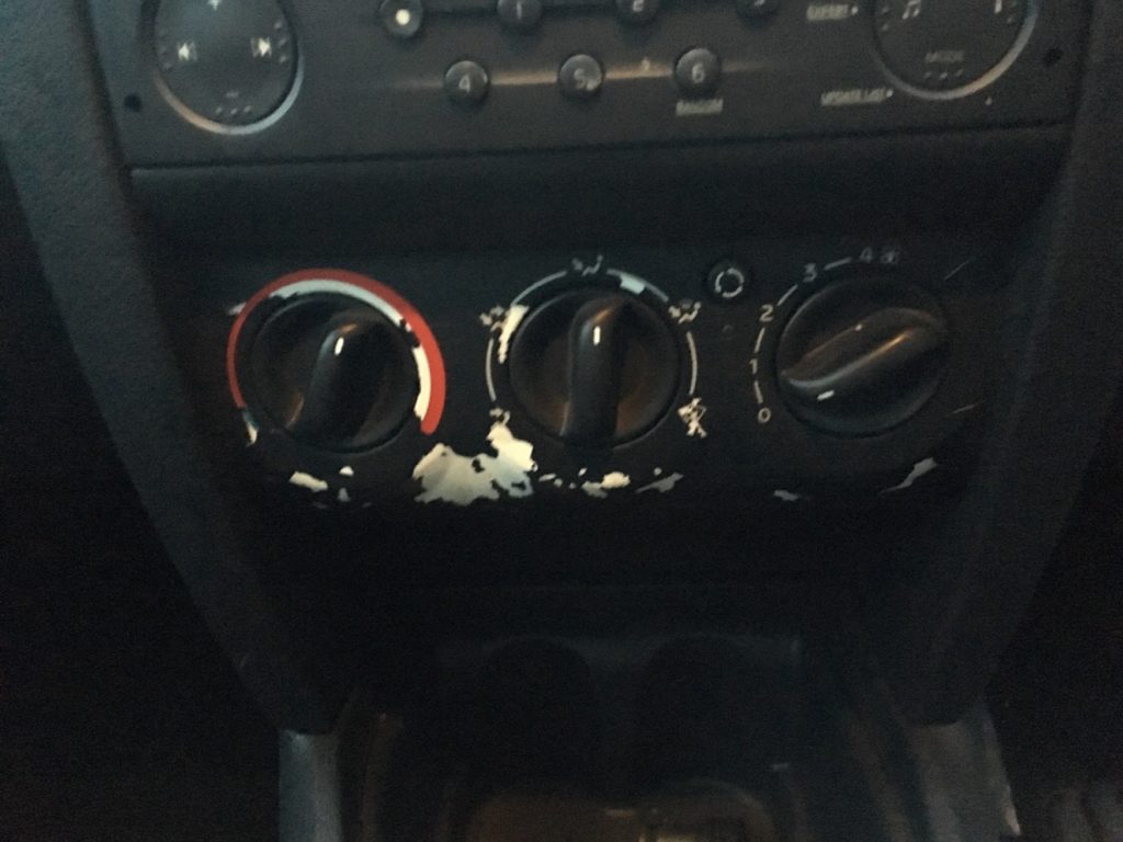

So the collecting of bits continues:
Heater Panel in the car currently
And the second hand one for £15

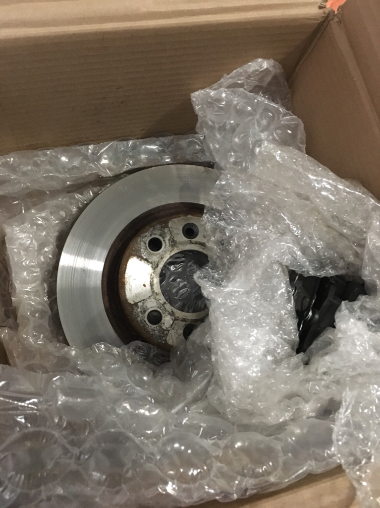

Then was my front brake situation. The discs and pads arrived from @Mazz in a Maserati box [emoji6] thanks again to him!

That spare wheel you got is an Equation style rim from Privilege trim clios, I've seen them on mk1 meganes as well.

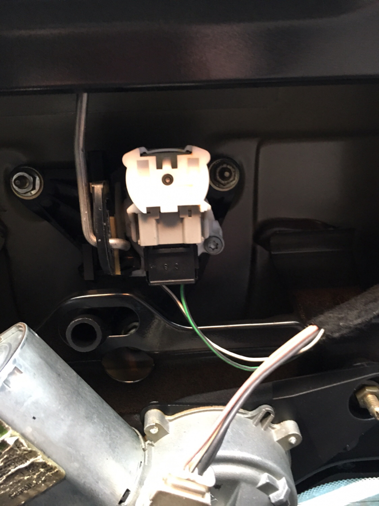

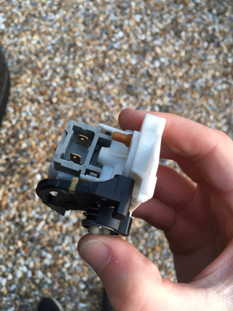

Swapped out the boot lock solenoid as the boot wasn’t locking with the car...
Did the trick and was an easy swap!

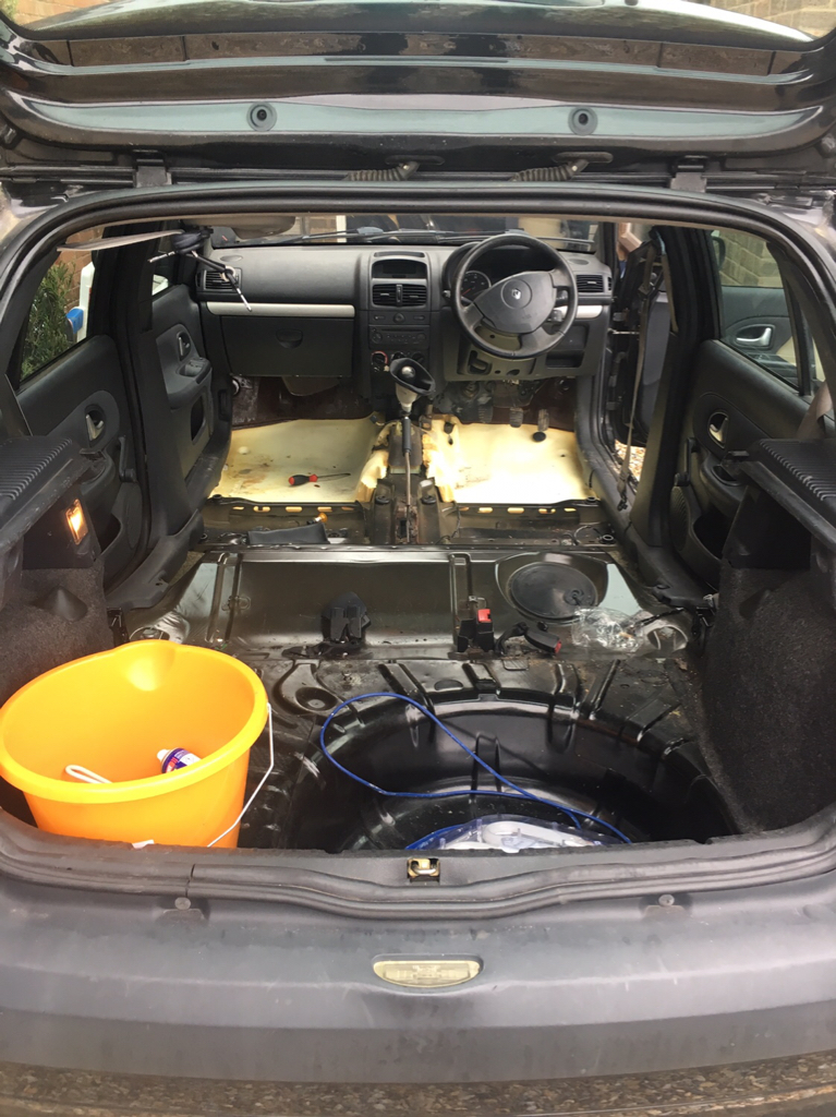

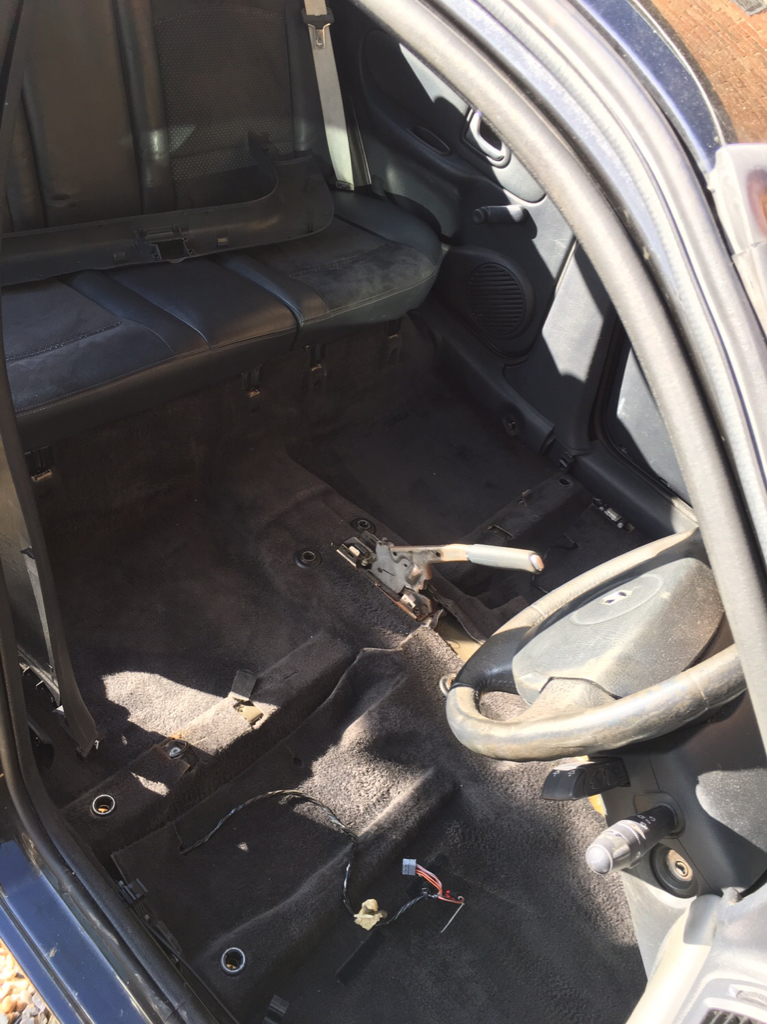

Then started tackling removing the interior (as it was MOT’d and didn’t have to move anywhere for a while as I collated the final bits).

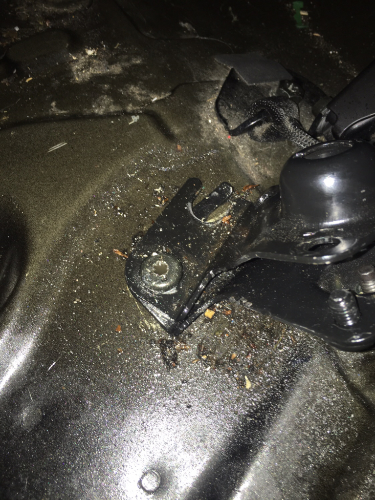

As all my Clios, the bolts that go into the chassis rust from the underside and so are a pain to get out! The Isofix bar first, then the central rear upright bracket bolts.
They have a star head and you struggle to get any real angle to turn it due to the bracket. One I managed, then the second head rounded.
Ended up angle grinding the seats away from the brackets (in frustration) then attempted to molegrip the head and get the last one out. Pain in the a** being a rusted old bolt anyway, let alone trying to use the grips but got there eventually and it’s slowly all coming out.
Few more bits to collect this week hopefully for the interior. Then a weekend of fitting it out.

Still making progress removing all the interior... minus the one bolt that’s still stuck in...

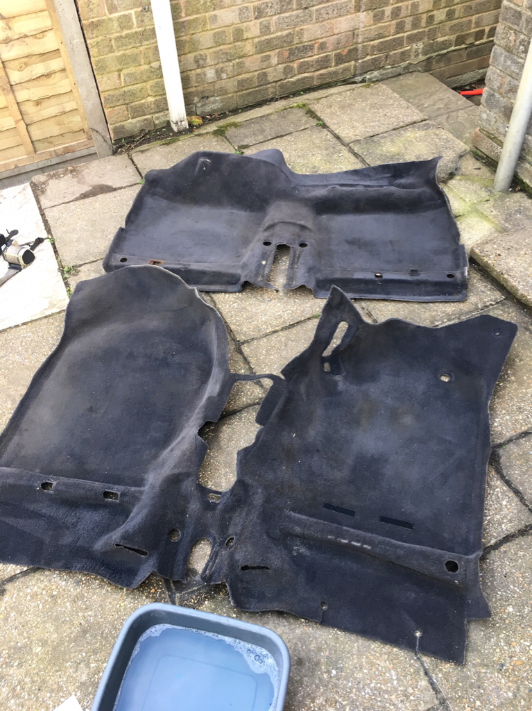

Cleaned all the carpets and seatbelts at the weekend I’d collated:
Before starting:
During for the seatbelts:
And here she is on the drive:

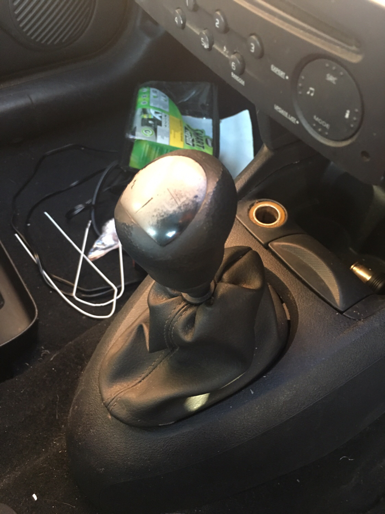

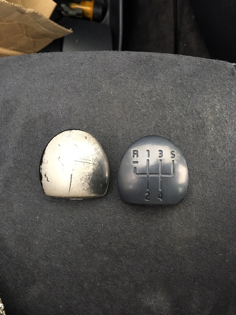

After a Cigarette lighter unit and a gear knob insert right now incase anyone reading has one spare!

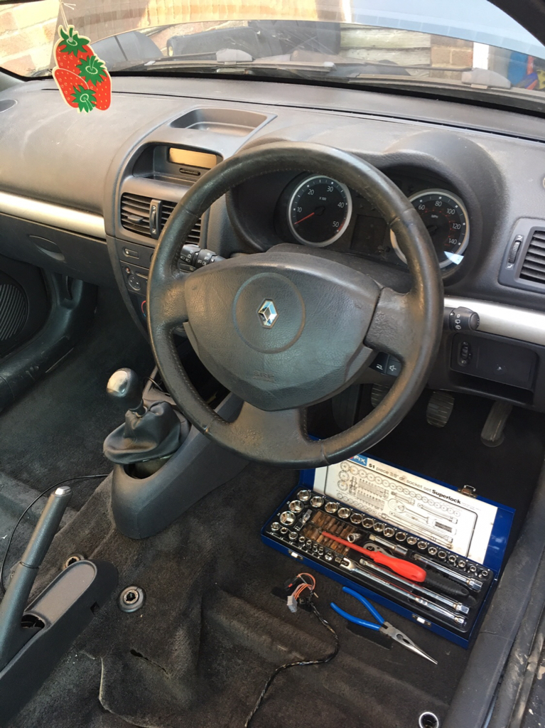

A little bit of weekend time and a day off today saw some more progress being made.
It’s amazing what a different car it feels like with clean and smart interior swapped.
I’ve been cleaning EVERYTHING with either upholstery cleaner or anti bacterial wipes lol! But it does make it feel so much nicer to be in!
From this:
To:

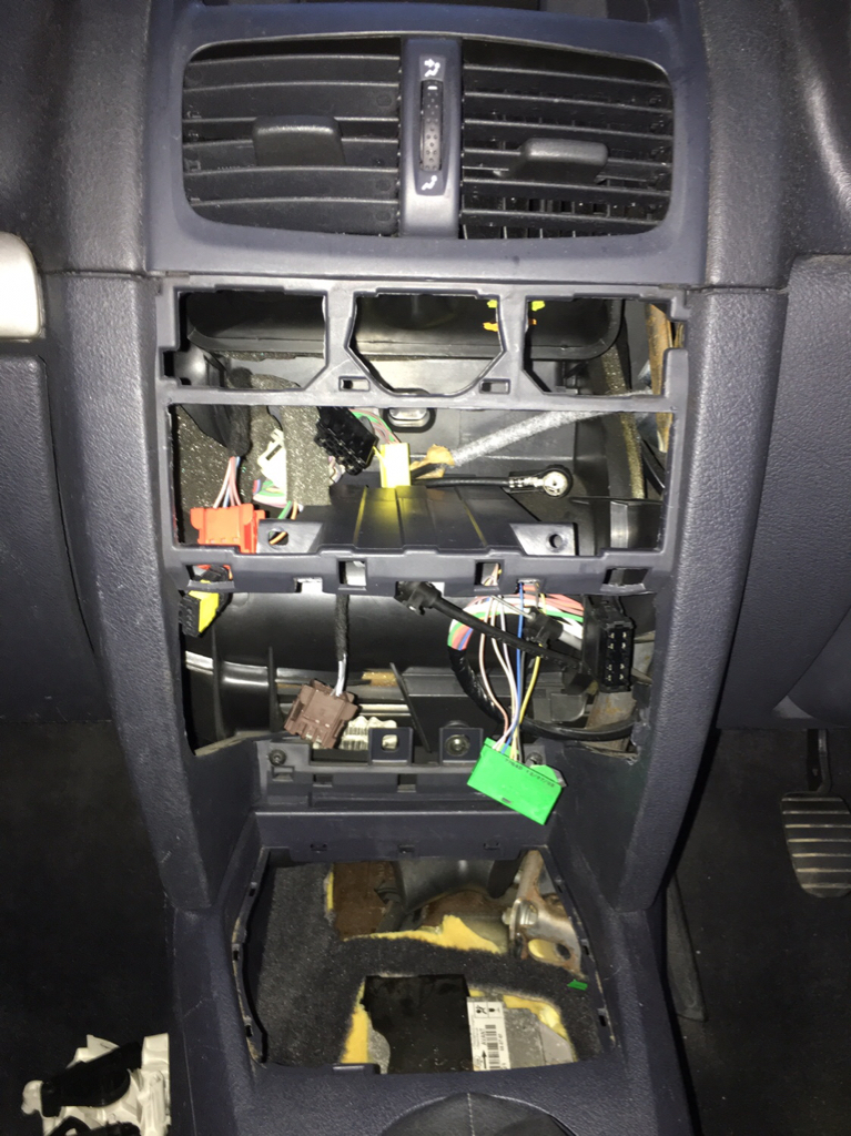

Front seats only this left to fit now! (And the annoying central nuts near)

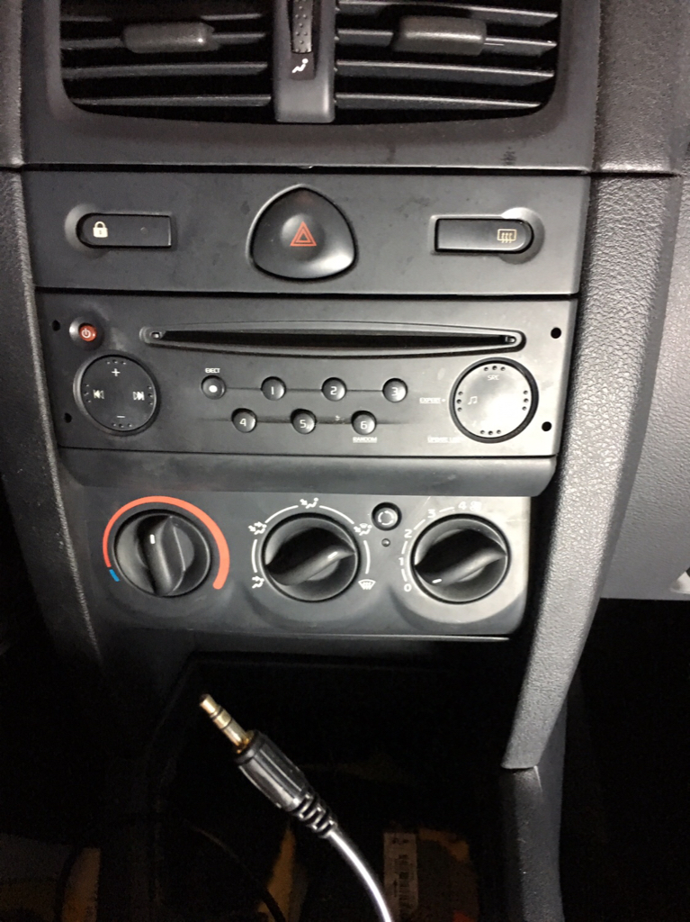

Also changed my heater control panel which was awful!
And the new one plus my aux which I did at the same time it was all out!
Have Friday off so hopefully will get the front seats done and also my 172 wheel fitted, then it’s just 3 new tyres and she’ll be good to run as the daily!

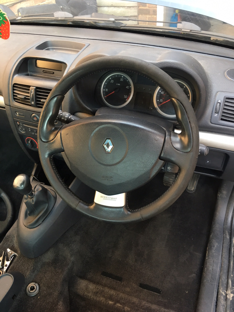

Changed the steering wheel today to my 172 one! Was actually a doddle. Followed the guide on here and took all of 15 minutes! Another big improvement!
Old: stick and dirty no matter what you did to clean it.
New: decent thumb grips and in pretty minty condition!

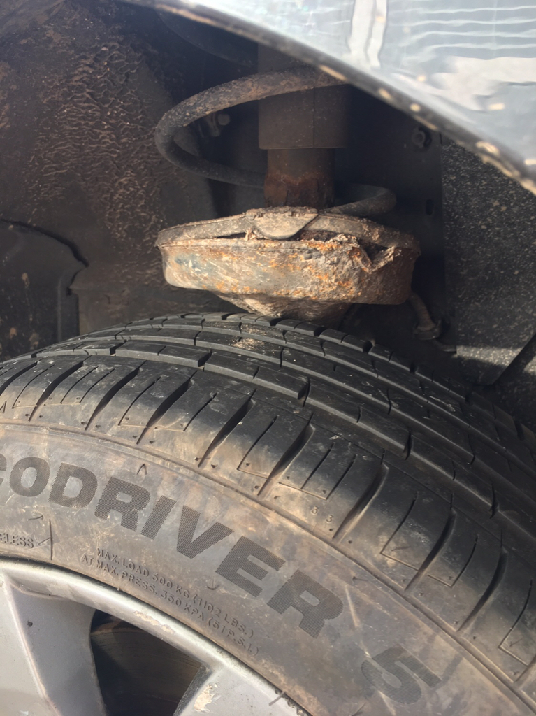

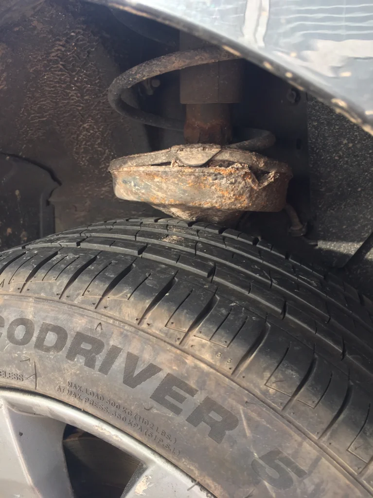

New wheels seem a right fit...
They’re just 16” 182 wheels
Do they foul at all on the bottom of the spring cup when in use?
I had 16" on and it wont foul there as the suspension travel is in the shock not in the wheel+shock ;)
The wheel and shocker move as one unit essentially
EDIT: Unless the tyres are a 50 profile on the sidewall. Then they'll definitely rub without spacers
