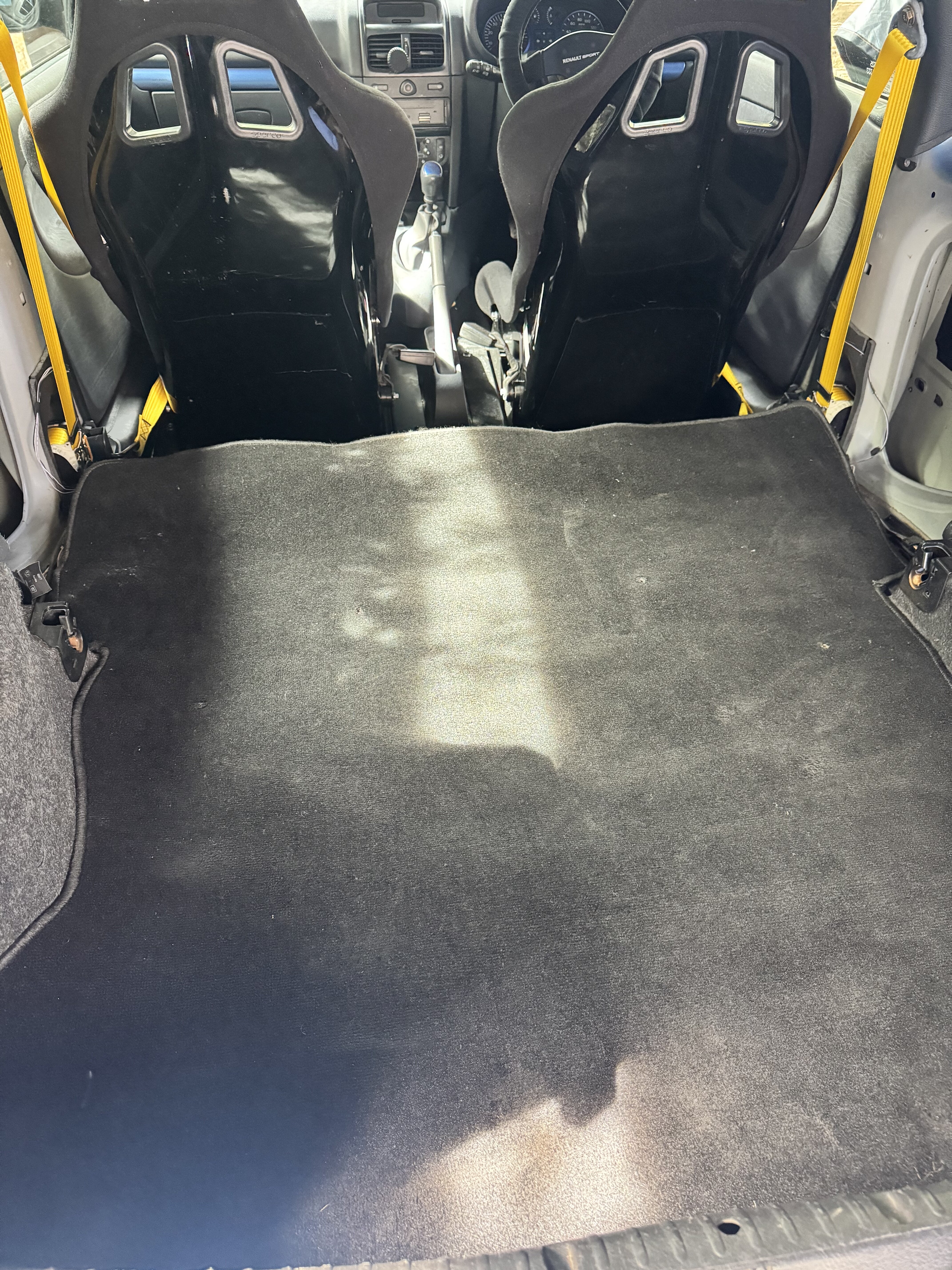

I finally got the gearbox mount refitted, and then realised that for an MOT, any seatbelts need to be secure and the airbag light off etc etc. never mind the rust. Whacked some 3.3 ohm resistors in the airbag connections and both the airbag and the SERV light went out. Great. Lost the bolts for the seatbelts over the last 9 months or so, not ideal. Managed to get the front passenger belt secure- I have bucket seats but standard belts. At the rear I was worried that flappy belts would be a fail- I undid them at the base to get the interior panels off to check for, and find, rust.
They’re now bolted in, the rear bench is out and a nice carpet in there. I’ll remove the rear belts fully when I have time.

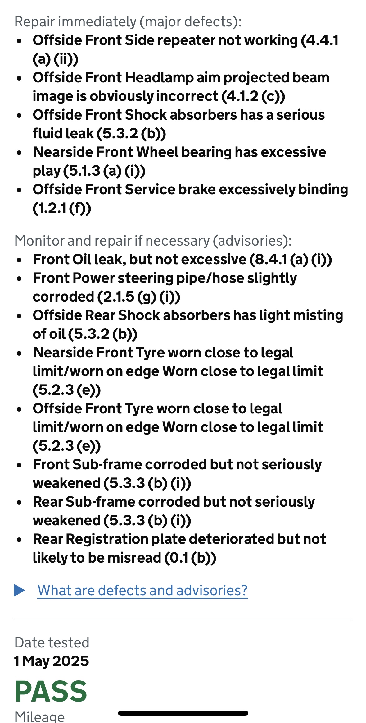

Wheel bearings were changed about 200 miles ago at two techs, so I think that advisory might actually be for the clicking shagged driveshaft.
My front subframe is a mess, if I’m changing the suspension arms, dampers and bushes anyway, should I just go ahead and do it all with a new subframe?
Rear plate is absolutely fine, insane advisory to me.
That's a shame.. sounds like a good opportunity for a front end refresh though. Drop the subframe and get everything (subframe, arb, bottom arms hubs etc) blasted and powder coated
Yeah, seems to make sense as I would want to do it at some point anyway.
The headlamp aim is a pretty obvious one-I have a bulb dangling in the holder!
I'll need to talk to two techs about the wheel bearing as they literally just changed them both!
The rest is all fine for me, not real surprises. I wonder if the "service brake" could just be binding/ rusty brakes from it being stood for nearly a year. It's done about 600 miles with me in the year... maybe a hard run would sort that?
Just a thought- front wheel bearings were done, I then added spacers- wonder if a spacer is giving the effect of a loose wheel bearing???

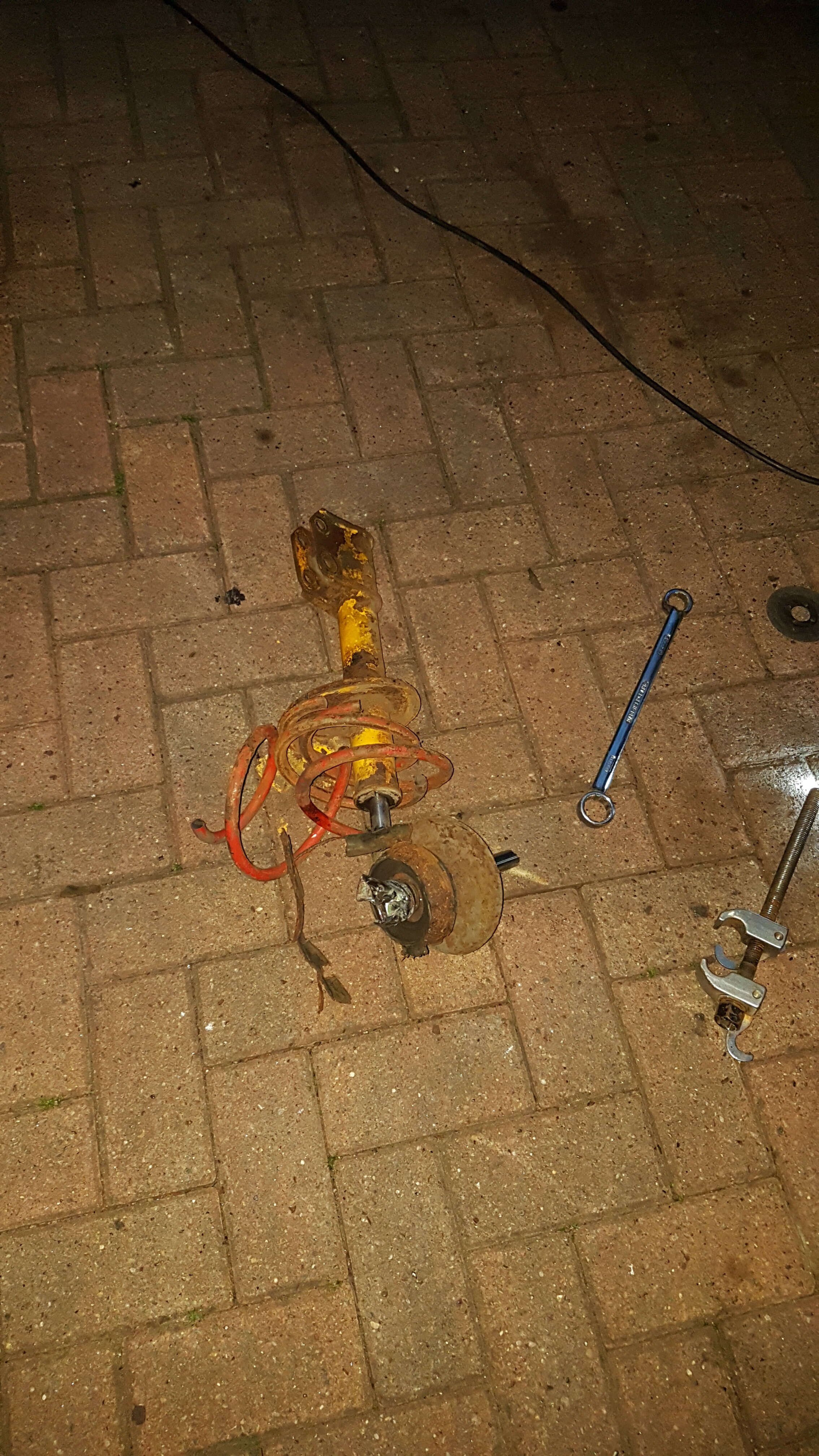

All the guides say you don’t need spring compressors. Which is half true, but the damper piston retracts immediately that it’s not held tight, so by the time I have the top mount sat over the spring upper, the piston has retracted and I can’t get the little collar bolt on.
How do you all do it?

Sure enough… got the nearside damper and spring on, relatively straightforward. So what, another 10-15 mins to finish the job and be ready for Friday's MOT?

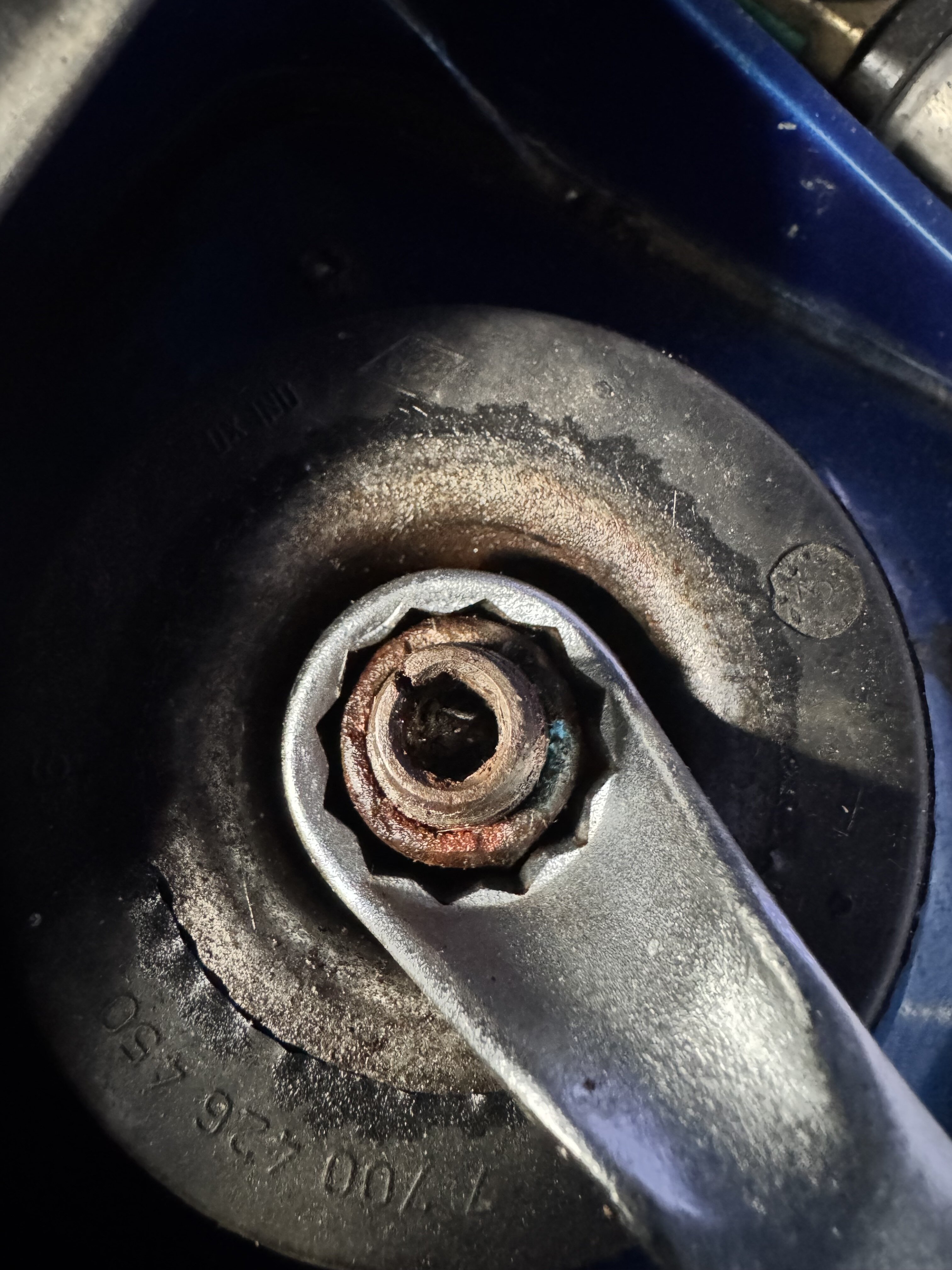

No. Look at the threaded top of the damper piston where it comes through the top mount. How the f**k am I going to get that out now? The sidewall of the piston top is split and so you can’t get any purchase on an Allen key in it- swan neck spanner just spins the entire damper. f**king f**k. So pissed off with this car. I need to get everything replaced so it’s reliable to work on. Not old s**t.
Any ideas on how to get the old damper out now?
Thanks everyone. I’ll get it done tomorrow and I appreciate the tips. At least I’ll have a badass tool for all kinds of jobs I can f**k up in future now!
Just grip the piston in the centre of the spring, Stilson or vice grips, put a bit of leather if you have any against the jaw to save marking the piston

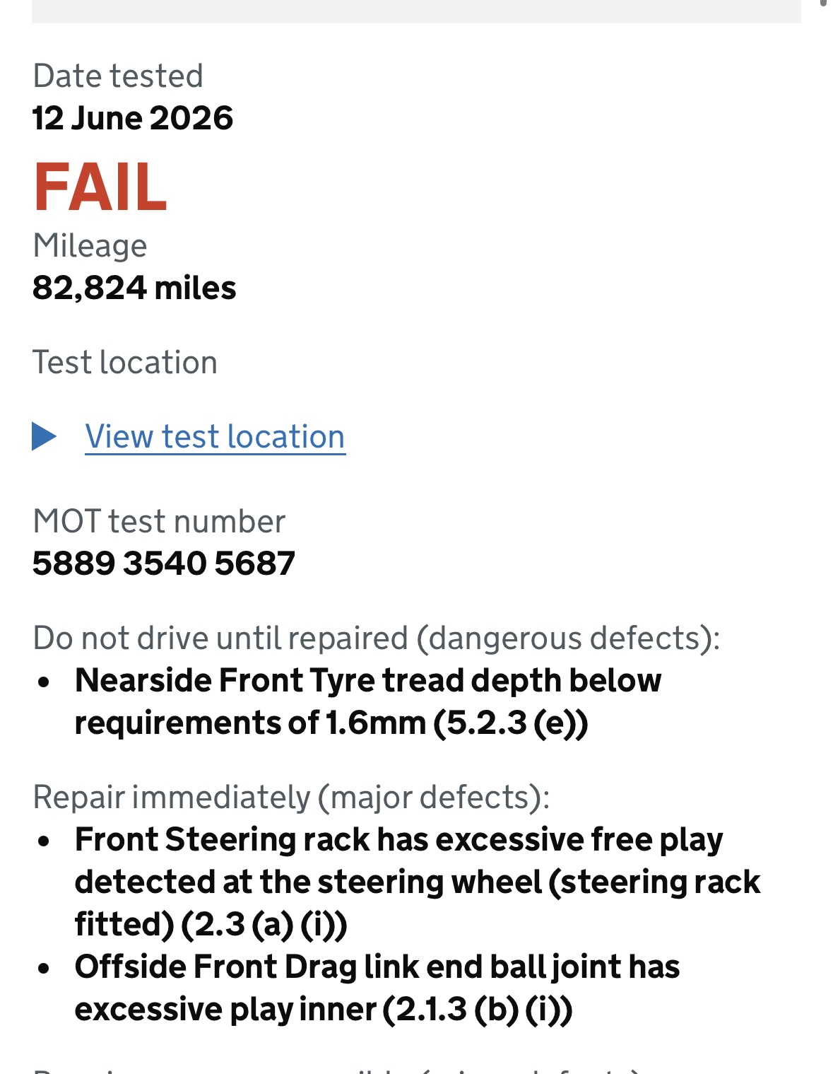

Guys, help me out with this. I obviously won’t be taking the car back to kwikfit for the mot- guy failed it on two things that weren’t fails 2 miles ago. FFS.
Tyres are easy. What am I going to need to do to sort the other new issue- shown below. He said tie rod ends. What does all of your experience with Clios say? Thank you.
Never heard of it being called a drag link before 😅🫣kwik fit jobsworth 😂looks like it’s Probly wants a inner tie rod joint or maby try a different test station
