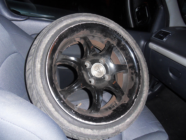

and the rims... they were very light nevertheless.
Old Rims by MWright24, on Flickr

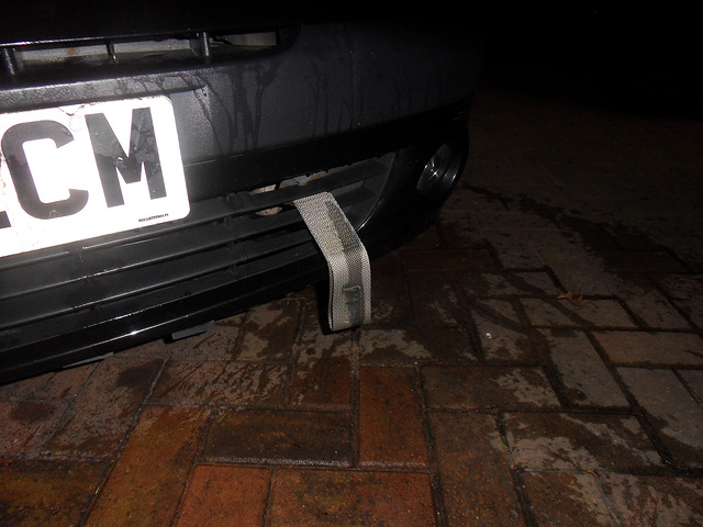

Had a beautiful tow strap so I imminently removed it.
Brap Strap by MWright24, on Flickr

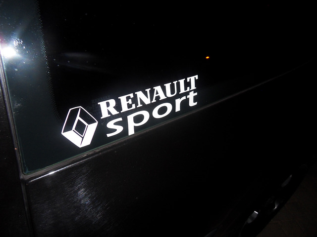

Pony Sticker by MWright24, on Flickr

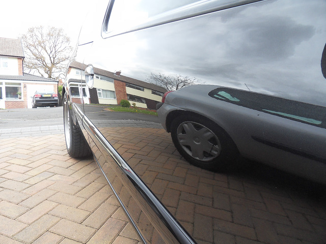

After. (mmmmm... swirl marks)
Sticker Free! by MWright24, on Flickr

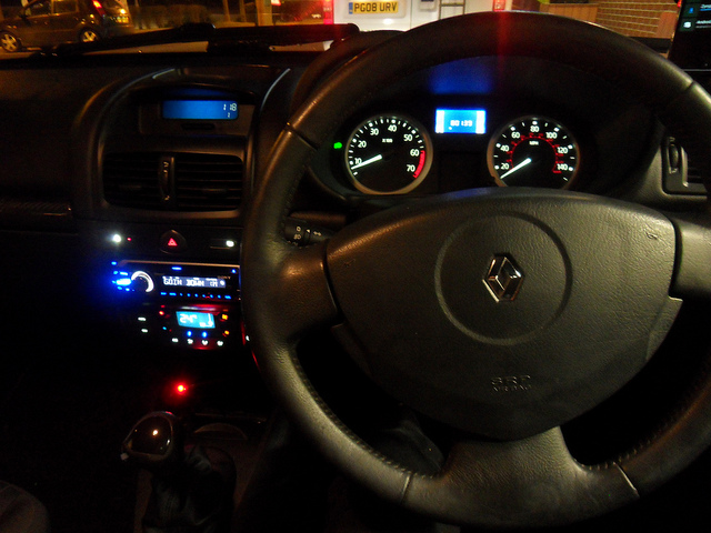

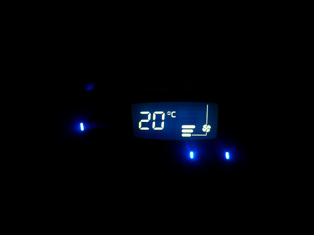

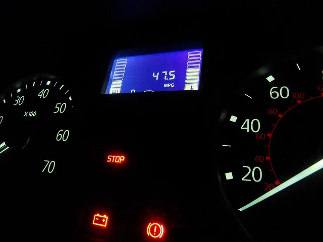

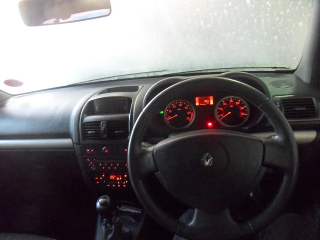

Then the first things I had to change were the interior lights & dash etc.
Clio Interior 1 by MWright24, on Flickr
Clio Climate by MWright24, on Flickr
mmmmm....MPG by MWright24, on Flickr
Clio Clock by MWright24, on Flickr
Then sorted a pikey fix :)

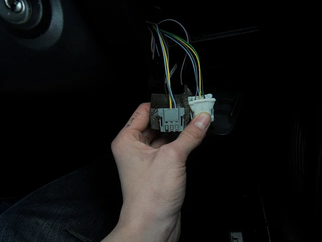

After showing a great interest into retrofitting cruise control to the other clio, I thought I'd have a root through the wires behind the dash, then I came to find the connectors for both Cruise and ESP. Win.
Cruise/ESP by MWright24, on Flickr
Which got me trawling through many foreign Clio sites as they and very in depth, they ssay that some clios are pre-wired (as in dci's and 1*2's 2002+) and some clio are only wired cabin side or engine bay side. Dieppe must have been a backwards place.
So I've left that as a future project, as I'm wired dash side so I will need to route wires from the ECU to R107 connector (Cabin to Engine Bay) near the washer bottle. Then maybe some CLIP time to activate the light, as it can work even without the light or SET --- being displayed :/.

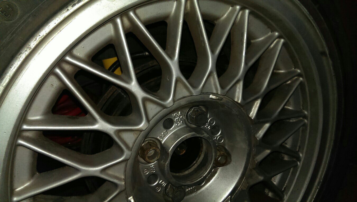

Also with my previous Clio I wanted to get a set of genuine BBS rims. So I took the opportunity to grab a set in Bolton.
Then I had to get them rebored from the 57.1 to 60.1. Cue a friendly lathe machinist who did it for beer tokens. So I promptly sourced some tyres and got them fitted.

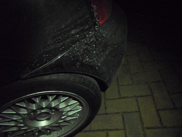

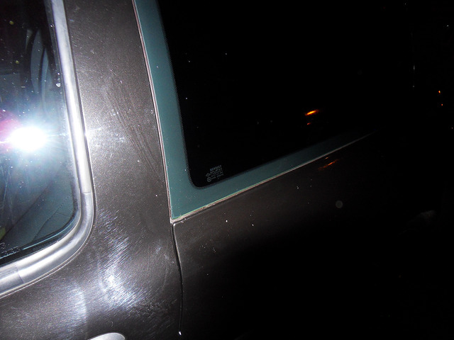

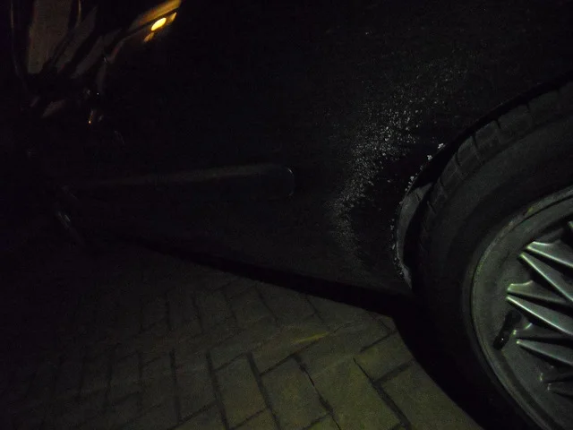

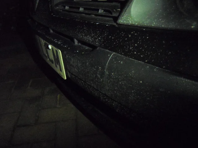

Dirt from the meet.
Dirty by MWright24, on Flickr
Dirty2 by MWright24, on Flickr
Dirty3 by MWright24, on Flickr

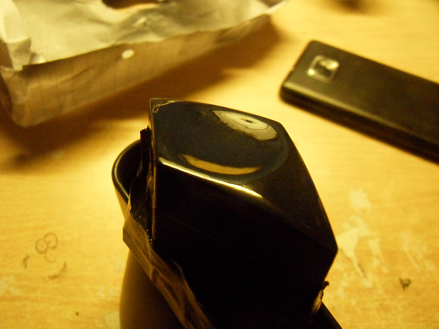

Then I replaced the gearknob as it was worn, then I had a moment and tore the rubber part off to realise it wasn't a simple process. I then sorted it out until a new gearknob arrived :)
Fitted.
Aftermath with a hacksaw and a hammer.

looks like i just found what to upgrade in my clio :D what is the voltage in dashboard? :) but the problem is that in my clio there no climate control, is there would be problem to replace normal temperature control buttons with electronic ones? like in yours car
To test the dash or for the SMDs?
The dash is 12v
And the SMDs I'm sure are a set value but dependant on colour iirc.
I haven't had a a problem with any SMDs I've bought.

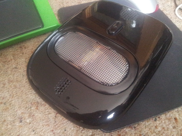

Also I've coded my courtesy panel and changed the light so I could fit a festoon.
Courtesy Light Panel by MWright24, on Flickr

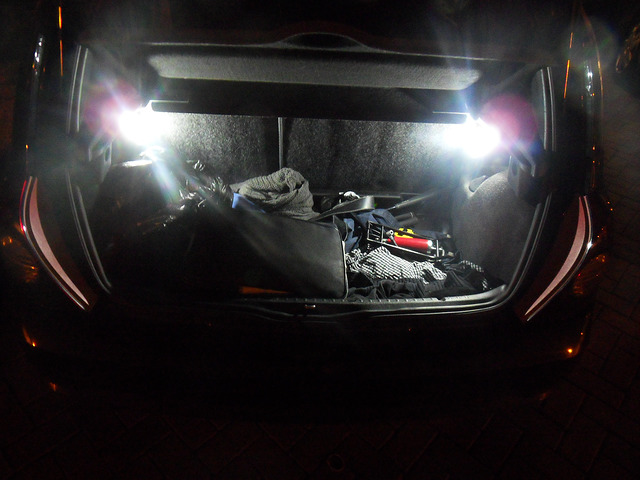

Also I replaced the rear number plate holder along with a LED bulb.

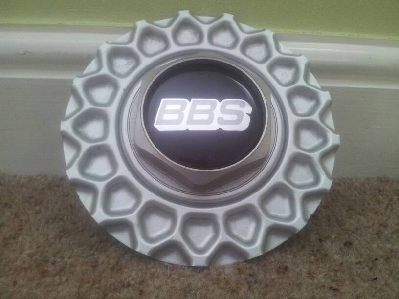

Now I've got all the BBS centre caps and currently awaiting custom centre badges, so after my exams wheels will be going in for a refurb in high-power silver with polished lip to match BBS centre badges.

im really liking the backlit being more ice blue mine are orange and its so dull I may get someone to do it for me looks really nice and refreshing on the eyes i bet especially when night driving
Yeah cheers.
Some people prefer orange to white for night driving. But white looks so much fresher, plus can use dash dimmer anyway.
It was the first thing I did in this and my other Clio, its not too bad to do it yourself with the guide and a soldering iron.
  Ford Fiesta ZS 2013
Yeah well Im going to be purchasing my membership on the 10th on here and getting the lights to do it so I will have a look on a guide on here if there is one and either attempt it myself or get a buddy to come and help. Well my car is white and black and the interior is something I really would like to get doing and that would be a good start for me to do. Orange dont really look that nice so yeah fingers crossed. What kit did you use from the site? any chance you could link it. How many did you use oin yours?
I didn't purchase a kit they over price them. I'm guessing you have a Clio Campus 57 plate? so you'll have the same dials as me.
You'll need to purchase 4 PLCC-2 3528 SMD (For dials)
and 4 PLCC-4 3528 SMD (For the center LCD)
You'll need a fine tip for the soldering iron and a steady hand :)
Surf eBay and other site I've used for interior LEDs/SMDs are www.moddify.com and www.crazyleds.co.uk

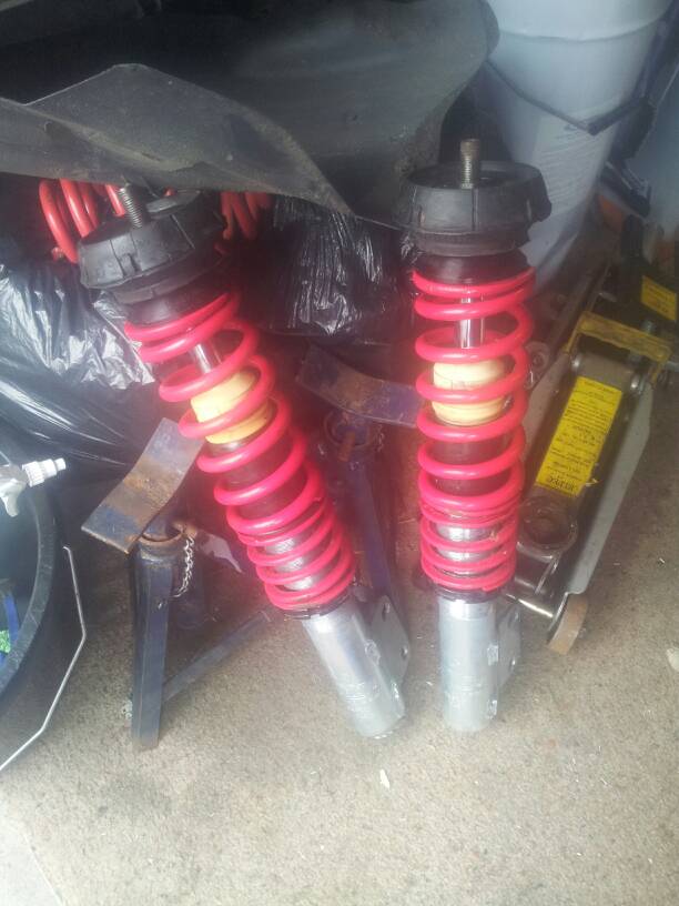

Firstly I've found the OSF strut is leaking so out on the look out for new front coilovers.
Front is a little lower and the rear likewise, as now I have some rear adjusters and gaz springs which need to be helicoil'd.

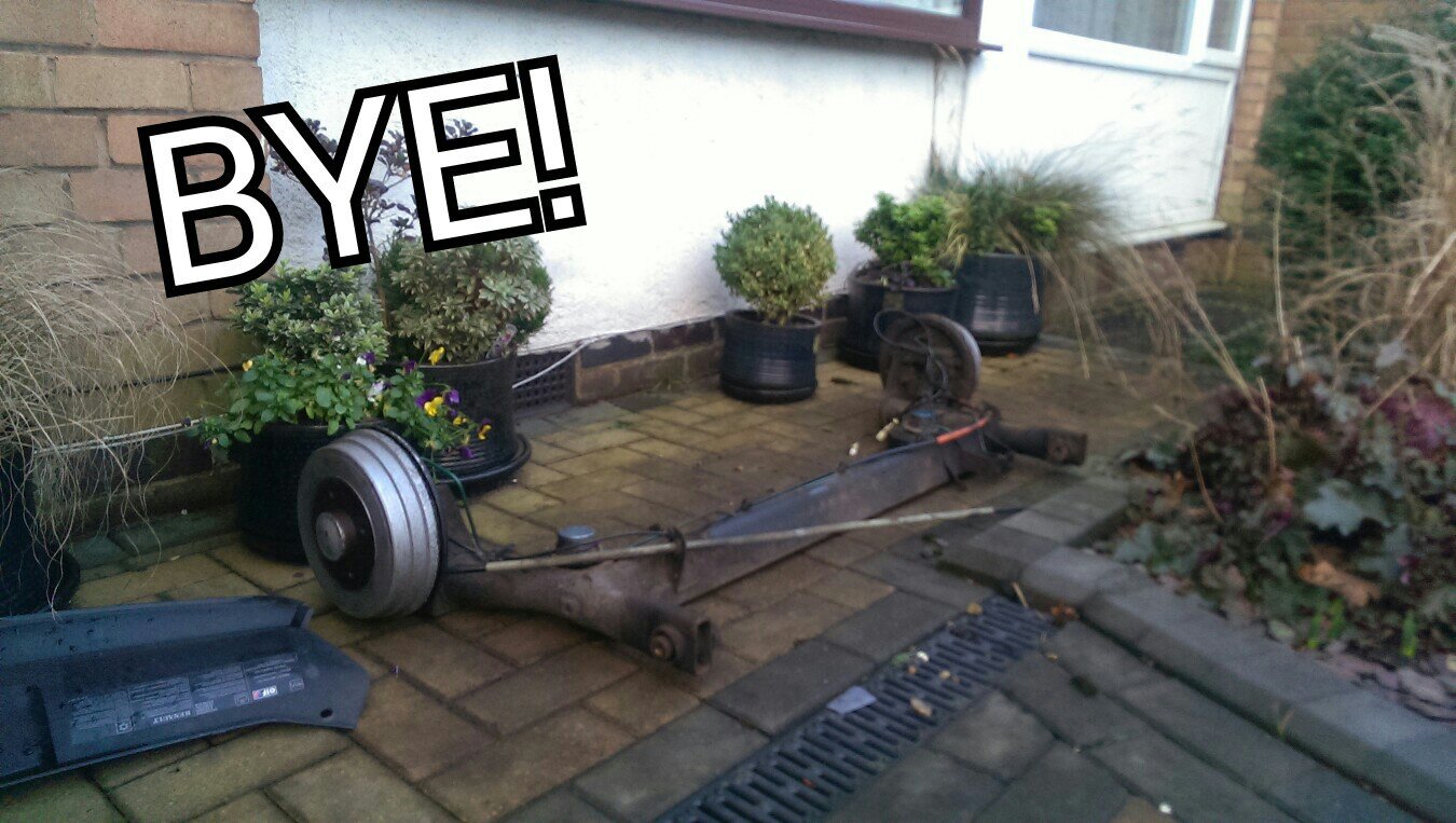

I have recently purchased an RS rear beam that will be powdercoated or a few coats of hammerite along with fresh bushes, for the time being I'll be cleaning up the callipers give them a lick of paint.
Rear Beam by MWright24, on Flickr
Rear discs by MWright24, on Flickr

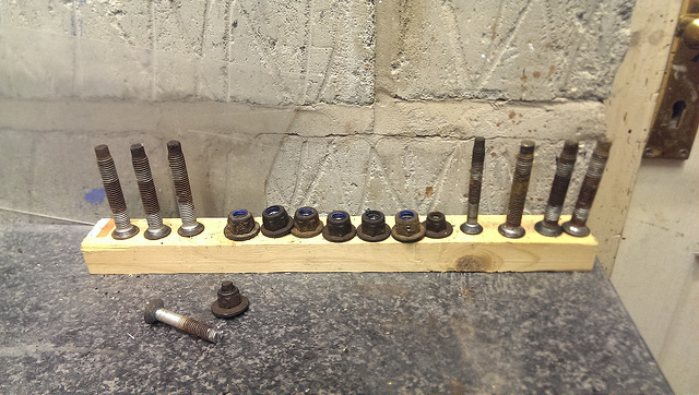

Plus these bolts were bloody hard to get off one of the smaller sheared and rounded the torx head *%$*!.
b*****d nuts & bolts by MWright24, on Flickr
Just bought a new set from Dan@MAD, once the beam is on I'll see if I want to add any camber as on some rough road it sometimes scuffs the outside tyre wall.

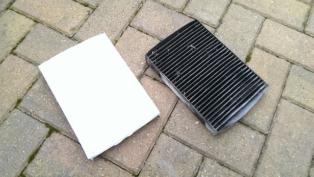

Along with the rear beam I am in the process of a full service inc. waterpump, tensioner, all belts, all filters, bushes, spark plugs and oil. I've bought a new coolant tank too to freshen up the bay, when removing my front wheels to clean them, I noticed my pads were a little low. They were replaced with Mintex pads & discs this will be likely for the rear once the disc stub axles are on.
Pollen filter was rank!
Pollen filters by MWright24, on Flickr

Also after an E30 BBS RZ 15" centre caps, one of mine got nabbed. If anyone has any miracle spares I'm after 09.23.117 just the black plastic part and 14" inch ones won't fit. I have a 14" complete cap that I can swap or trade.

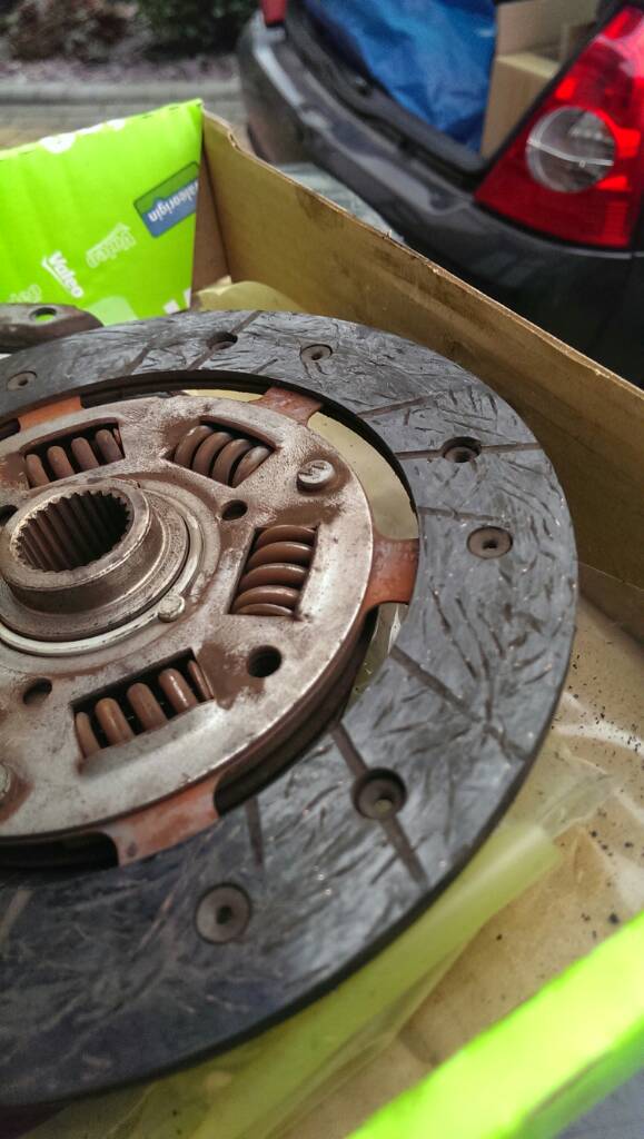

Another update, I changed my clutch for a valeo one as it was getting way too high and a little slip.
As you can see the friction plate was on its last legs. It's now so smooth when pressing the clutch pedal, also changed the gearbox oil while I was at it. Don't think there's much more wear and tear parts I can replace haha.
