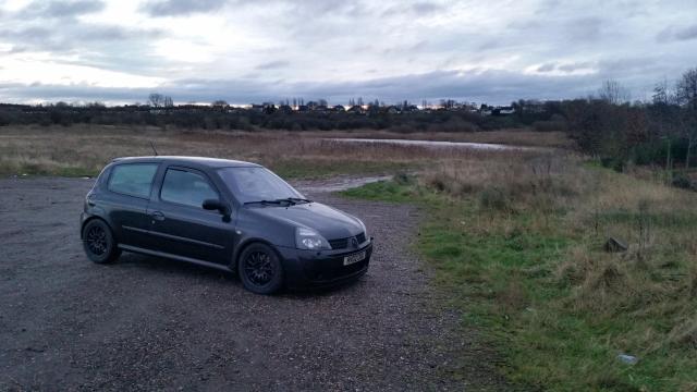

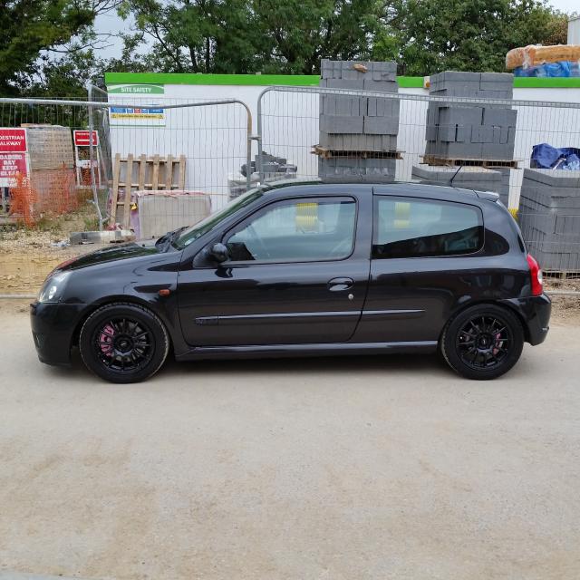

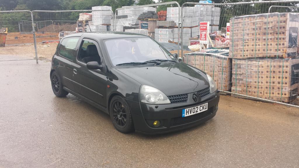

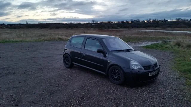

Thought i would start a little thread about my 172. Had a very colourful car history so far, never owned a renaultsport until now ( wish i had got one sooner). Know a few people on here from my local area, very helpful and friendly.
Got offered this 172 as a swap off a friend of mine for my 106 gti, i know the previous four owners of the car. Its a very well looked after and well used example. This isnt no show car, its used as it was intended imo.
The day i got it home, 134,000 miles on it well ran in and running nicely
So far its had a few bits and pieces changed and modified

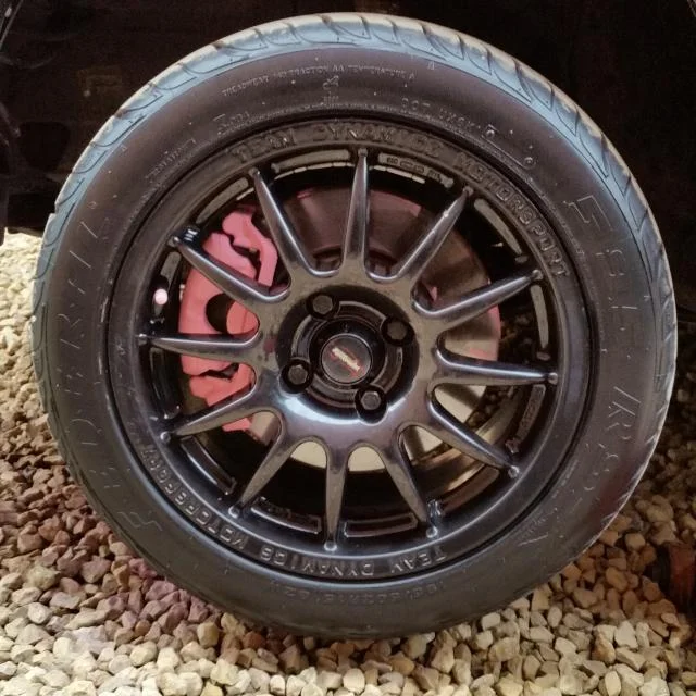

15" team dyanmics pro race 1.2's
40mm apex lowering springs
custom decat and catback exhaust
ktec style homemade intake with ramair filter
RS tuning remap 144whp/174bhp

After the trackday i realised i need to work on some weak points in the car. Tyres and brakes. Ordered some federal 595 rsr, brembo front brake pads, pagid rear pads, ATE super blue racing brake fluid and a full fluid change and brake bleed, also gave the calipers a tidy up. Car felt much better after this. Used it on the next track day, no brake fade and tyres worked great even in the wet.

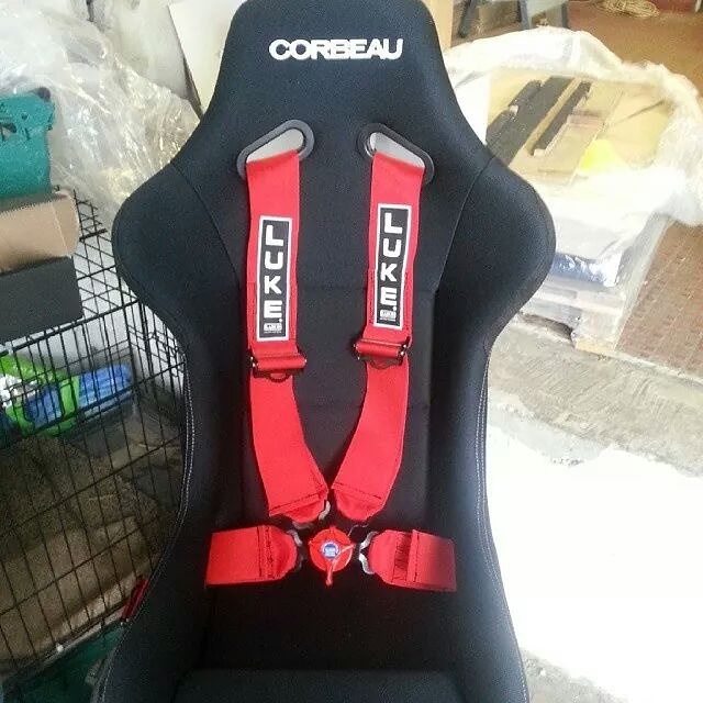

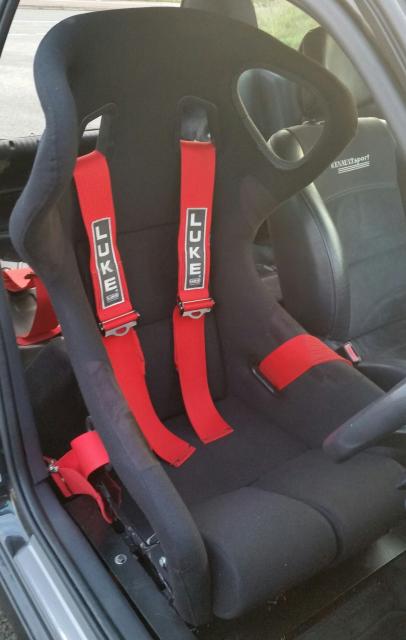

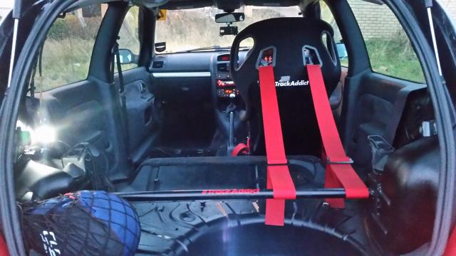

Next up i decided i wanted a bucket seat and harness, so picked up for a reasonable price locally and went and collected. Made my own subframe in my spare time at work, ordered some harness eye bolts and got it all fitted. Also stripped the rear seats, isofix bar, rear seatbelts and drivers seatbelt out for some weight saving.

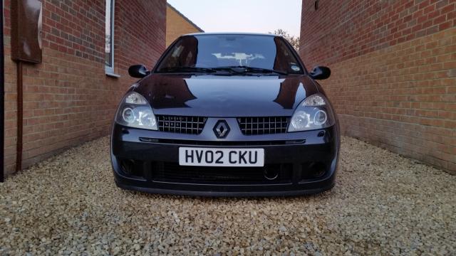

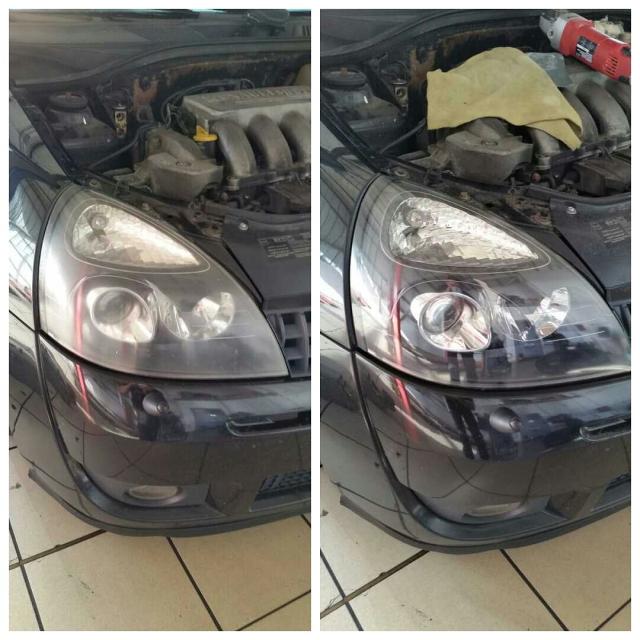

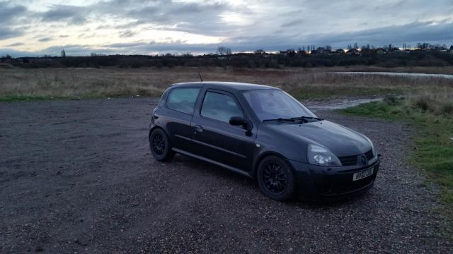

Front end needed a clean up so i machine polished the headlights, painted all the grills satin black and fit a cold air feed directly to my filter
How it stands now after a good clean and some pics from my most recent trackday

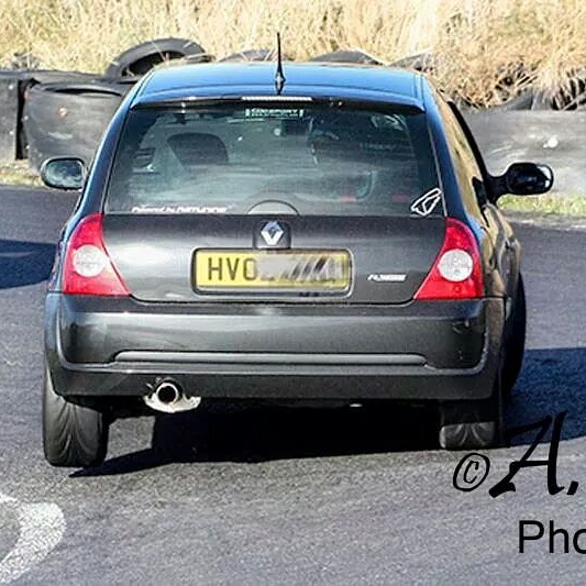

lol at that first picture!

That's the downfall of my local track, it's very short, very twisty, alot of right hand corners. Puts massive strain on the n/s wheels and tyres, with my car being quite soft it and big sidewall tyres it leans onto the sidewall, eventually the tyre just give up and popped off the bead. One damaged pro race 1.2 and dead tyre. All sorted now tho wheel repaired and federals fitted. Must have been a sign

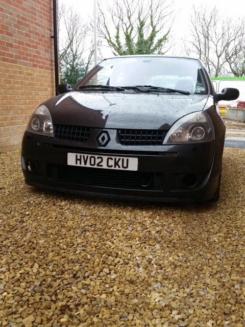

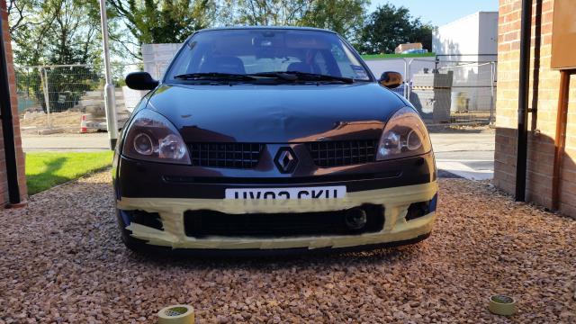

ordered a new small front plate 520mm X 90mm really like the look of the front end now

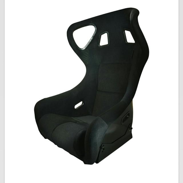

Impulse buy tonight after seeing this i just had to order it. Currently got my corbeau fitted which i really like but always liked wrap round seats. Gunna try it out next week and see what the quality is like, if all is good my corbeau will go the distance
Will get it swapped over next week and see how it goes :smiley:

Where did you go for the number plate and is it legal?
Nah they are fine on the road because they cut outs in the side for checking blindspots the filled in ones are abit naughty though lol
Got it from fancy plates not sure on legality though

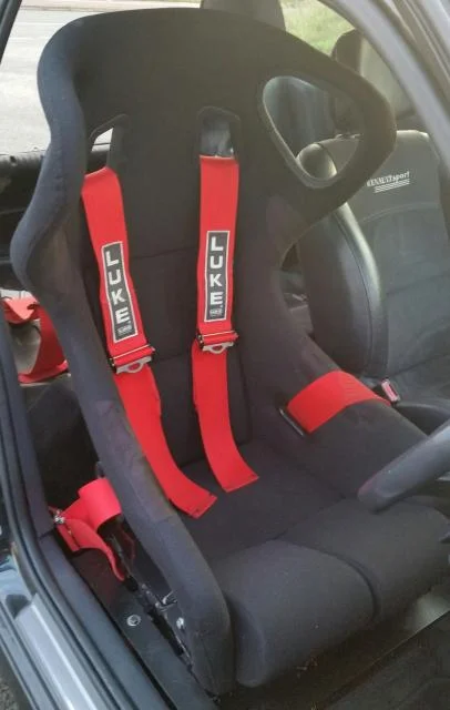

Seat turned up yesterday, brilliant service ordered saturday night and it turned up yesterday dinner time. Got it fit last night. Very happy with it so far

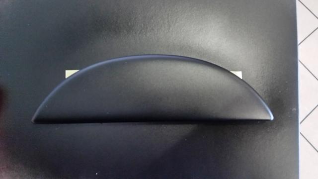

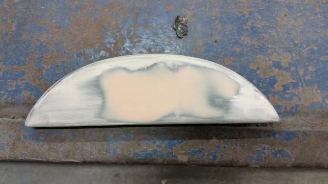

Also made a rear wiper blank out of the original rear wiper mount

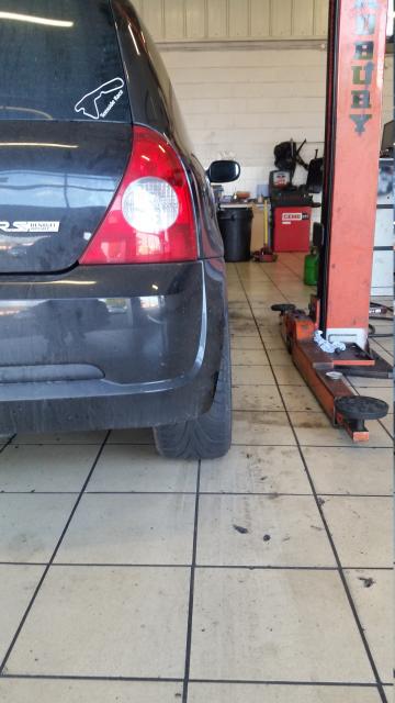

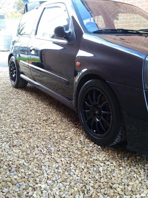

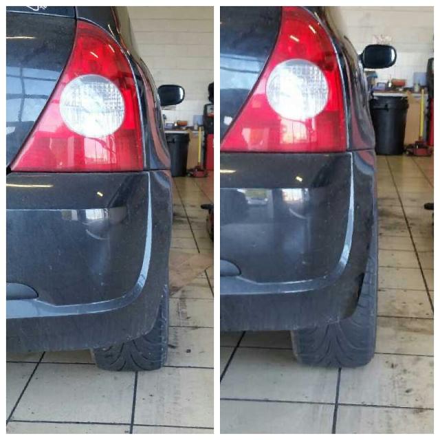

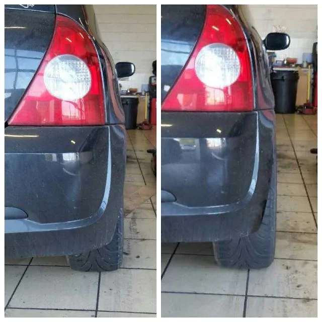

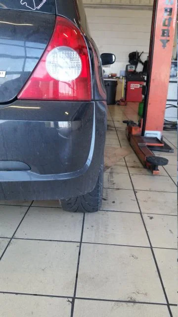

Fit some spacers on the rear yesterday. 15mm per side, sits perfect really happy with it. Just need to roll the lip on the inner arch catches on big bumps due to my soft suspension. Ignore the state of the car desperate need of a wash
Before
After
Comparison shot

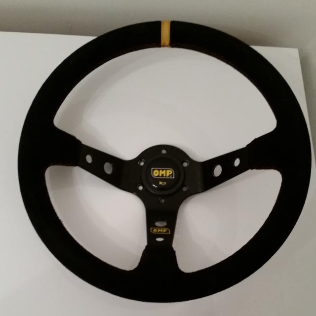

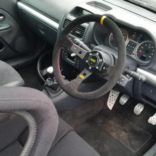

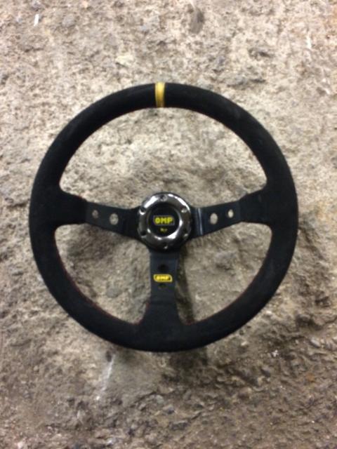

Steering wheel and boss kit turned up yesterday, got it fit on my dinner break at work. Really happy with it.

It looks a LOT better though I've always been warned to stay away from spacers though im unsure of the theory/reasoning behind it.
  172 sport
Few reasons, cheap nasty non hubcentric spacers can cause vibrations. Spacers in general can put strain on wheel bearing apparently. I've ran them on many cars and never had any problems though

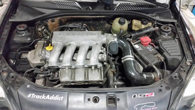

Managed to get the inlet painted satin black and give the bay a very quick clean. Next up I want to move the battery in the boot when I can find out what cable I need for the live

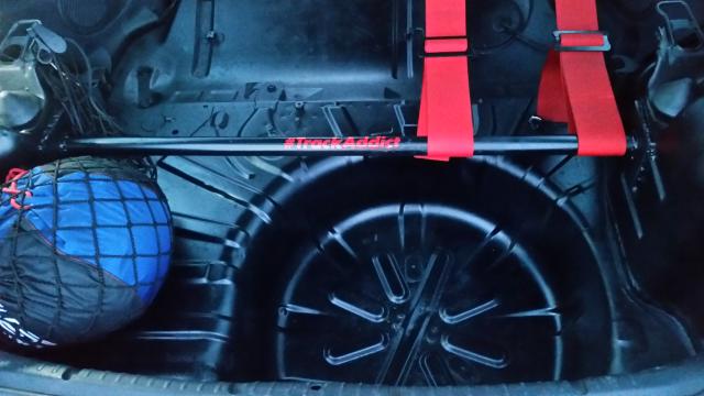

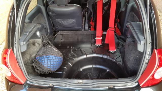

Also got a rear harness bar made up and welded in

Is it easy to remove the inlet? As I've been quoted £112 to fit a matched inlet and would rather not pay that!
Would the harness bar not have been better going to the rear suspension?

The upper inlet is about 5 minutes to remove, I've never removed the lower so not so sure but read it can be a pain on aircon models.
No I don't really want my harness fastened into my rear suspension top mounts they not the strongest part to attach a harness to.

I just thought it would look better as I noticed you hadnt gone the whole hog and removed the whole interior so assumed you wanted a bit of comfort/looks.

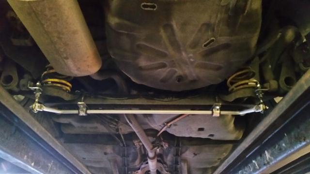

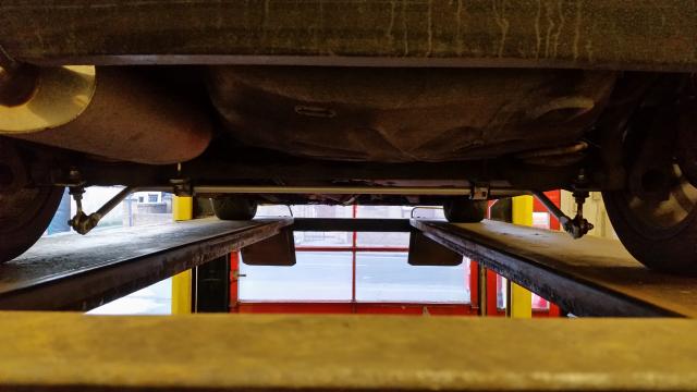

update from today, a friend of mine was selling his 2month old whiteline rear anti roll bar so i snapped it up and got it fit today. Havnt driven the car hard since fitting so cant comment on how well it works but it looks great
