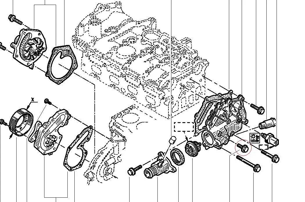

BenR Jul 14, 2006 #4 the bleed screw is on the side of the thermostat housing. Its a 10mm head and about 10mm long,
G greer182 Jul 14, 2006 #5 dear lord, where abouts is the thermostat housing. lol if i can change the oil ok then im sure i can do this.
