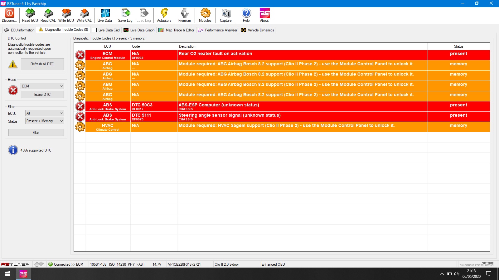

I've got an rs tuner with the abs module, I can access it and connect no problem and it appears on the screen that the bleeding is taking place but when I run the pump i.cant hear any noise coming from the abs unit which I was under the impression I should have been able to?
I've ran 2l of fluid thru it and the lines are running fine with no bubbles but my pedal is still mega soft
Rs tuner is flagging an error code "ABS-ESP Computer - unknown status"

Yes I did! Removed the main connector from the abs pump, gave it a good clean with contact cleaner, plugged it in and out a few times, blew it out with compressed air and re fitted, was all good after that!
Interesting , will tey that , i did get it to work but had to engage pump motor then select which actuator and it works then 🤔
