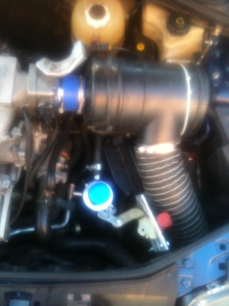

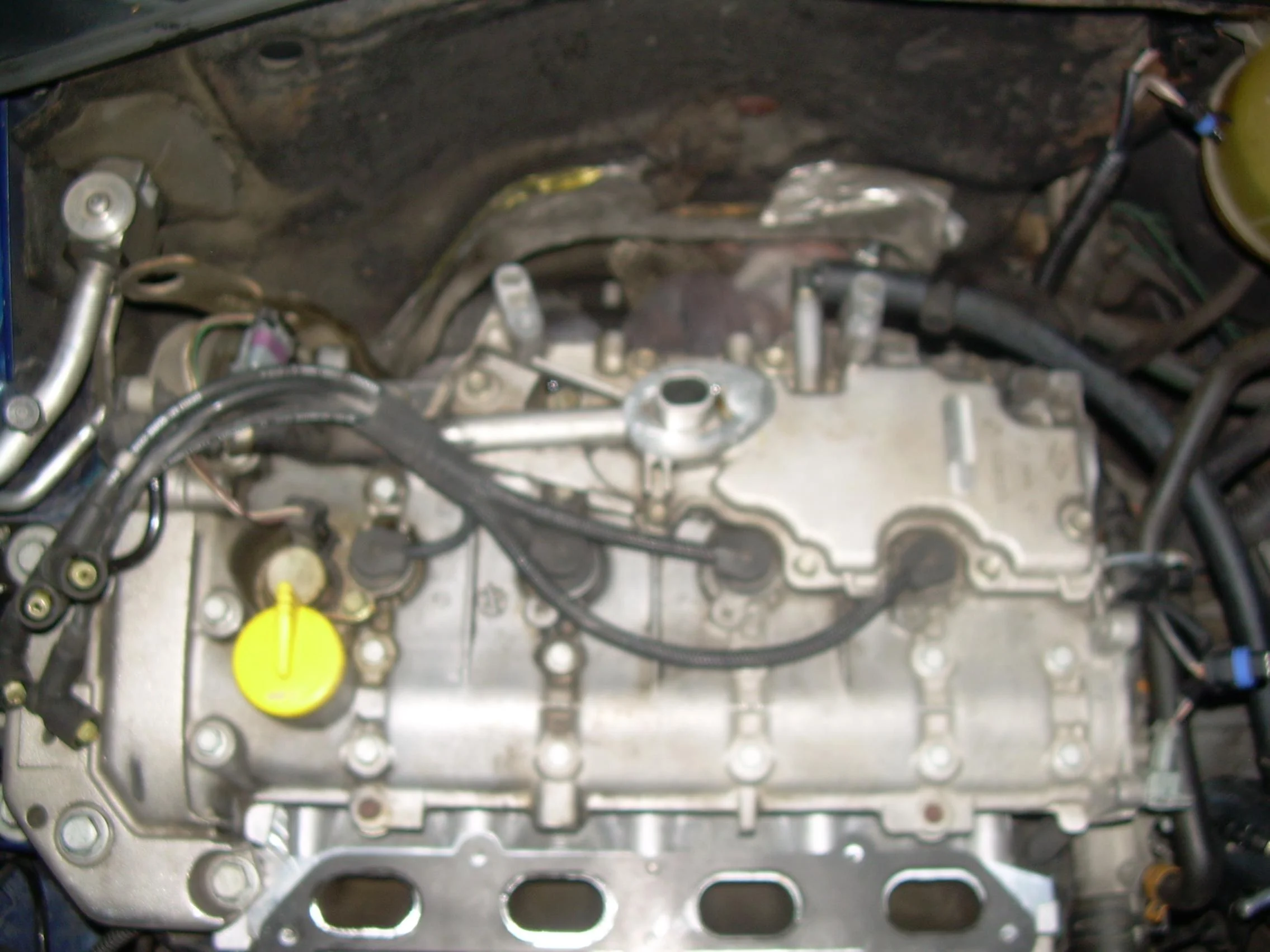

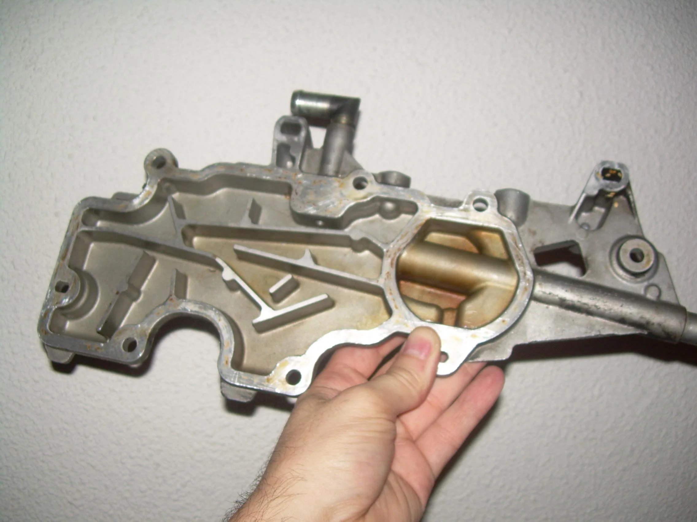

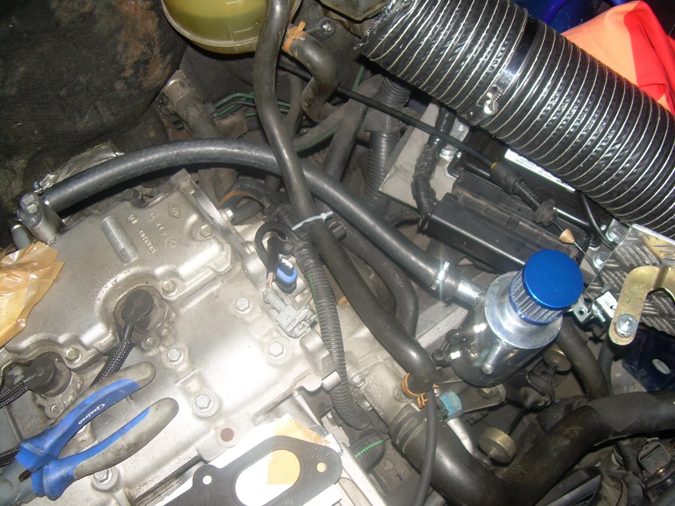

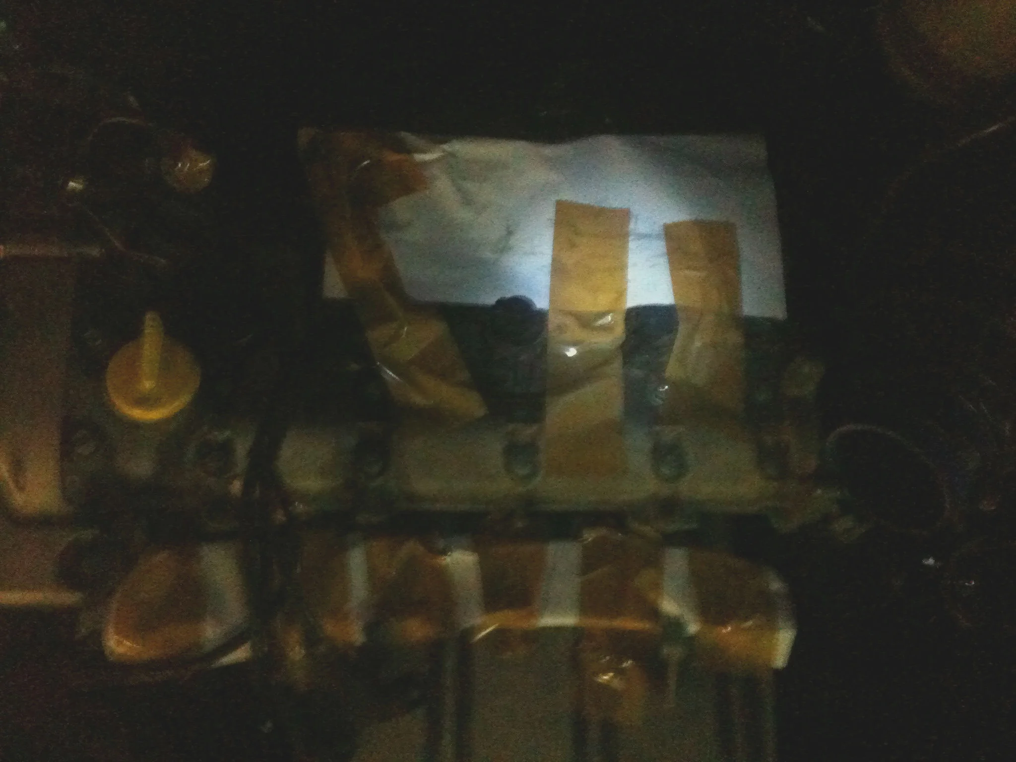

My last work in the engine is to eliminate all the returns of oil in the engine and the admission air

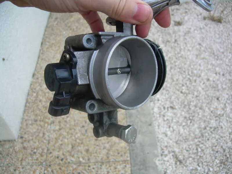

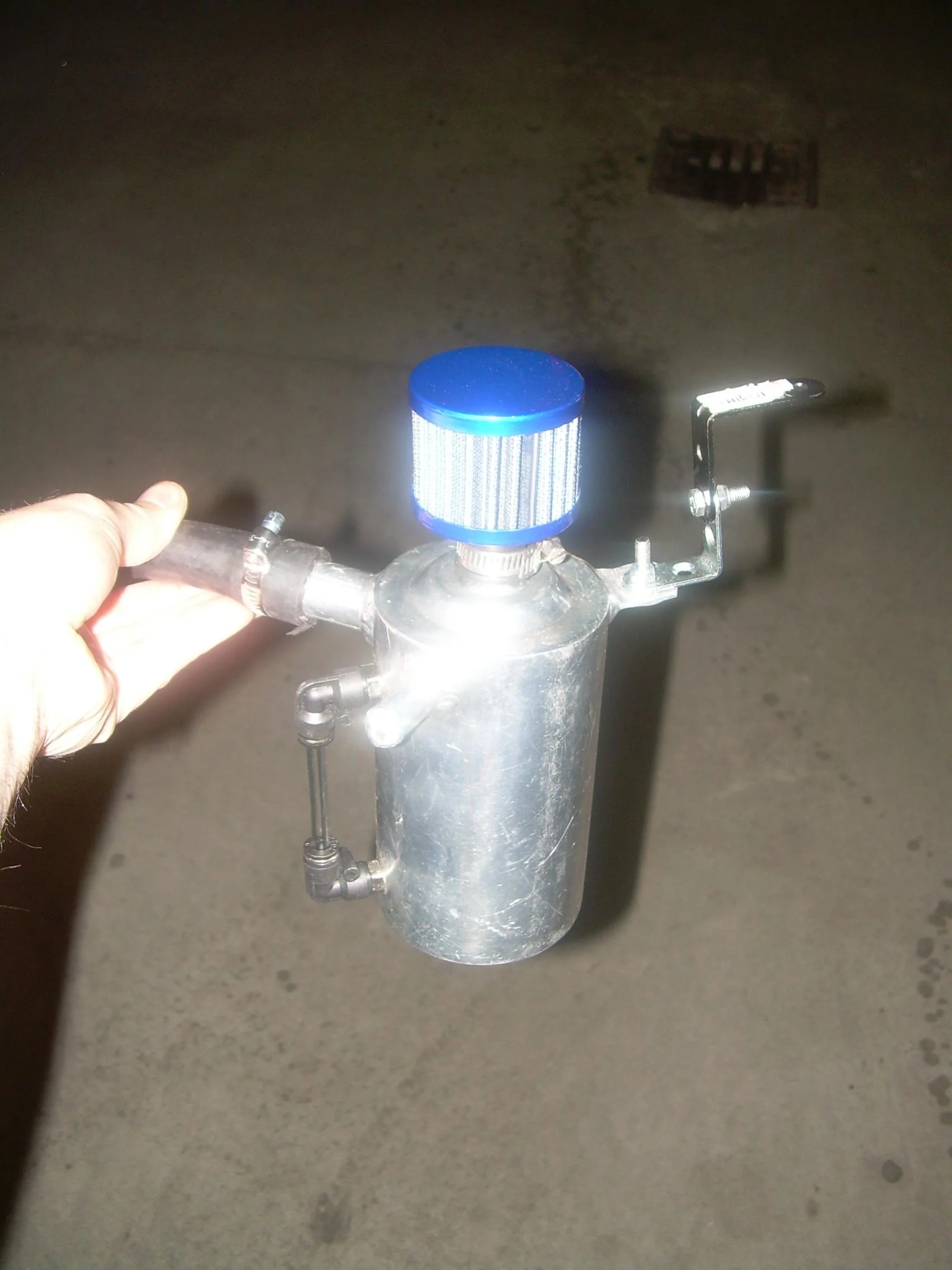

Already I have made this for the return of oil in the admission air (under the case "buttefly) by diverting the circuit towards a oil-catch tank and by blocking the entry under the case butterfly

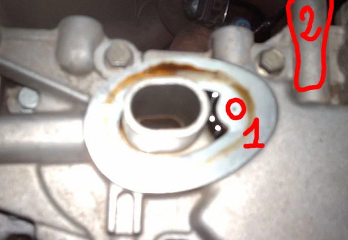

Now I could like to block the small hole in the decanter of oil (number 1 in the photo) like made some owners of Clio 2 RS1, but before, because i'm not sure, I shall wish to know if it's dangerous or not for the engine for average or long term
I suppose this little hole is used for the return of oil towards the plenum but also to let escape the pressure of the engine
And thus I ask the question to know if by blocking this small hole, I am not going to make increase the pressure at the top engine and thus destroy faster or be dangerous for parts and joints "spy" of the engine for examples
To resume, if I block this small hole (number 1), the only exit (number 2) towards the oil-catch tank will be enought to evacuate the full oil and pressure and not be dangerous for the engine?
Thanks for all informations about that ;)

Re: Block the small hole of return of oil in the decanter of oil : Good, Bad, Dangero
1 is for positive crankcase ventilation. This means the oil vapours are sucked into the engine through this hole. There is no issue from blocking this as long as the main outlet (number 2) is unrestricted
I know the use of this little hole, it is not my question ;-)
Sorry I dont understand ^^
do you want to say that I can block this little hole without problems for the engine because it have the outlet number 2 ?
Outlet number 2 which is unrestricted in my mountage because like I said it have that
OMG it's sure for me now I write a bad English langage because I explained that in my first message ^^ lol
So, on the engine of a Clio 2 RS phase 1 there are 2 return of oil :
1 by the outlet behind the decanter of oil (zone 2 in my picture in the 1st message) which return in the admission air under the case butterfly that I diverted towards a oil-catch tank and blocked the entry under the case butterfly
and
1 by the small hole (zone 1 of my picture in the 1st message) which go in the plenum
And it's on this that I ask if I can block this small hole to avoid thus returns of oil passing by the plenum without dangers for the engine
KumKum - You're getting confused reading replies. Straight forward answer - you can block hole 1 with no issues at all.
  CLIO 2RS Mk1 noStock
Ok that is direct answer and I understand perfectly !! :cheers:

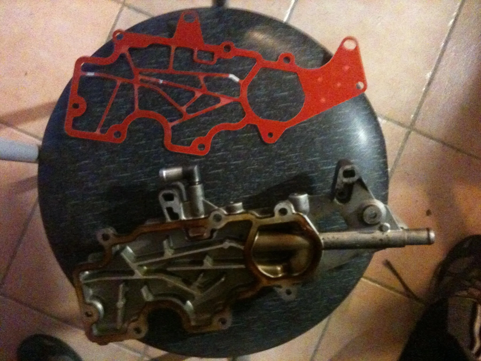

Tomorrow I shall visit my friend boilermaker to block cleanly the small hole ^^

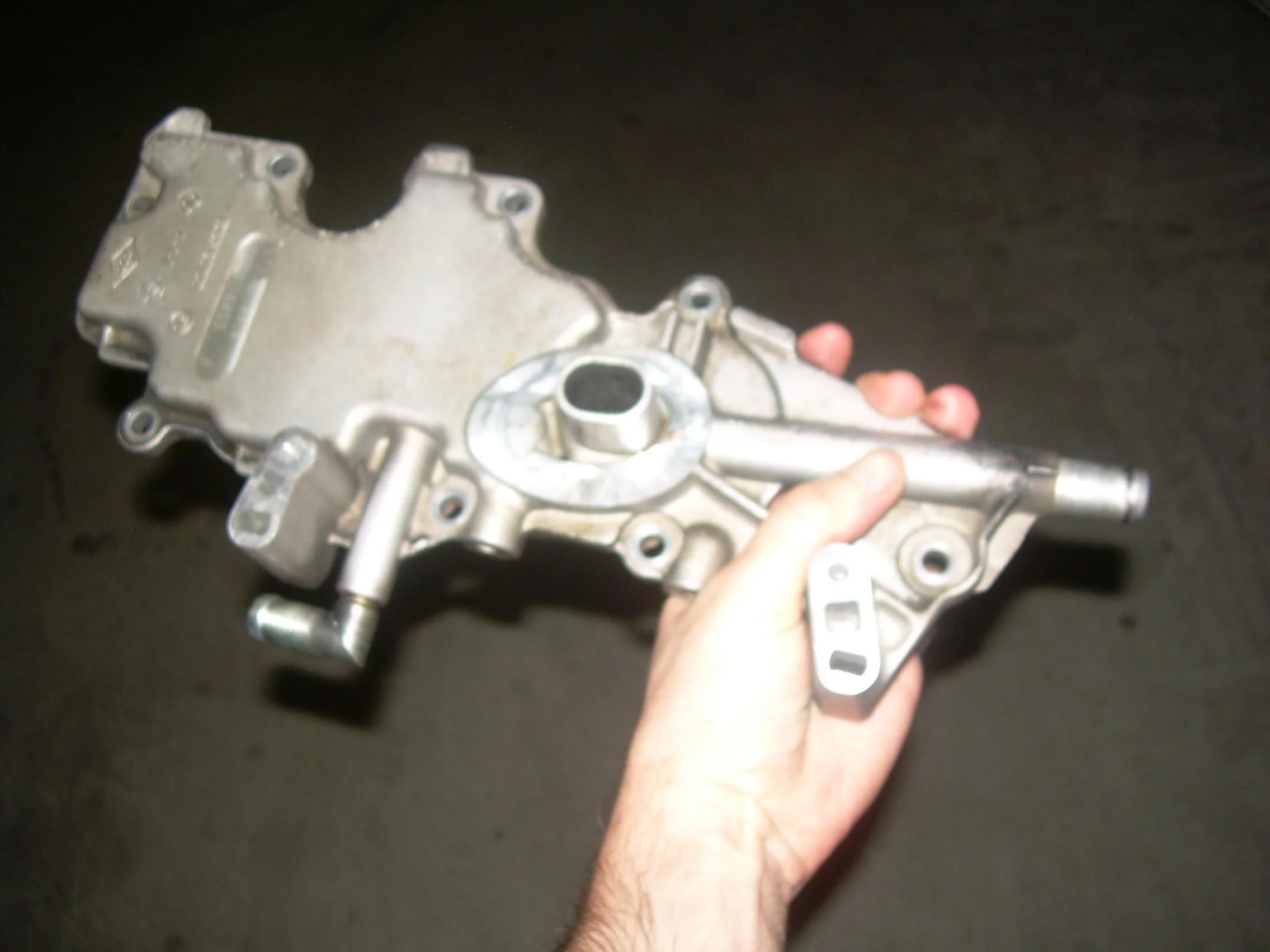

Thus tonight I prepared the things for that

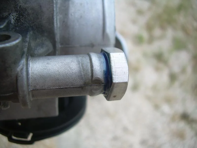

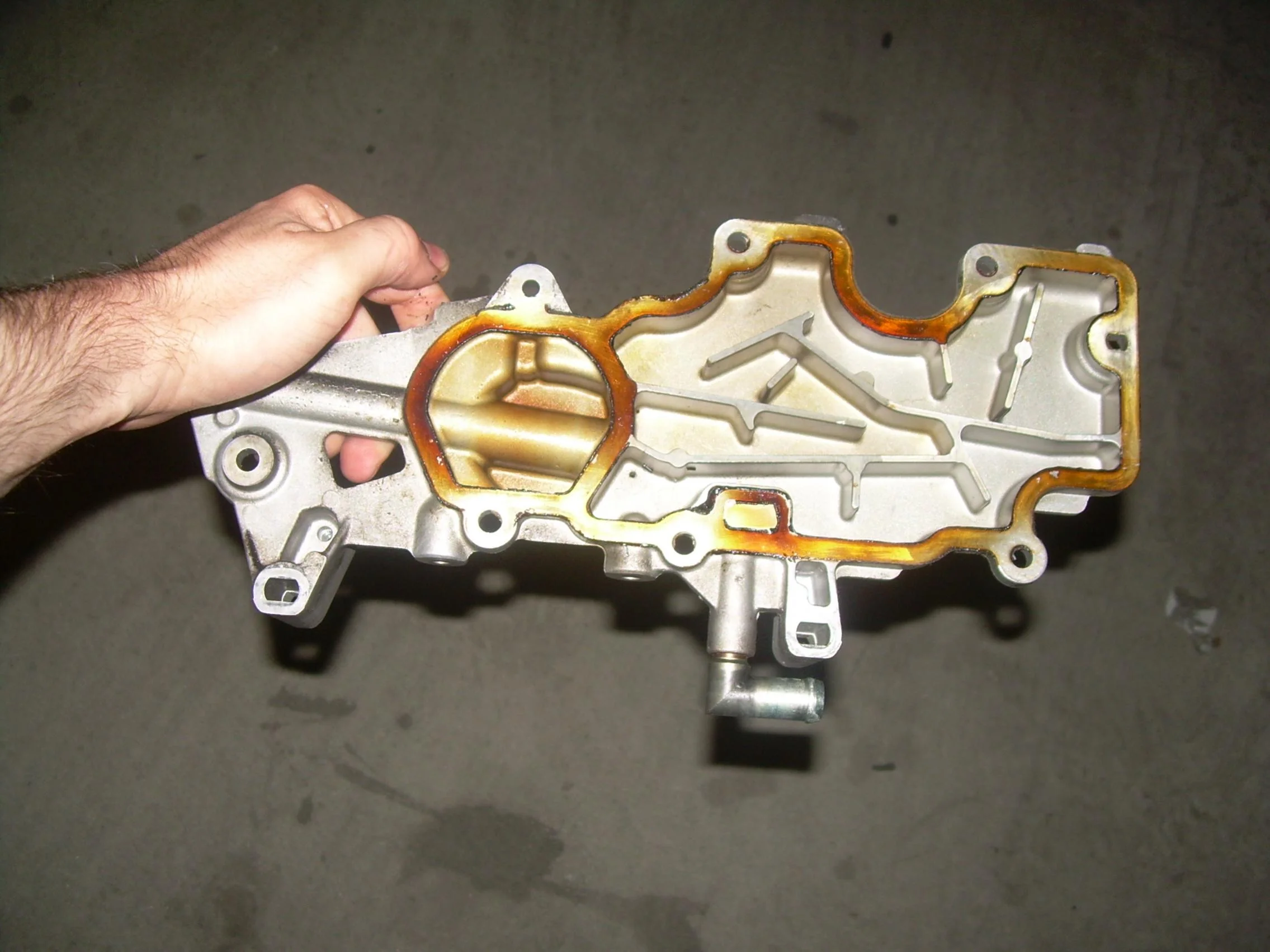

You see in the next photo the joint dough which was in stock on the decanter of oil
I am going to clean because I bought the metalique joint that I prefer
And the same decanter of oil after the cleaning :cool:
To be continued tomorrow :p

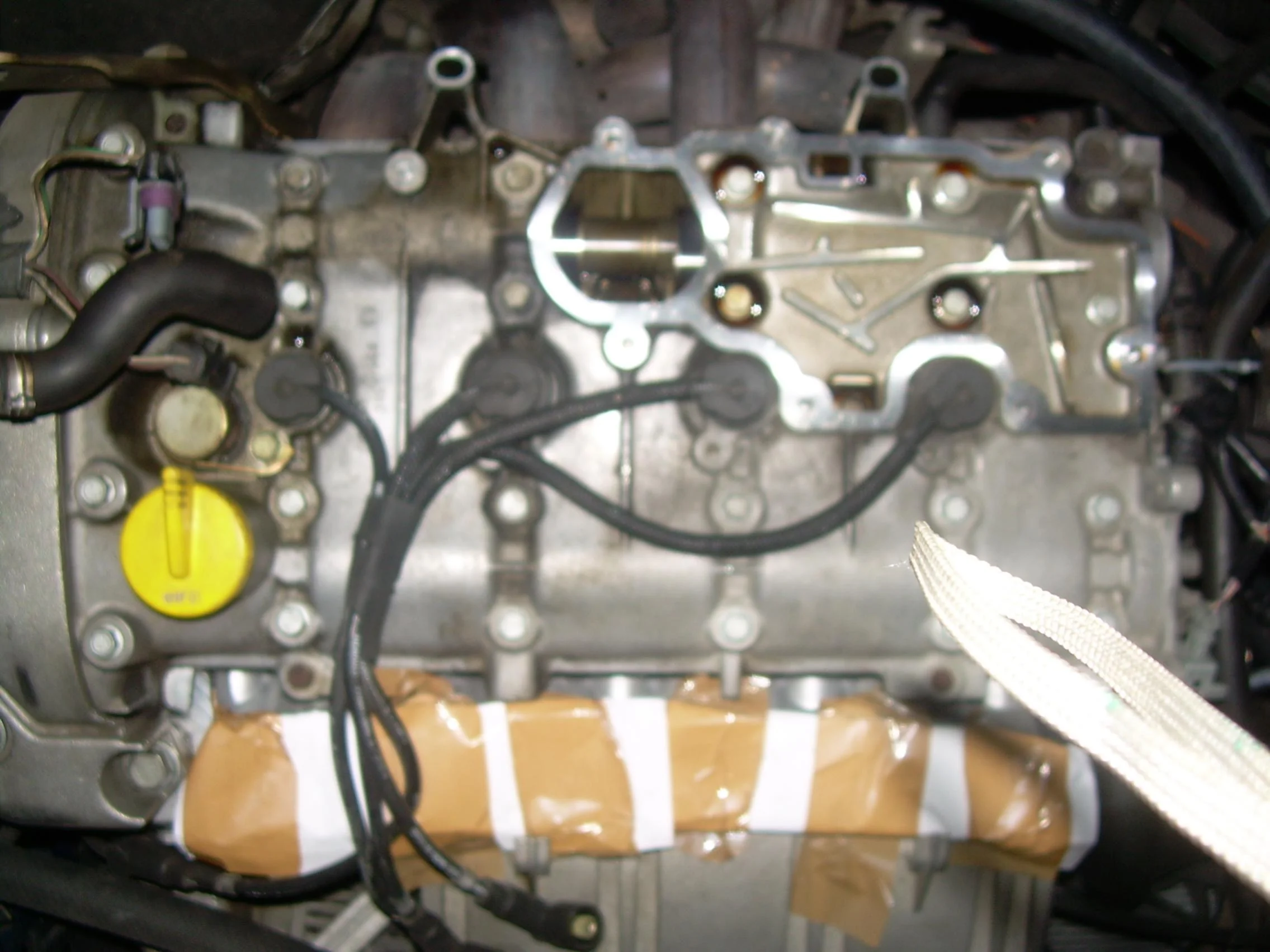

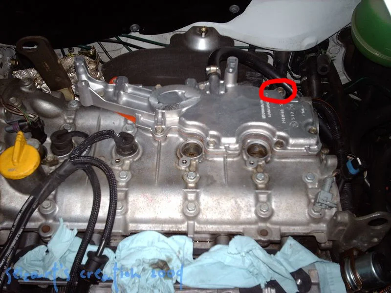

So I remounted the decanter of oil with its small hole blocked by welds (I will post photos of that later) BUT I have little (I hope) problem :S
I cannot screw saw it of the decanter noted in the red zone
All others screws are good but not this...
The hole of this screw is "falsified" and too big (it is one of big problems on the engine of my Clio 2 RS1... do you knwo that you too in your Clio 2 RS ph1 ?) Grrrr !!
I try to made the hole and the form of screw for a bigger screw (size 8 and the stock 6) but it's too difficult and not possible for me...
Is it dangerous for my engine and the lack of oil for example to remount the engine anf the decanter of oil without only this one screw ?
