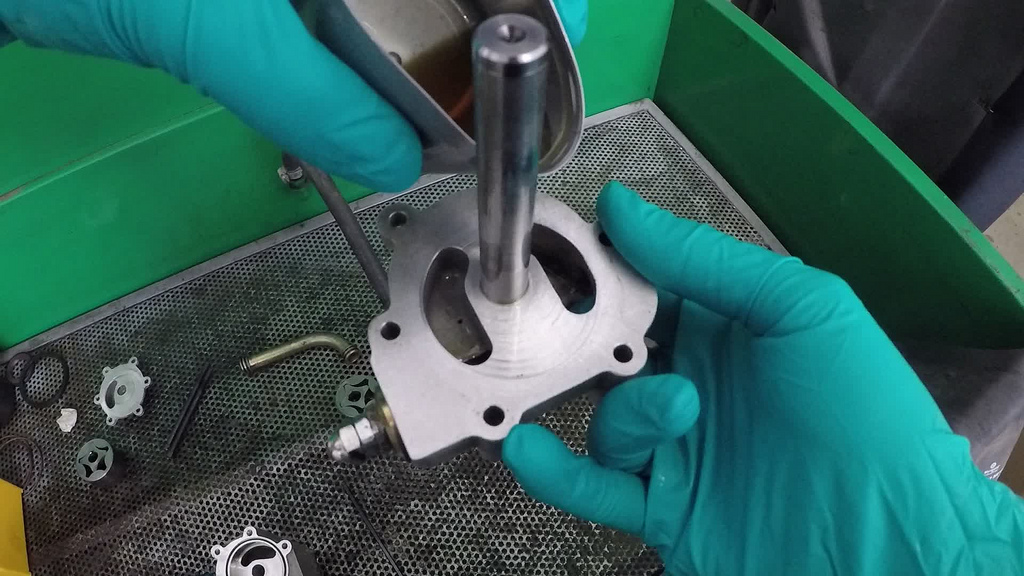

I took the pump apart when I rebuilt the engine but didn't touch the PRV as they're fixed from the factory. You can see the majority of it from inside the pump housing so I cleaned it all out.. didn't look like it was stuck open.
Seems like the pump is working to me, in light of the above.

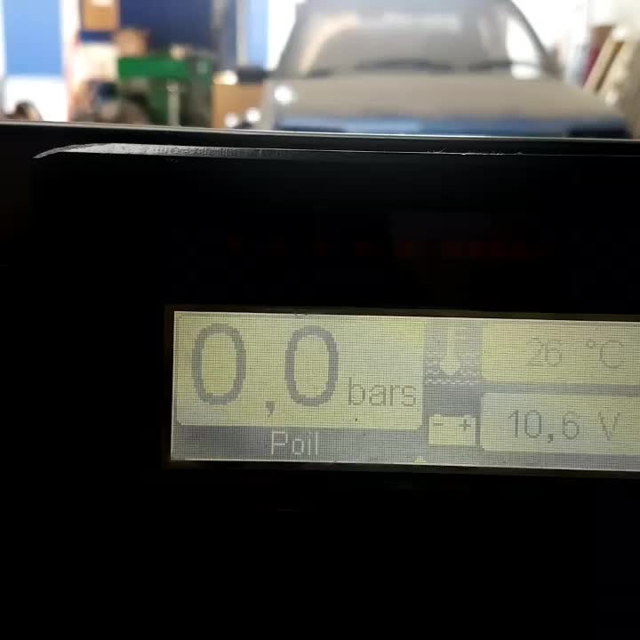

You can see the gauge (and the problem) in this video.

Well, a small update.. I can't get hold of a pressure tester but I'm pretty sure the sender is faulty. I span the pump with a drill until oil gurgled back into the tank through the return and got the gauge up to 0.8Bar, but then it stayed there and didn't go back down. So I disconnected and reconnected the plug on the gauge and it now reads 0.1Bar and won't budge.
Senders fucked then by the sounds of that. Blast it with brake cleaner and an airline blower mate. It may have some s**t in there - ya never know. We have this happen from time to time.
