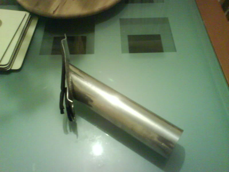

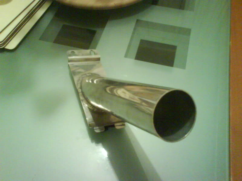

Ok since i had problems finding a adaption plate for this bmc. i went to my local scrappies and got another air filter box for £10 :cool: . and let my wee project commence.
Cut my hand in process :S...
Now to sand all the cut parts down flush. not a bad idea ah. :approve:
not realy wanting to spend £70 on a induction kit from ktec so gonna see if i can get this to work. in my mind i have it planed :P cause its just the same as the adaption plate now just with a 43mm pipe :S

Well from what I can see, theres a gapping hole in the side...
Na thats a bad angle where i took the picture. have now filed down the rough parts pics to follow soon. just need to figure out how i can get a 70mm to 42mm reducer.

Ok pics of it filed down, just need to sand and might spray it green or black.
now is a challenge to get from a 42mm, pipe to a 60mm. maybe a wee bit of fiberglass will be needed, or something.
