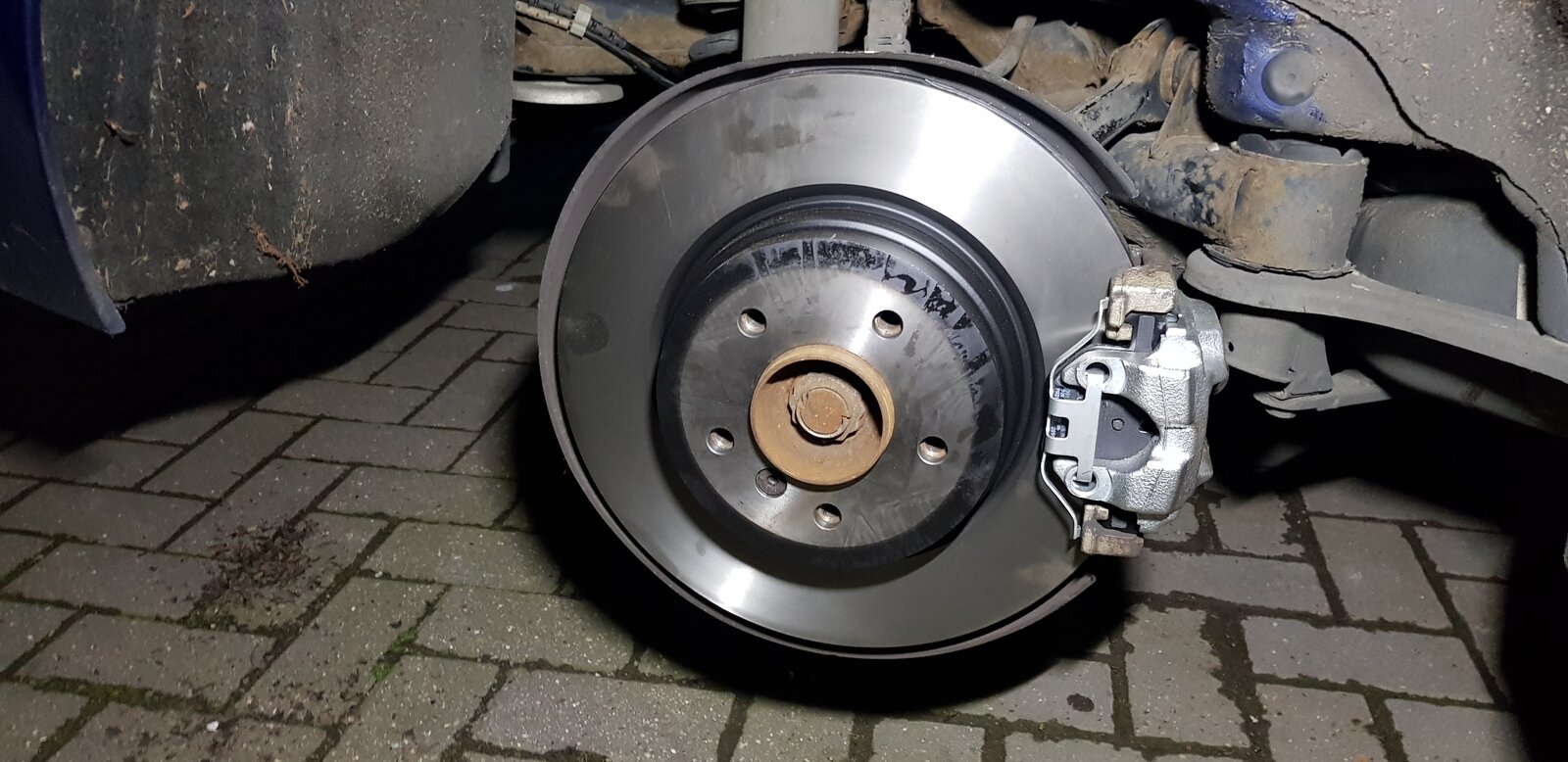

Had a slight issue pretty much since I bought it I think with a very slightly binding r/o/s brake caliper. In the last week it has got quite bad so stopped using the car. On inspection the caliper is seized on the rear o/s causing it to bind. I have purchased a reconditioned caliper along with new rear discs and pads. I am currently in the process of replacing these and it should improve the drive(although was pretty good before!). I also plan on doing a service as it's due.
Rear bumper and the washer jet covers should be getting painted next month. Then it will just be the wheel refurb. I will wait until after winter for this though.
Back brakes all done. Drives like a different car. The old discs and pads had definitely seen better days! O/S caliper replaced with a refurbished one and the N/S was in really good condition. New discs, pads and wear sensor. The anti rattle clips were missing both sides too so got two new

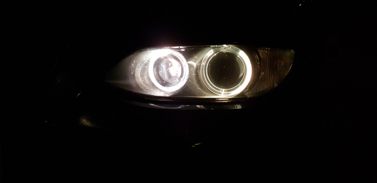

Got a quick picture of the halo lights with the new bulbs. Give a nice light. Not the easiest of things to take a picture of.

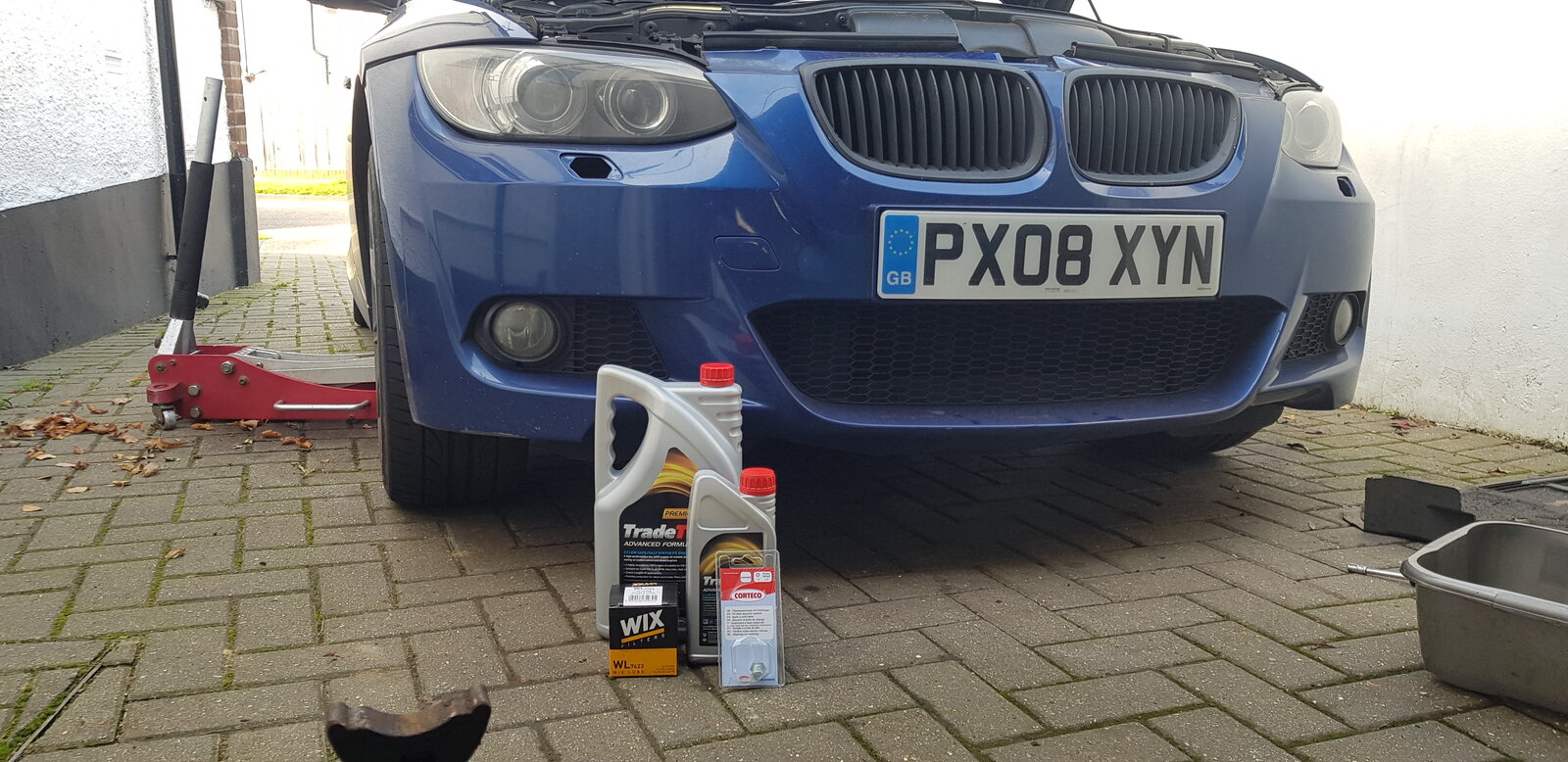

Completed a quick oil and filter change today as not done one in my ownership. Bought some 5w30 C3 fully synthetic with the correct BMW LL-04 rating. Takes 6.5ltrs.
I read and read yesterday about various views on BMW approved oil and this meets all the criteria.

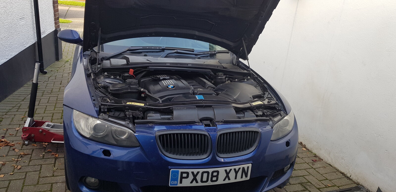

Had a good look underneath as took the under tray off. All very tidy. Got a slight leak from the rocker cover, which I understand is really common. Not an issue at the moment, but I will get this sorted in time.
