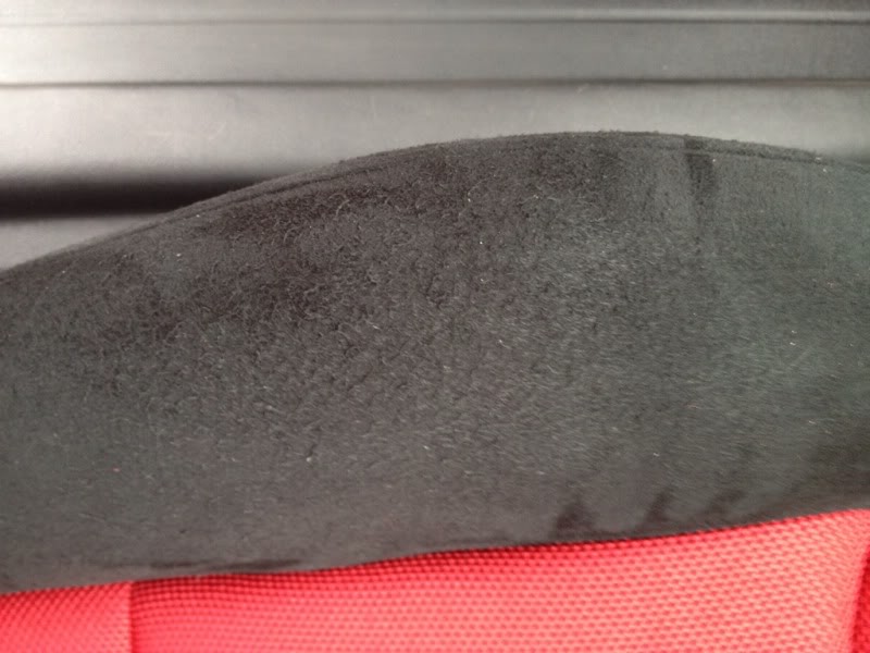

Hi, I know this isnt for a Clio, but Im guessing my seats are the same sorta material as 182 seats.
The interior of my 6 year old Civic is in pretty good condition, but one thing that lets it down is the Alcantara on the passenger side bolster is a little bobbly. Bizarrely, the drivers seat is fine, So Im guessing one of the previous owners had a fat mrs ;) Only joking.
Heres a rough pic of it,
Anyway to improve it?
Thanks

I just razor bladed a 172 drivers seat and it came up like new! Proper suprised!
Bluebeard
  Whichever has fuel
I used a razor blade bare (no actual handle or owt) and just scraped the seat. A stanley blade will also do but make sure whatever you use is brand new!
Scrape in short motions and gather up all the fluff.
Works a treat!

Wow what a difference, could do with another going over with a brand new razor but its still turned out really well.
should of taken before and after pics :/
