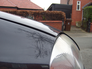

Now I've got it open, I can't shut it now!! The release-bolt thing doesn't seem to go in, if you get what I mean..
It "shuts" as in the bonnet goes into place and the pull release is locked - but its not flush with the rest of the body and can still be just re opened by lifting the pull lever underneath.
Gah I've bought a lemon haven't I.
The catches are renowned for being shite on them mate, Renault Re-called some of them for problems with the catches, might need lube-ing up with a bit of grease?
Phew - sorted it. The release cable seemed pretty tight, so I pushed it towards the hole that the 'pin' in the bonnet goes and the locking mechanism re-appeared. Surely not the right way, but it'll do.
