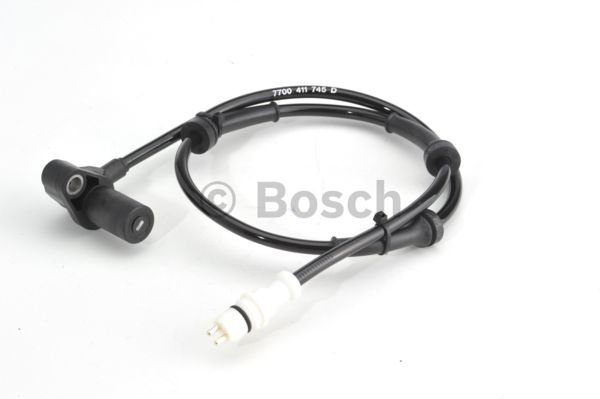

Need to replace my rear drivers side ABS sensor.
Appears to be a Bosch option on euros for about 60 quid, half the price of an OE Renault one, anyone know any reason why I shouldn’t get the Bosch?
Happy to pay for the gen Renault one if I can find one & the Renault part is a significantly better product

What's the Bosch number?
Bosch number appears to be 417745410
And the OE number for the Renault one is 600007352
Just can’t find anything to say they’re the same thing, probably meaning they’re not!

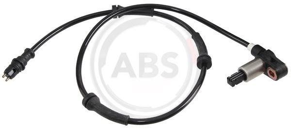

Small write up and update on this.
Around 3 weeks ago I need a rear N/S ABS sensor but found it virtually impossible to get one, After a week solid of trying to find one I got all this information on them.
The OE part number - 6000073527 (n/s/r - "CUP PACK")
The OE part number - 6000073528 (o/s/r - "CUP PACK")
The above part number is also the same as the Dacia but Renault and Dacia use the same parts system so it can not be bought through them.
I then done some research and found that the "CUP Pack" cars have a different ABS sensor / part number from non-cup pack cars.
I then found that Euro Car Parts sell ATE sensors which are who supplied renault and that if you bought an ATE one from ECP it came with the renault part number and logo stamped on.
ATE Part Number - 24.0741-1129.1 (n/s/r - "CUP PACK")
ATE Part Number - ? ? ? ? ? ?
I called and spoke to a friend who is the manager at ECP and he done some research to find that ECP now now longer supply these sensors so I was left with calling other motor factors with no joy.
I then managed to message ATE direct via e-mail and speak to them to be told they now no longer make or supply this sensor.
If you have a "Cup Packed" car and need rear ABS sensors there is one make that supply them, I managed to find it, get there part number for it and then I fitted it and its worked a treat.
Trying to get one in the UK is going to be a nightmare for people as unless there is genuine sensors running around in dealerships you will struggle and the OE sensor is around £130 per side.
I paid £32 for my sensor and another £30 for postage.
I would also like to add at no point have I found any Bosch sensor that fits / works as they have all been wrong.

Can you use this Bosch item in place of the ATE 6000073527/ 24074111291 part?
I tried to get to the bottom of this months ago, but gave up.
https://www.cliosport.net/conversations/6000073527-lhr-abs-sensor.494233/
I know this was about the LHR, but the principle remains the same.

Anyone know if bosch part number below will fit mine ?
It's a 172 non cup model , rear drivers
Product Code: 417745410

If your car has the sensor with the exposed rectangular core, 6000073528 is what you need.
Triscan & NK are available on ebay or
https://www.onlinecarparts.co.uk/oenumber/6000073528.html
Around £50 with postage.
