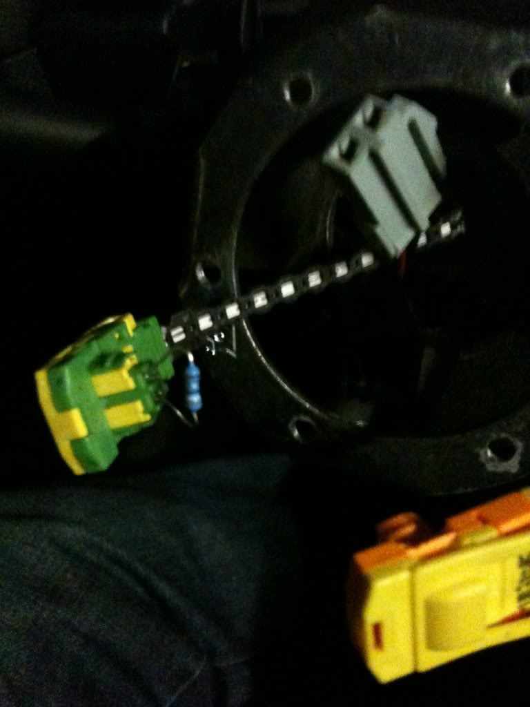

The boss has nothing to do with the air bag light, the light will come on due to the air bag conectors, to stop the light you need 2 resistors.go to maplins and ask for 3.9ohm then you need one resistor in each airbag block heres a pic
  182
No probs mate, if you get stuck give me a pm. The resistors btw are about 20p each, you need 2 of them but i got about 6 just so i had them spare
