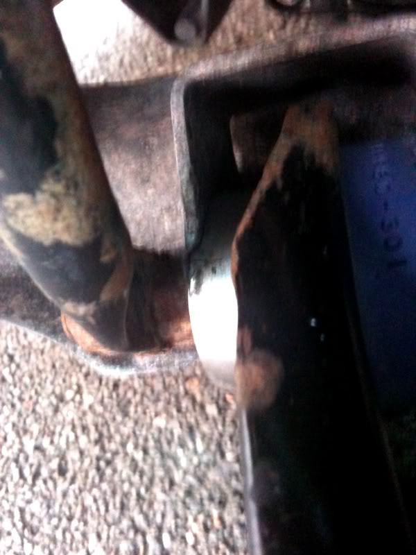

Is tackin them a must? As the instructions don't say to I don't think?
^^correct.
Otherwise the sleeve comes out and eats away at your subframe, which isn't a cheap part you will be wanting to replace.
